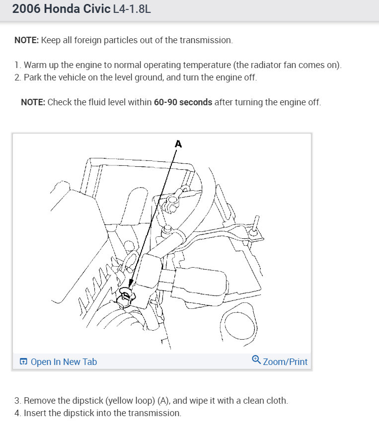

My car rolls backwards very bad on small inclines after i release the brake. When i hit the gas to stop rolling and to accelerate forward, my rpm's go very high and my car revs up very loud. there is also a rattling noise.
Feb 27, 2019 at 1:49 AM
  • 55,433 POSTS

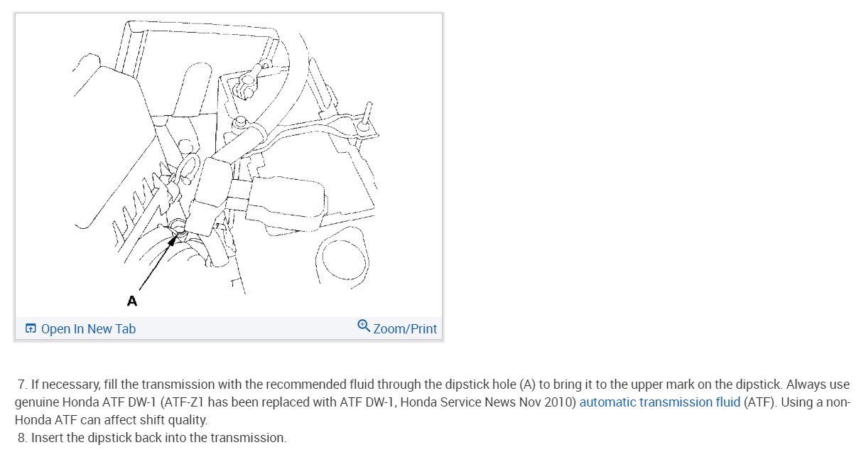

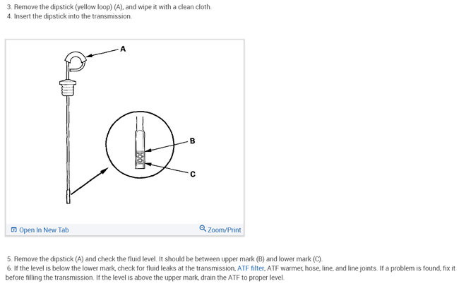

It sounds like you are low on transmission fluid, let's check the level first. here is a diagram to help you. Check out the diagrams (below). Please let us know what you find. We are interested to see what it is.
