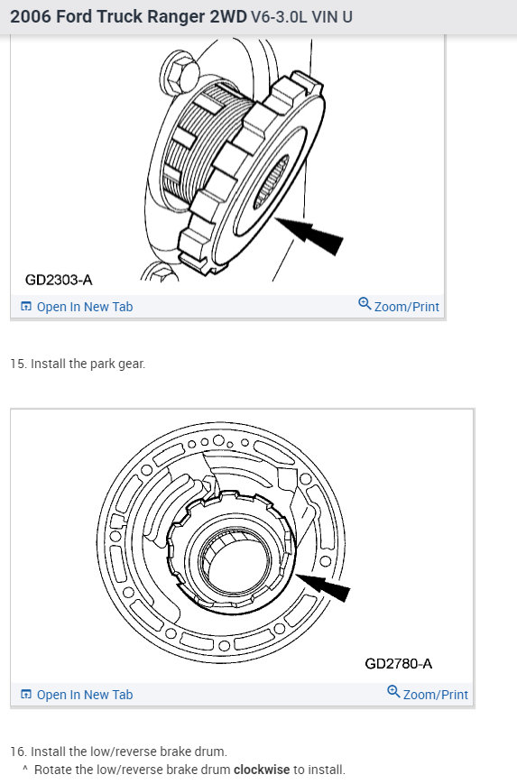

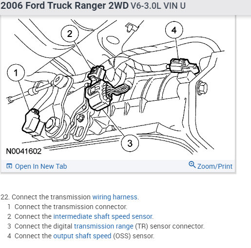

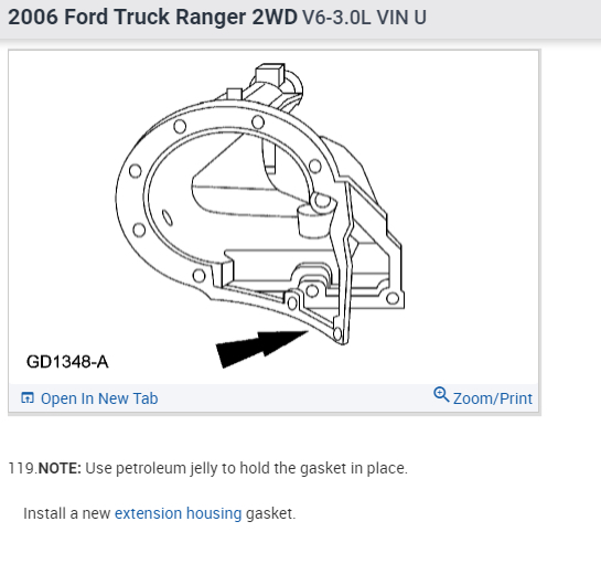

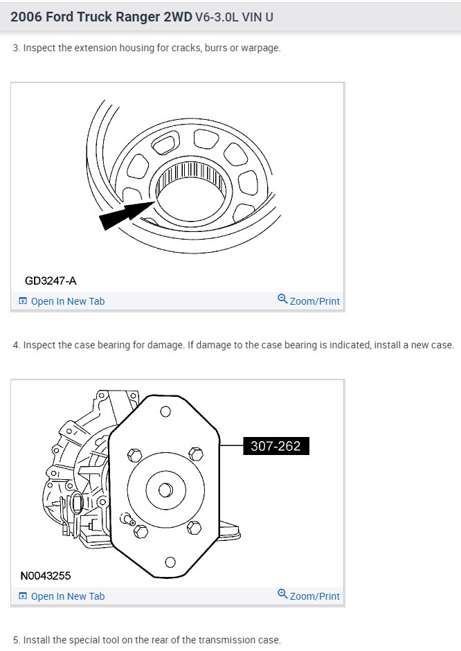

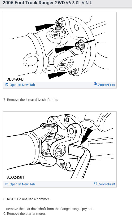

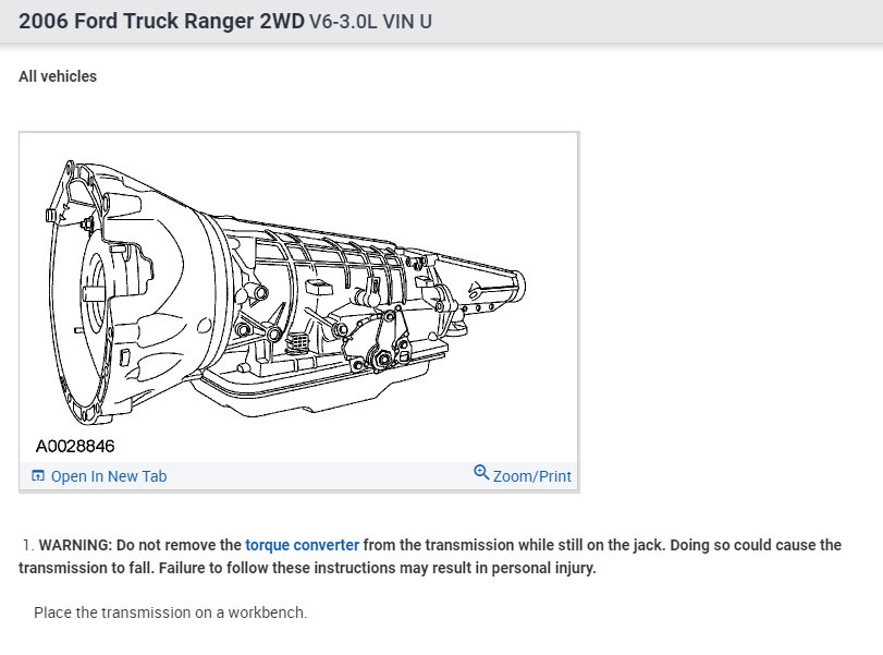

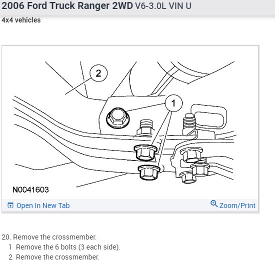

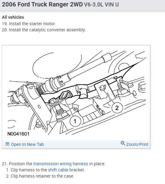

Fixing to do a transmission swap on my truck. Same transmission as original just lower mileage. Looking for a guide out any tips you may have. Thank you!
Oct 29, 2021 at 3:44 AM
SQM
  • 6,383 POSTS

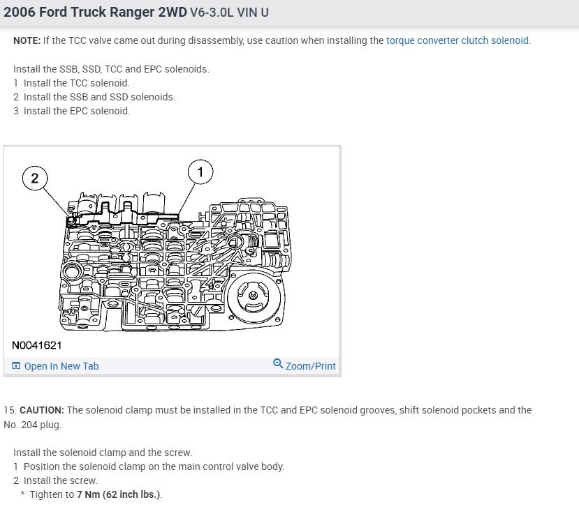

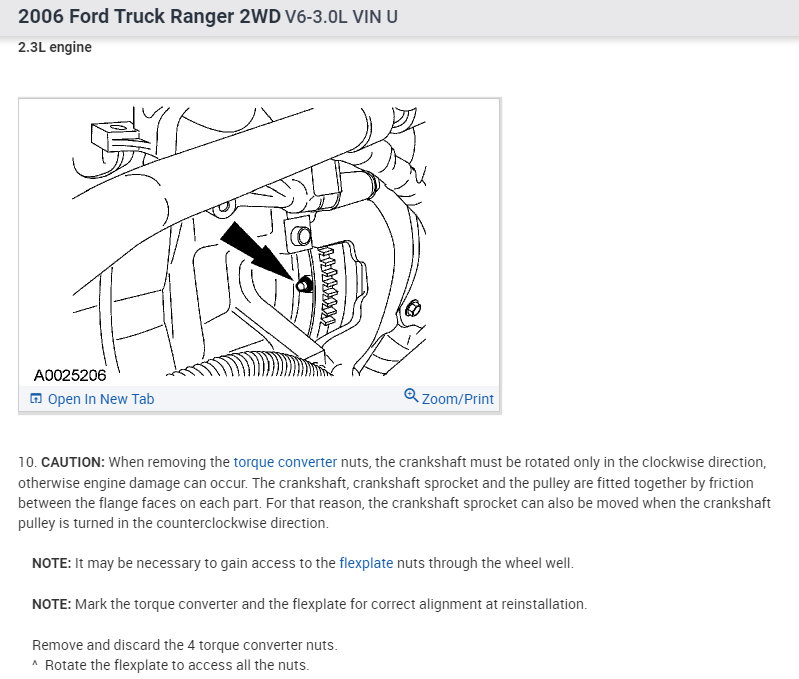

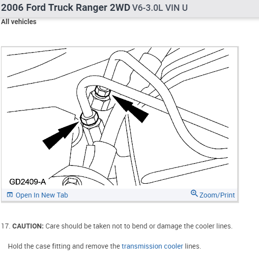

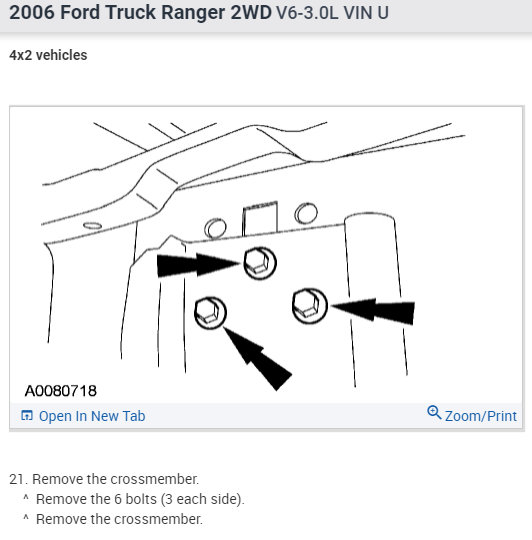

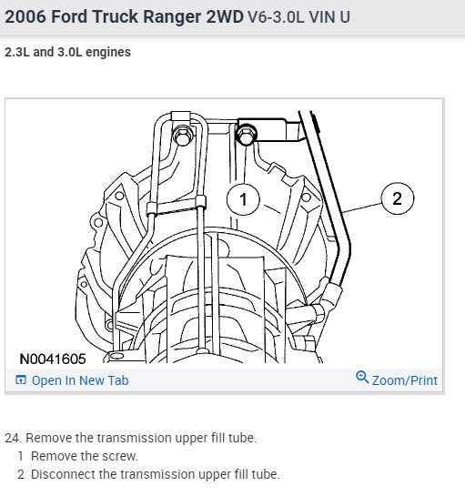

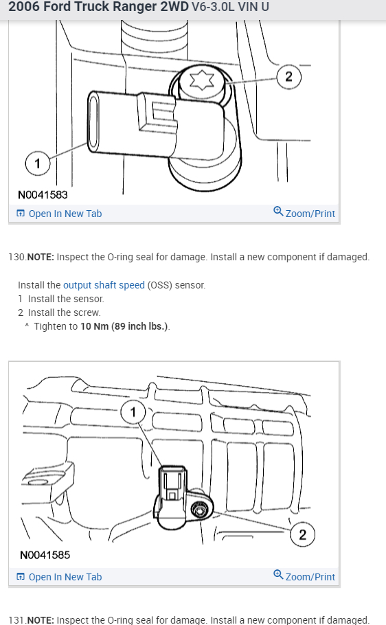

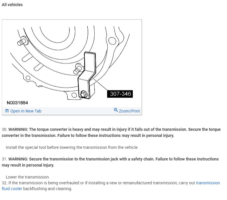

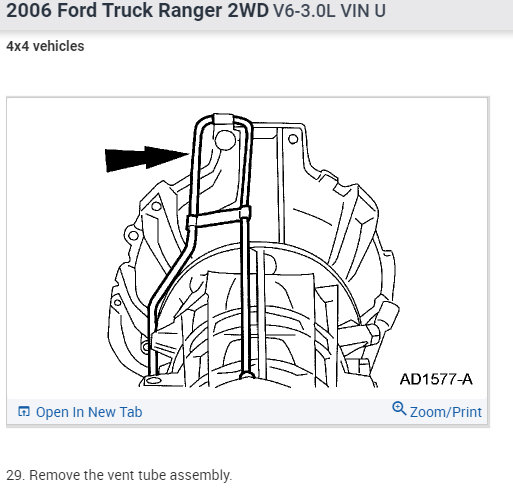

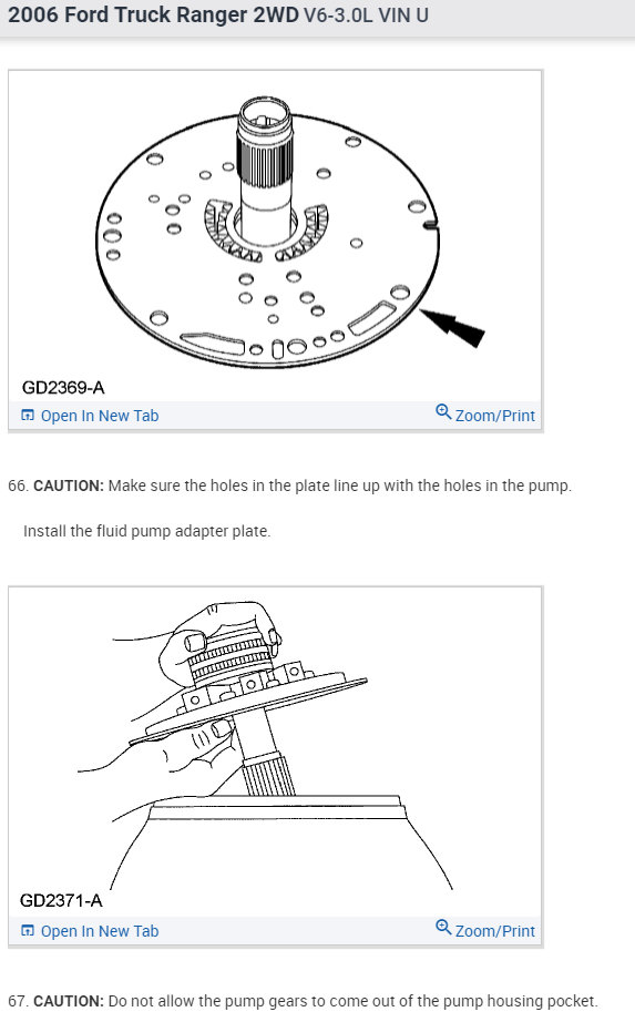

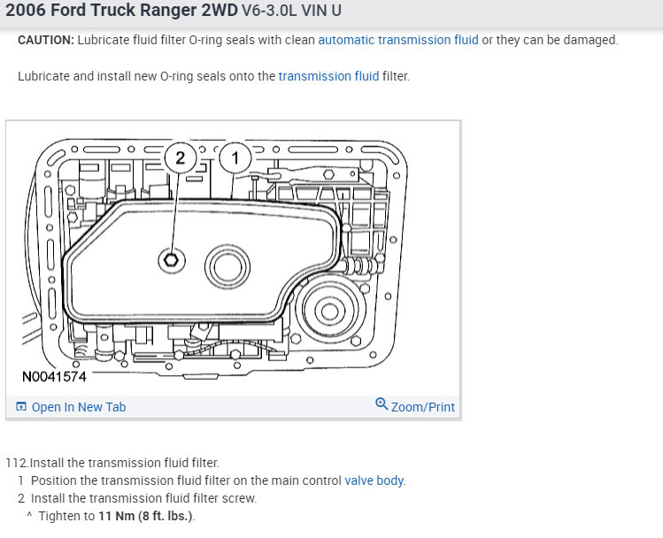

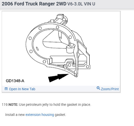

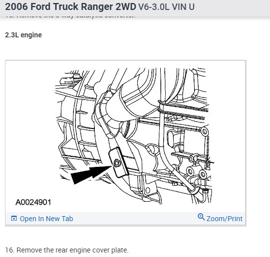

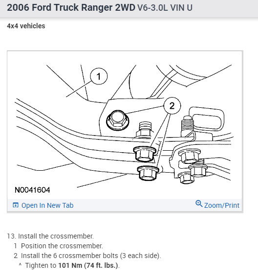

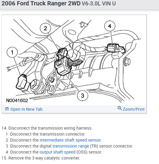

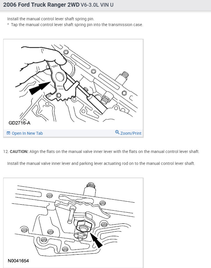

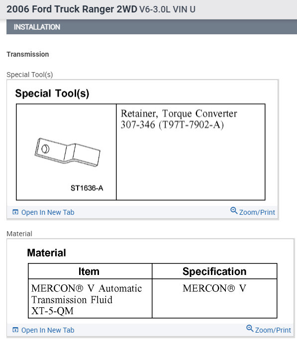

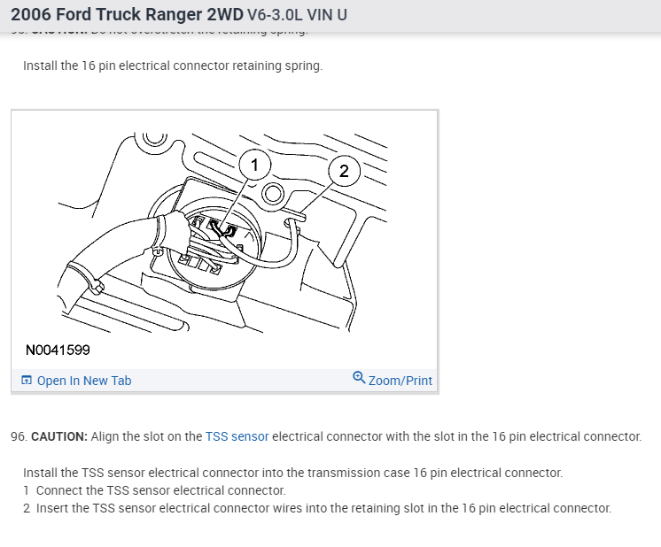

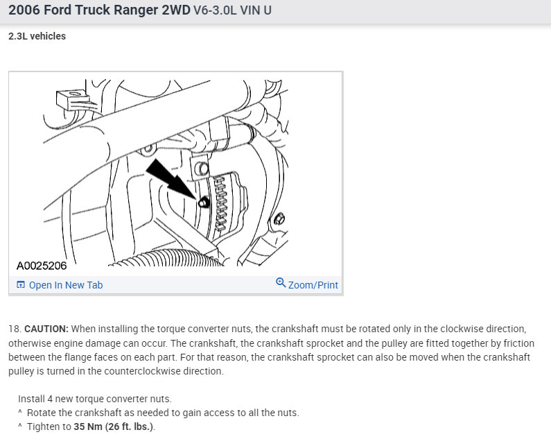

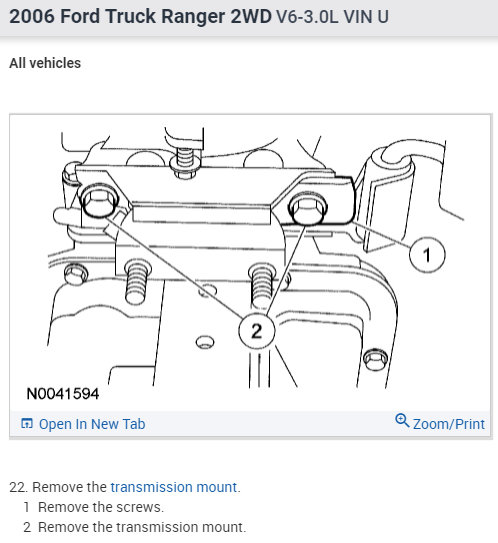

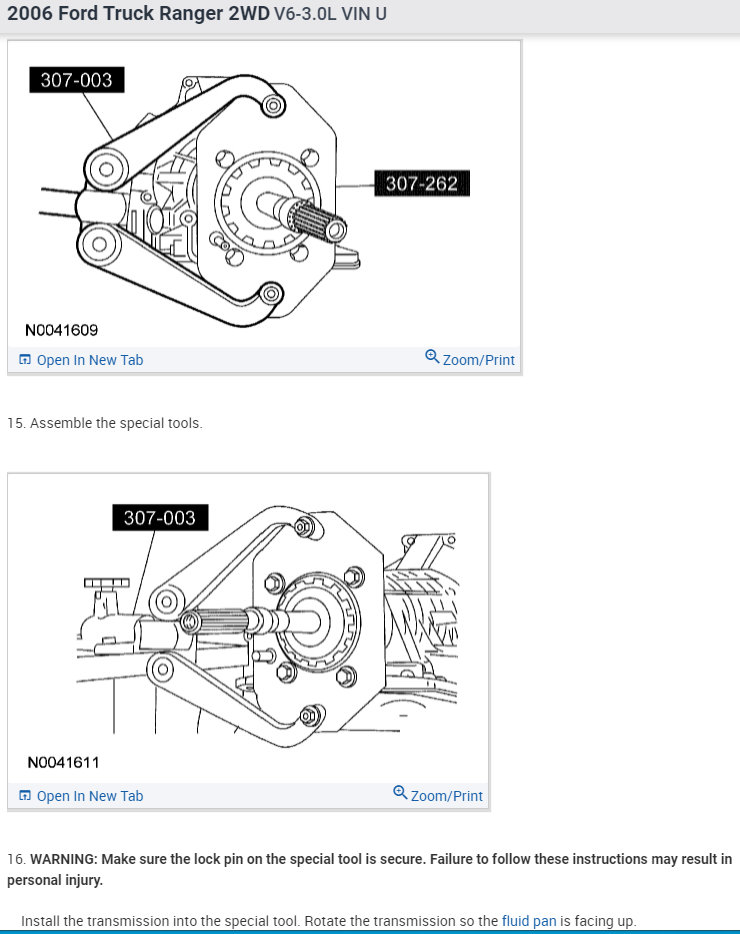

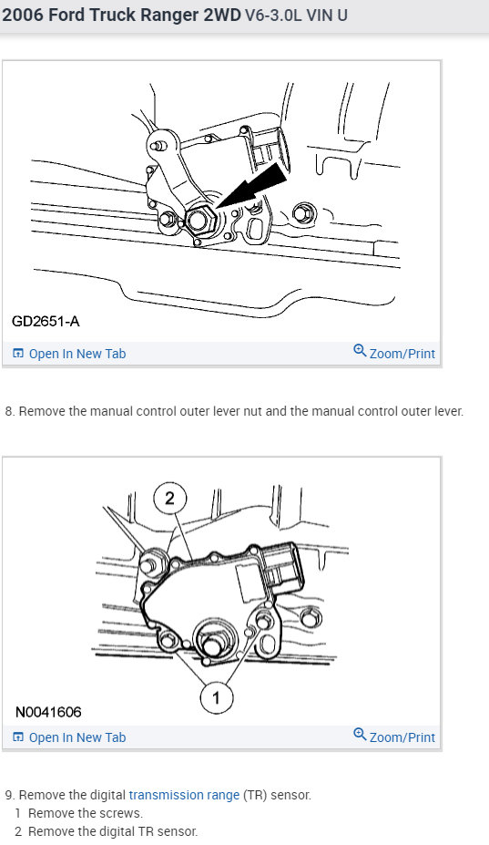

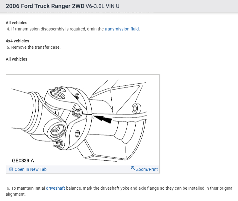

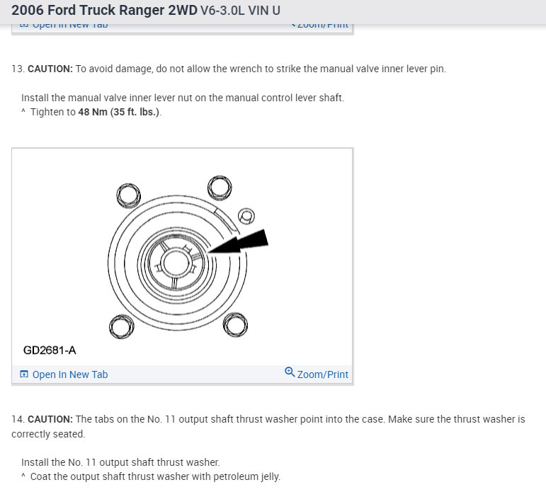

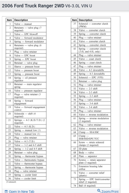

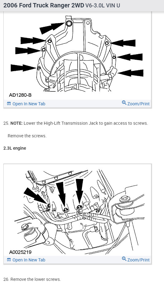

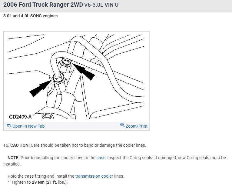

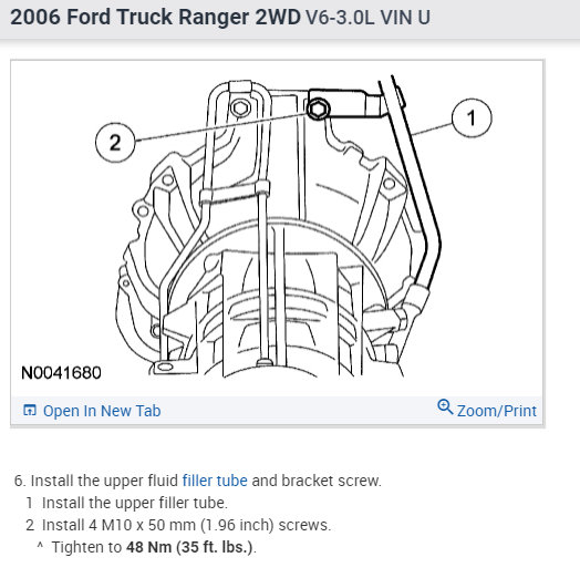

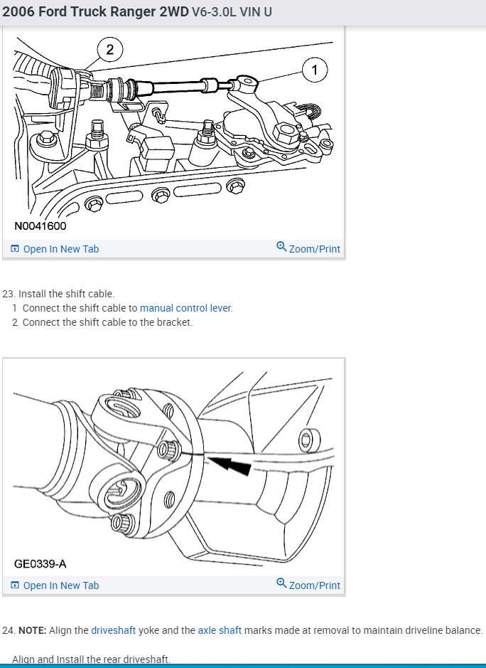

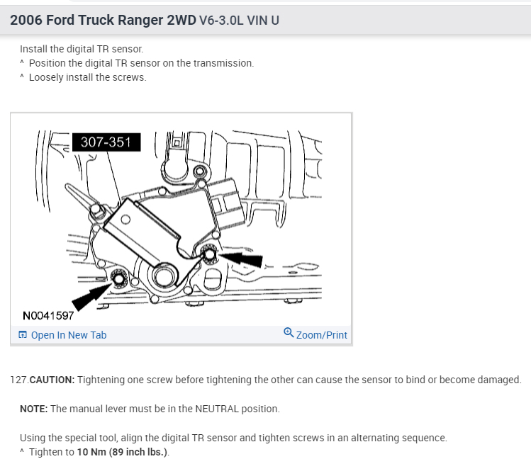

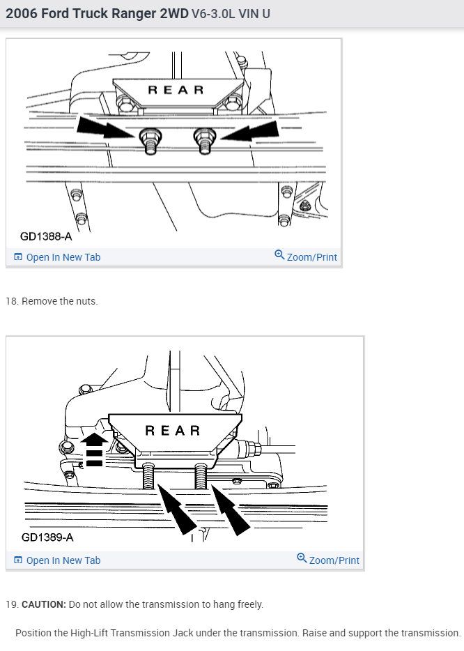

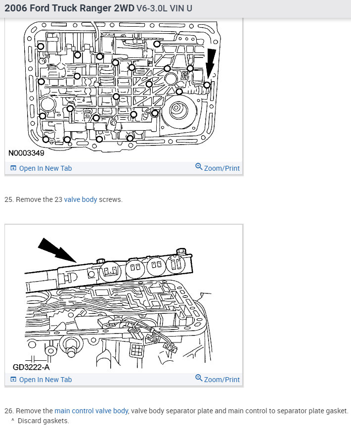

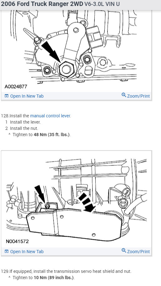

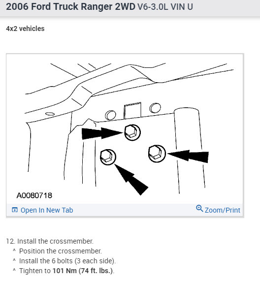

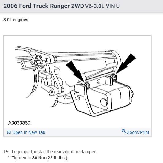

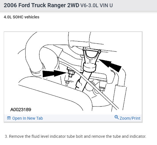

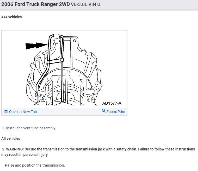

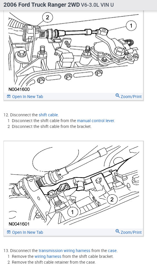

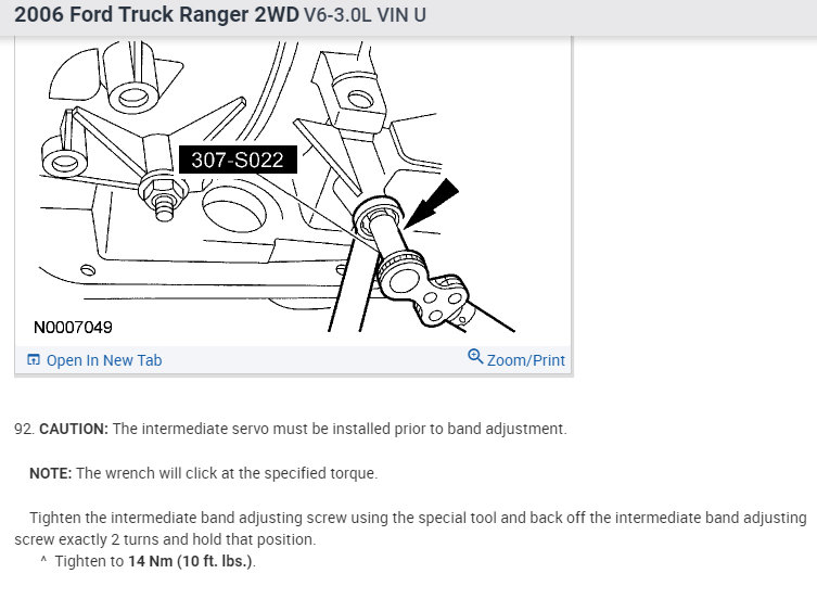

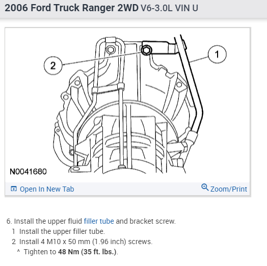

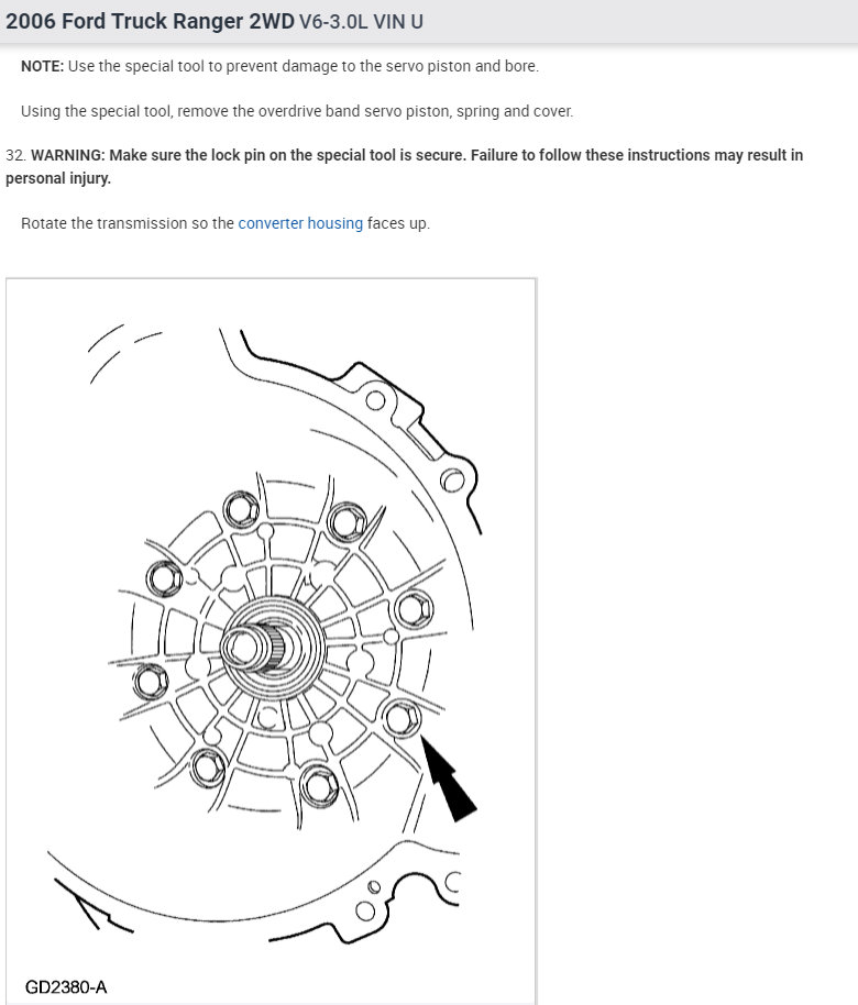

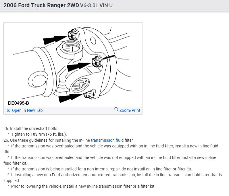

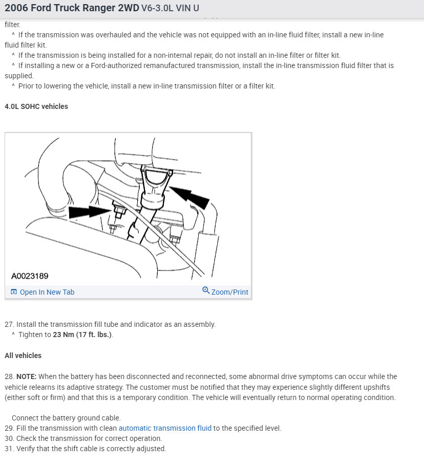

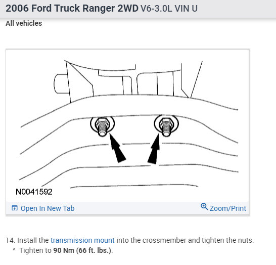

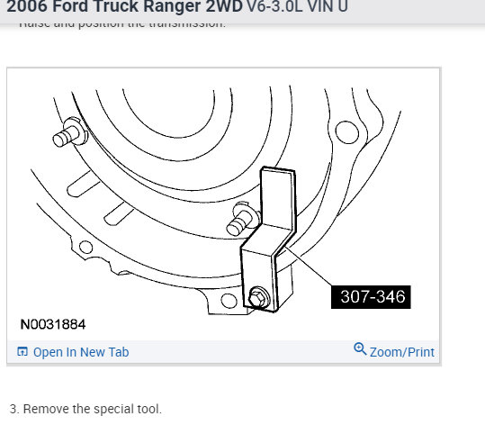

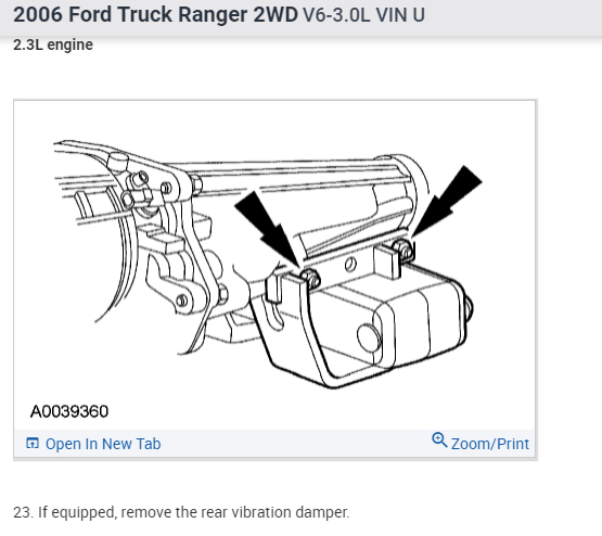

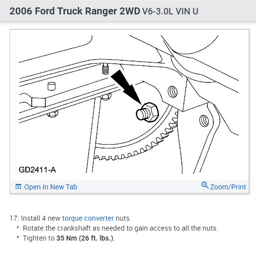

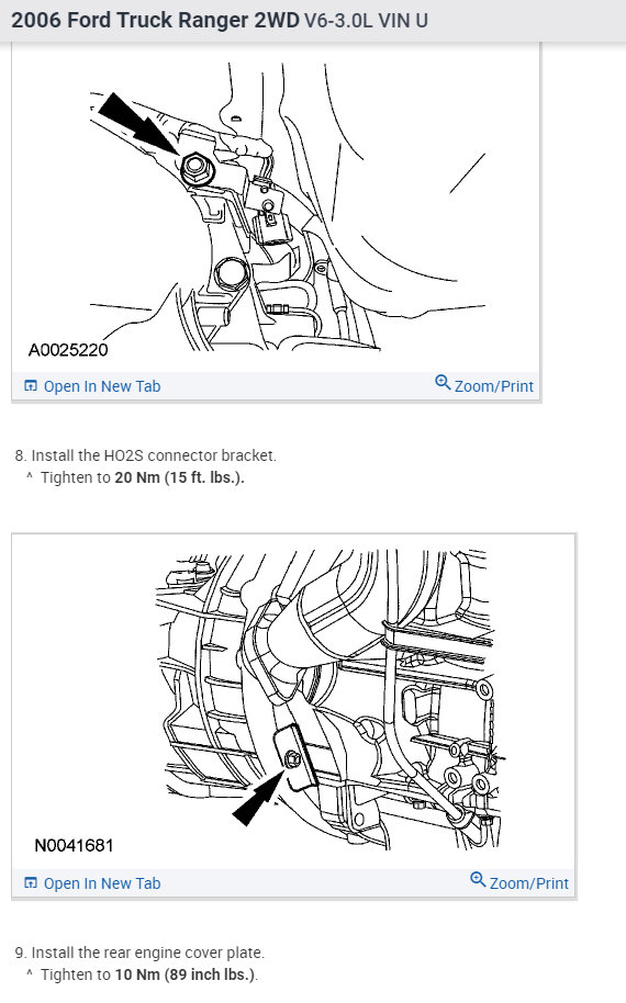

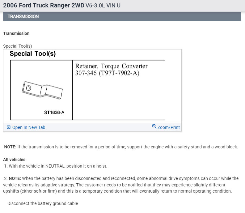

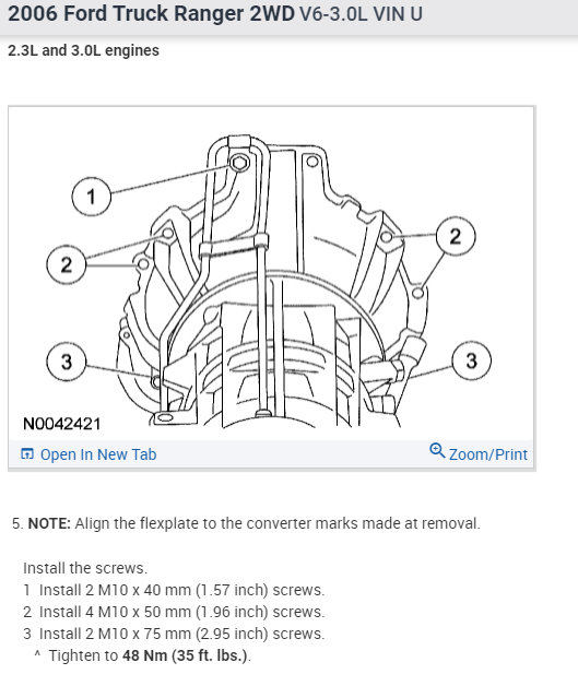

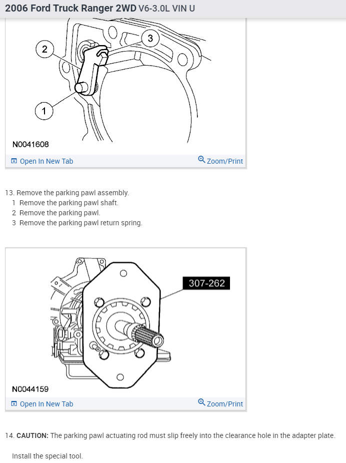

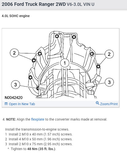

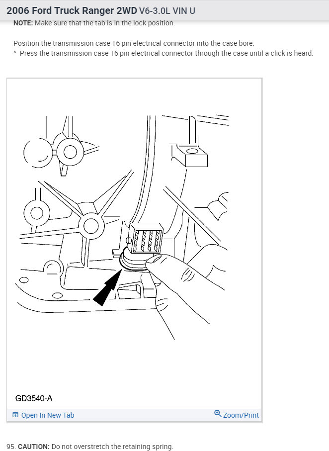

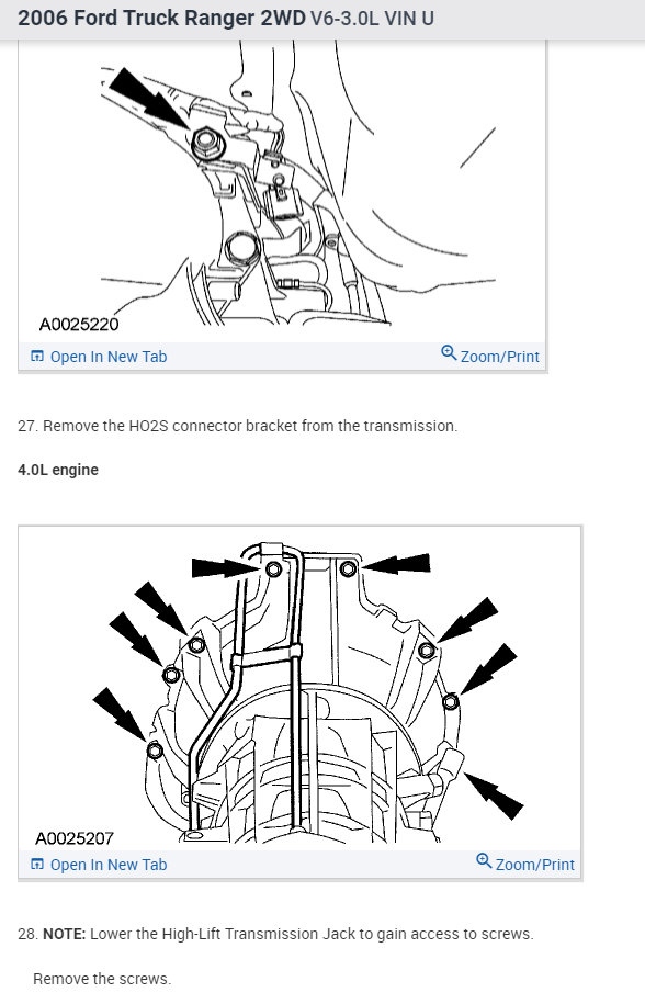

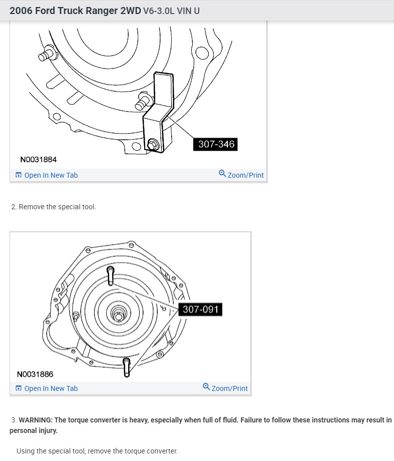

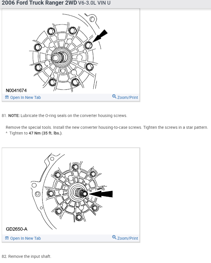

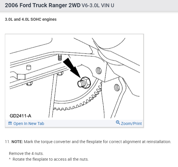

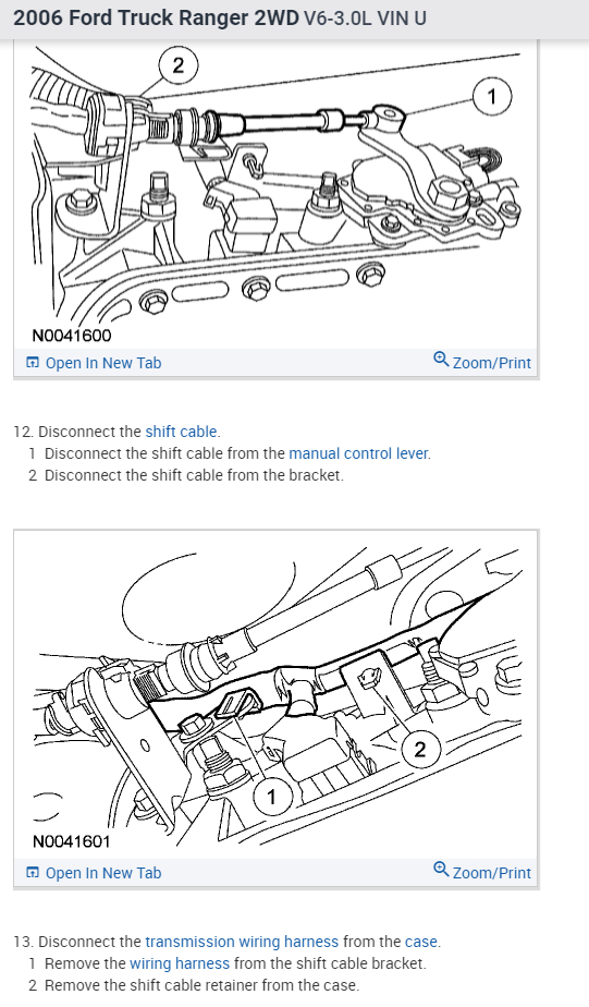

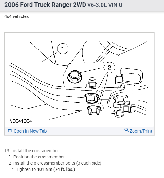

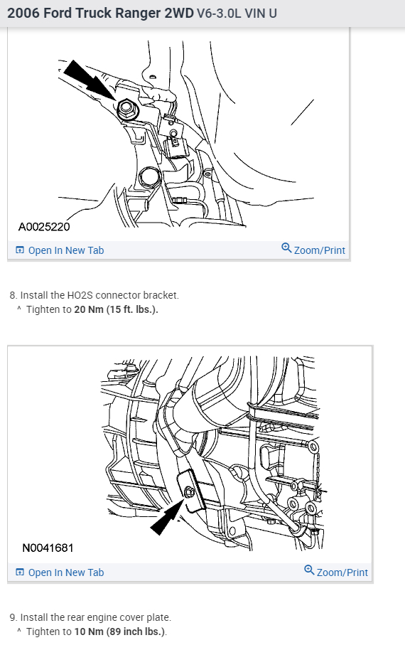

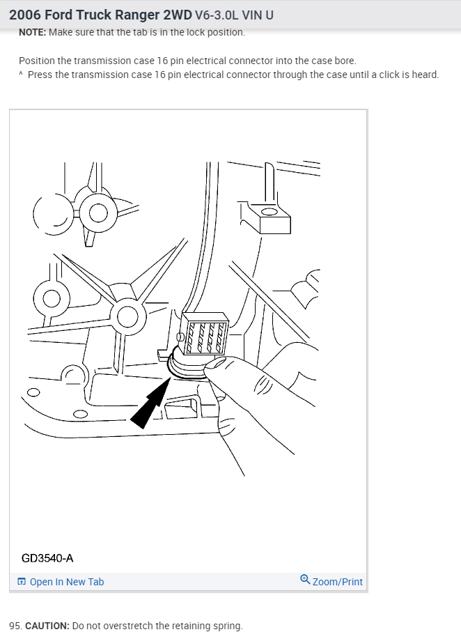

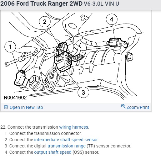

I have attached the transmission replace instructions below.
Please note some of the diagrams does not apply to your vehicle as they are for different engines (it will state clearly on the diagram for what engine and drivetrain).
https://www.2carpros.com/articles/how-to-remove-an-automatic-transmission-rwd
Oct 29, 2021 at 6:59 AM

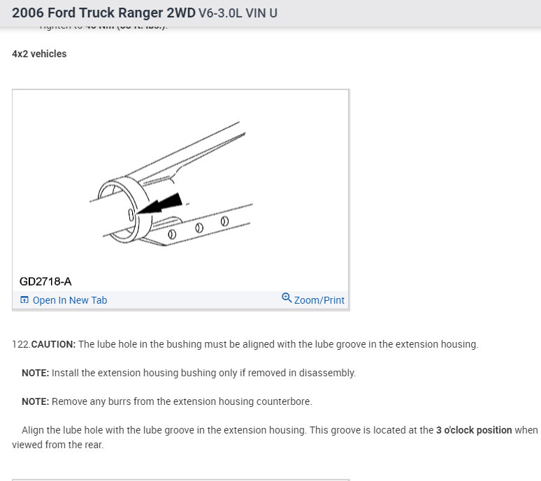

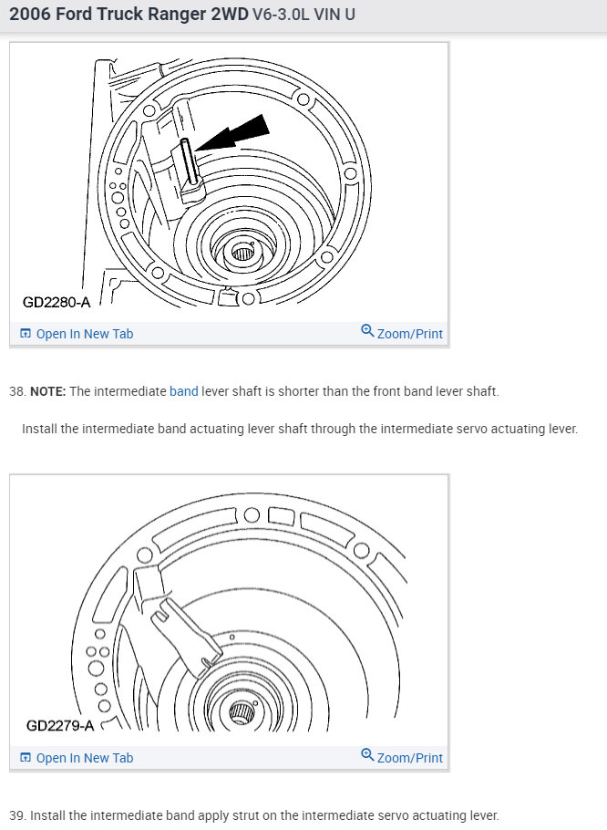

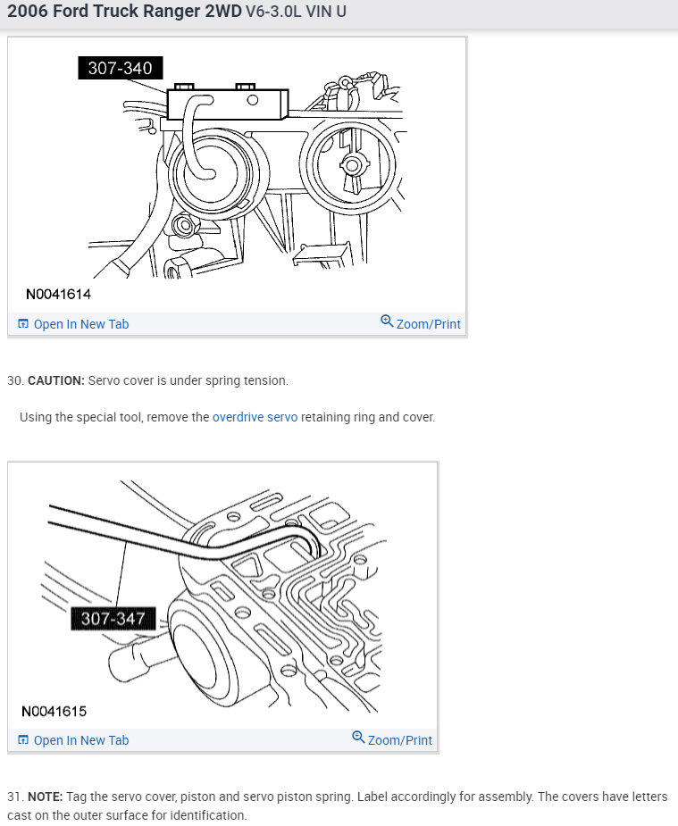

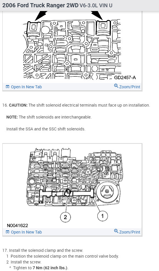

I got roughly about 40,000 miles out of the rebuild. Initially it started off with second gear incorrect ratio, so I just had it rebuilt. Got about 40,000 miles out of it and now I got a code for first 3rd and 4th gear incorrect ratio. I don't know if it's overheating or what, but it's got a brand-new transmission cooler on it. So I'm going to do a swap and cheap the transmission that's in it right now and I'm going to buy a rebuild kit and try to rebuild that would you happen to have any instructions on rebuilding one also and like I said I was just looking for recommendations on what I can do to make it last longer. I appreciate your quick replies as I'm fixing to start doing this in about an hour.
Oct 29, 2021 at 8:06 AM
SQM
  • 6,383 POSTS

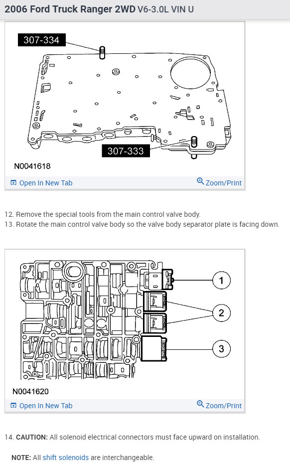

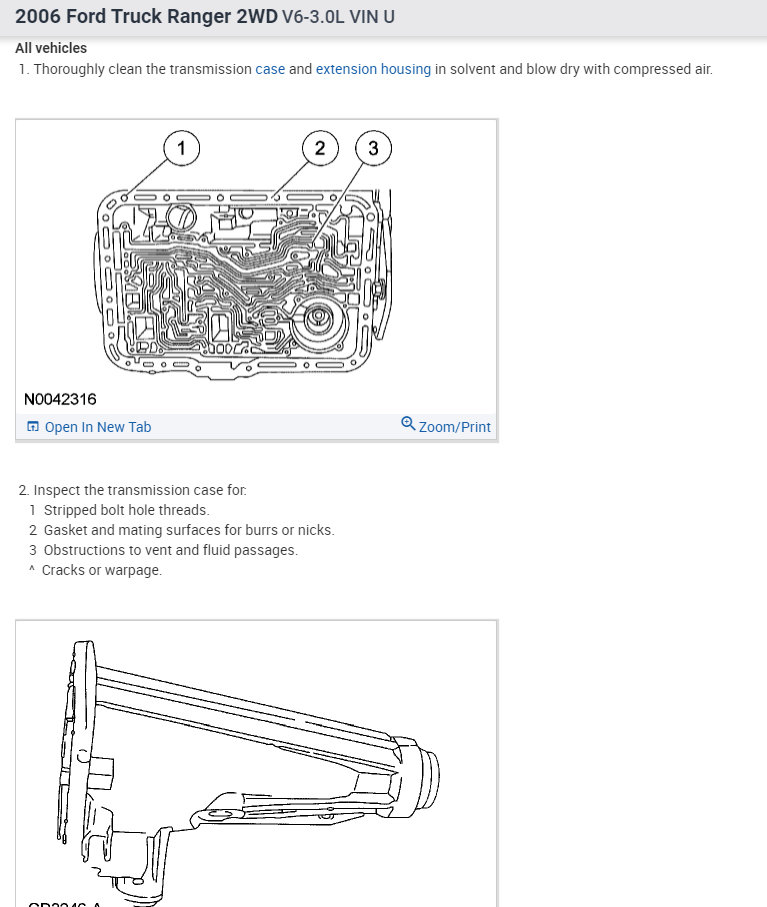

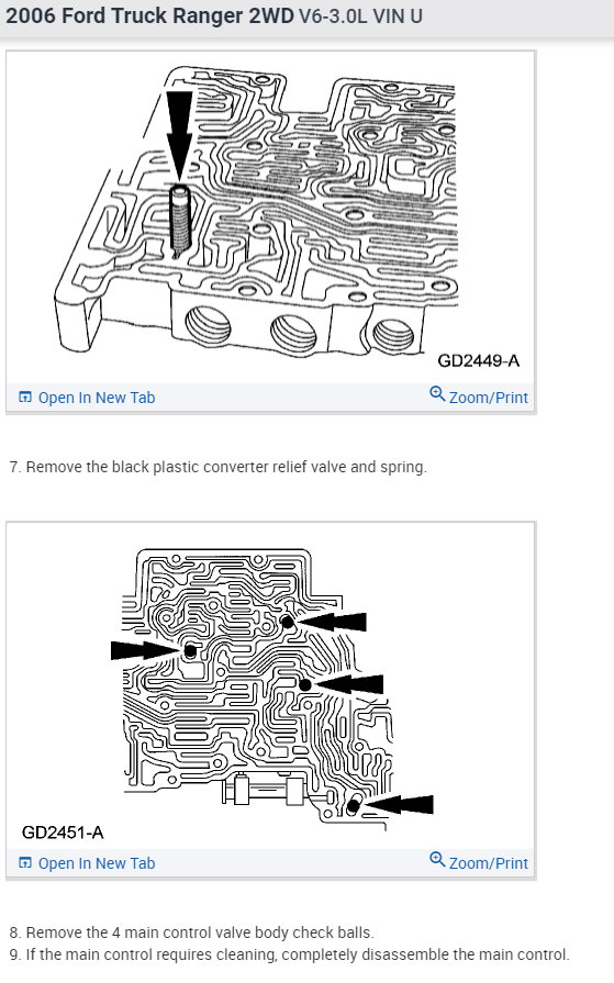

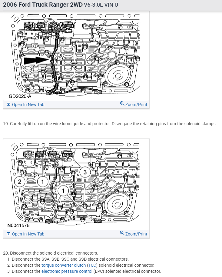

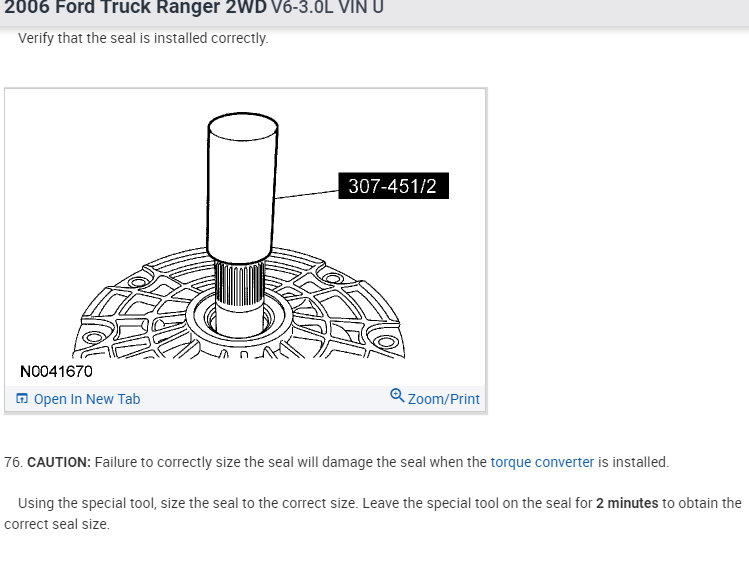

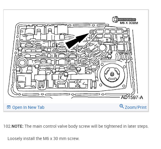

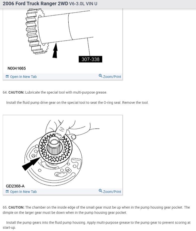

An extra cooler does help if you drive a lot of miles or do towing/hauling.

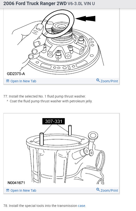

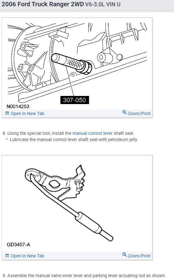

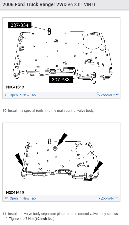

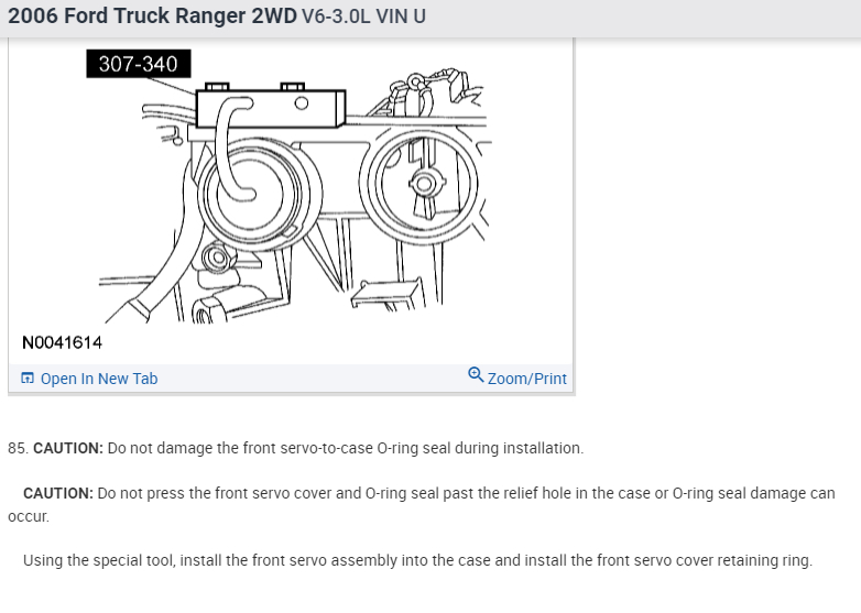

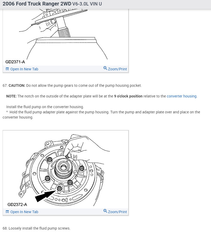

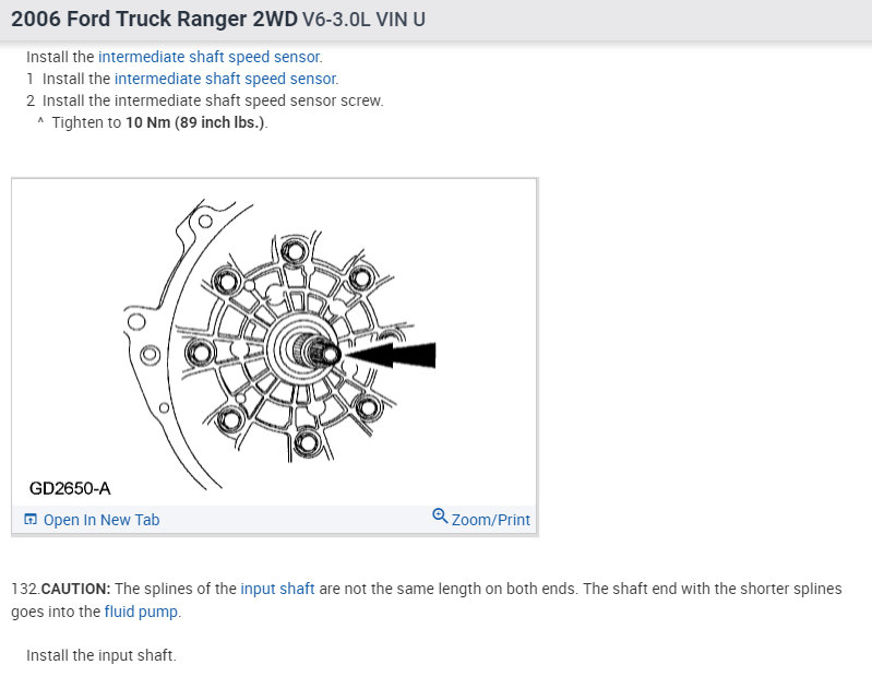

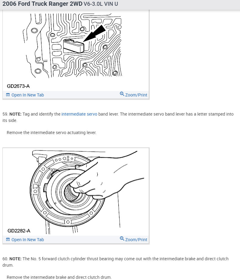

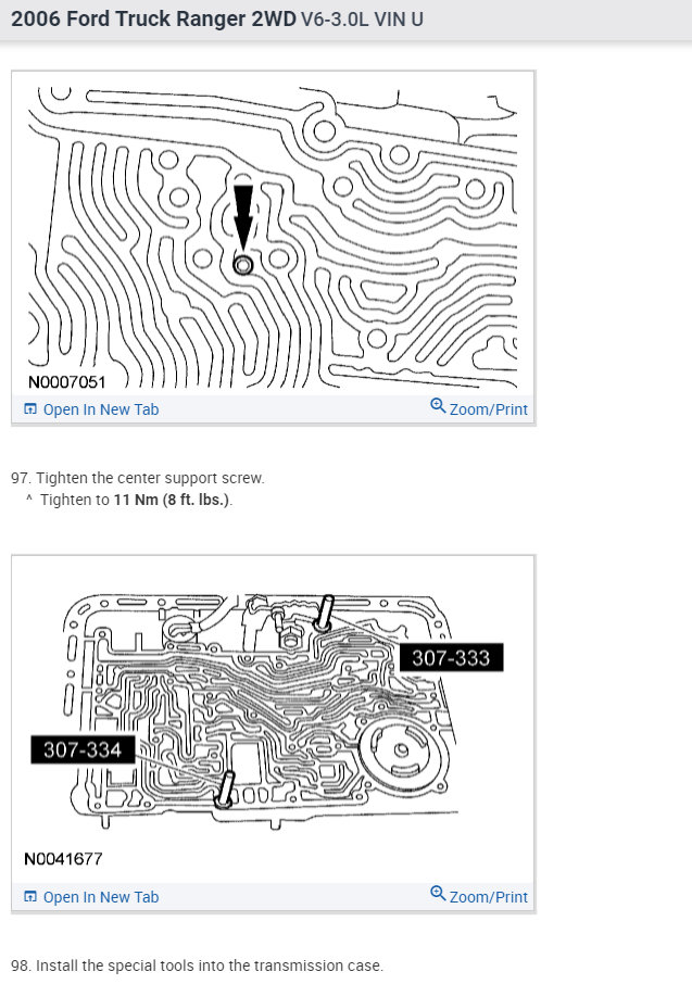

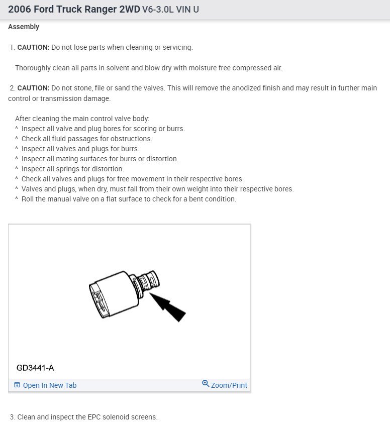

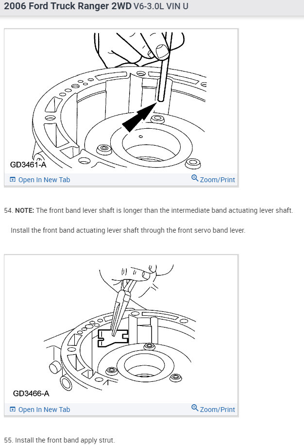

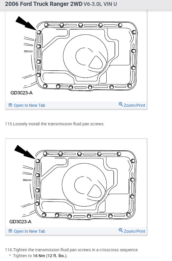

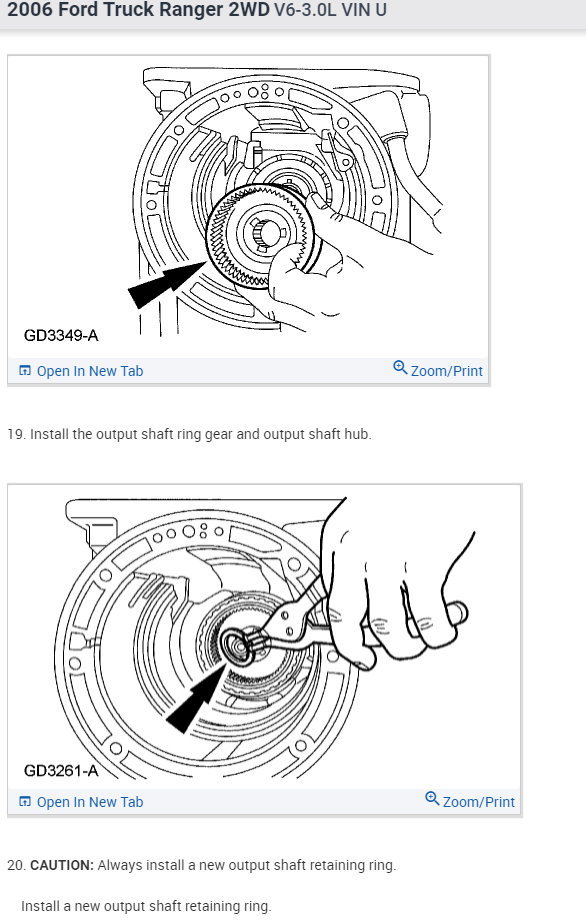

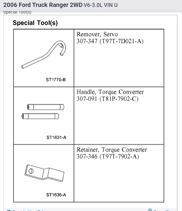

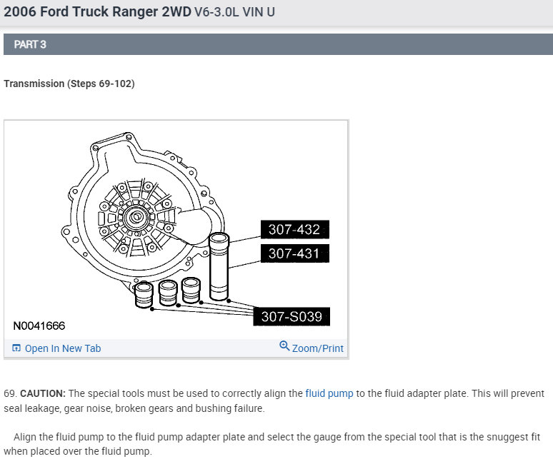

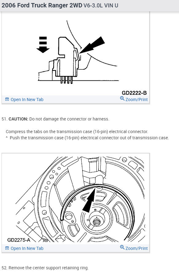

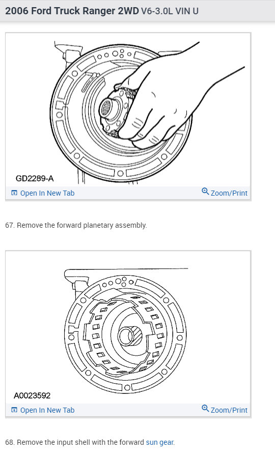

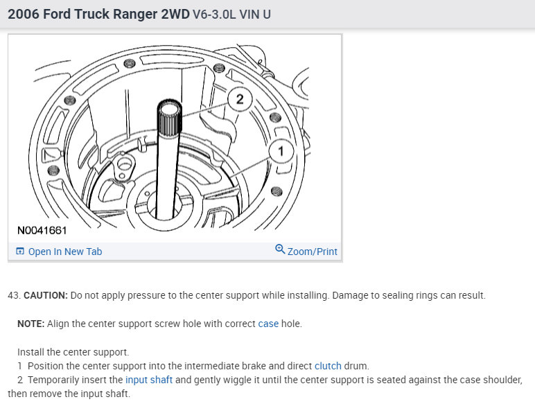

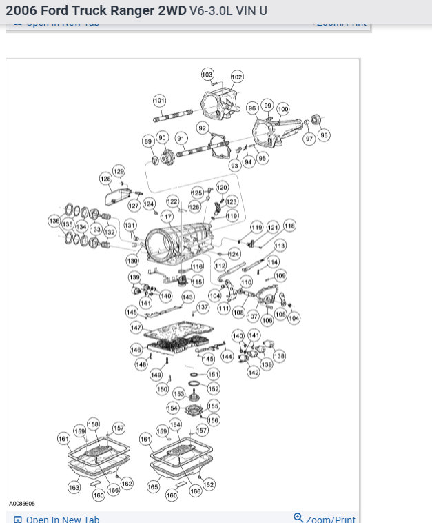

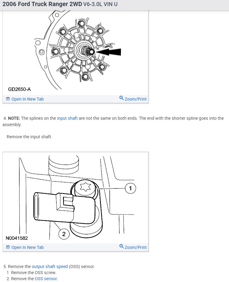

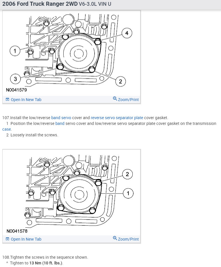

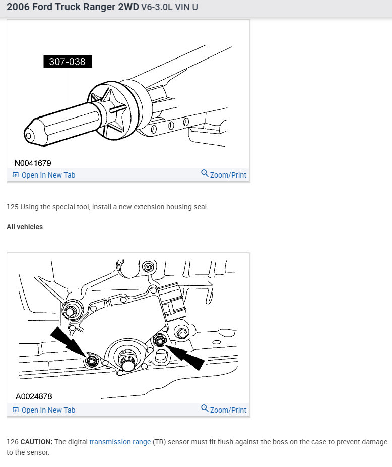

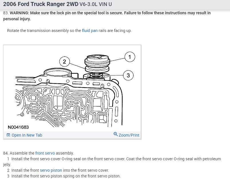

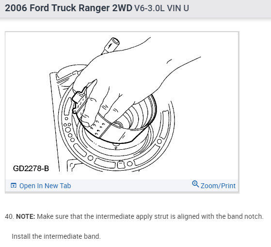

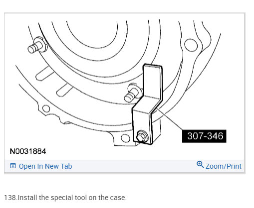

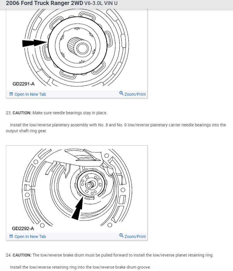

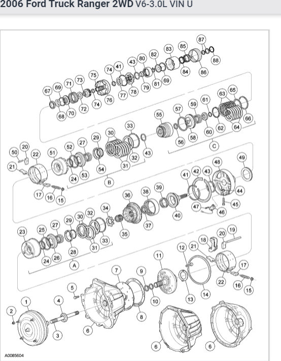

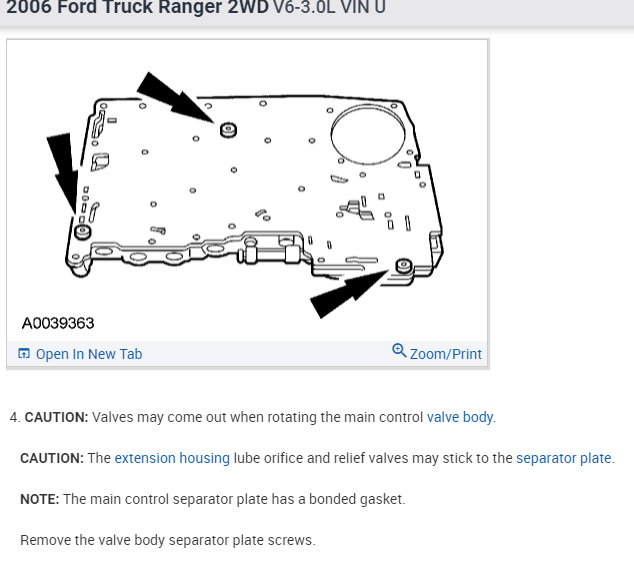

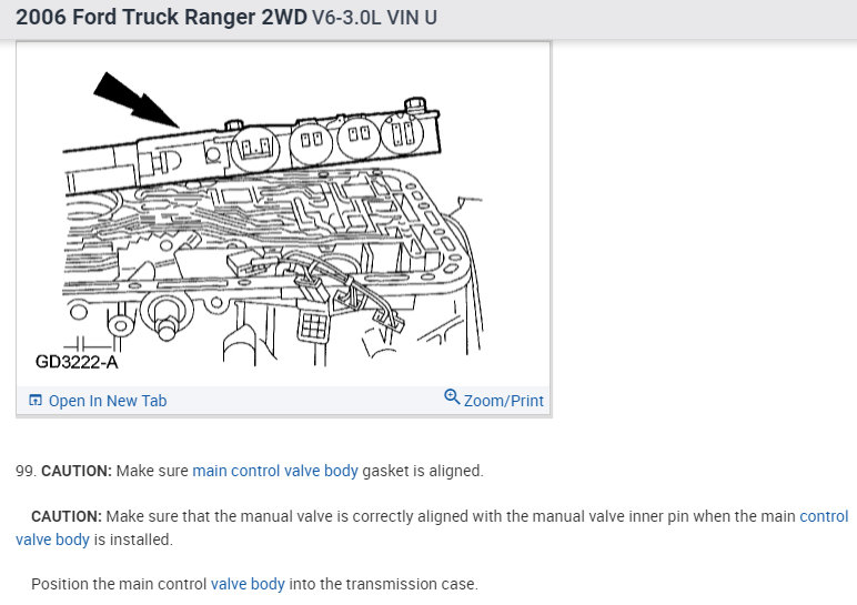

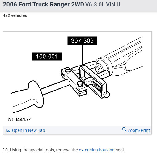

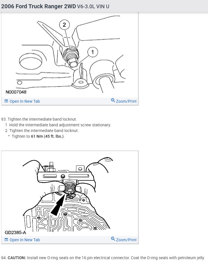

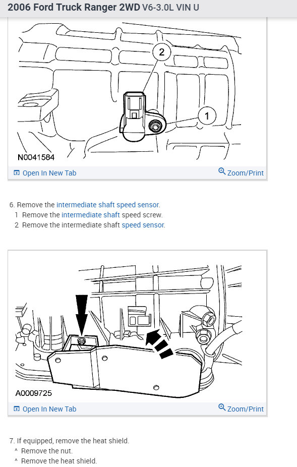

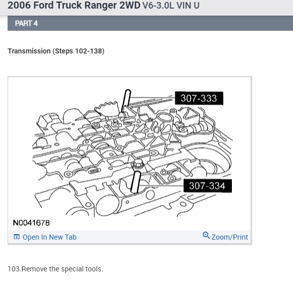

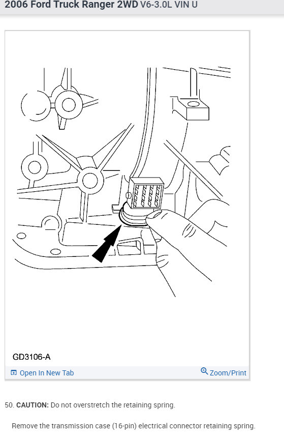

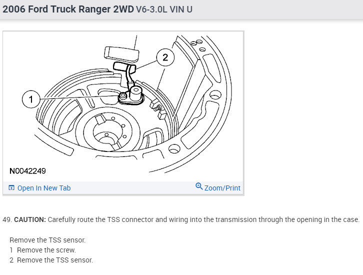

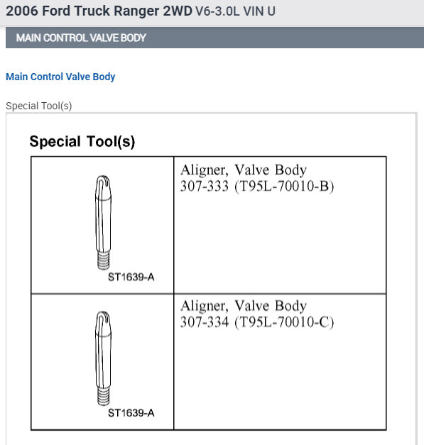

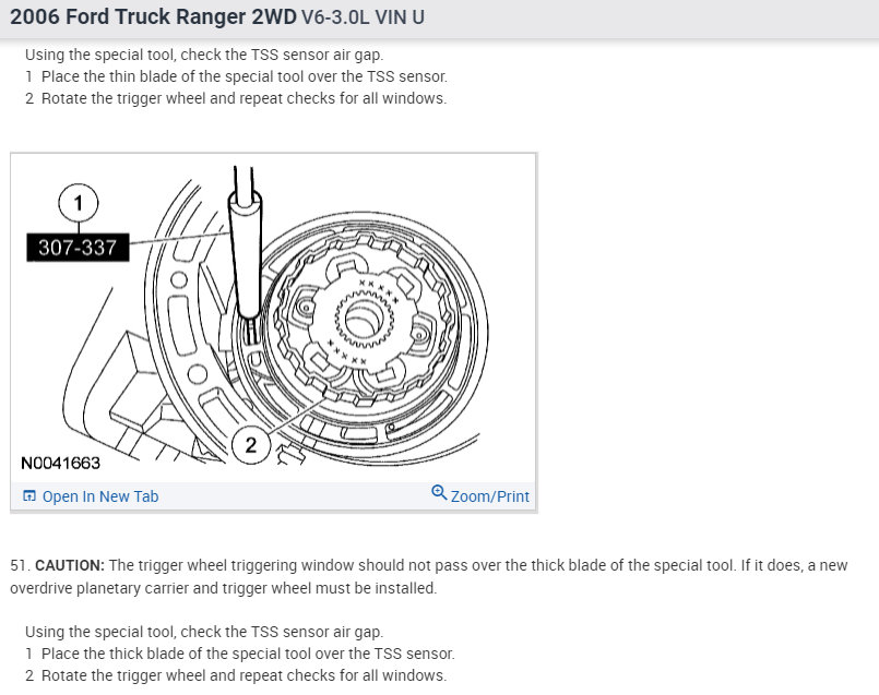

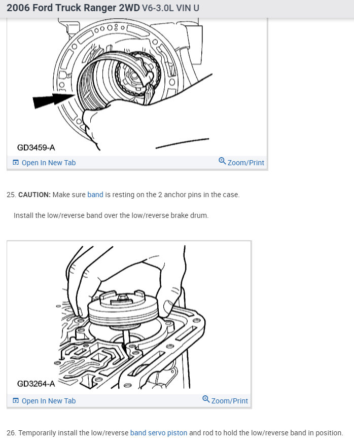

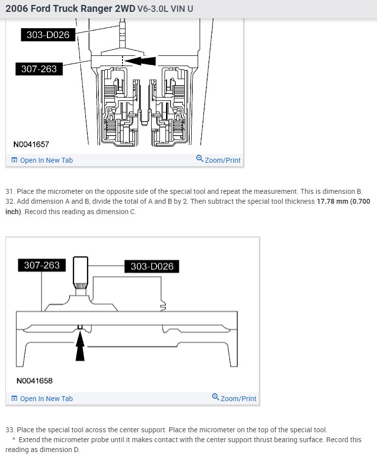

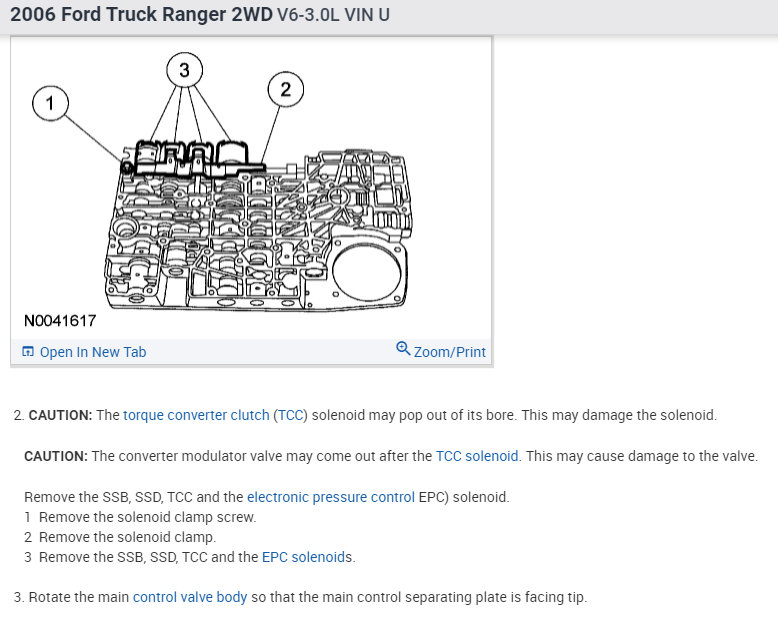

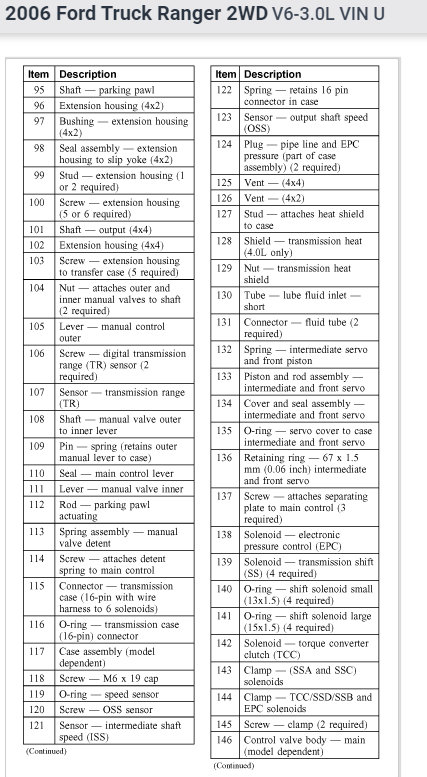

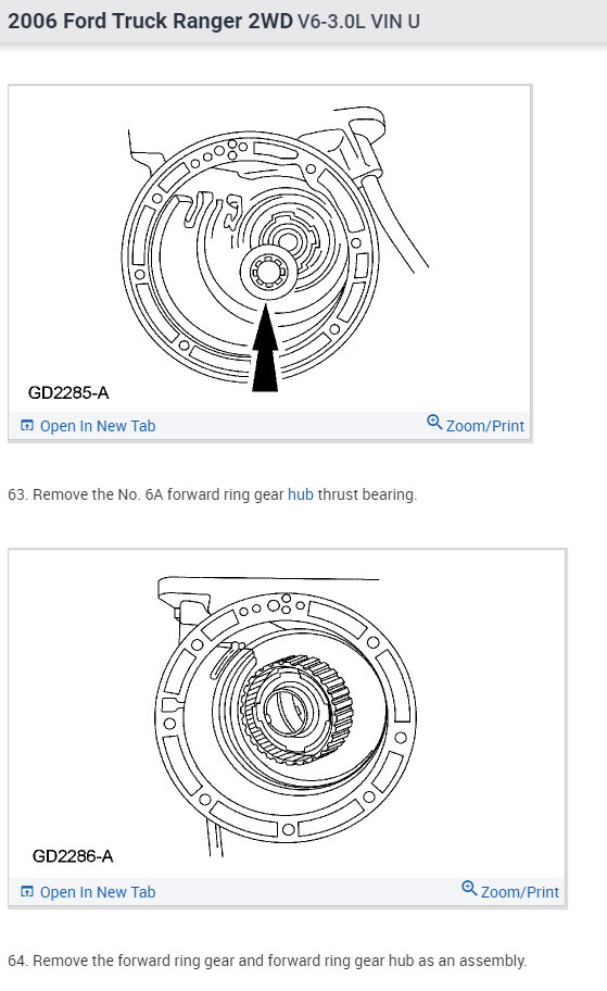

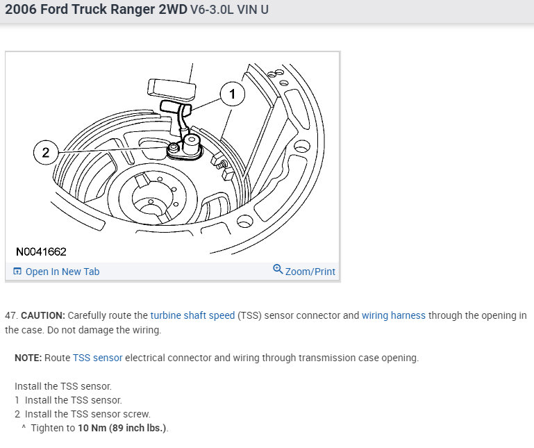

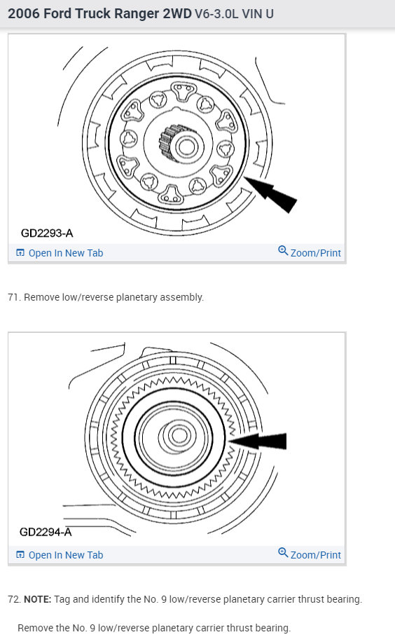

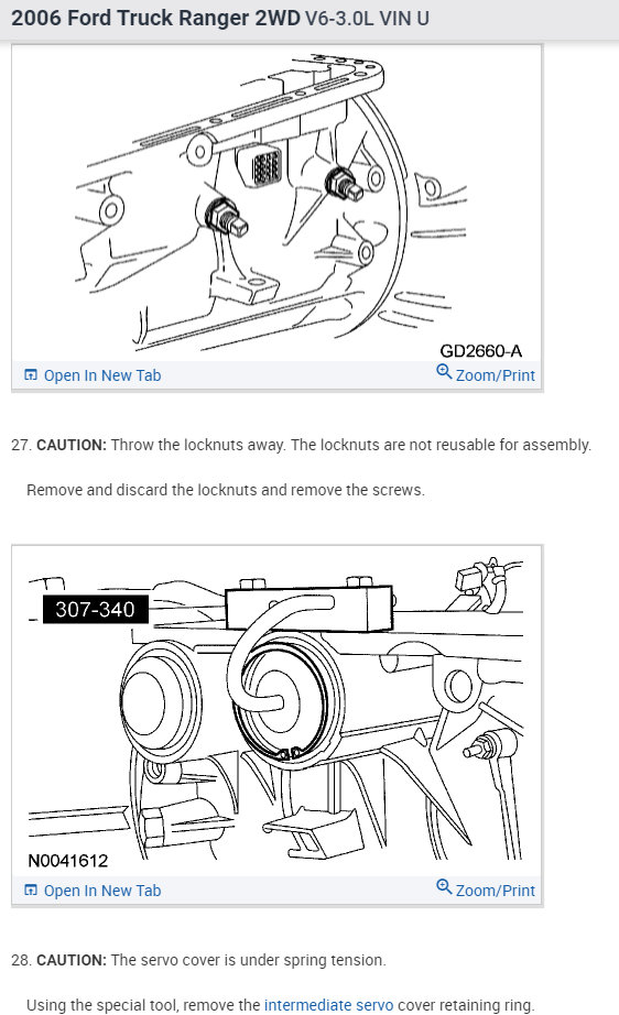

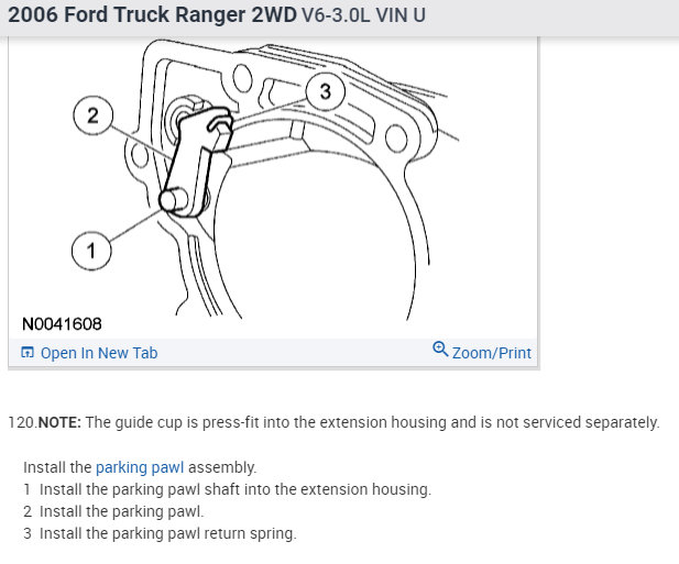

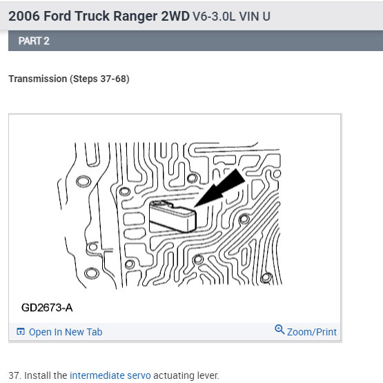

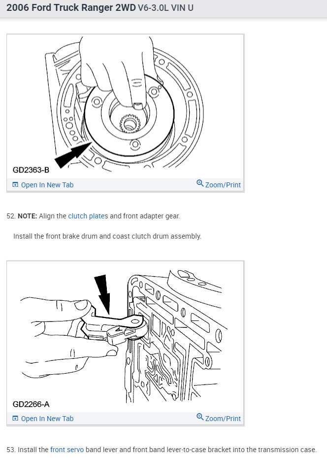

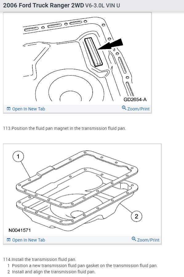

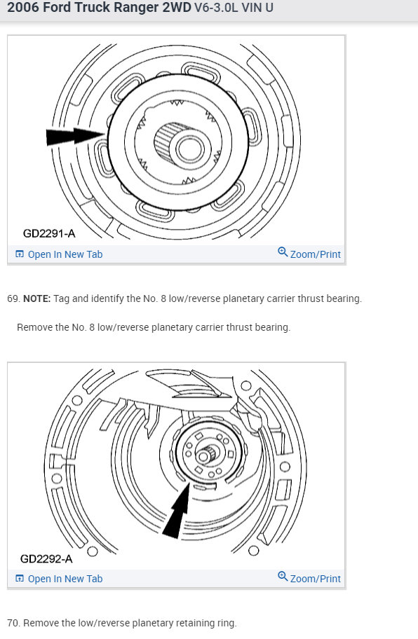

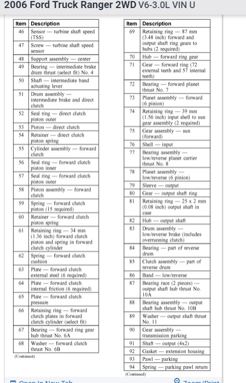

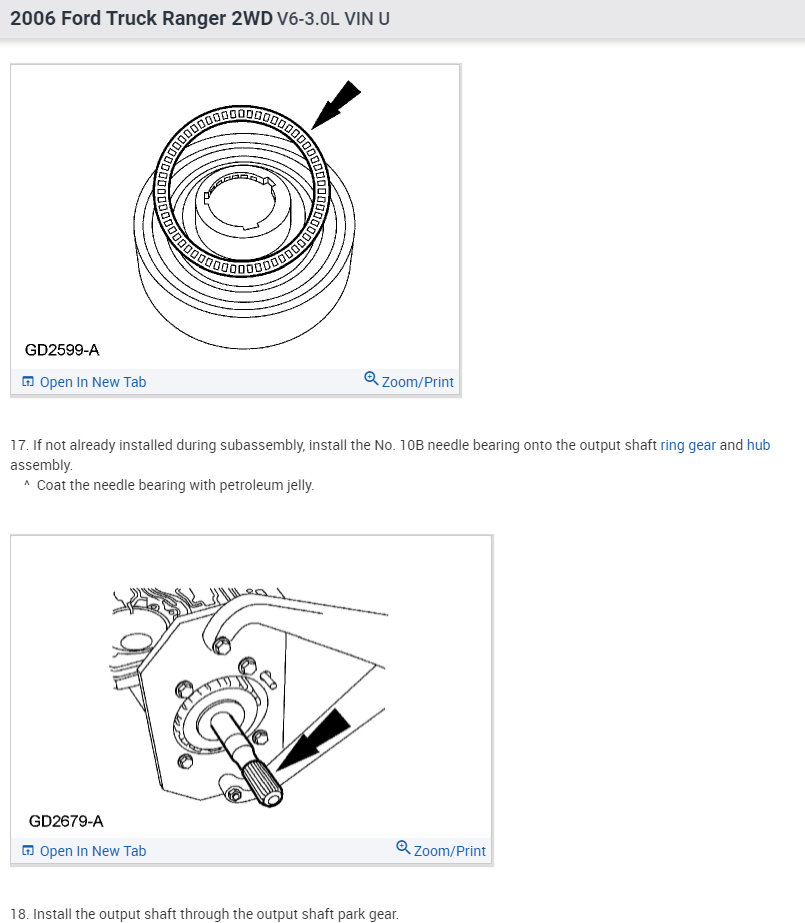

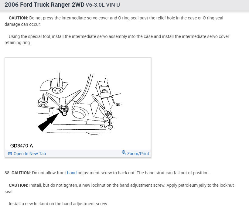

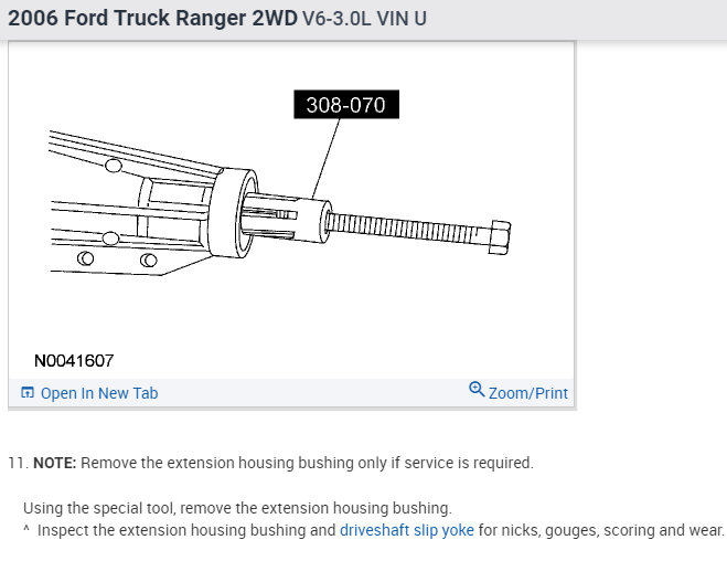

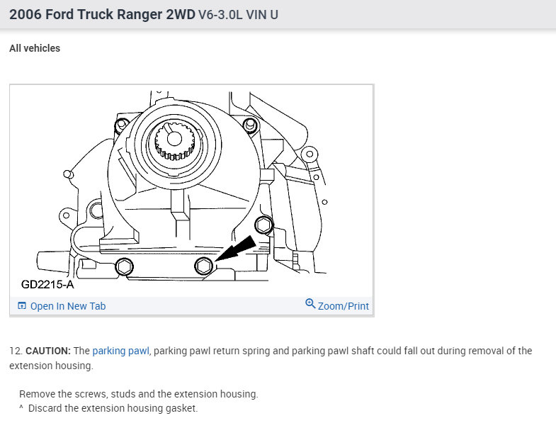

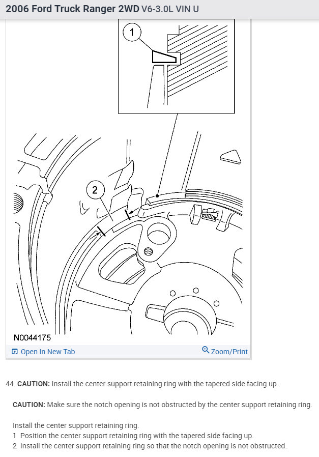

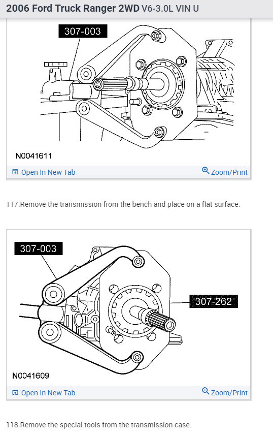

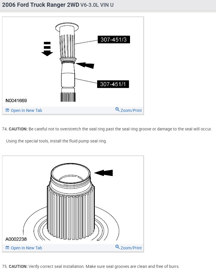

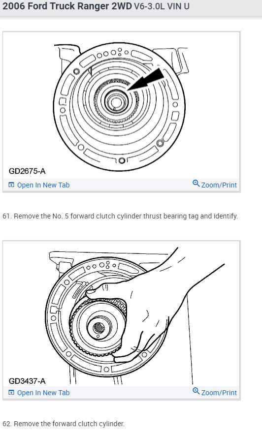

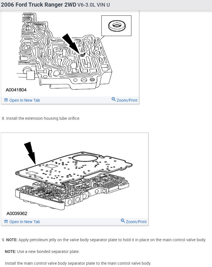

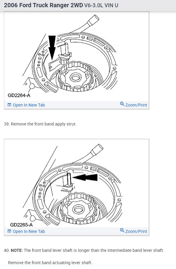

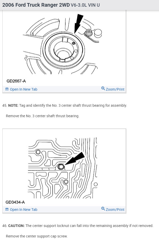

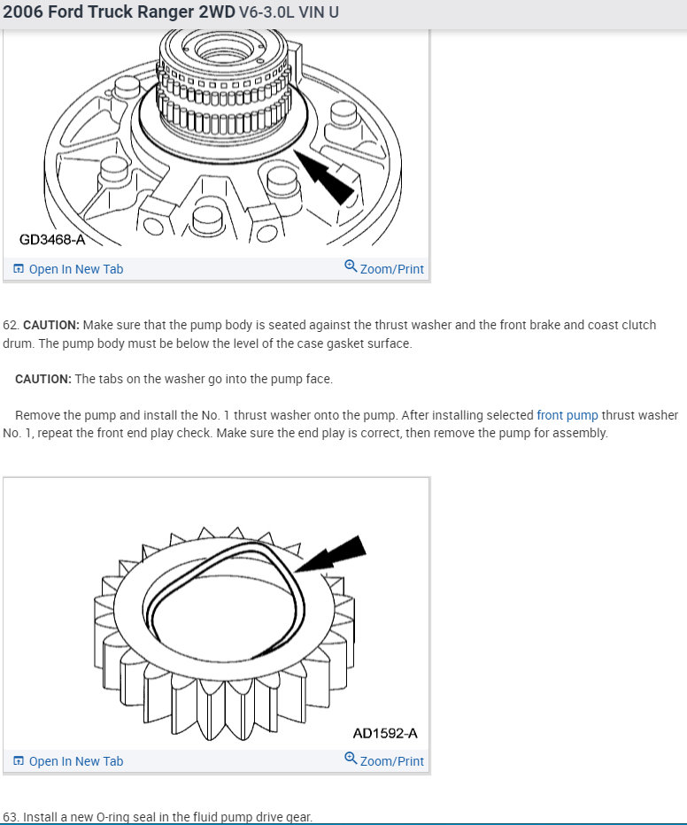

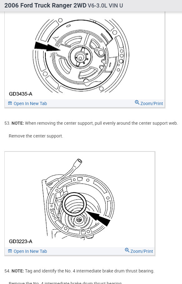

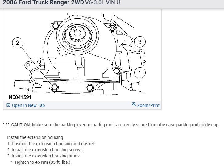

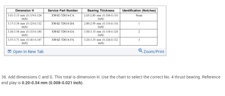

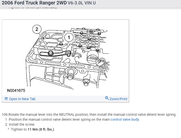

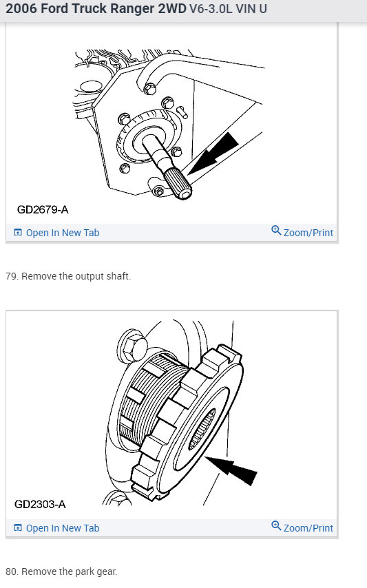

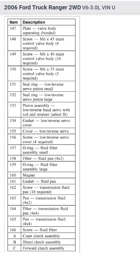

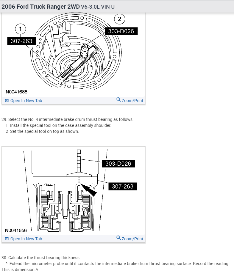

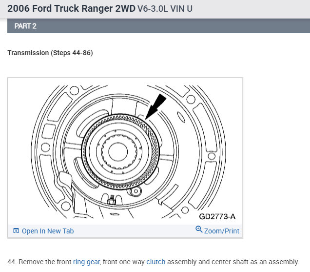

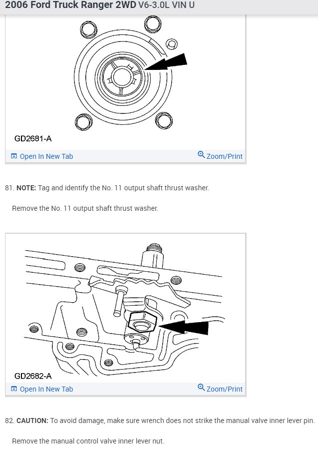

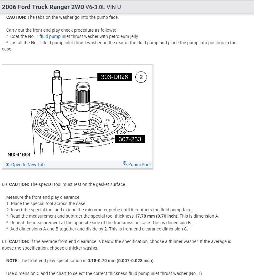

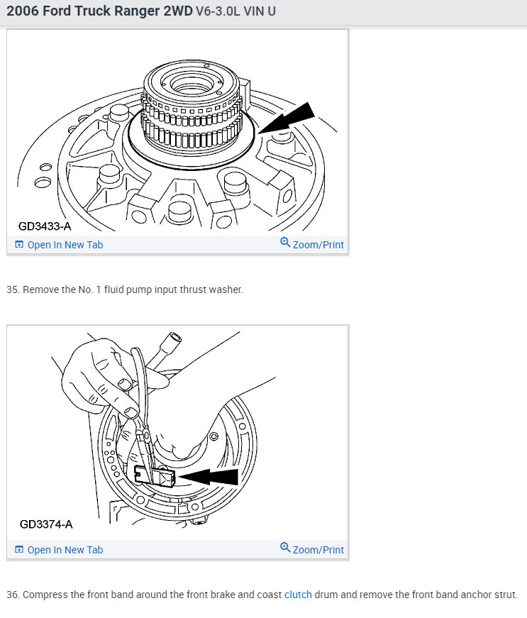

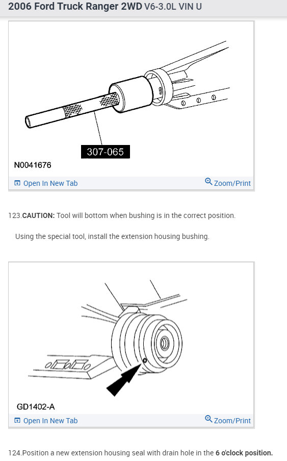

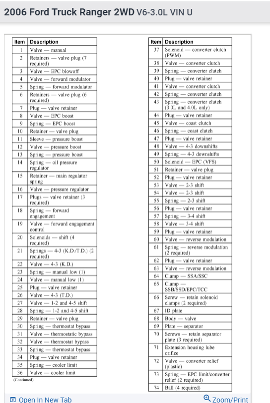

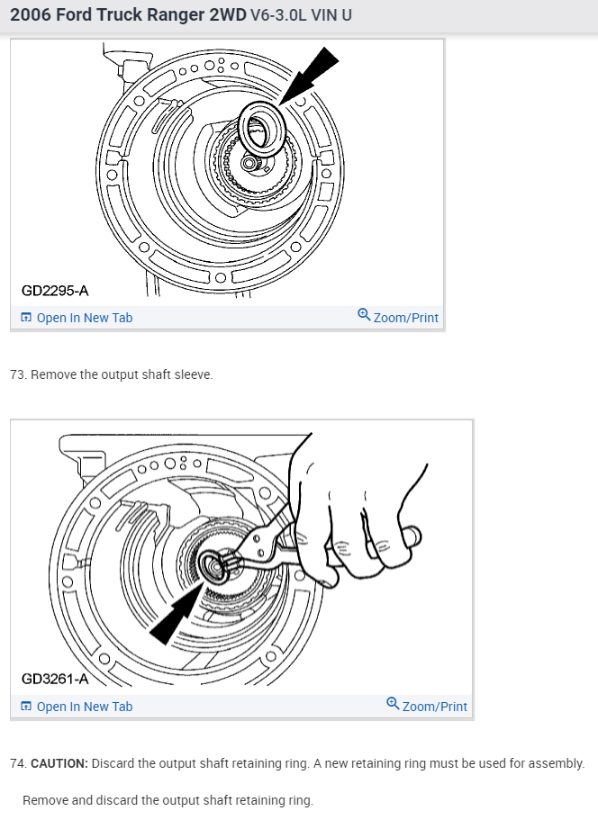

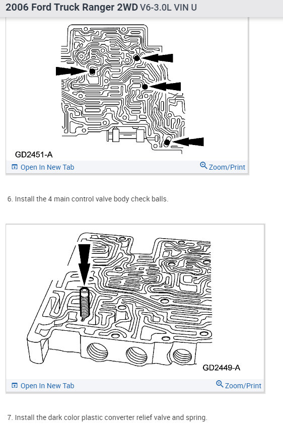

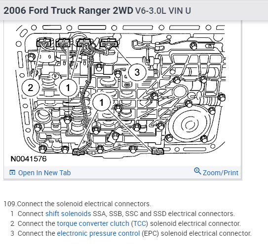

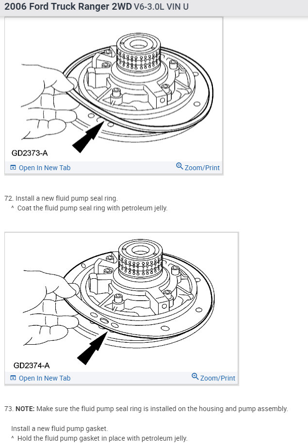

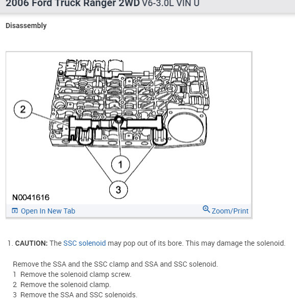

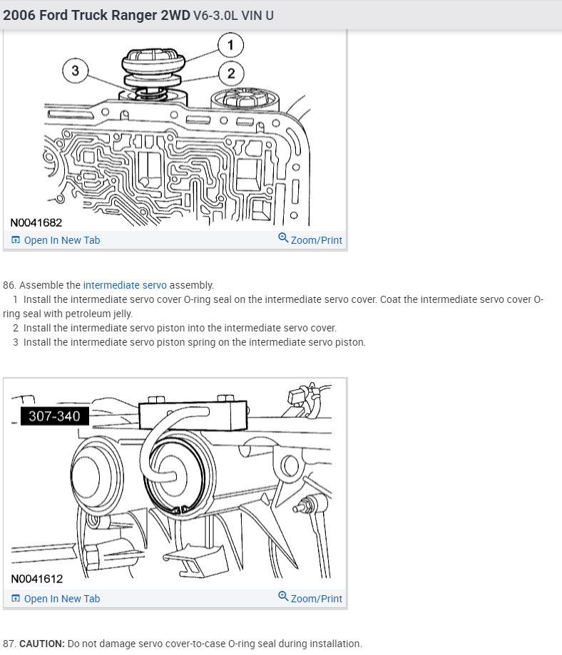

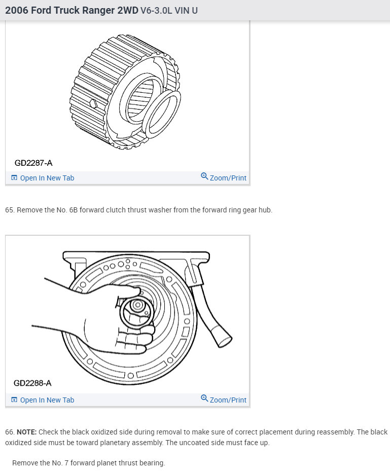

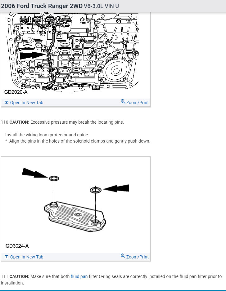

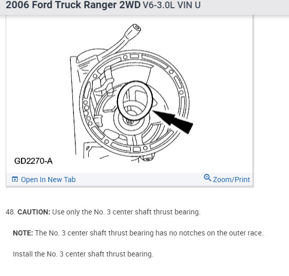

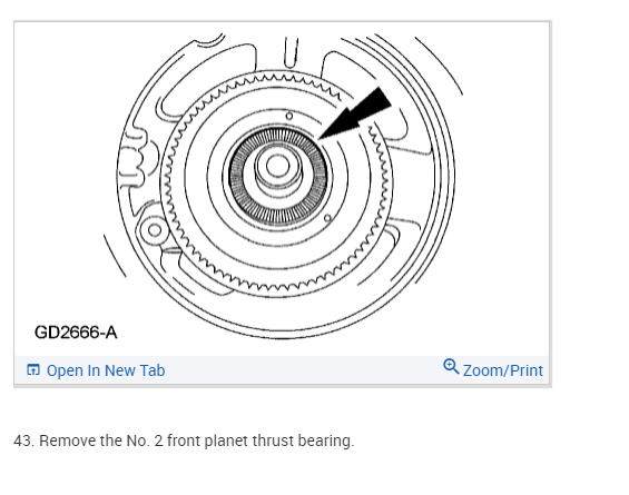

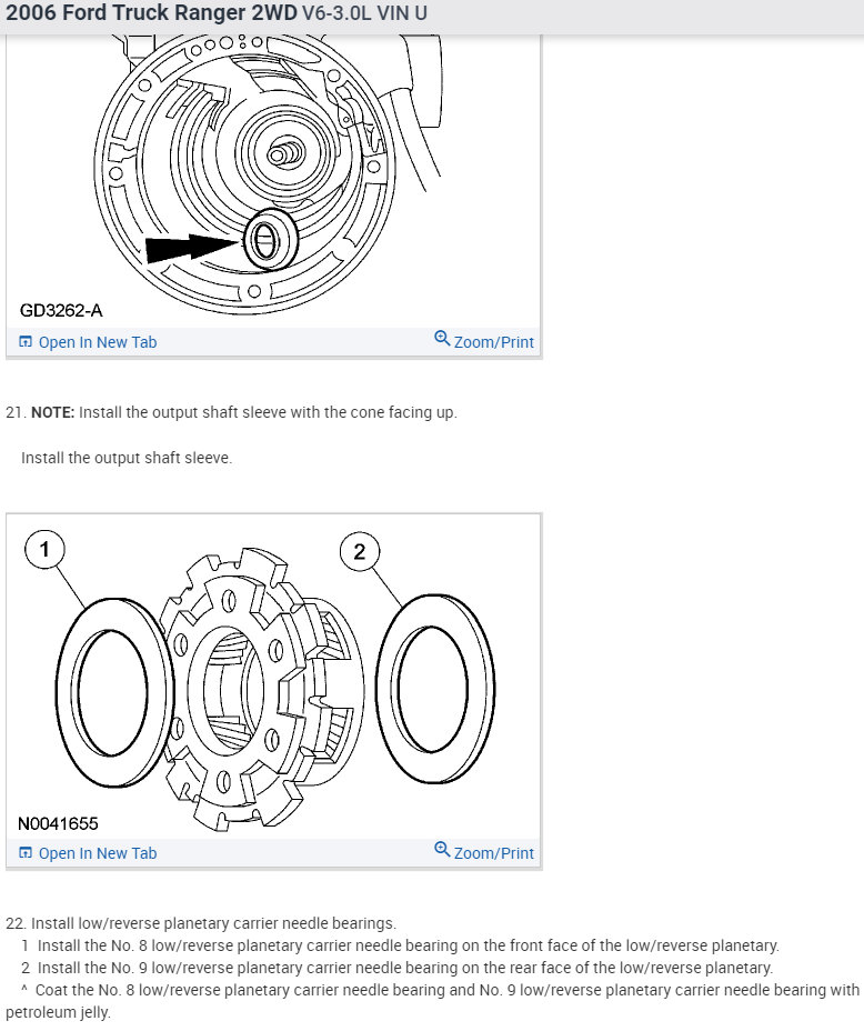

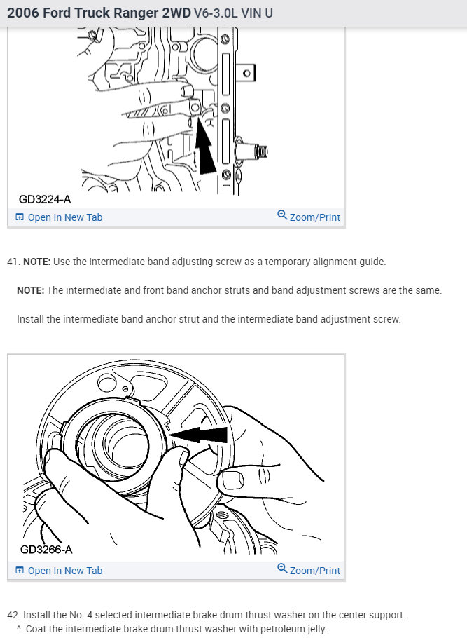

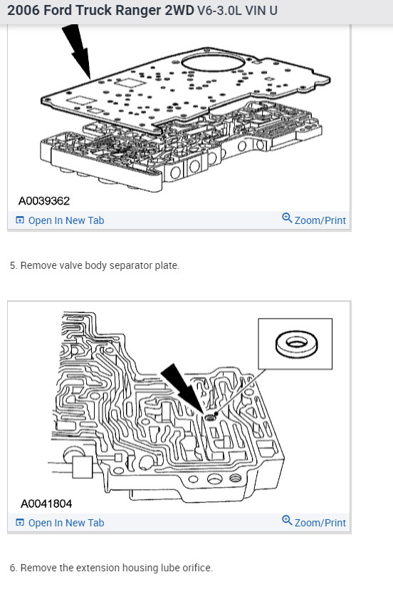

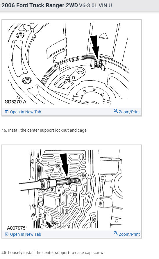

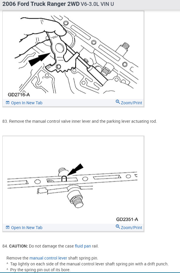

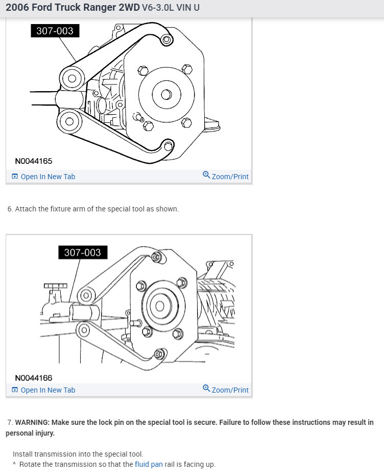

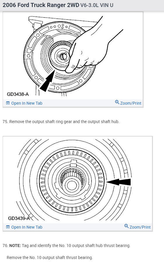

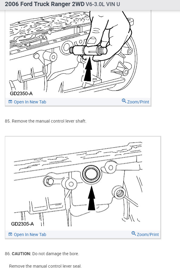

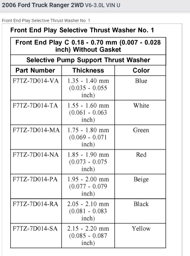

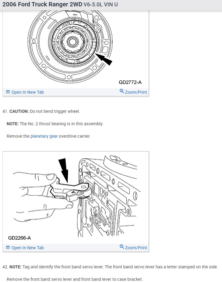

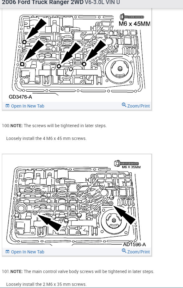

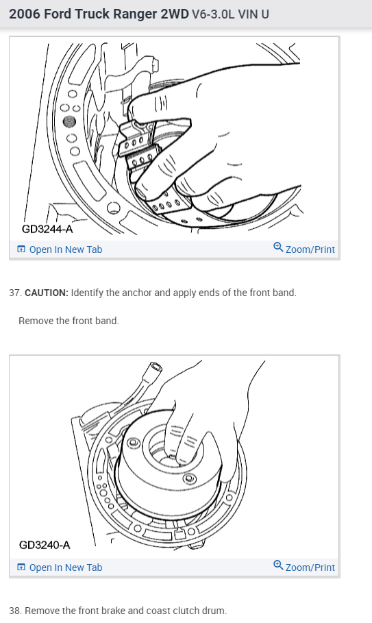

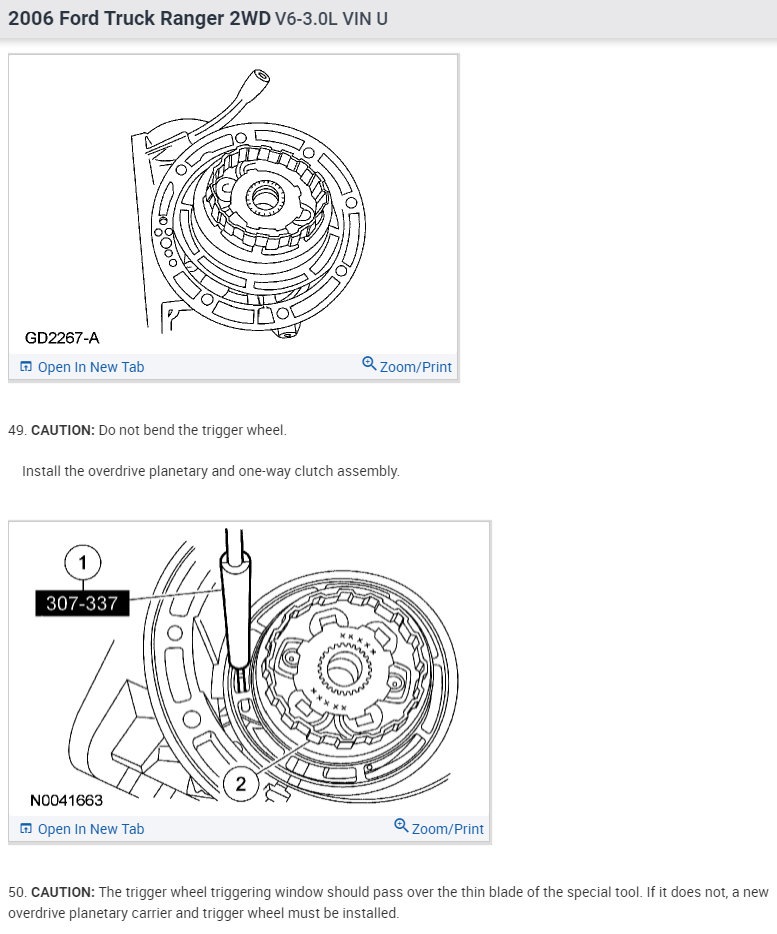

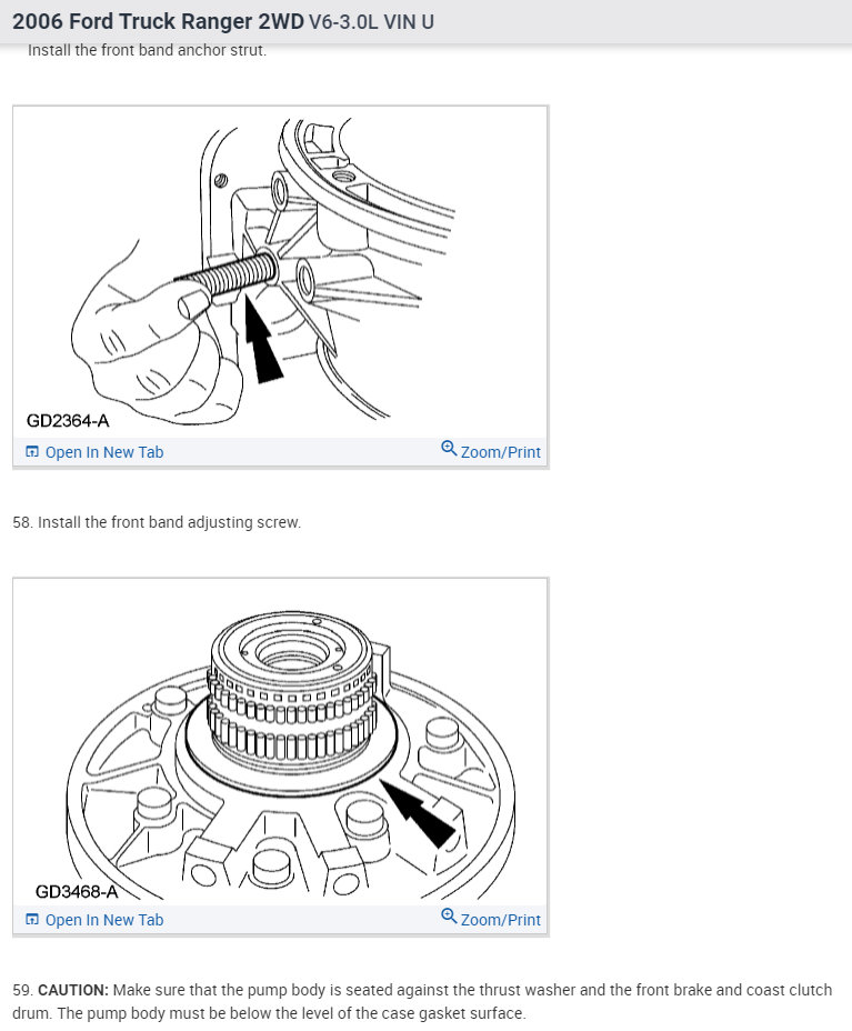

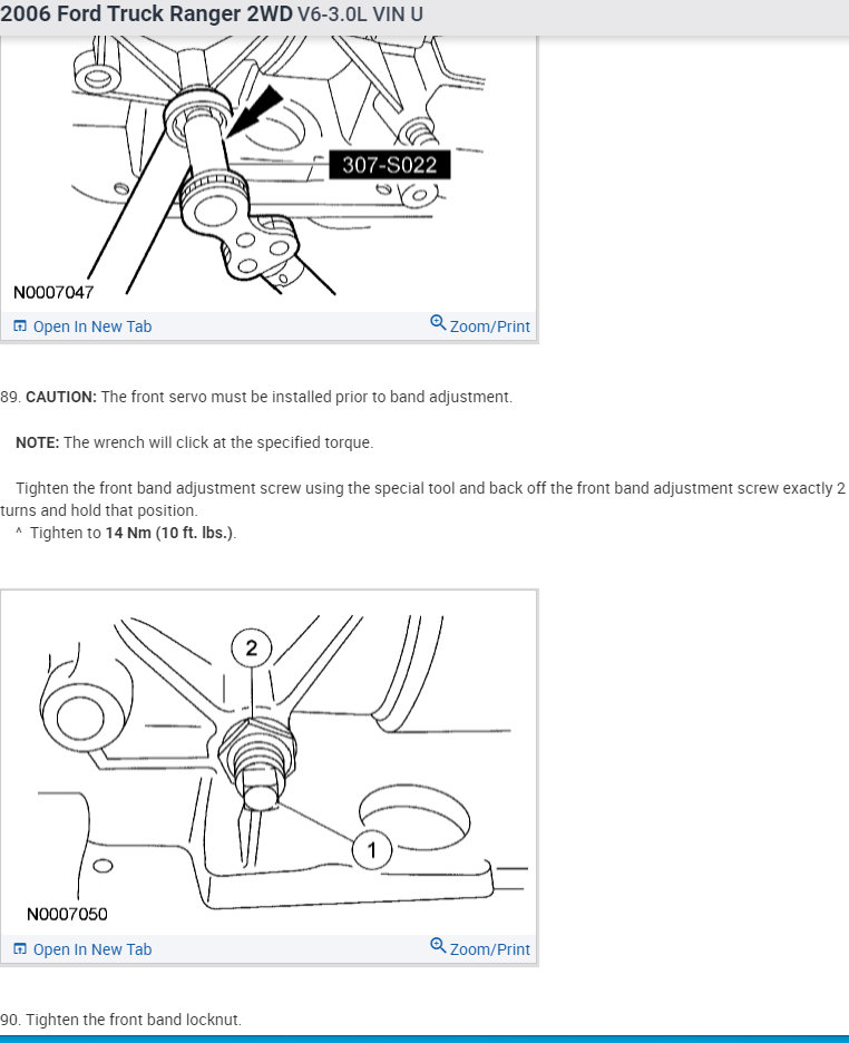

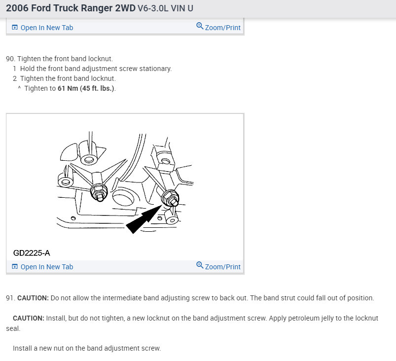

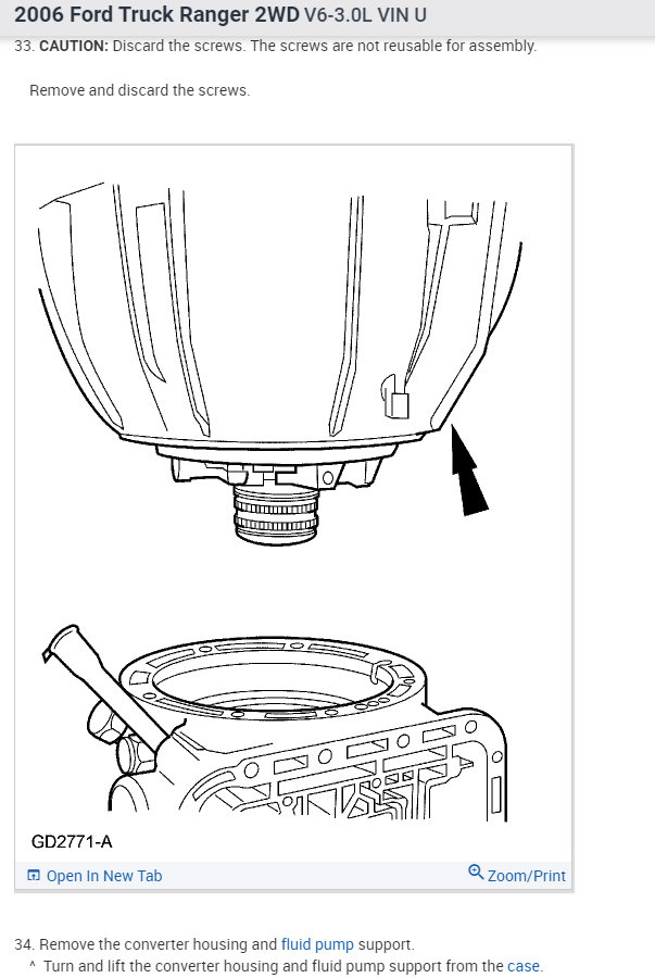

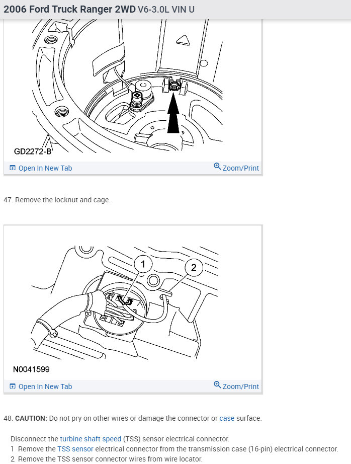

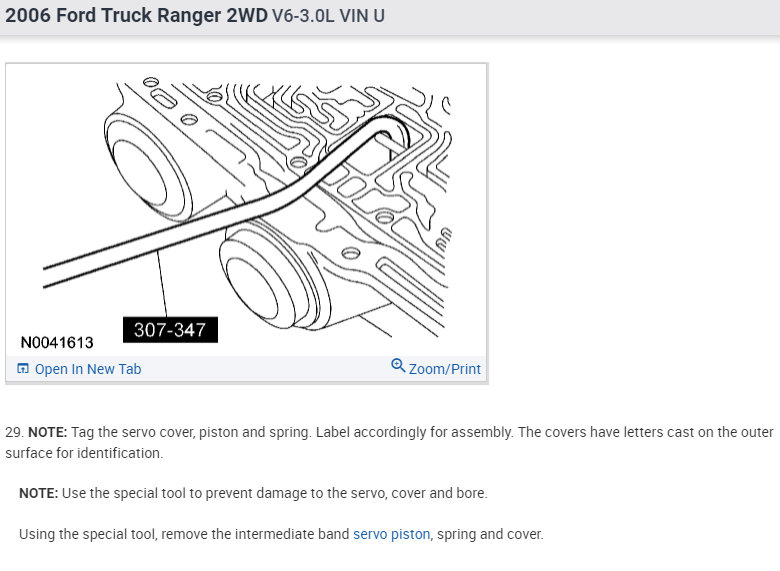

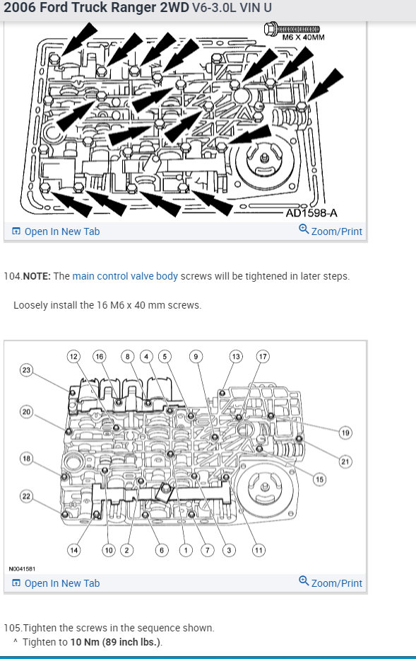

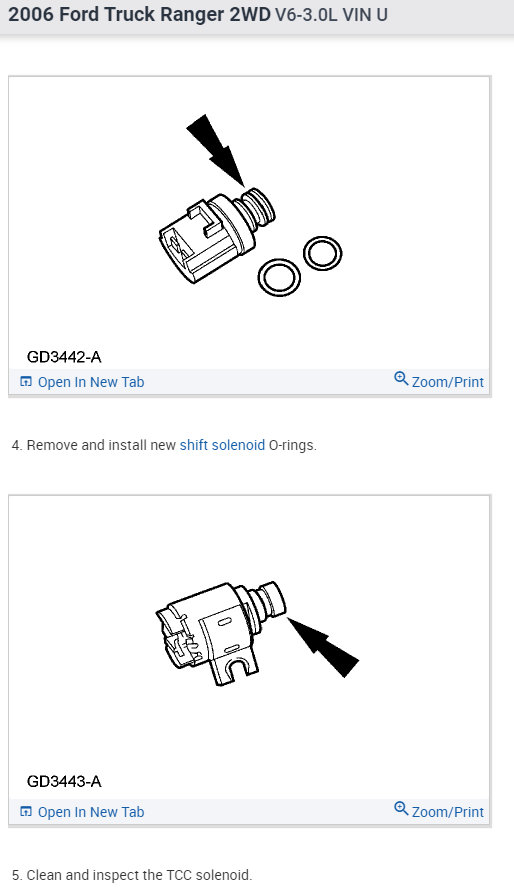

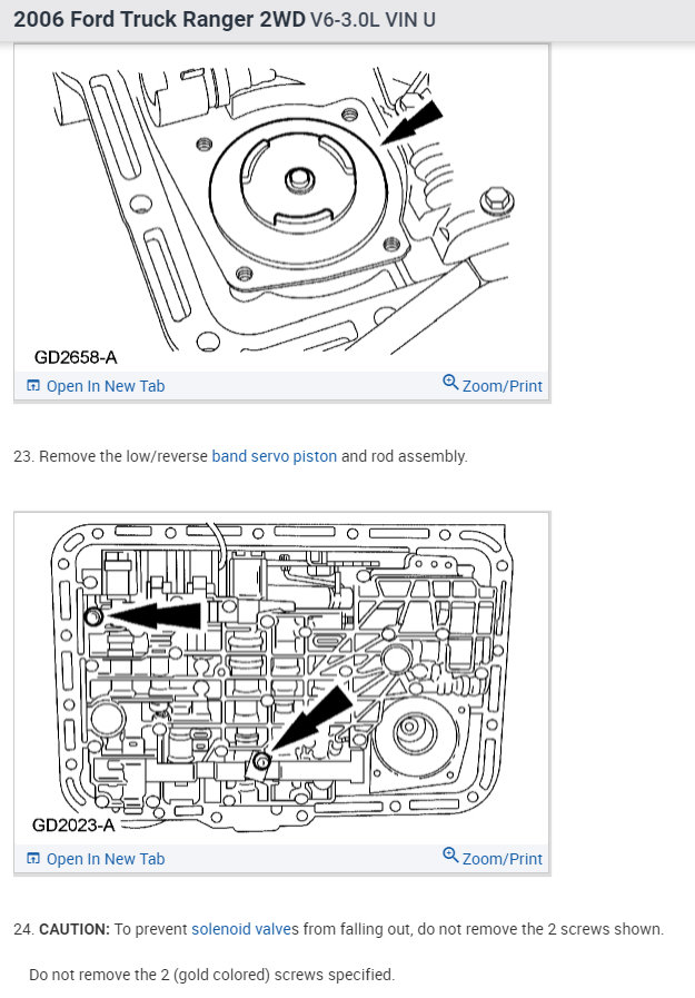

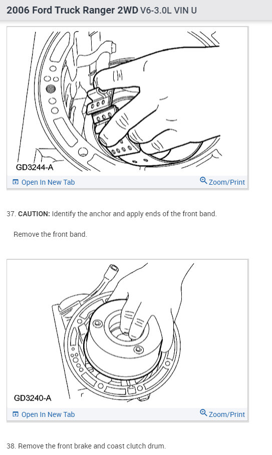

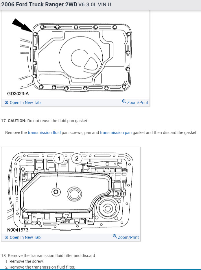

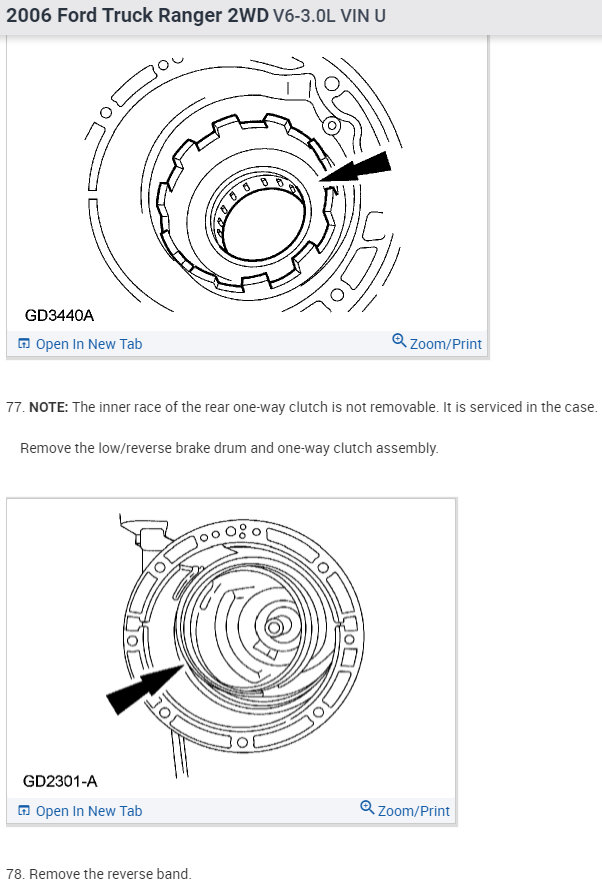

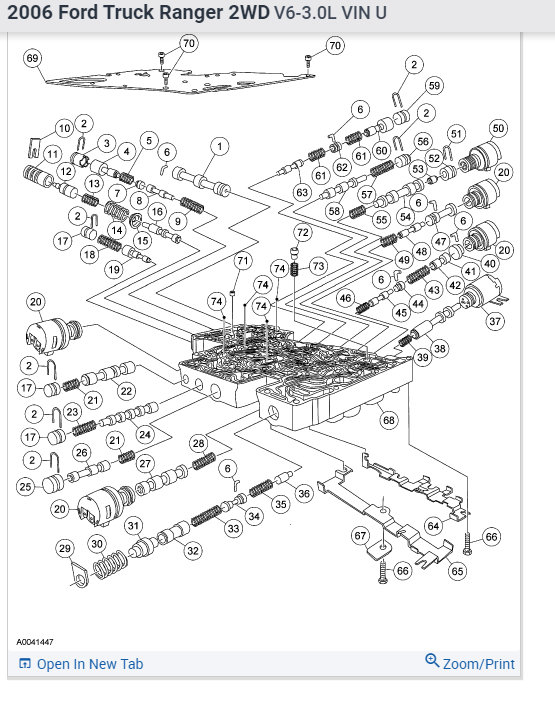

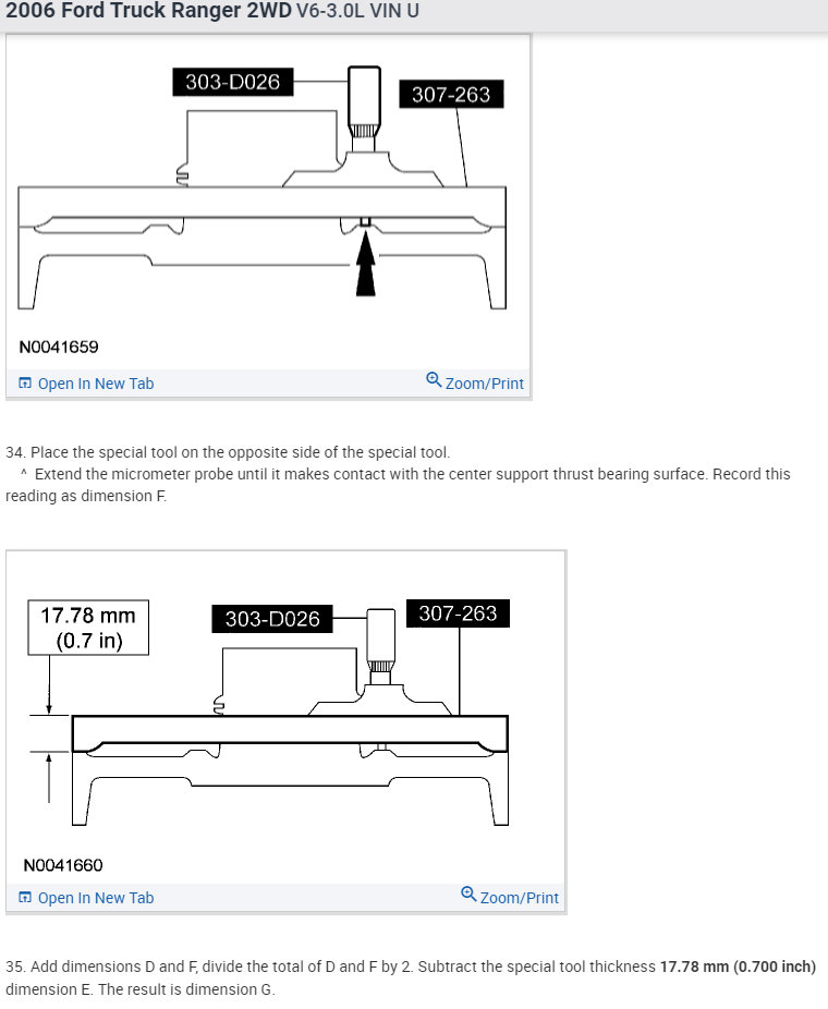

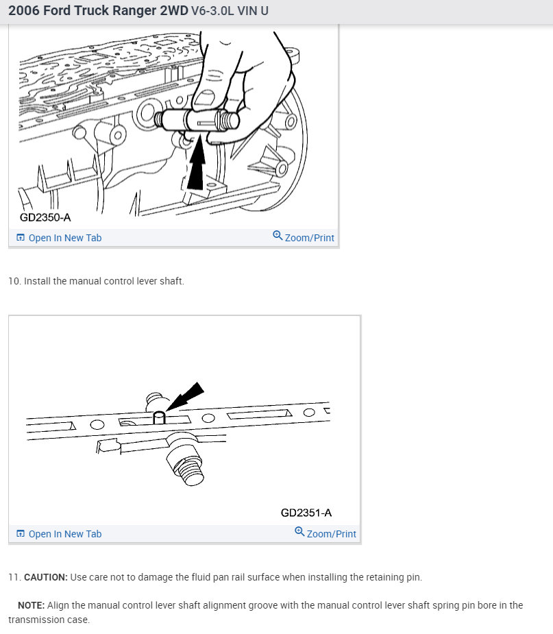

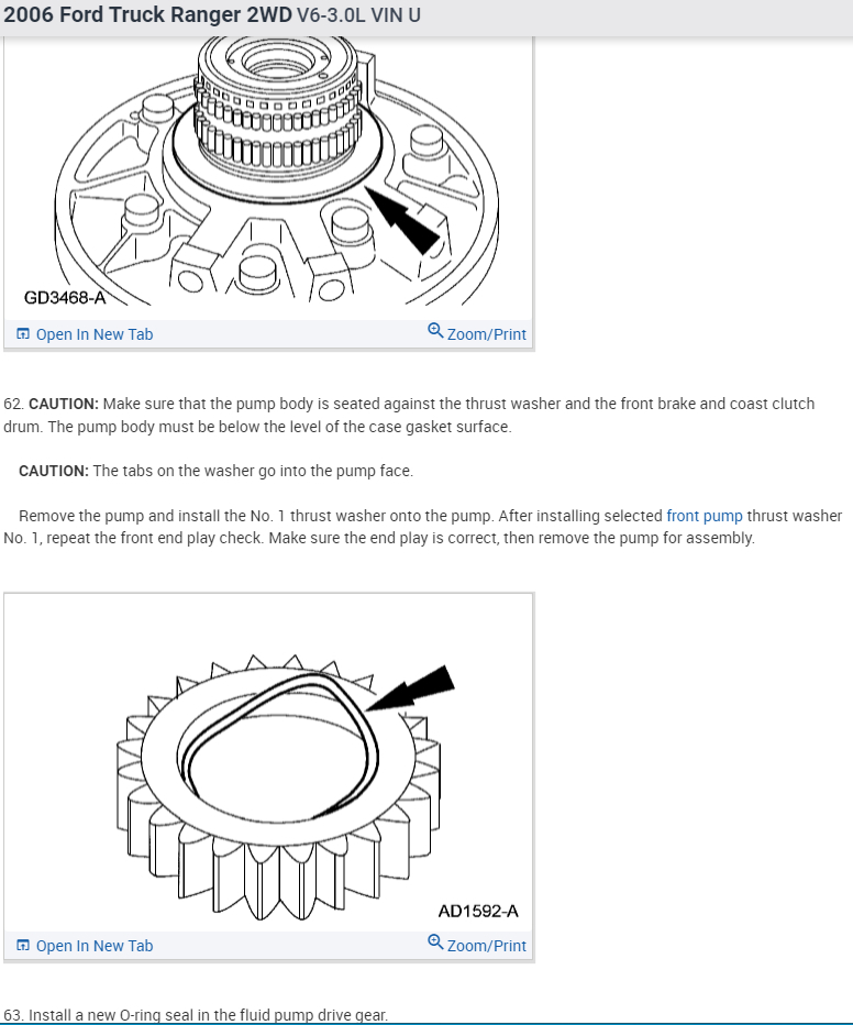

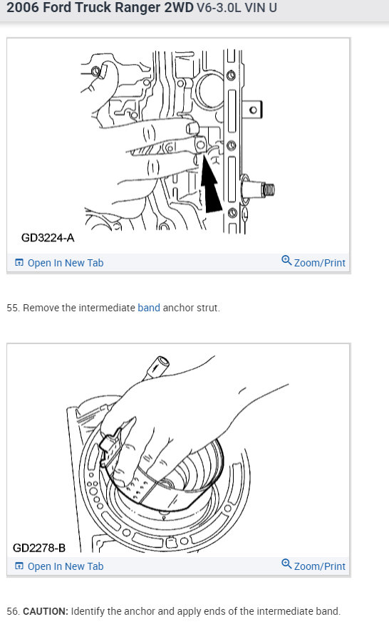

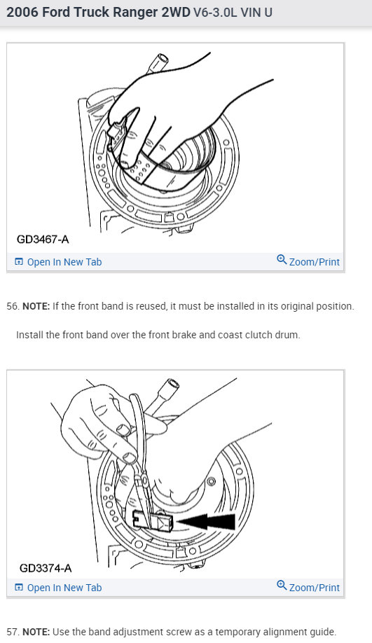

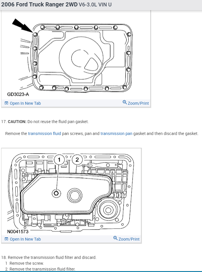

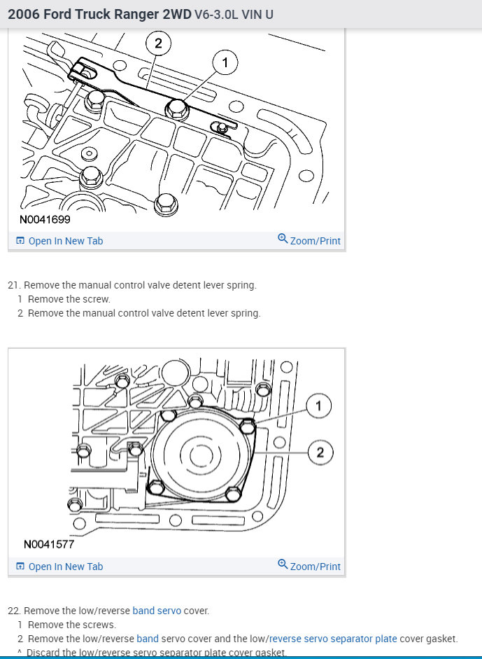

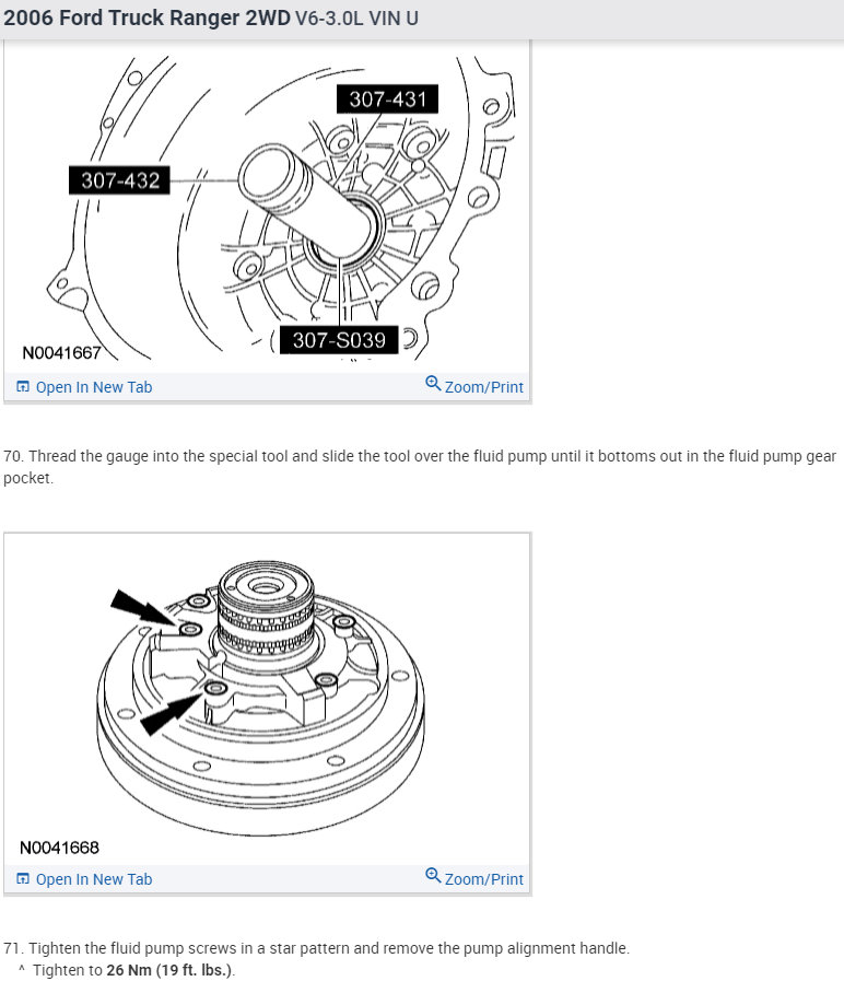

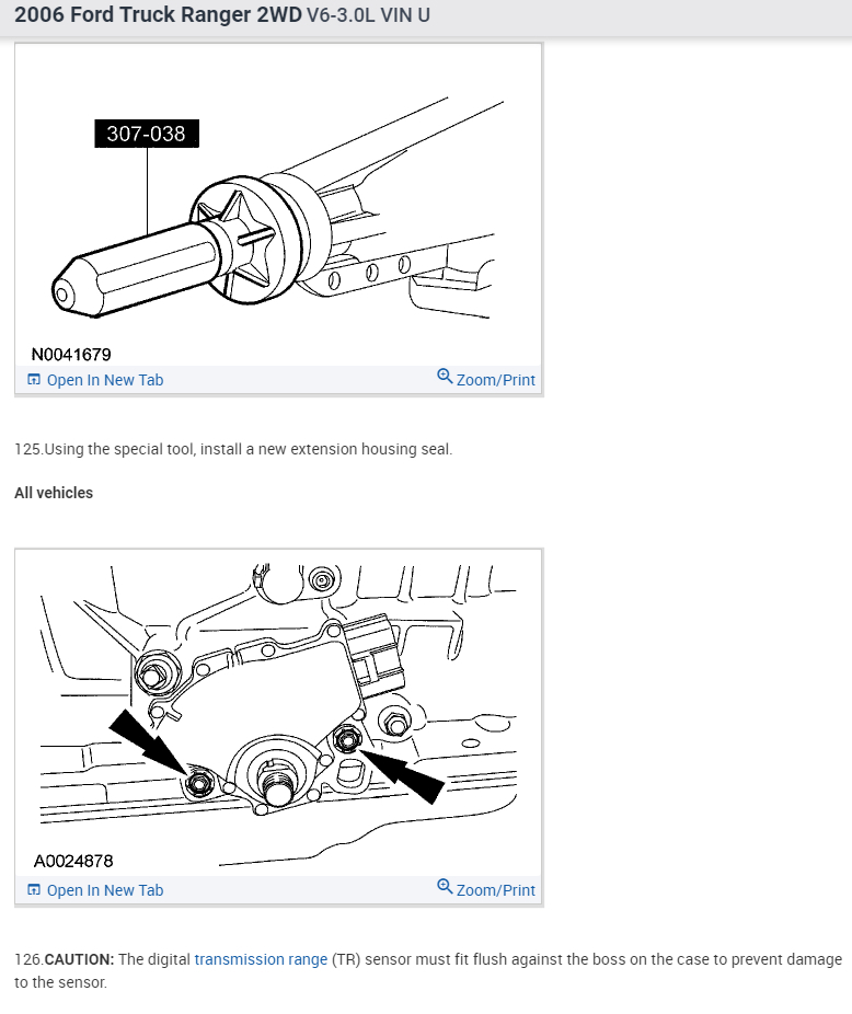

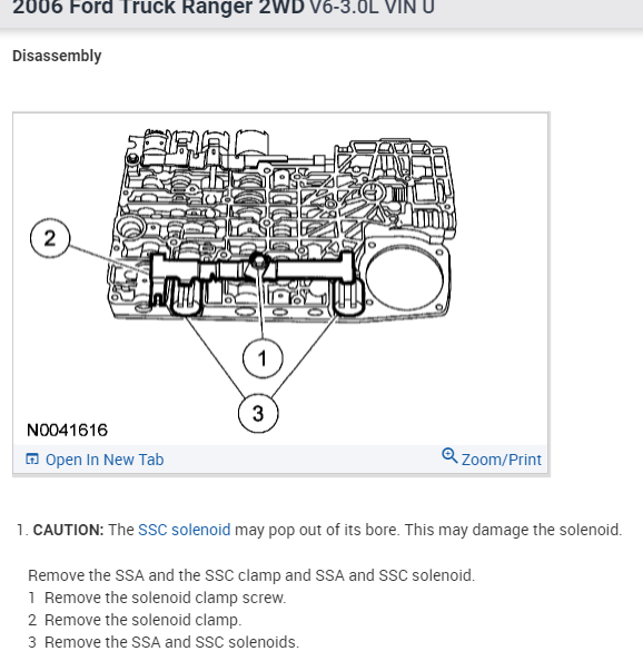

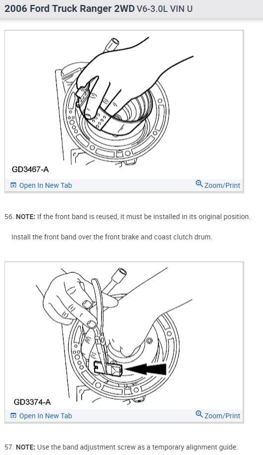

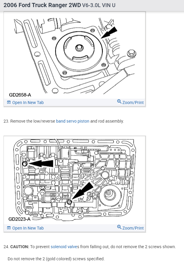

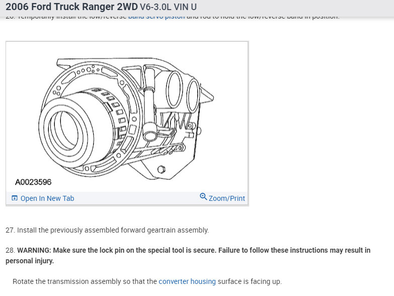

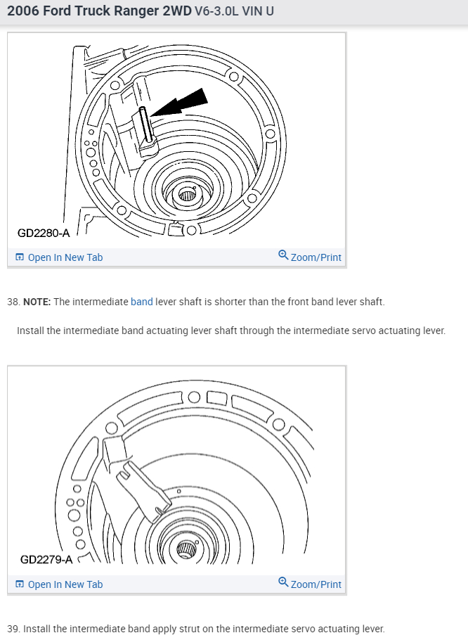

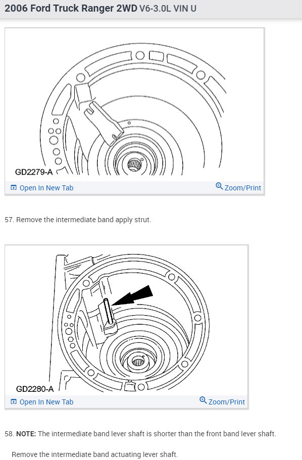

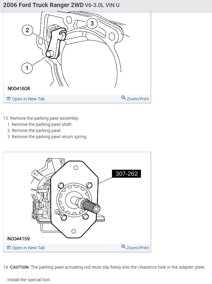

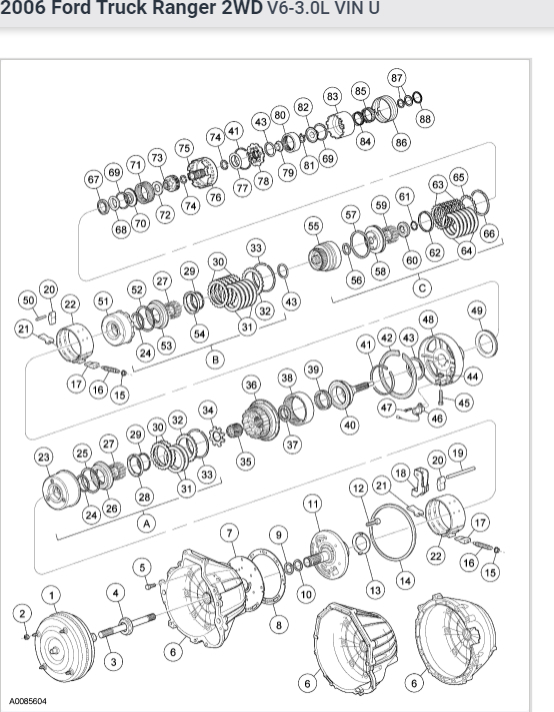

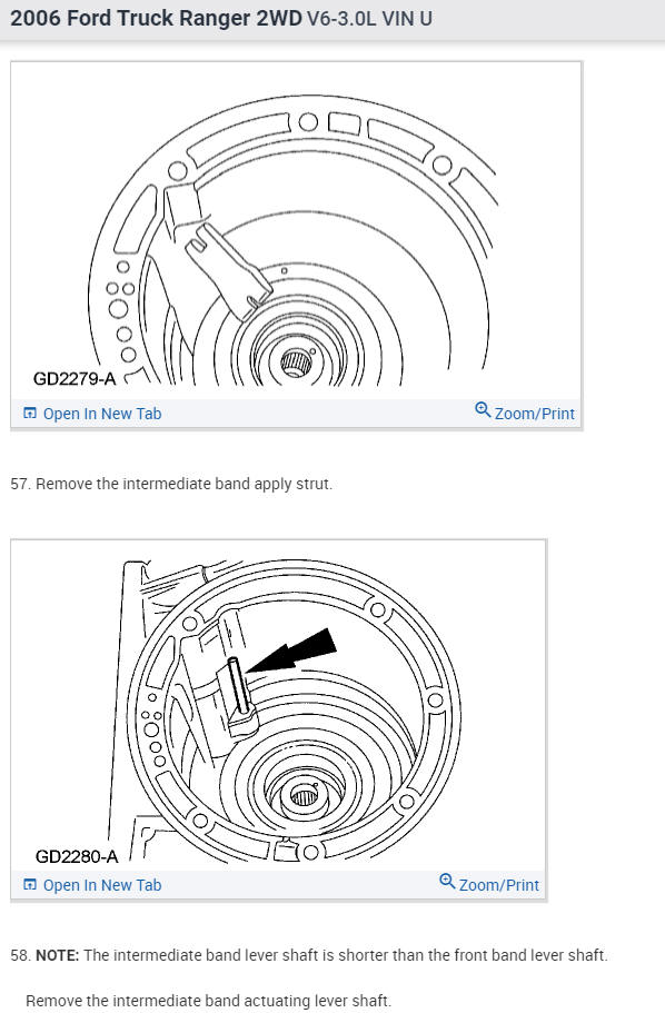

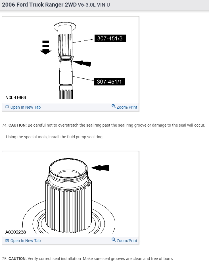

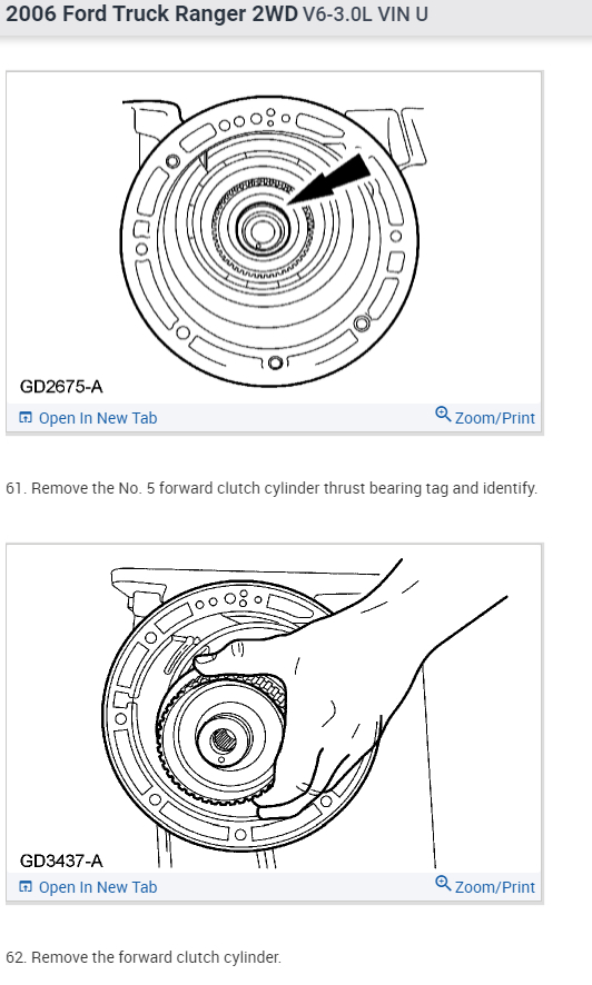

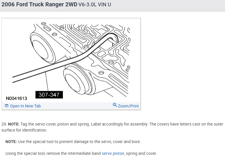

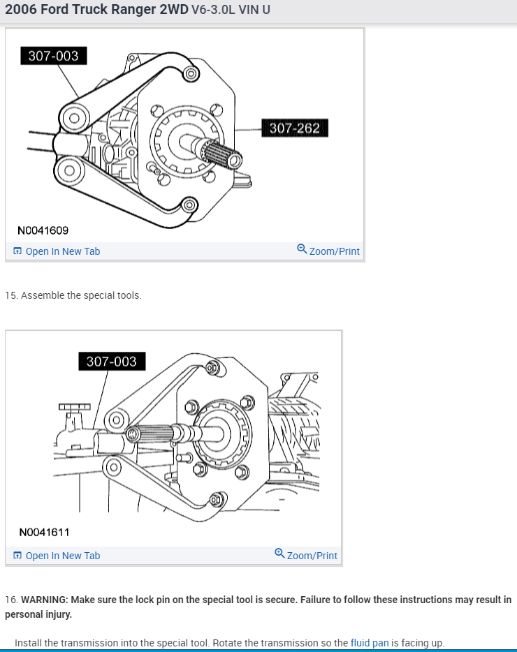

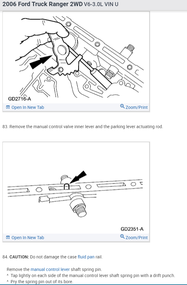

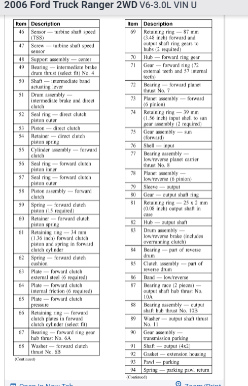

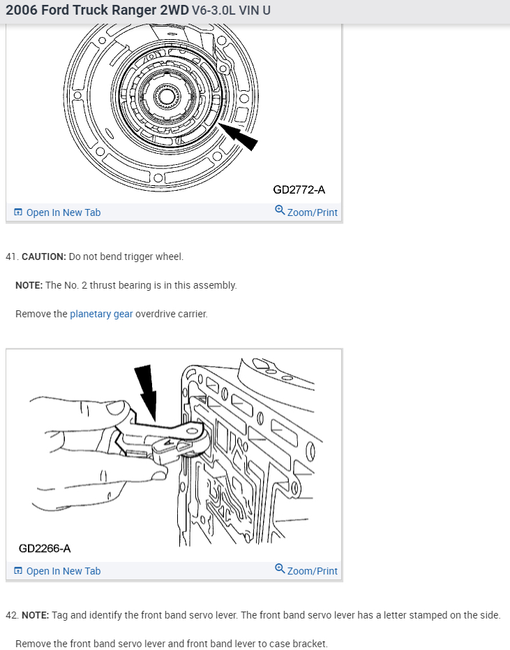

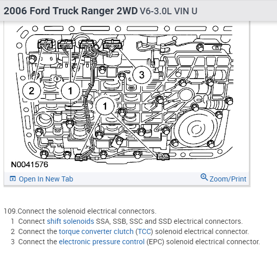

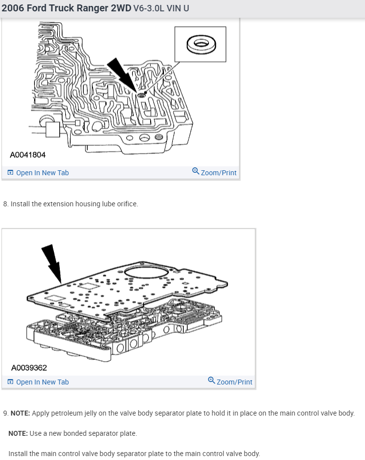

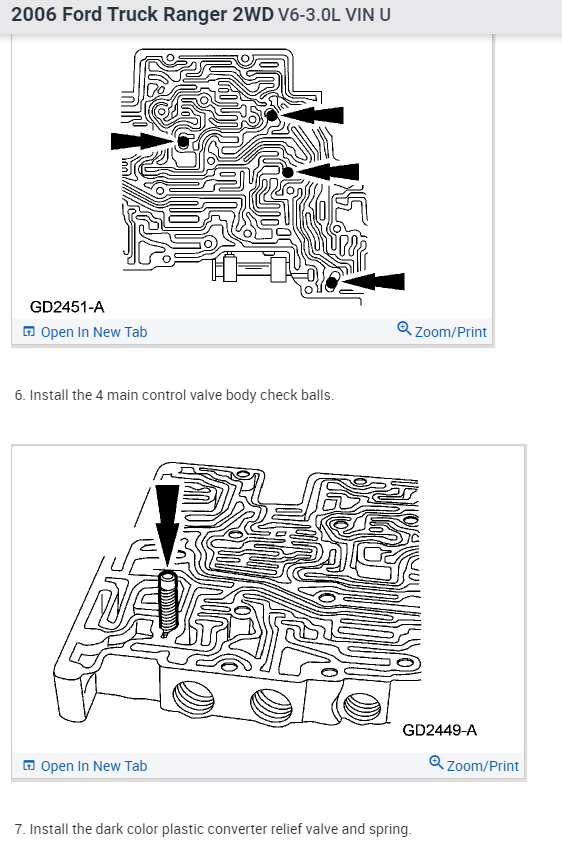

I have attached the complete disassembly and reassembly procedures for all the major components in the transmission. This will help you with the rebuilt process.
Let me know if you have any questions.
Oct 29, 2021 at 9:43 AM

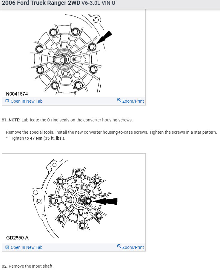

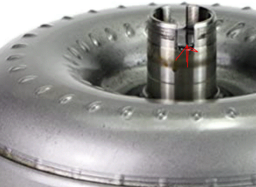

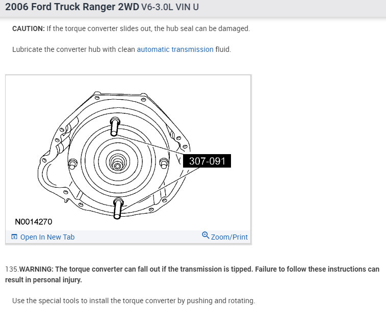

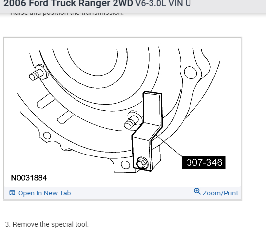

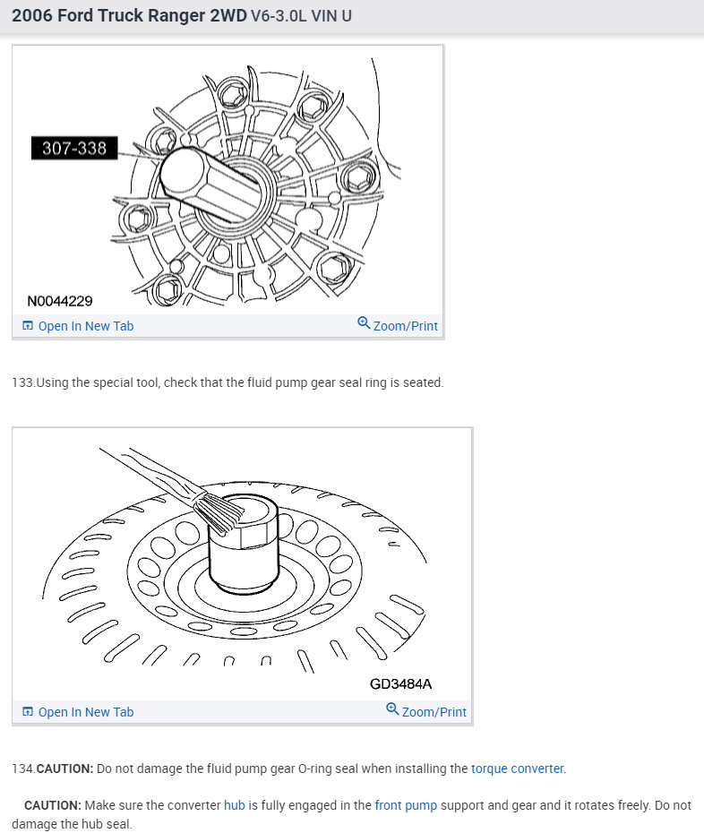

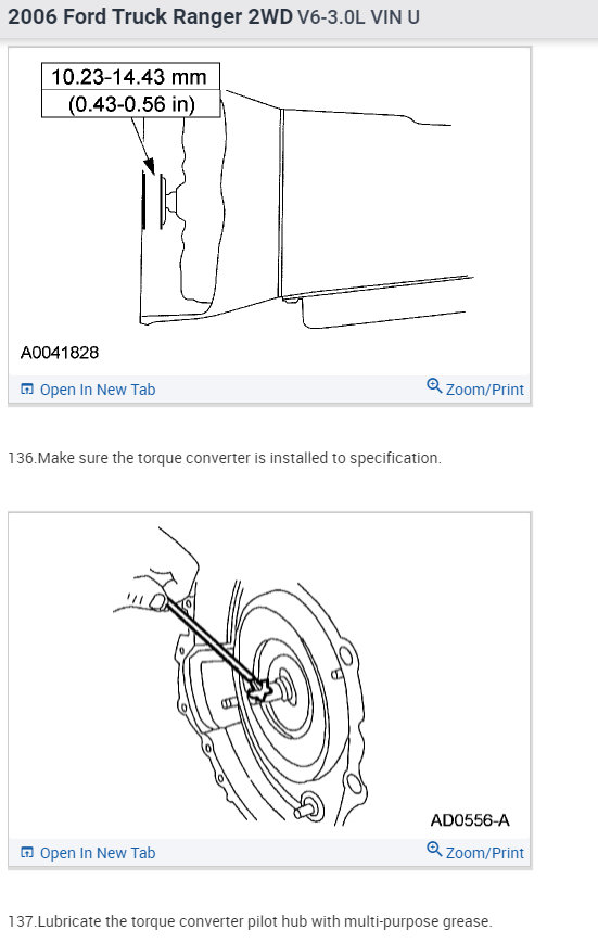

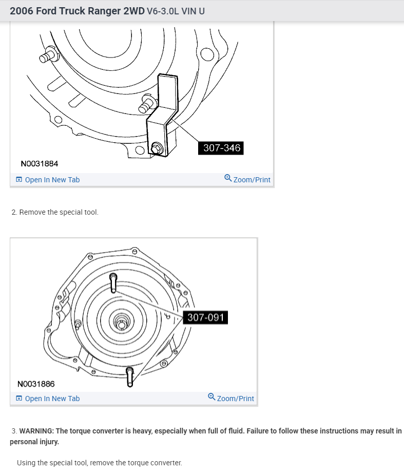

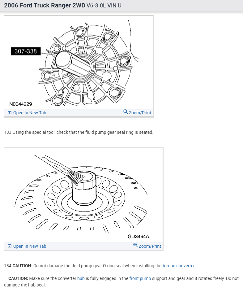

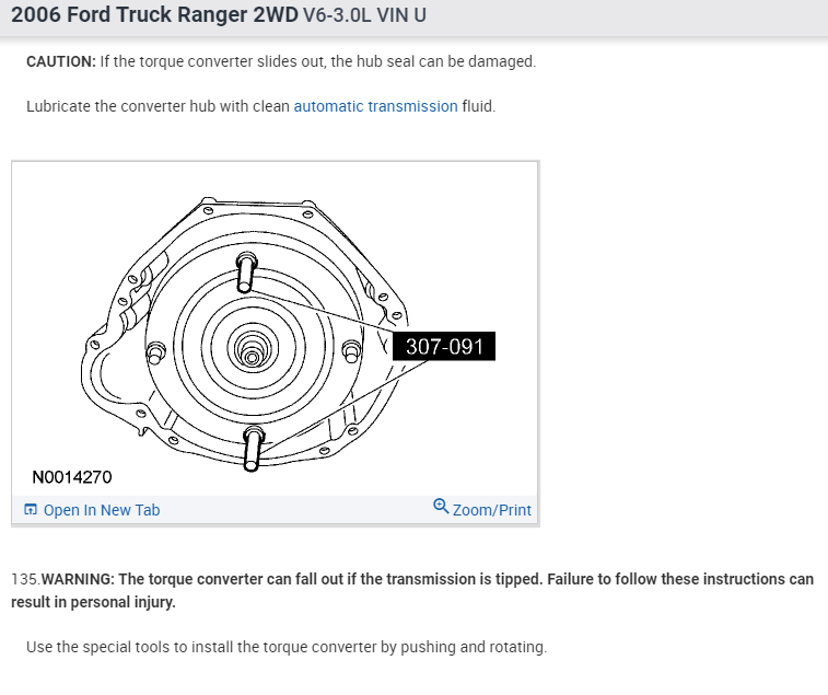

So, we got the original transmission out but can't get the other one to seat properly. I can get a couple bolts started but can't move the transmission around when I do that. Is there a smoother process of aligning this up? It almost seems like the torque converters not back all the way and stopping it from coming forward all the way but I put it in and spun it till I felt it drop twice and couldn't get it to drop anymore. Any help or ideas would be greatly appreciated!
Nov 1, 2021 at 10:57 AM
  • 110,194 POSTS

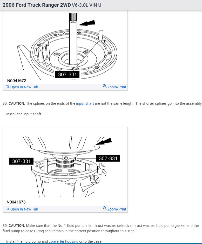

The torque converter needs to be seated. If you remove it, you will see two spline cutouts where it pushes into the front pump. You need to rotate the converter until they seat.
See pic below. It shows what I am talking about.
Nov 3, 2021 at 7:12 PM
JUSTIN STUDDARD
  • 49 POSTS
I've already done that. After setting torque converter on shaft, I spin it and can watch and feel it drop in twice. How can I tell if it is back all the way or is there anything else that would cause it to stick out a little too far?
Nov 3, 2021 at 8:21 PM
  • 110,194 POSTS
If you see and feel it drop into place, it should be fine. There really isn't anything that would prevent it from sticking out too far.
Is this a new torque converter?
Nov 3, 2021 at 9:01 PM
JUSTIN STUDDARD
  • 49 POSTS
It looks remanufactured honestly the one that came with my truck was brand new from when they rebuilt it about a year and a half ago. I'm swapping mine out for one off a 2005. The thing is it won't pull in with the other torque converter either but without a torque converter at all it pulls in flush and sits perfectly.
Nov 3, 2021 at 10:23 PM
  • 110,194 POSTS
Both model years use the same torque converter. So, it should work. If you have it fully seated in the front pump, something must be moving.
Did you remove the front pump or flex plate or anything other that may cause an issue?

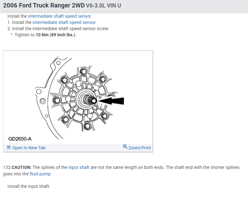

It was the used transmission that they had given me the input shaft was sticking out way too far, so they gave me a different used transmission I just got today and just got done getting bolted up and I am actually driving it right now! I really do appreciate you getting back to me and if by chance you have rebuild specs and instructions for a 351 Windsor it would be greatly appreciated.
