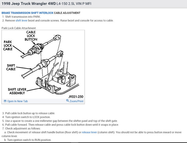

Wont shift out of park.
Aug 4, 2019 at 12:31 AM
  • 55,433 POSTS

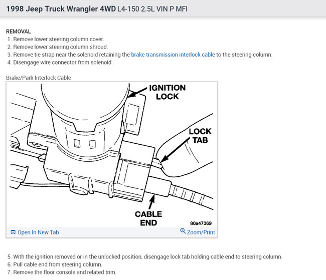

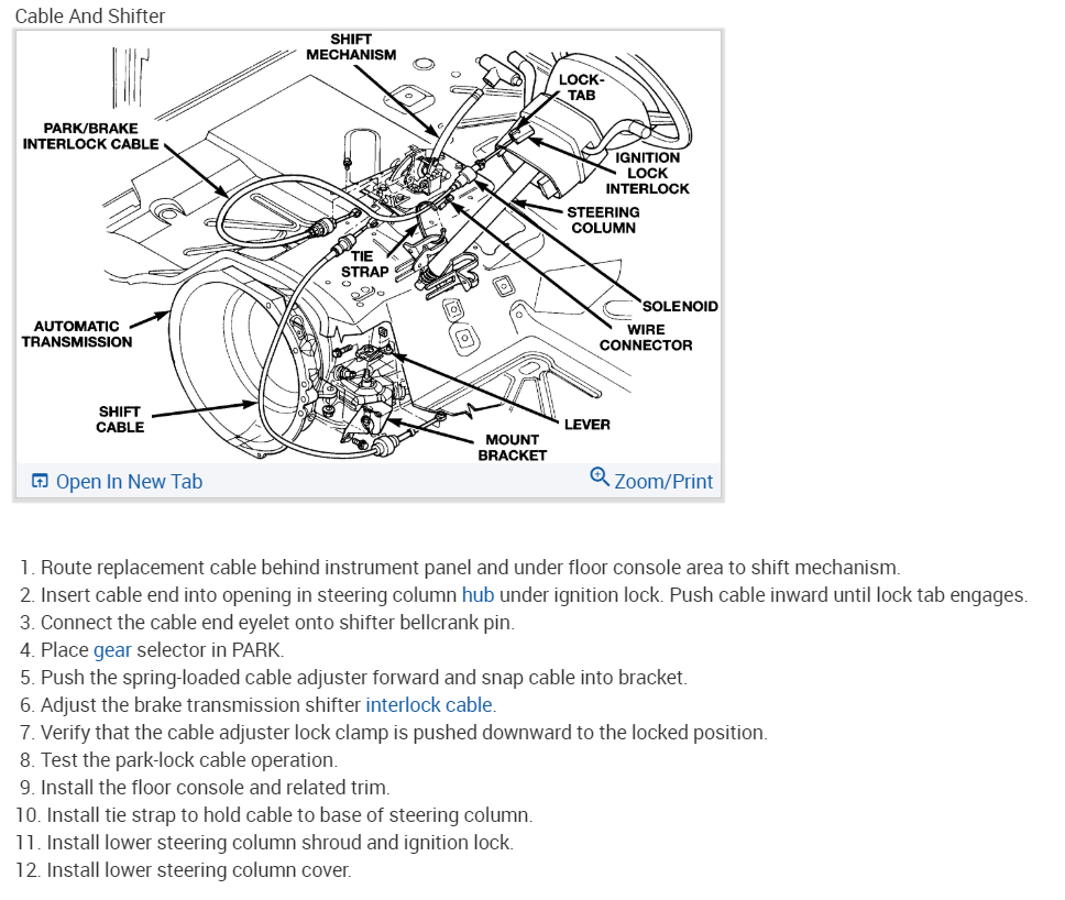

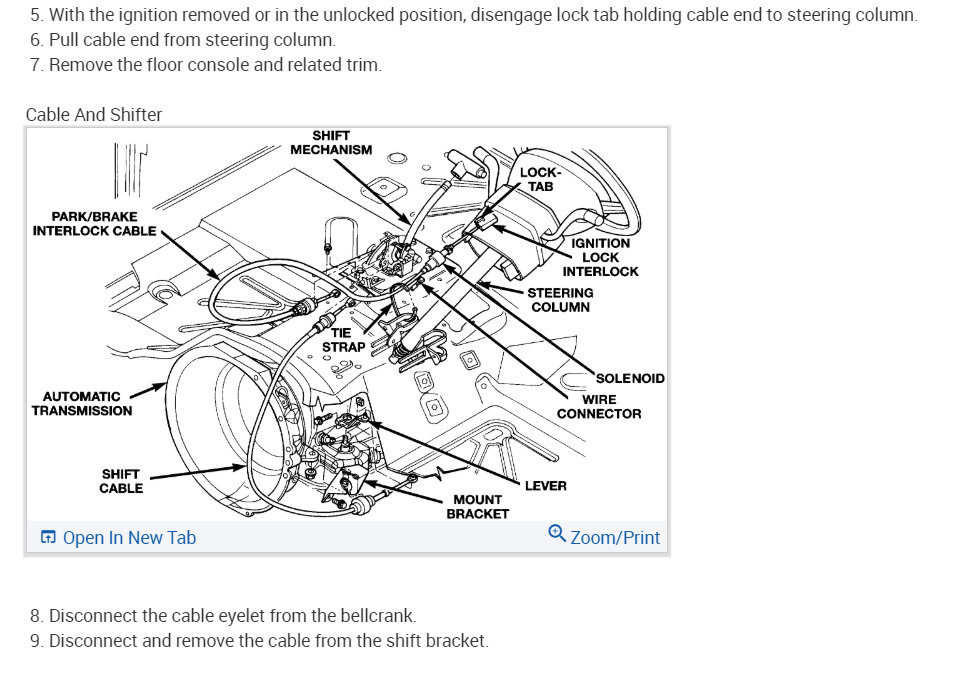

Does the ignition key work correctly? Push on the brake while trying to shift? If so it sounds like the shift interlock cable has gone out or is out of adjustment. here is the location so you can check it out. Check out the diagrams (below). Please let us know what you find. We are interested to see what it is.
