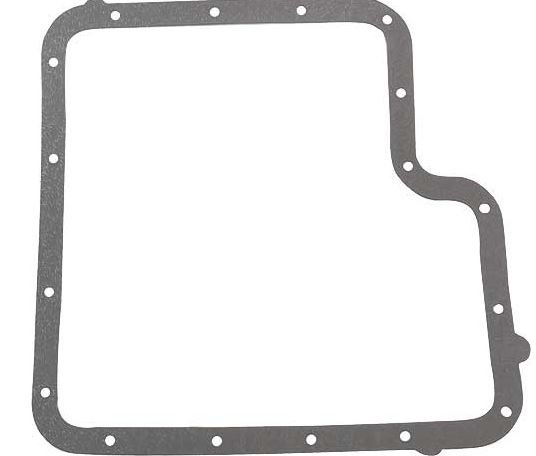

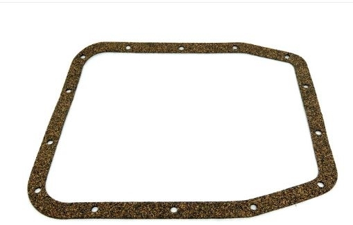

Will a transmission from a 2002 F250 with a 5.0 fit my 1985 with a 5.8?
Friday, June 7th, 2019 AT 5:53 PM
  • 109,885 POSTS
Welcome back:
No. They are different animals. The 02 is reliant on a transmission control module where as your's isn't. You may be better off rebuilding the one you have. The one in your vehicle can be one of three types. It could be a C5, C6, or AOD. Make sure you get the right one.
Friday, June 7th, 2019 AT 6:27 PM
MRCMC88
  • 9 POSTS
How can I tell which one I have?
Friday, June 7th, 2019 AT 8:21 PM
  • 109,885 POSTS
Take a look at the transmission pan. I attached two pictures. The first shows an AOD pan gasket and the second a C6. They are shaped differently.
