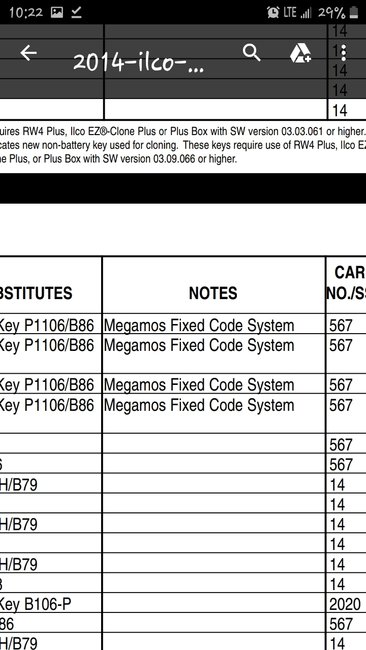

It is a Transporter key.
B99-PT5
USA
Sep 2, 2019 at 1:27 AM

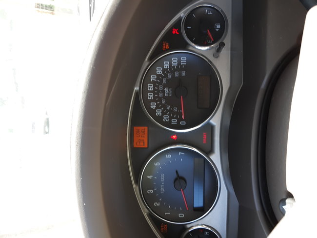

I have 4c pictures total to show what my dash is showing after 10 second's.
Sep 2, 2019 at 3:27 AM

The security light never came on, only the battery and low fuel light was flashing and the lights never stopped.
I was thinking of having my car towed to O'Reilly to have them scan got codes. My son drives a Tow truck. I will let you know the outcome. Thank you so much Rich.

So last night I tried the key/ignition idea from you and this morning my son came to tow my car to O'Reilly's to be code scanned and the only on the dash is "low fuel". So my son said no use if not showing a "service engine " light.
So I just went back out to start it and low fuel still stays on but I could smell an odor kinda like exhaust but not a converter smell. So I do not know.
Sep 7, 2019 at 11:24 AM
