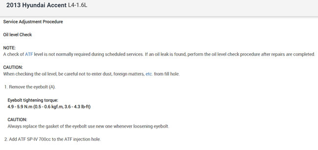

1. Car still I can drive but it's in 3rd gear, cannot change so when I start car need more acceleration for go.
2. When I put reverse gear it's jerks.
Aug 28, 2024 at 6:44 PM
  • 55,781 POSTS

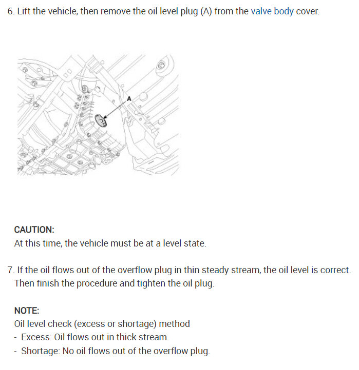

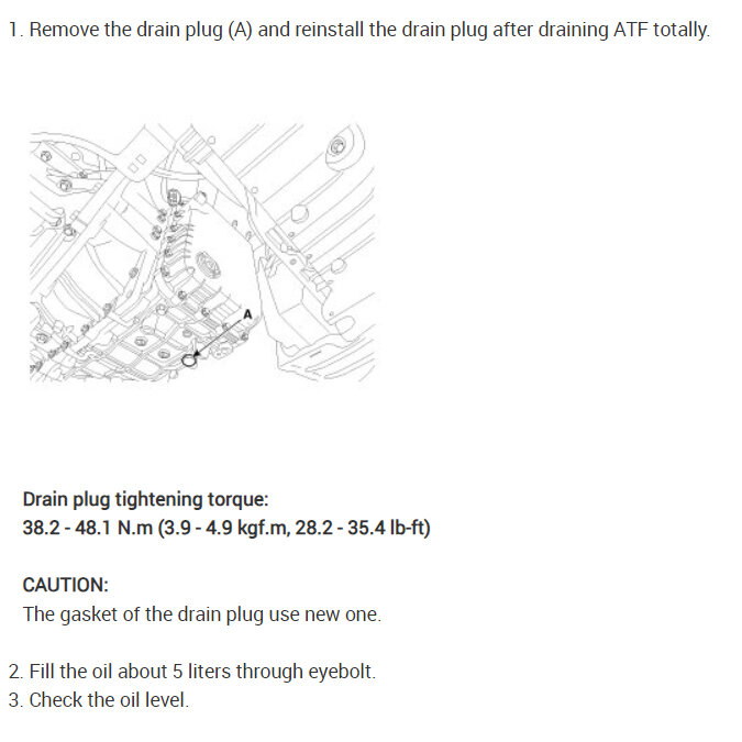

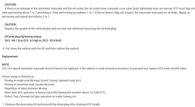

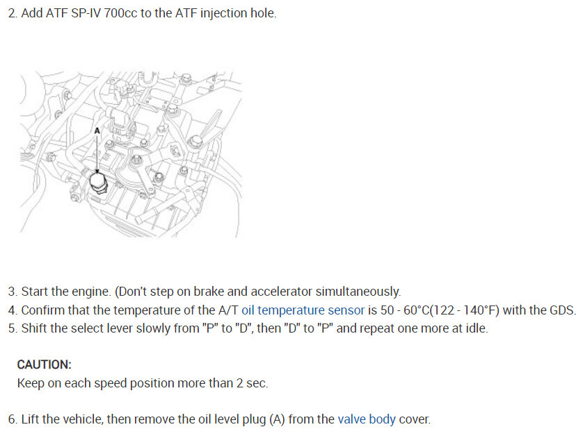

The first thing I would do is check the transmission fluid level and if the fluid is burnt, I would do a fluid and filter service.
Automatic Transaxle Fluid
Type .................... MICHANG ATF SP-IV, SK ATF SP-IV, NOCA ATF SP-IV, HYUNDAI genuine ATF SP-IV or other brands meeting the specification approved by Hyundai Motor Co.
This guide can help as well, also we should run the codes to see if any are stored:
https://www.2carpros.com/articles/how-to-check-and-add-transmission-fluid
Here is a guide to help you get the codes:
Check out the images (below). Let us know how it goes.
