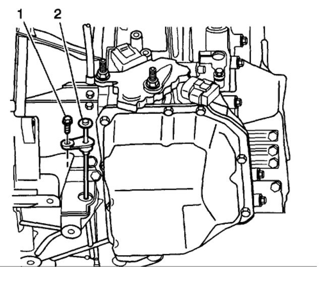

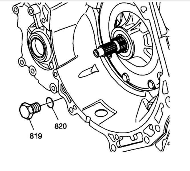

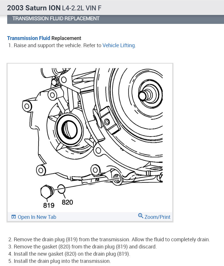

I have found what the manual says about transmission drain and fill with diagrams (BELOW)
Raise and support the vehicle. Refer to Vehicle Lifting.

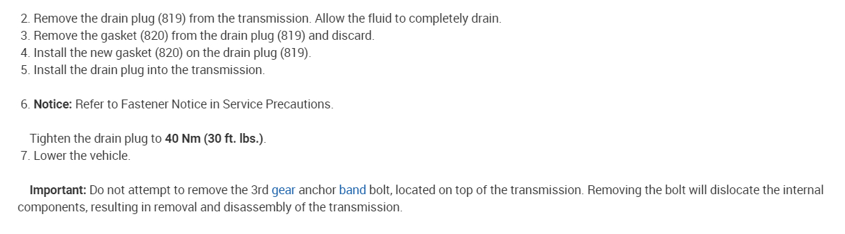

Remove the drain plug (819) from the transmission. Allow the fluid to completely drain.
Remove the gasket (820) from the drain plug (819) and discard.
Install the new gasket (820) on the drain plug (819).
Install the drain plug into the transmission.
Notice: Refer to Fastener Notice in Service Precautions. See: Service Precautions
Tighten the drain plug to 40 Nm (30 ft. lbs.) .
Lower the vehicle.
Important: Do not attempt to remove the 3rd gear anchor band bolt, located on top of the transmission. Removing the bolt will dislocate the internal components, resulting in removal and disassembly of the transmission.

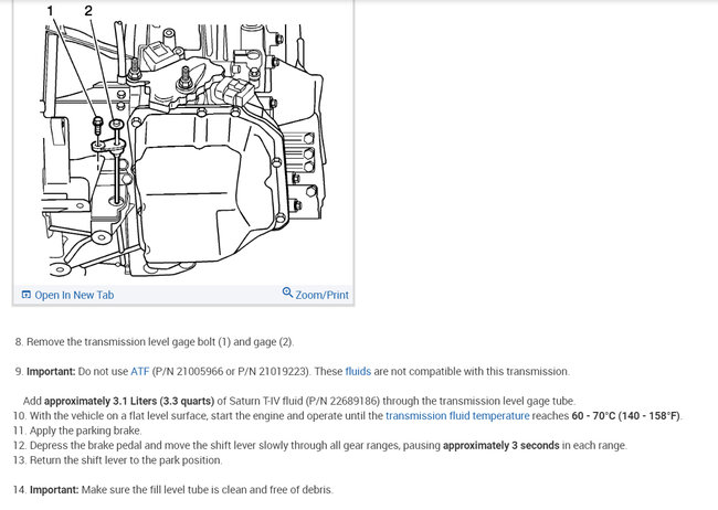

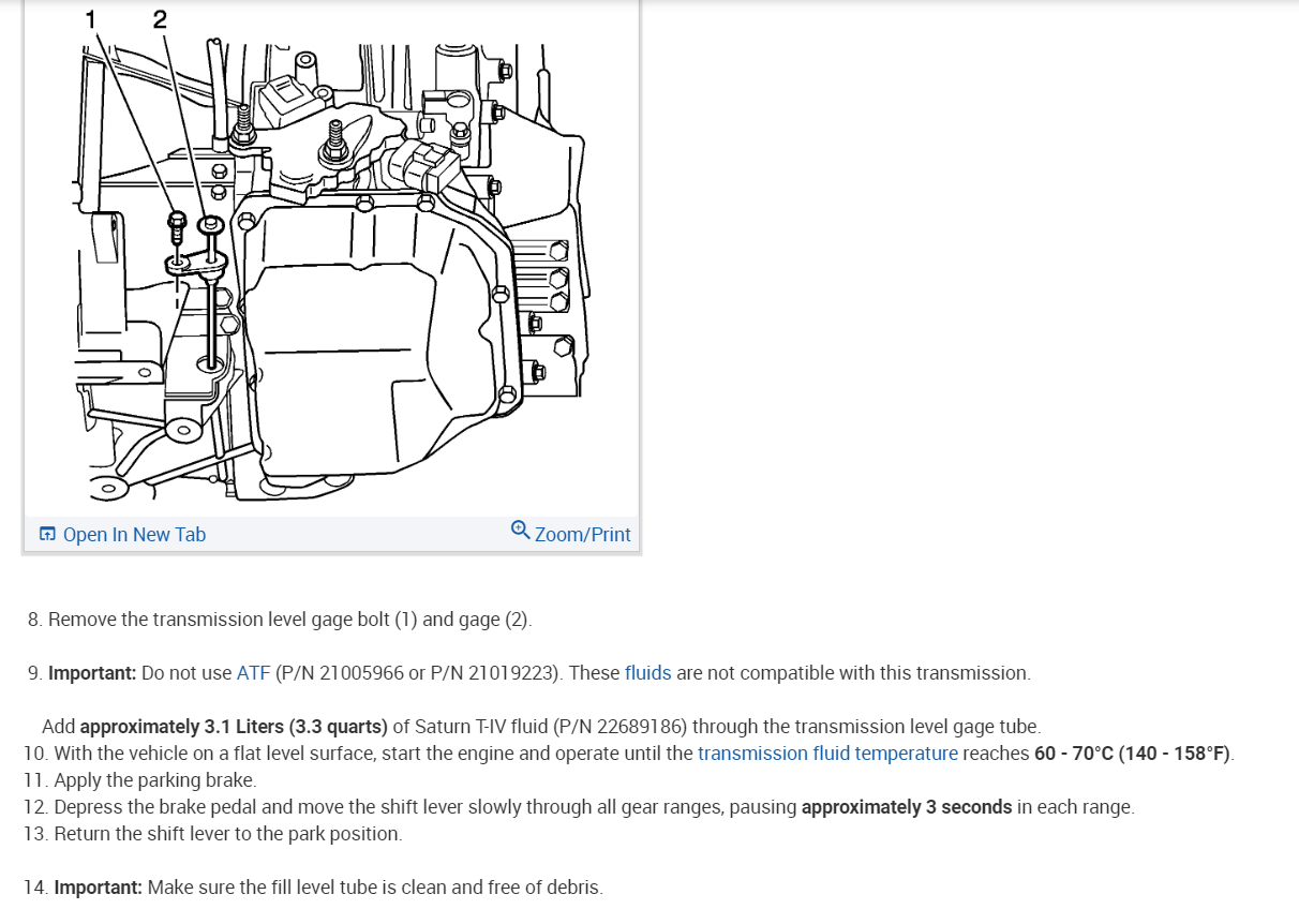

Remove the transmission level gauge bolt (1) and gage (2).
Important: Do not use ATF (P/N 21005966 or P/N 21019223). These fluids are not compatible with this transmission.
Add approximately 3.1 Liters (3.3 Qt) of Saturn T-IV fluid (P/N 22689186) through the transmission level gauge tube.
With the vehicle on a flat level surface, start the engine and operate until the transmission fluid temperature reaches 60-70°C (140-158°F) .
Apply the parking brake.
Depress the brake pedal and move the shift lever slowly through all gear ranges, pausing approximately 3 seconds in each range.
Return the shift lever to the park position.
Important: Make sure the fill level tube is clean and free of debris.
Push the transmission level gauge into the level gauge tube until fully seated.
Pull the transmission level gauge from the transmission in order to check the proper fluid level on the gauge.
If the fluid is not within the proper range, adjust as necessary.
When complete, install the transmission level gauge bolt (1).

It's not sealed there's a small yellow dipstick that is bolted down with a 12mm bolt on the side of the transmission facing the radiator.Its down towards the bottom.It gets changed every 50,000 miles on that transmission.If it's doing what your saying that's not a sign it needs to changed that's a sign there is a problem with the transmission. Have you had the transmission scanned for codes yet?

yes thats where u check it its a 12mm bolt holding it down i belive.check it while idling in park and hot.u change it every 50,000 miles.also donations and feedback greatly appreachiated.

I would try a transmission service first here is a guide to help walk you through the steps with diagrams below to show you how on your car.
Fluid Types
AF23-5 Automatic Transaxle
Transmission Fluid .................... Saturn T-IV Fluid P/N 22689186
Capacities
Transmission Fluid
Complete Overhaul .................... 8.2 quarts (7.8 liters)
Apr 16, 2020 at 3:29 AM (Merged)
BIRDDOG94
Wow thanks for the help I did the service and the car seems much better ;) fun site.
