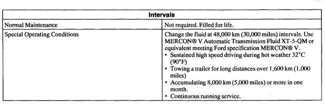

Let me know if you have any other questions.
CAUTION: Use only MERCON (R) V Automatic Transmission Fluid XT-5-0M or equivalent meeting Ford specification MERCON (R) V. Use of any other fluids can result In a transmission malfunction or failure.
Capacities
Capacity 10.0 qt (US)
