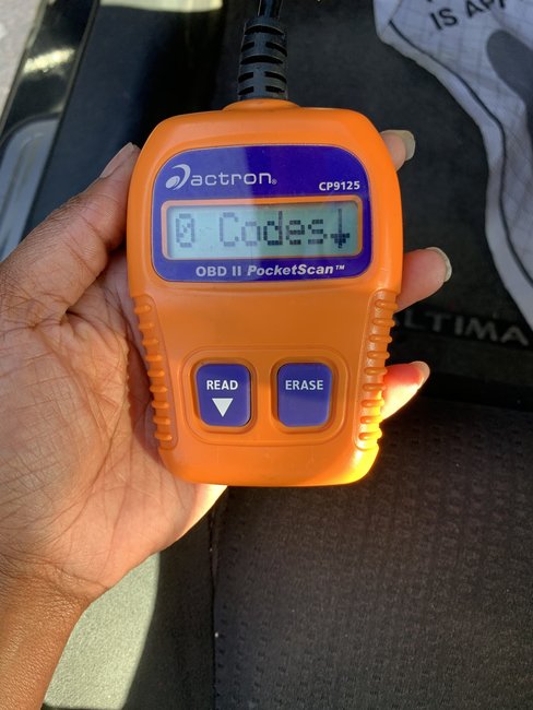

I checked it but still no codes.
May 21, 2019 at 4:00 PM
  • 54,832 POSTS
Good job on the codes, this car has the CVT transmission which has problems. can you tell is it making any weird sounds also can you check the fluid level and condition? smell the fluid to see if it burnt and check the color. If you have not serviced the unit I would try that as well. here is a guide to walk you through the steps:

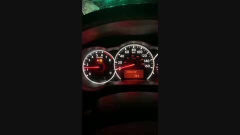

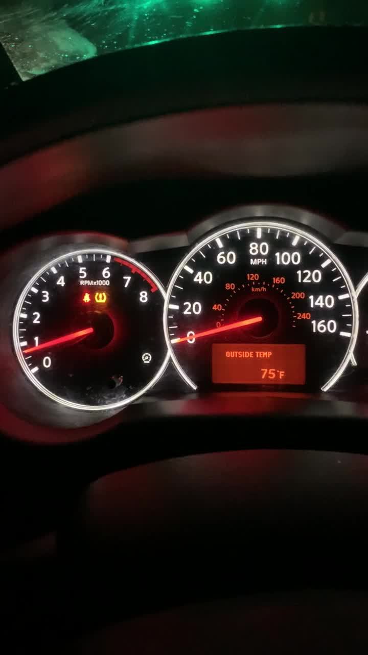

It’s not making any noise but here’s a video of what it doing.
May 26, 2019 at 6:06 PM
  • 54,832 POSTS

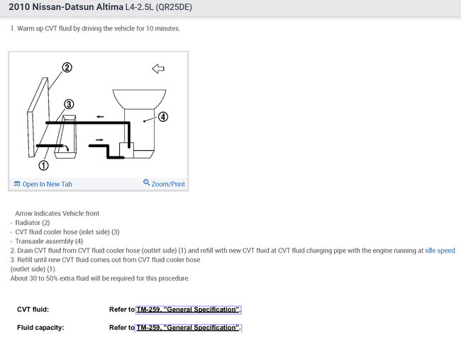

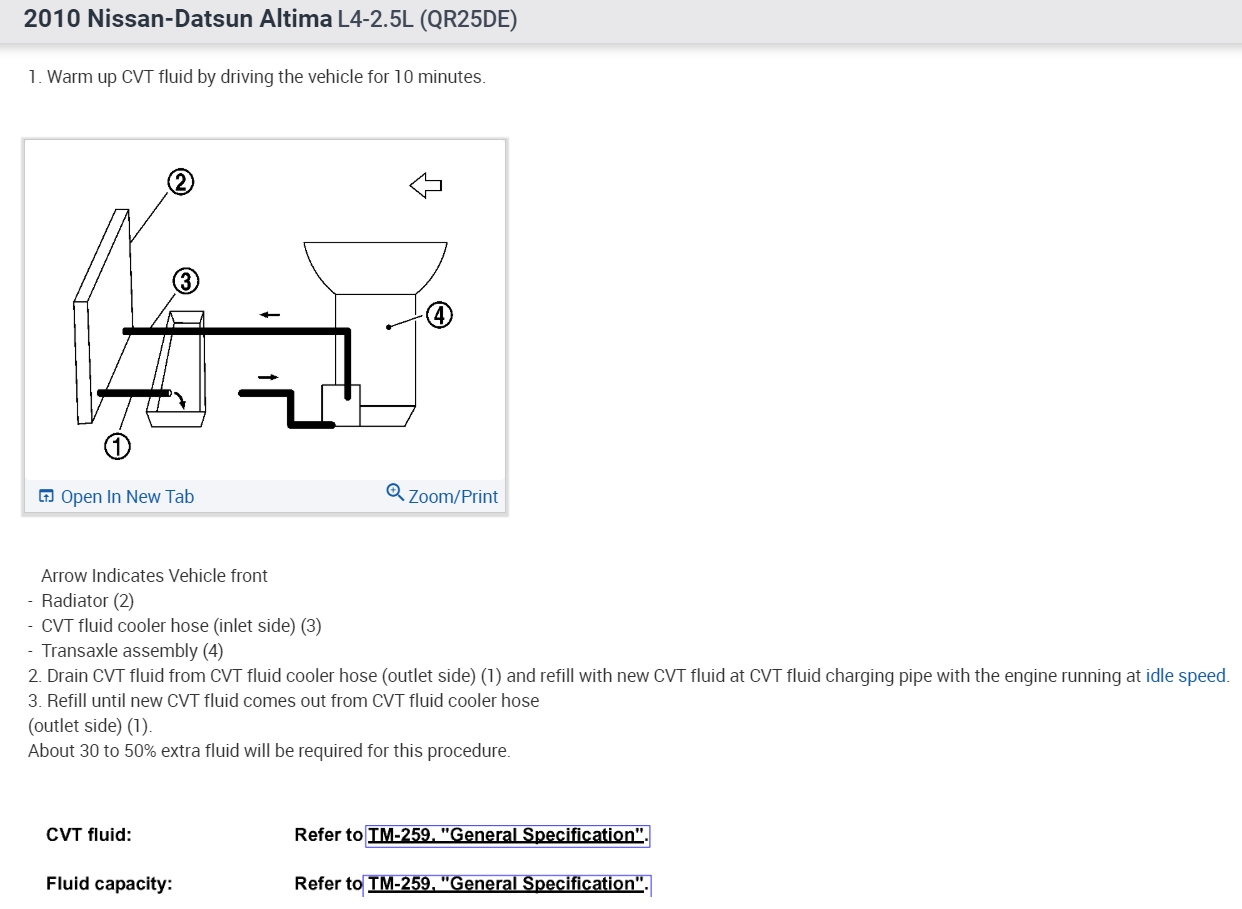

Yep, it looks like the transmission is slipping. have you serviced the fluid? If not I would start there. Here is a guide to walk you through the steps with more information in the diagrams below:
CAUTION:
- Use only Genuine NISSAN CVT Fluid NS-2. Do not mix with other fluid.
- Using CVT fluid other than Genuine NISSAN CVT Fluid NS-2 will deteriorate in driveability and
CVT durability, and may damage the CVT, which is not covered by the warranty.
- When filling CVT fluid, take care not to scatter heat generating parts such as exhaust.
- Delete CVT fluid deterioration date with CONSULT-III after changing CVT fluid. Refer to See: Continuously Variable Transmission/Transaxle, CVT > Scan Tool Testing and Procedures > CONSULT-III Function (Transmission).
4. Check fluid level and condition. Refer to See: Fluid - CVT > Procedures > Inspection.
