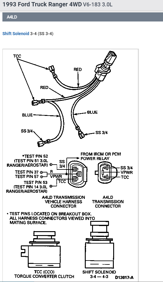

wont engage what is causing this? I have change fluid filter and gasket.
150,000 MILES • 3.0L • 6 CYL
NIK COSTANZO
What is causing this? I have change fluid filter and gasket. what is my problem? I don't think my transmission is going out.

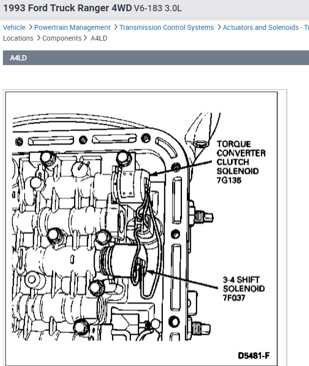

The transmission will need adequate fluid pressure in order to shift.
The shifting issue can be due to having low or contaminated fluid, bad transmission oil pump or faulty shift solenoid.
Weak pump may not provide enough fluid pressure which can lead to the solenoid not working properly.
Take a look at this article, it covers the basics of automatic transmission issues:
Many times, with shifting issues the check engine light gets illuminated. Is the check engine light on? If so, getting is scanned for code(s) can help with the diagnostics.
