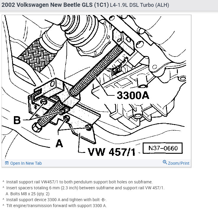

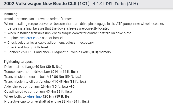

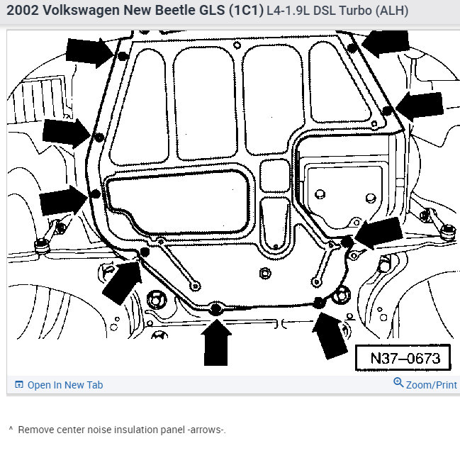

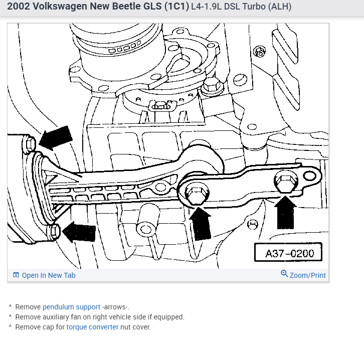

Dad's car listed above with a 1.9 tdi. transmission has been acting up for a while. He was offered one from a gas powered 2.0 automatic 2007 for a great price but we are wondering if they are compatible. Can we swap those? Thanks in advance.
Oct 22, 2021 at 11:57 AM
SQM
  • 6,383 POSTS
These transmissions are not interchangeable. Unfortunately, you cannot install the transmission out of the 2007.

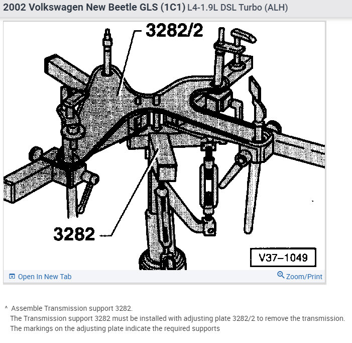

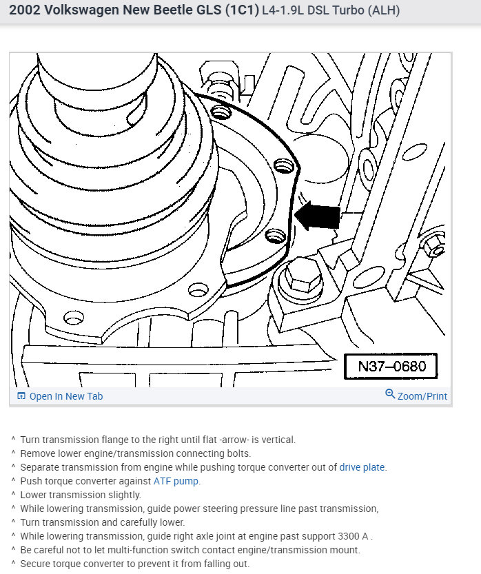

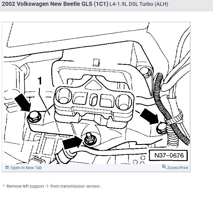

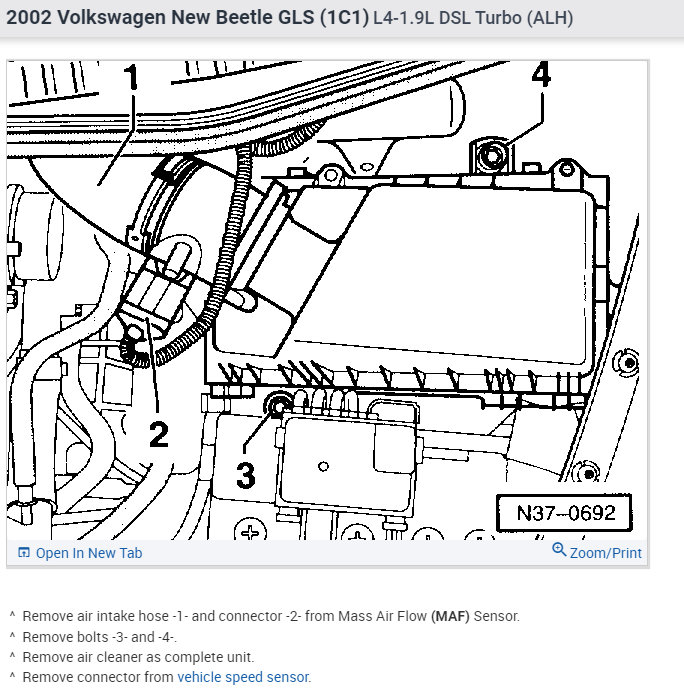

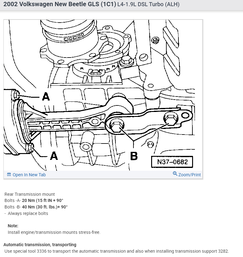

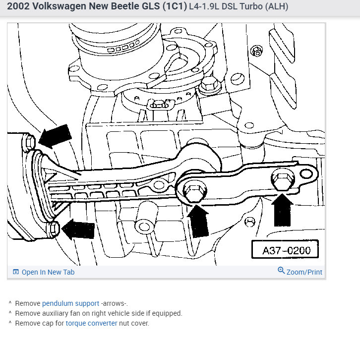

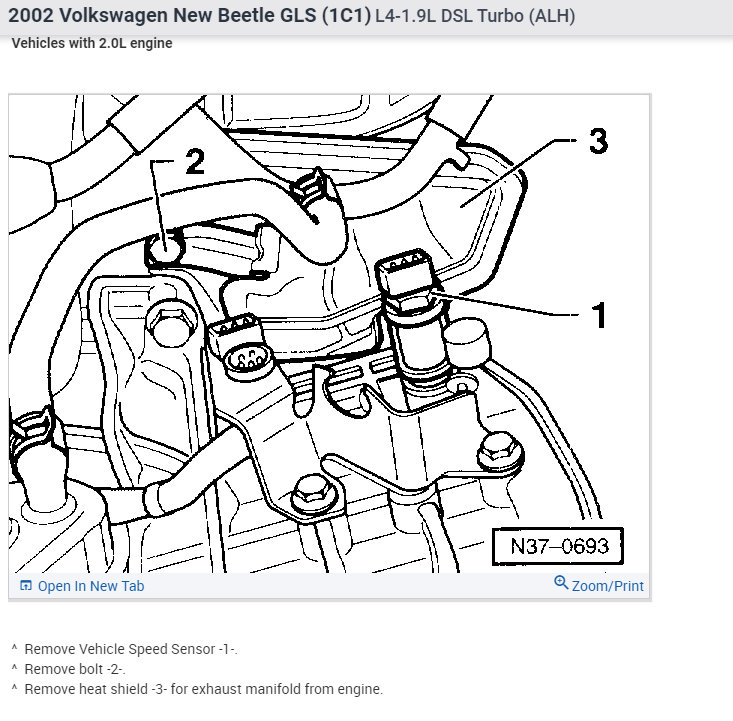

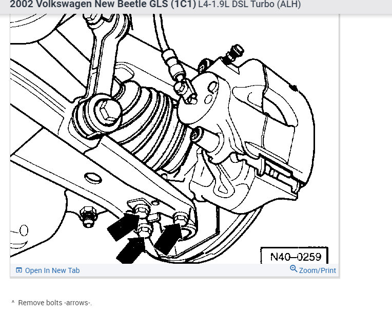

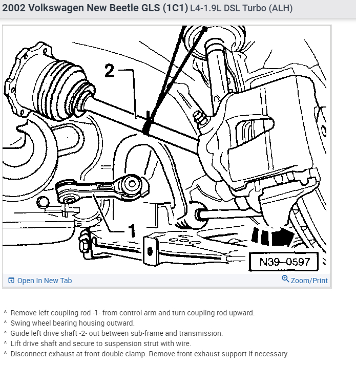

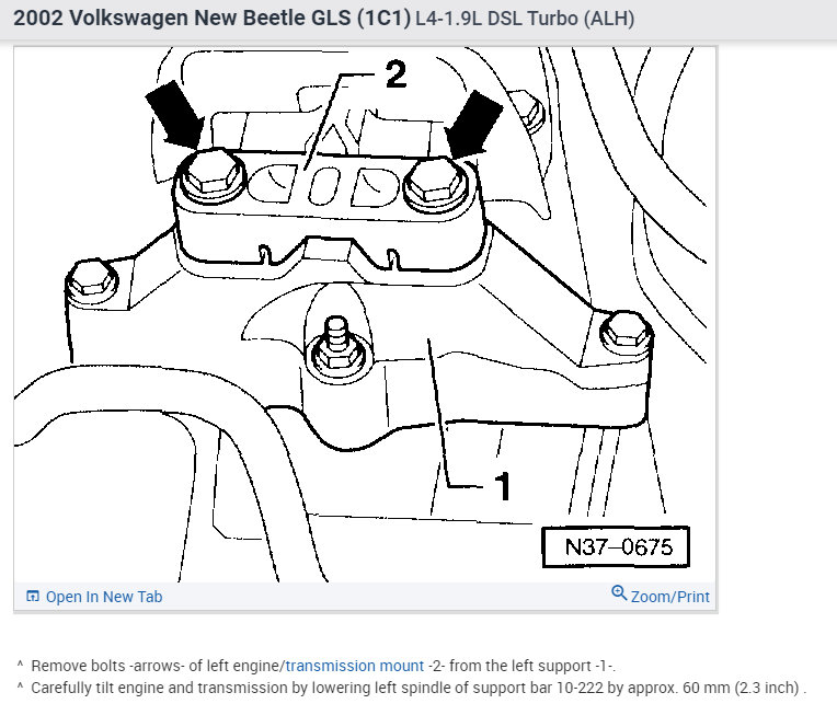

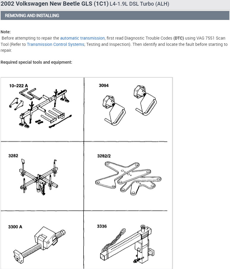

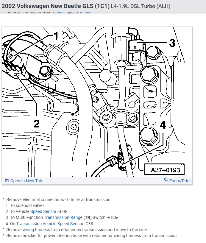

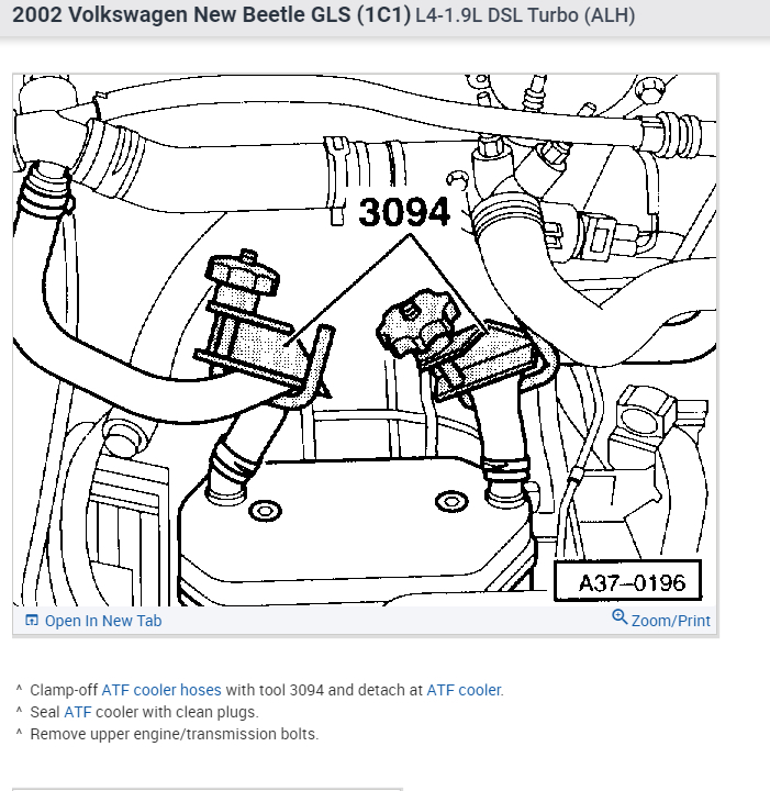

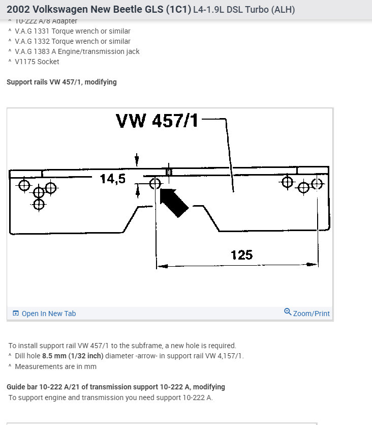

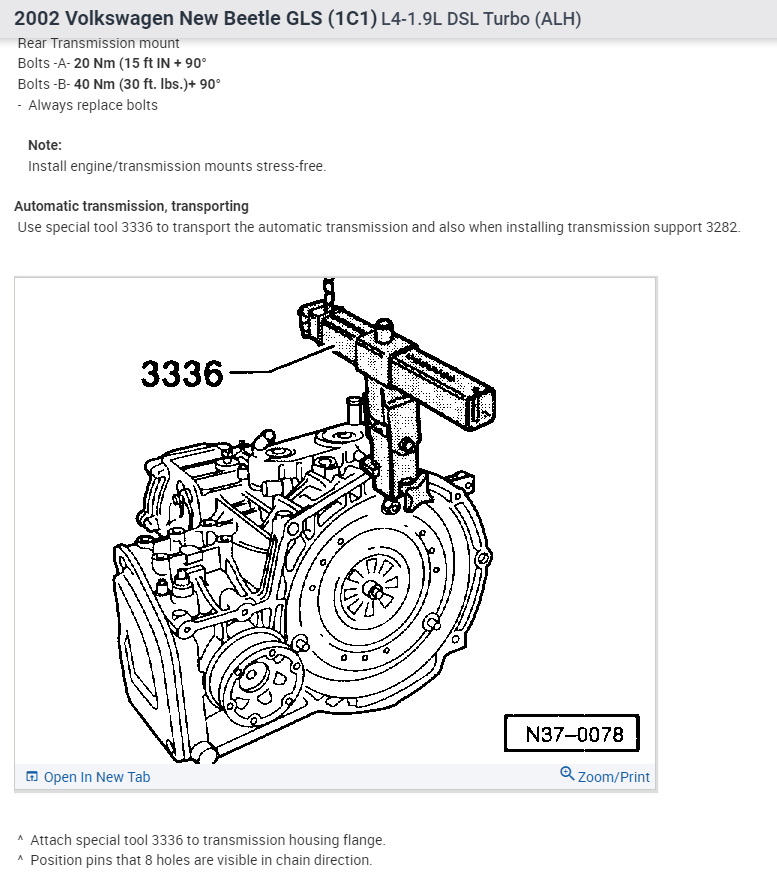

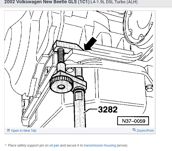

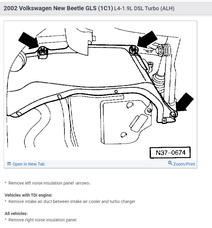

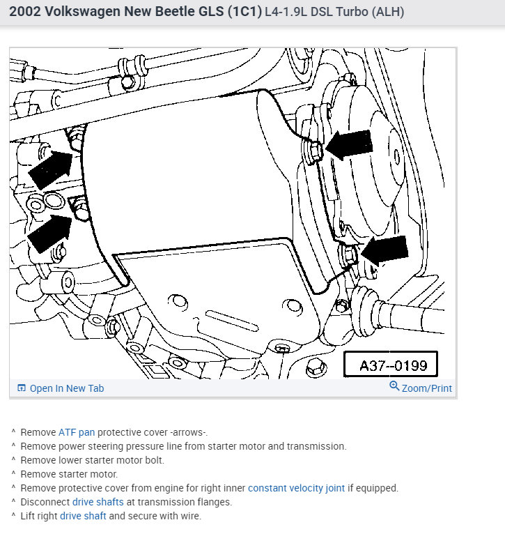

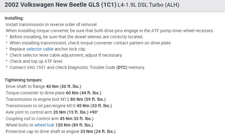

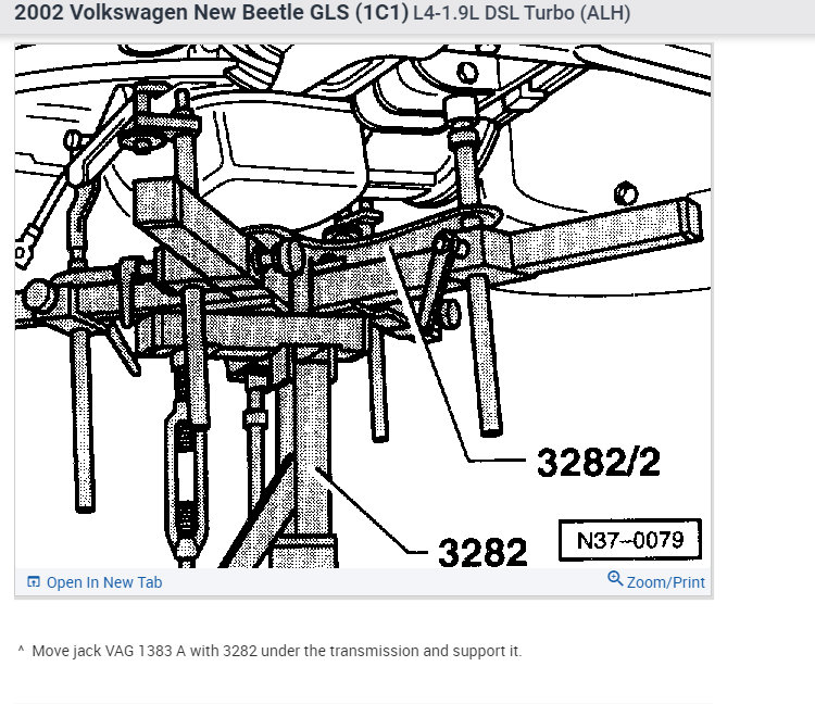

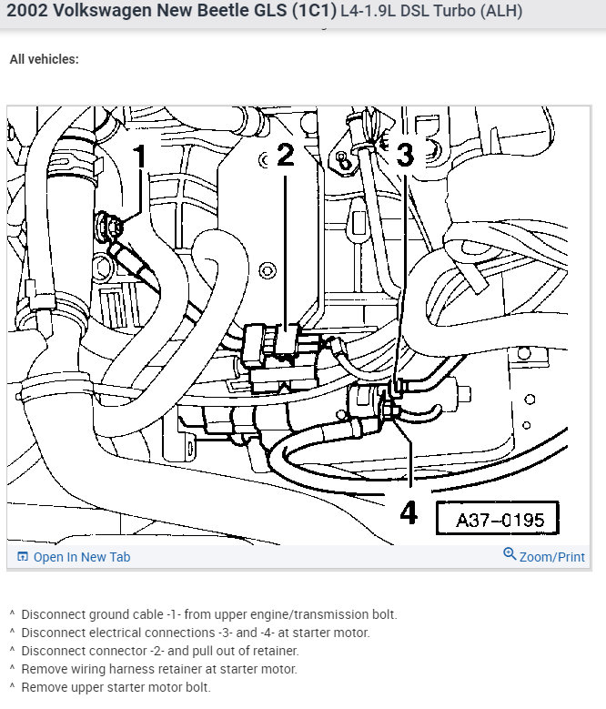

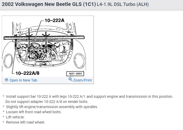

I have attached the transmission replacement procedure; in case you find a transmission that will fit.
https://www.2carpros.com/articles/how-to-remove-an-automatic-transmission-rwd
