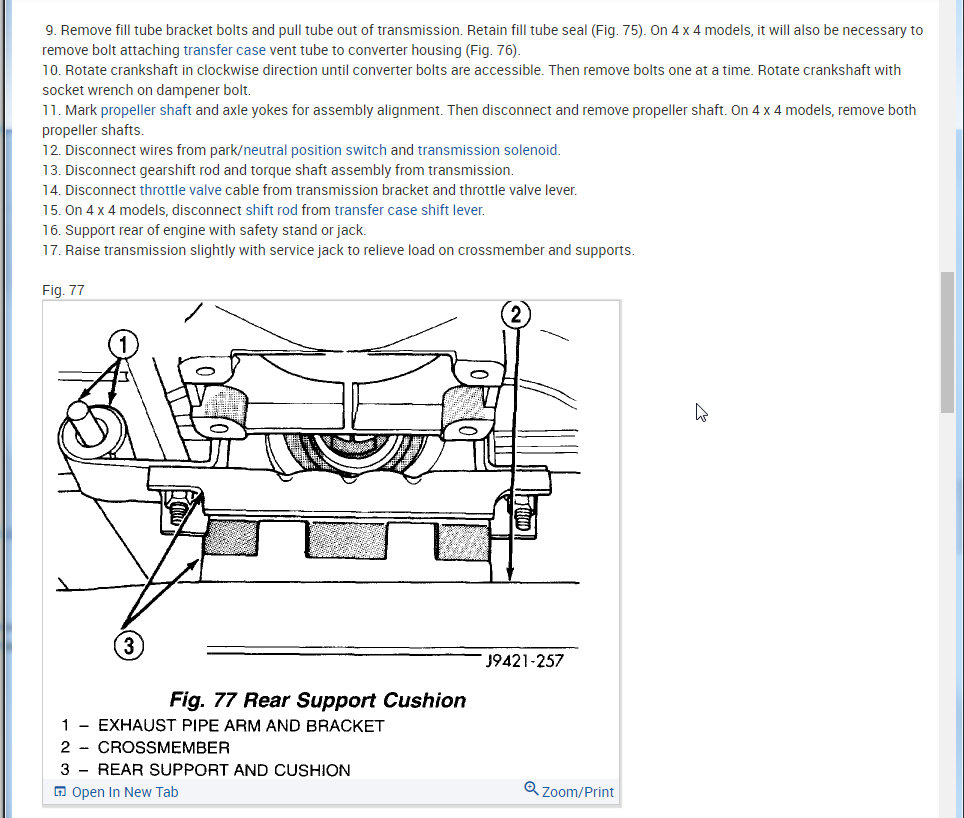

Will this ram I have described above transmission replacement, I need help
Mar 8, 2020 at 6:29 PM

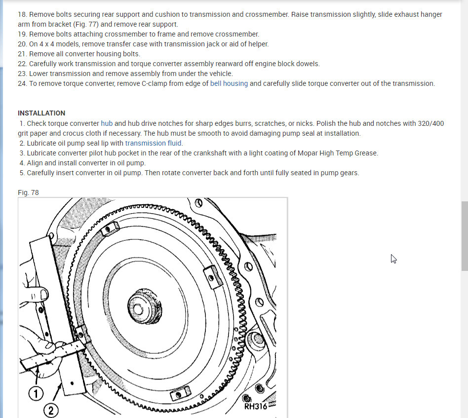

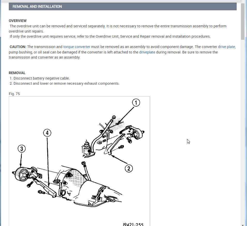

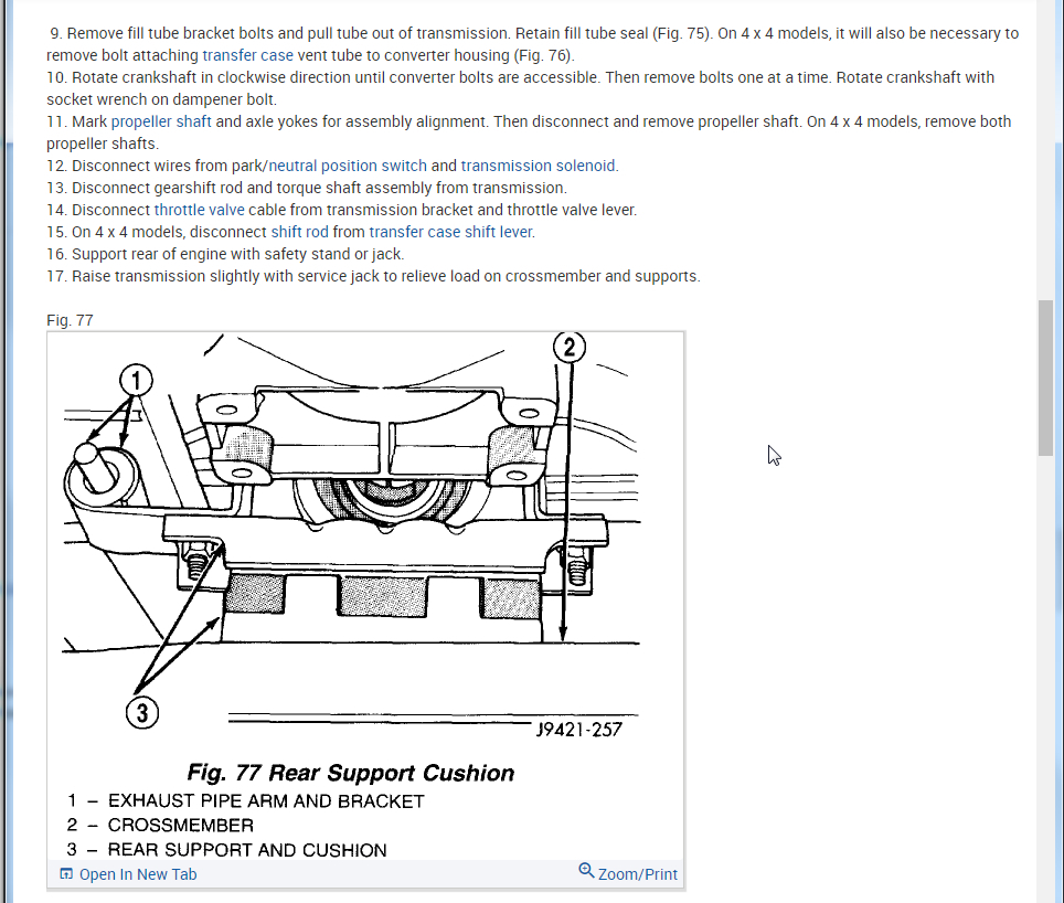

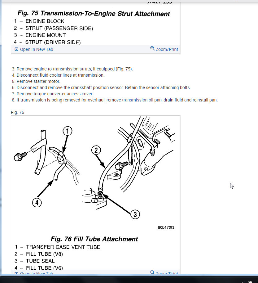

Here is a guide that will help with this:
https://www.youtube.com/watch?v=3vJAojsrfuU

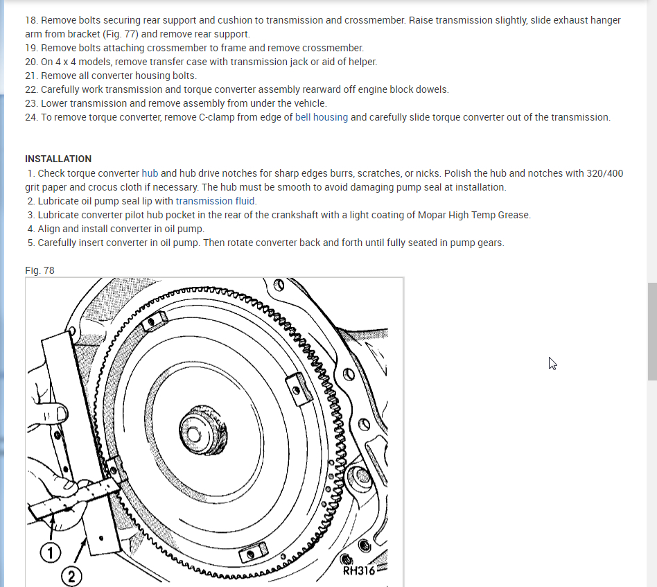

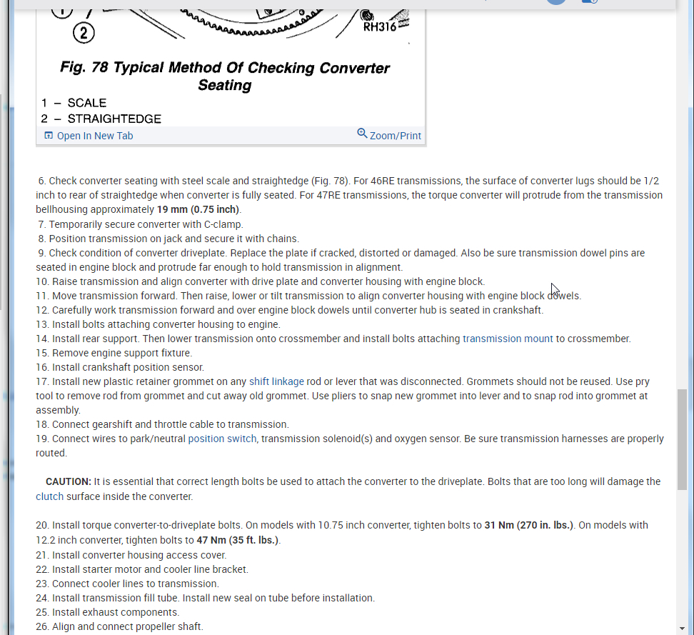

Below is the process from the manual on how to remove and install this transmission.
Please let us know if you have other questions and we can go from there. Thanks
