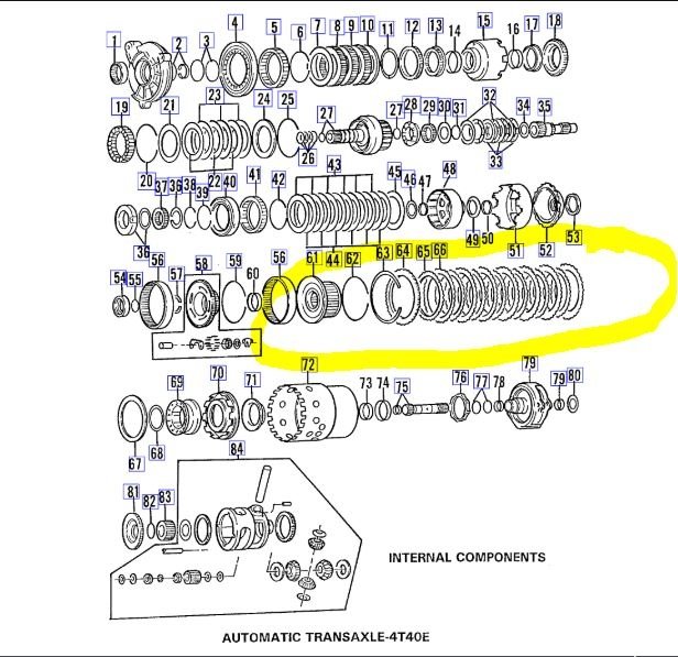

I have reverse but no forward gears.

It does sound like you have an internal failure in the transmission. The forward clutches may have failed not allowing forward movement.
You could try changing the fluid and filter in the transmission to see if the filter is clogged.
