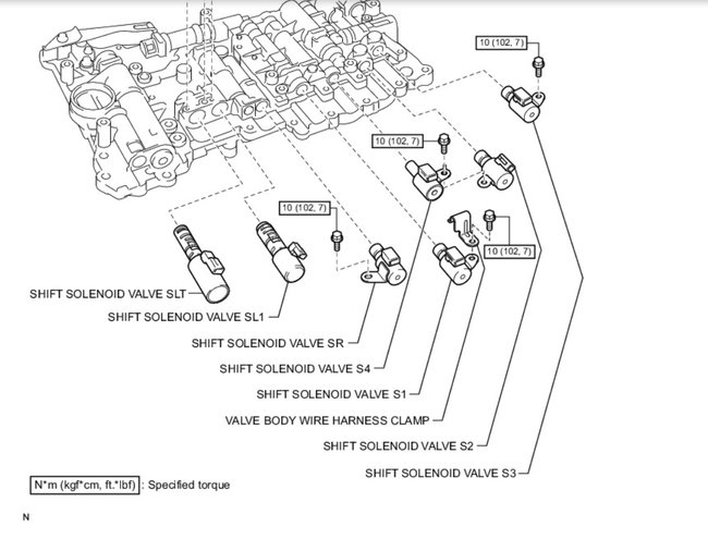

Transmission won't shift into 5 and 6 gears, but drives normal with all other gears. computer shows shift solenoid D, pressure control solenoid B, pressure control solenoid D, secondary air injector system switching valve stuck open bank 1. what do you suggest?

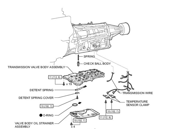

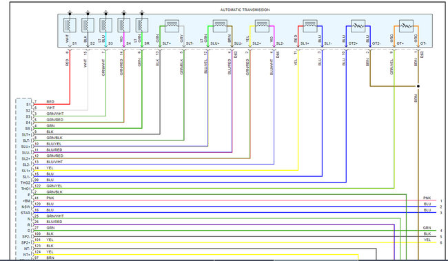

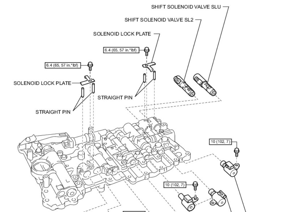

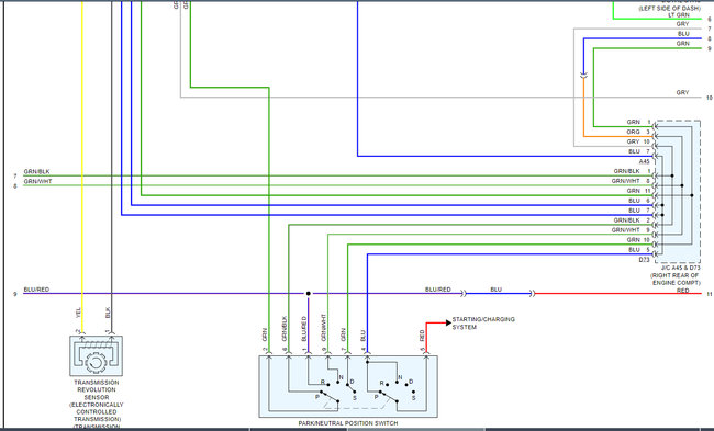

Okay, I attached a picture of the valve body and the location of the solenoids for you. Make sure you have battery voltage to the solenoids for them to work.

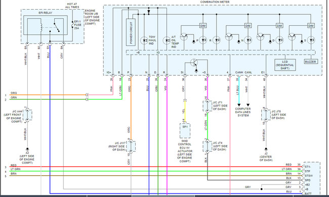

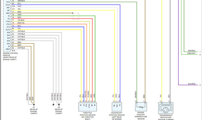

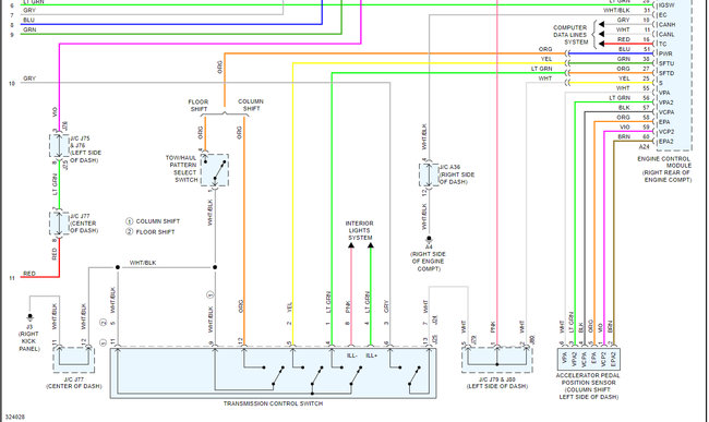

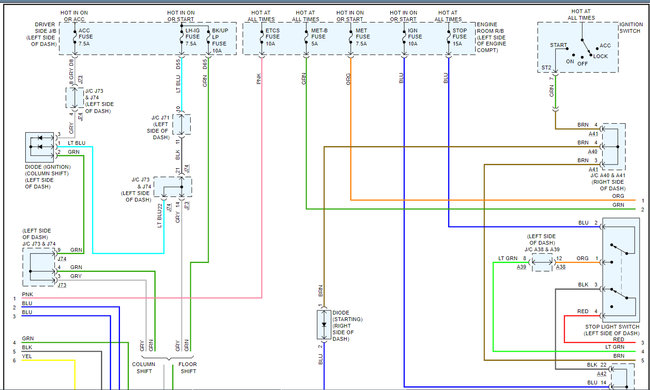

I also attached the wiring diagram for the transmission for you to view.
