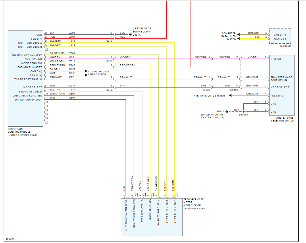

Transfer case will not shift to neutral or low. Automatic front axle doesn’t pull. I need a wiring diagram for the T-case circuits. Thanks

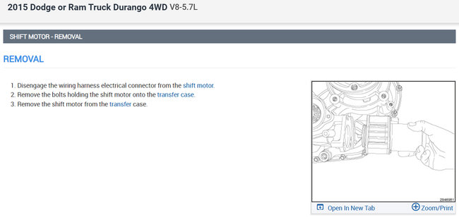

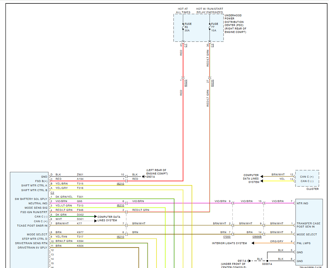

It could be the transfer case motor, but i would check the fuse# 32 and 77 in the fuse panel under the hood.
This guide can help:

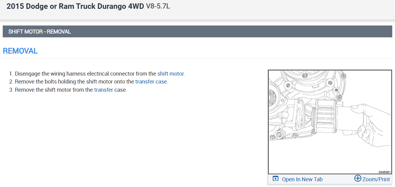

If the fuse is good, I have seen the transfer case motor go out on these trucks, here is the location of the motor and the transfer case wiring diagram as requested. Check out the images (below). Please let us know what happens.

Thanks. I’m a retired driveline mechanic and have worked on many 246s but if you don’t know how they work you can’t fix them. I was having too much trouble finding a wiring diagram for my personal Durango. Thanks again. I’ll let you know what I find out.

Got it ! Loose terminal connection inside the TCCM. I send to you a virtual beverage of your choice. Thanks.
