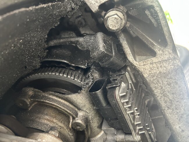

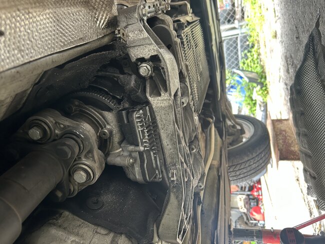

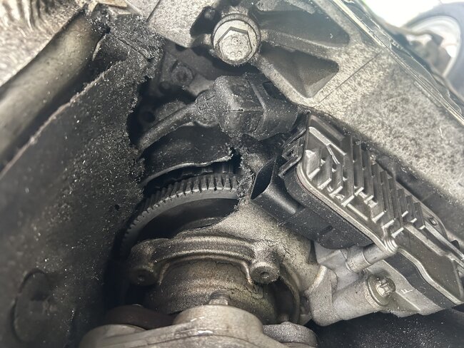

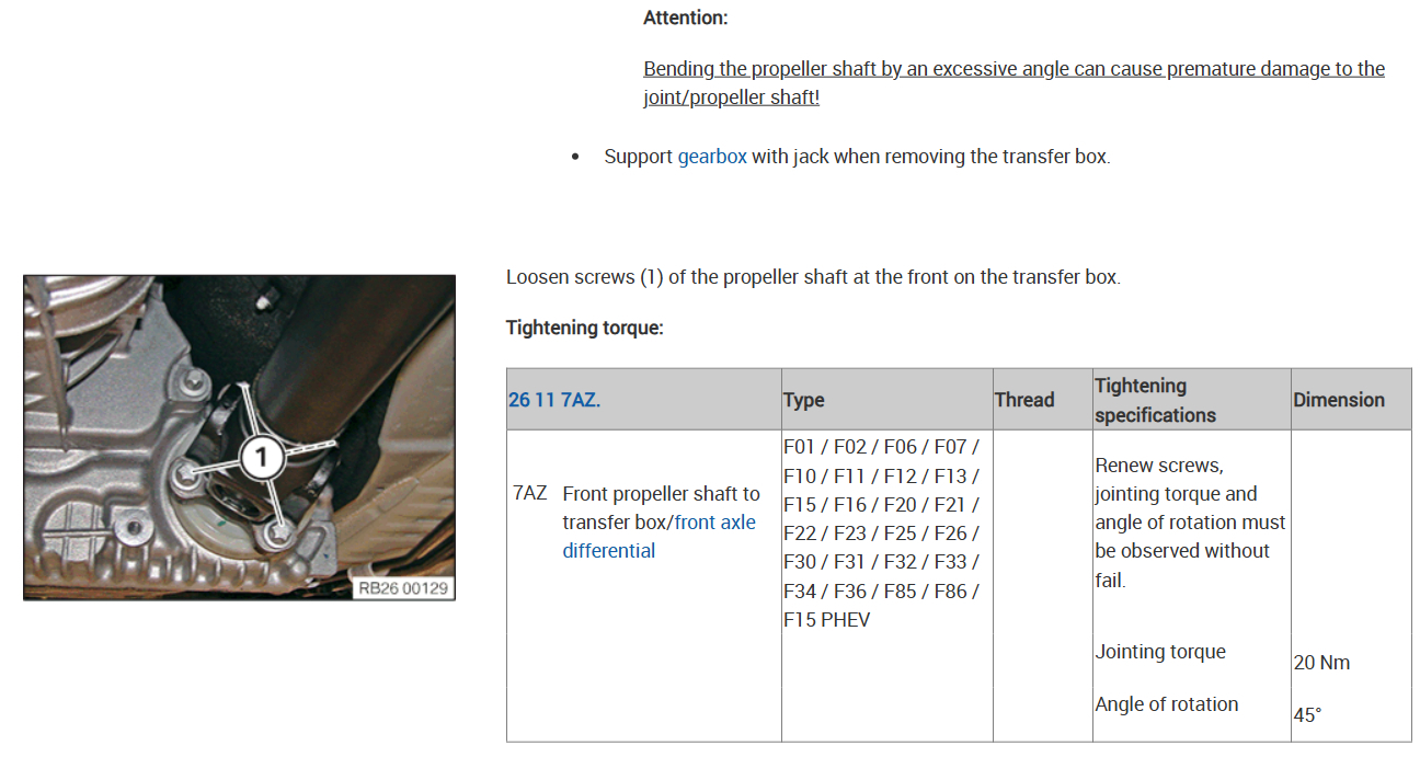

Greetings! I just bought this BMW, and it runs and drives great, but I could hear a noise coming from the transmission. I removed the muffler and the heat shield to access the rear driveshaft. This is what I found (see attached photos). It still runs and drives great. But I’m not sure what this part is. Is it the transfer case? Would this be an easy part to replace?

is there supposed to be fluid where that hole is? It doesn’t really show any signs of fluid leaking out anywhere.
Jun 4, 2025 at 6:33 AM
  • 55,224 POSTS
Hmmm, you found the problem. The case is blown up! The car will need a new or used transmission. I would try eBay for the unit and then swap it out. Let me know if you need instructions on how to R&R the transmission.

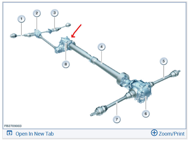

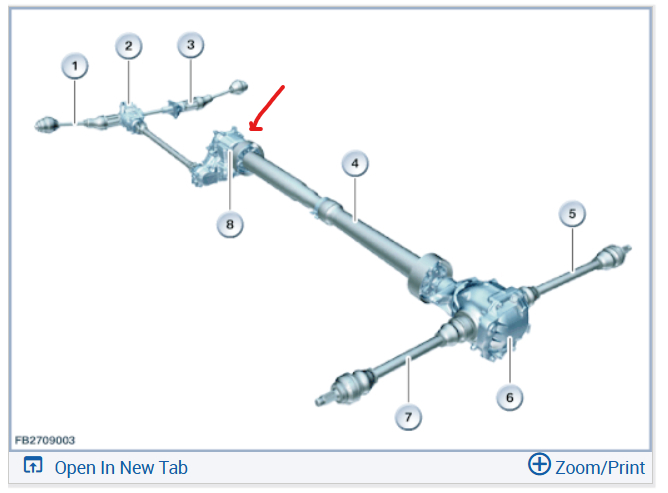

Is it the transmission or the transfer case?
I thought it was the transfer case that was mounted to the rear of the transmission and to the rear driveshaft?
Do you have a diagram that shows the transmission, the trans case, and the driveshaft?
I just want to make sure before I purchase the part. Thank you so much for your help. I greatly appreciate it.
Jun 6, 2025 at 1:48 AM
  • 55,224 POSTS
Yep, my bad, you need a new transfer case. Check out the images (below). Please let us know what happens.

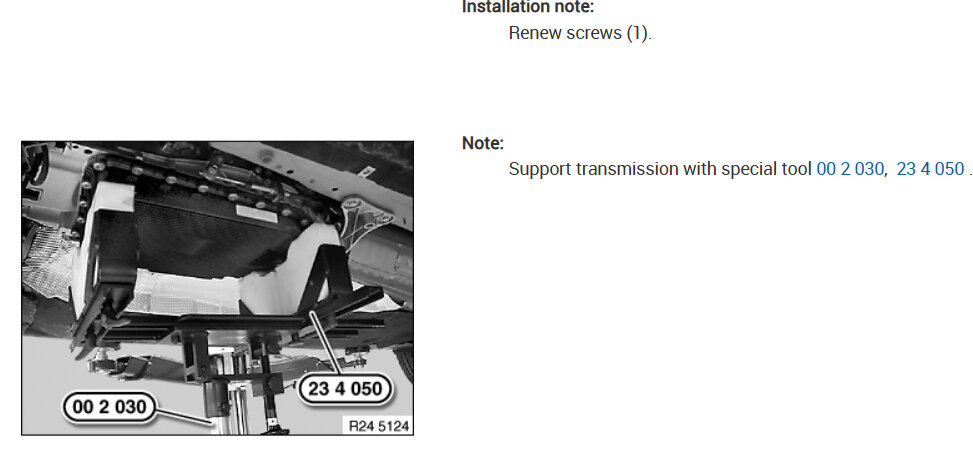

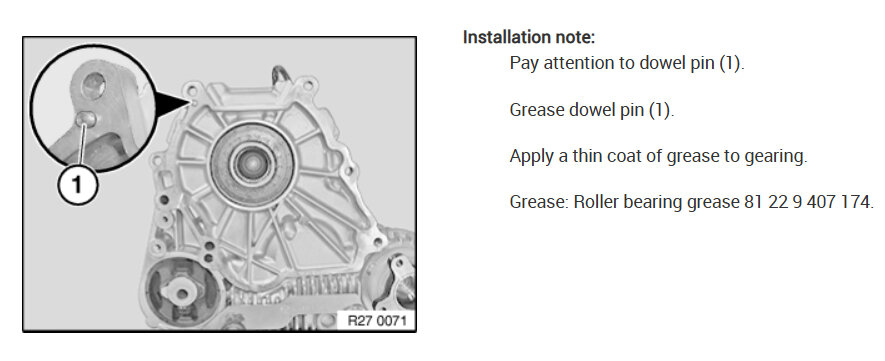

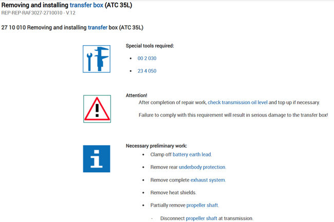

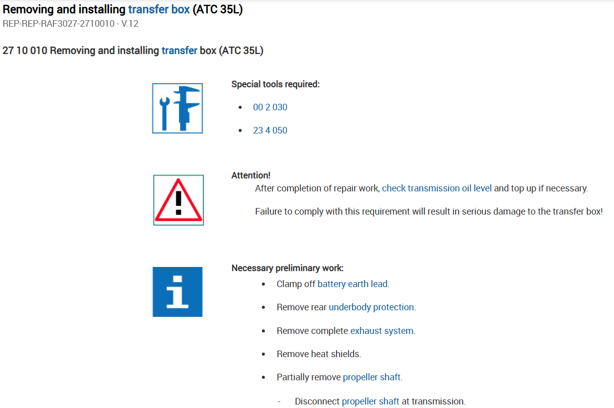

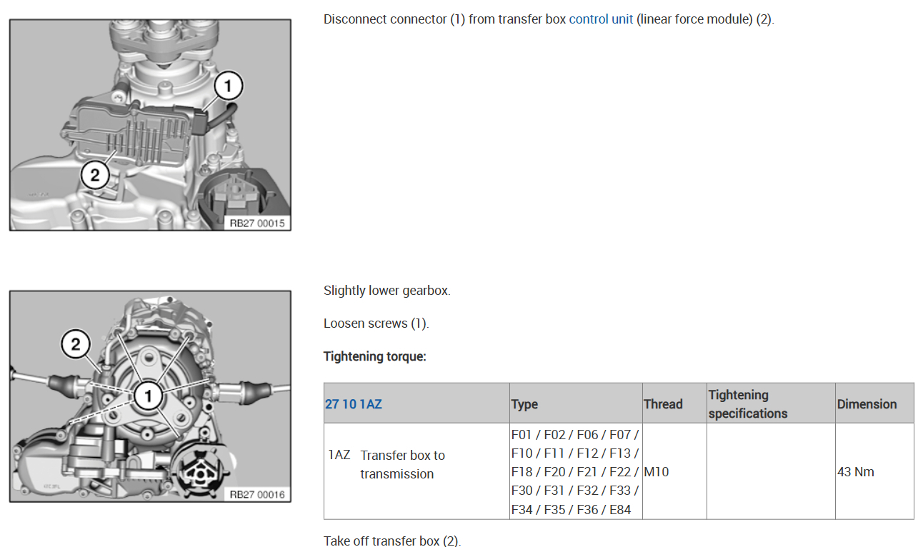

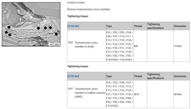

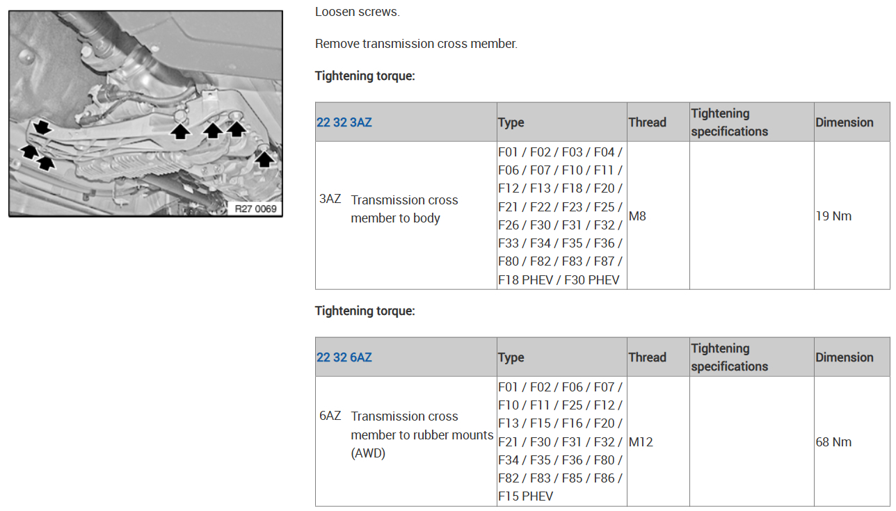

Many thanks. Do you happen to have the removal/installation instructions? I greatly appreciate it.
Jun 6, 2025 at 8:26 AM
  • 55,224 POSTS
Sure, here are the removal and installation instructions for the transfer case. Check out the images (below). Please let us know what happens.
Jun 7, 2025 at 2:21 AM

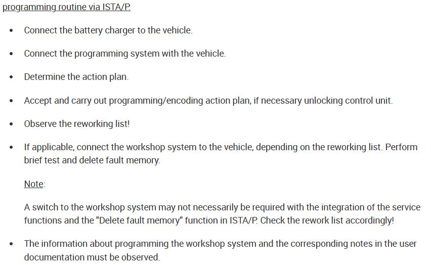

Hey Ken, transfer case is installed, and the car runs good. However, I did not know that you had to register or code the transfer case to the car. I do have a scan tool that will do that, but I will need to access the information on the transfer case. You don’t happen to have that procedure, do you?
Jun 16, 2025 at 10:39 AM
  • 55,224 POSTS
Good job on the repair. The instructions look pretty vague, I would try a hard system reboot to see if the allows the systems to re-initialize.
Here is a guide to help you:
https://www.2carpros.com/articles/step-by-step-guide-performing-a-hard-system-reboot-for-your-vehicles-electronics-systems
Here are the instructions from the manual. Check out the images (below). Let us know how it goes.
