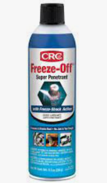

So, i am helping a friend pull a transmission. the upper two nuts that hold the transfer case to the transmission absolutely will not move. other ones did. and there is not much leverage up there either. i do have flex head wrenches but the things are on there. Sprayed a lot of PB on them. I wish i could use heat, but I'm scared to with how close to other components they are. Another pain in the butt is this truck is not too high off the ground.

I understand your concerns about using heat. Are you able to use an impact gun to see if that would break them loose?
Also, there is a product I've used in the past called Freeze Off. It's manufactured by CRC. I attached a pic below showing what I'm referring to. When you spray it on a specific bolt, it causes the temperature to drop on the item and causes it to contract. It's worked for me under some crazy situations. It may be worth a try.
See pic below.
