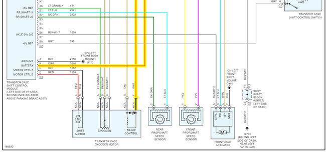

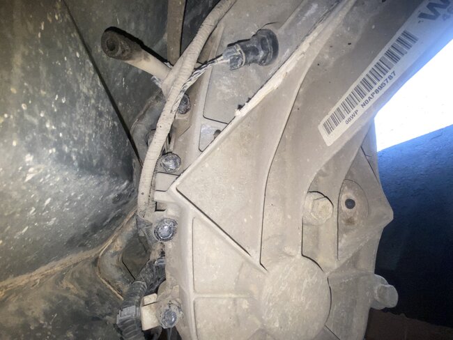

I have a 2003 1500 HD. I had a C0306 code but the service 4wd light only came on when driving in the rain. I was preparing to drive on the beach, and I shifted into neutral. Then shifted the transfer case from 2wd to 4wd high then as I shifted into 4wd low the selector switch lights went out, the service 4wd light came on and the 30-amp fuse blew. I tried to shift into gear, but I heard a loud grinding noise. The transfer case was in neutral. Next, I pushed it onto the street and flat towed it a half mile away. Next, I used a spare fuse to force the transfer case in 2wd and the fuse blew again.

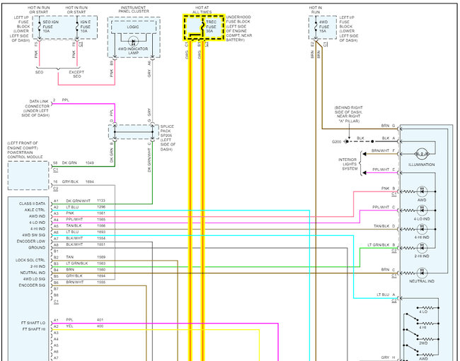

Based on the code you have and the following symptoms, I suspect a failure in the shift motor for the transfer case. Let's rule out any wiring concerns first. I would start by testing for a short to ground at the 30A TRCC fuse socket, just make sure you are on the correct side of the socket. If your ohmmeter shows a short to ground, then unplug the shift motor connector at the transfer case and retest. If the short goes away, you know it's in the shift motor. If not, then unplug the transfer case control module. Then, if you still show a short to ground, there is a wiring issue you would need to track down.
I cut the schematic into 2 sections so it's easier to read. I hope this helps, please let me know if I can do anything else for you.

I haven’t gotten the service 4wd light since, but I ran the same test again for everything including checking resistance in the wires related to the encoder motor. I checked while shaking the wiring harness and everything seemed okay. I’m going to clear the codes again to see if they come back. It’s also going to rain today so I will see if that makes the service 4wd light come on. I’m not sure where else to look or test if the light and code come back. If you have any other advice, please let me know.

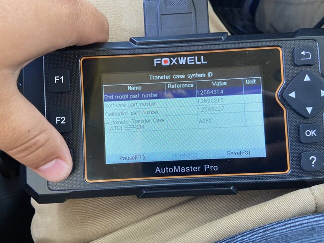

Light didn’t come on, but codes did. I drove home then put the scanner on it and drove it for 8 minutes after clearing the codes then used the 4wd went into every mode then checked codes again and nothing. I’m putting the videos in chronological order. It did not rain so I couldn’t determine if the service 4wd light would come on again. I do not have a lot of confidence in using the 4wd because I drive on the beach every weekend and I would like it to be reliable. If I cannot determine the issue, do you think it be wise to buy a manual transfer case?
