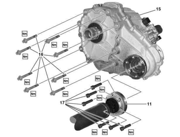

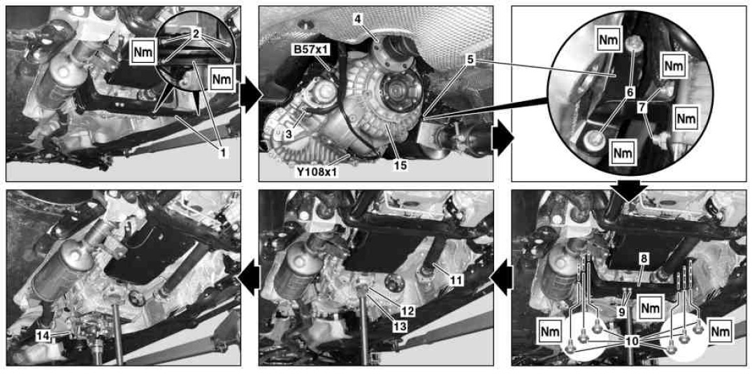

Car has an announcement of a transfer case not engaging, not sure what that means. No codes in the system. Worst case scenario is that it will need a replacement. Would like to know the procedure for replacing it with a used one, in case i buy the car tomorrow. I hear sometimes it's the chain inside the case or even the motor as the case in BMW's x5.

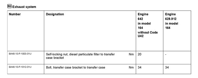

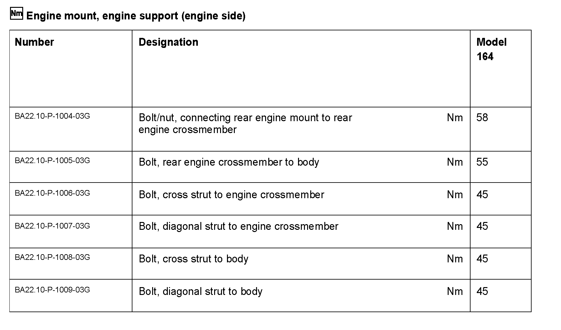

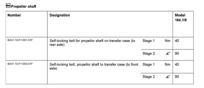

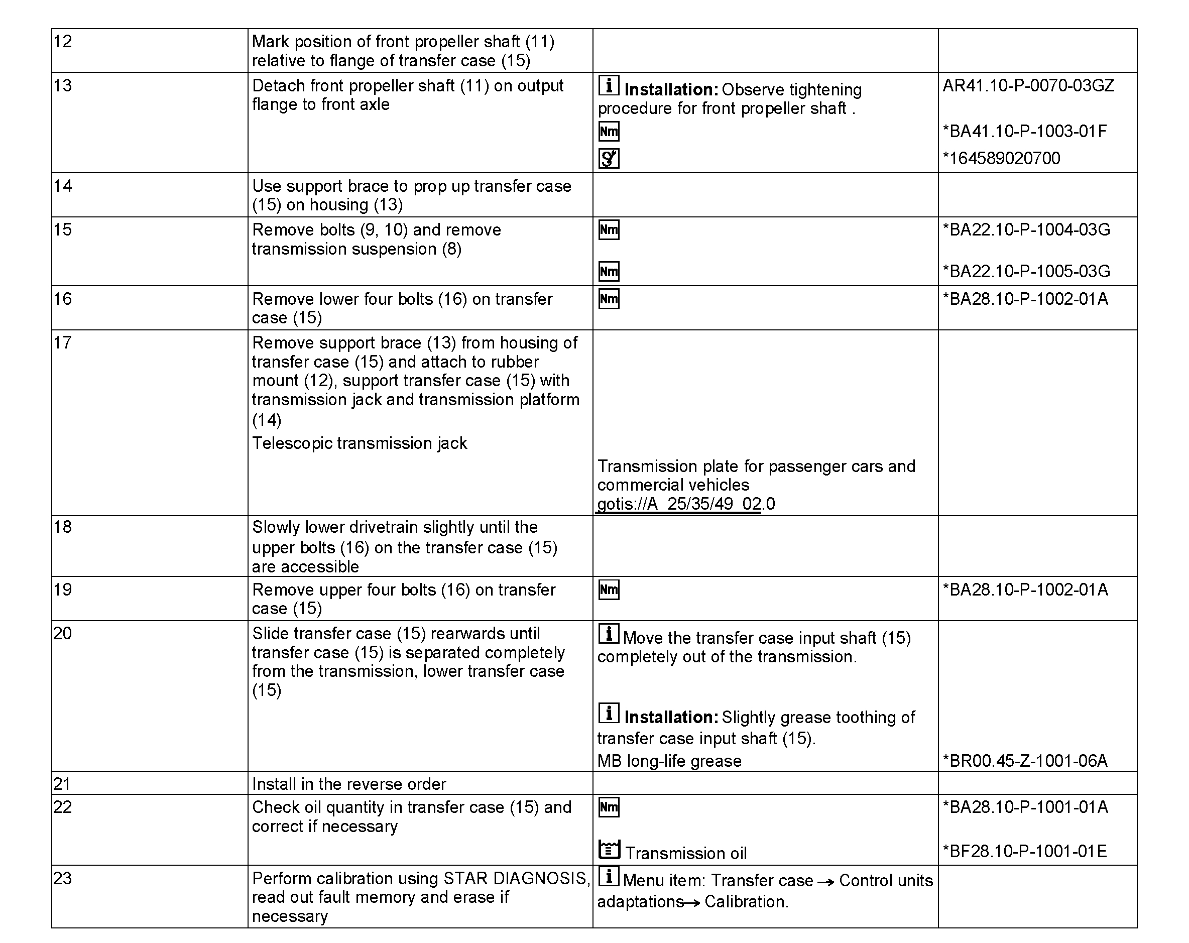

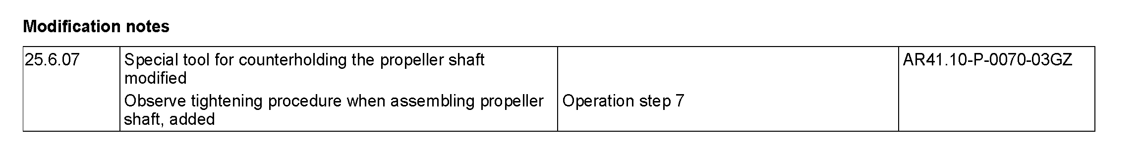

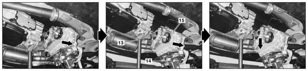

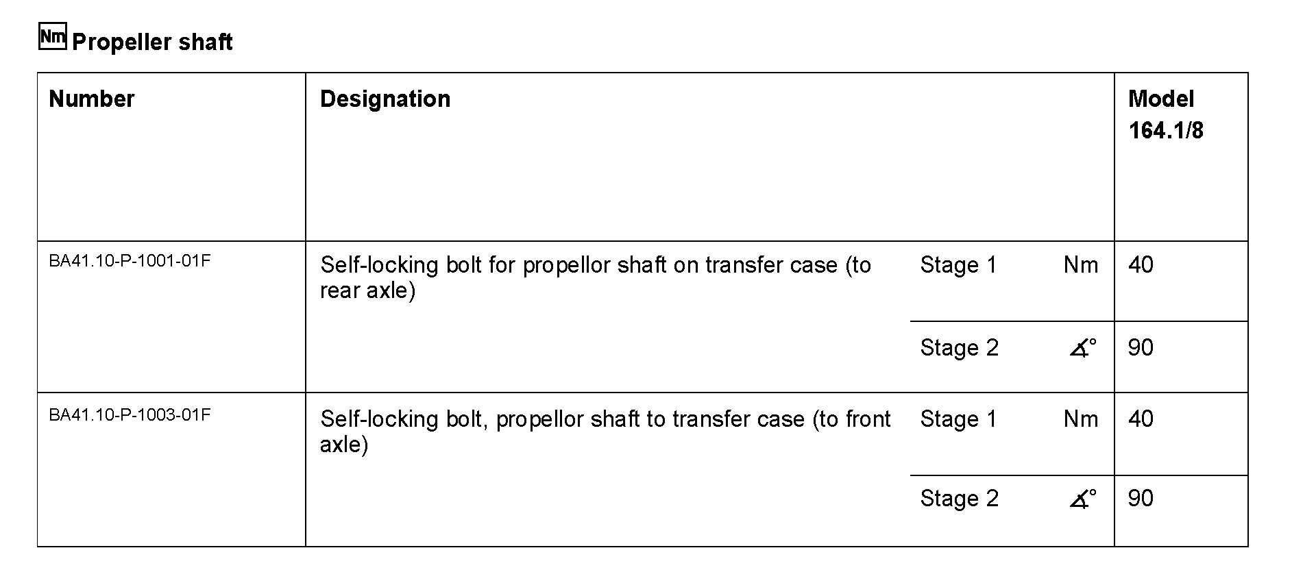

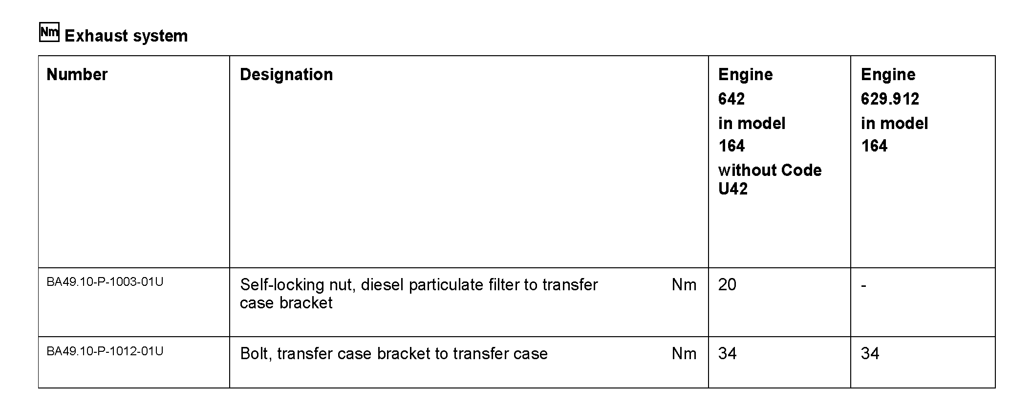

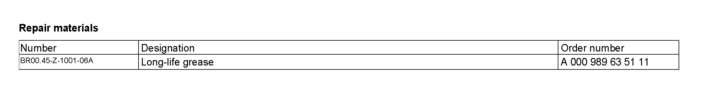

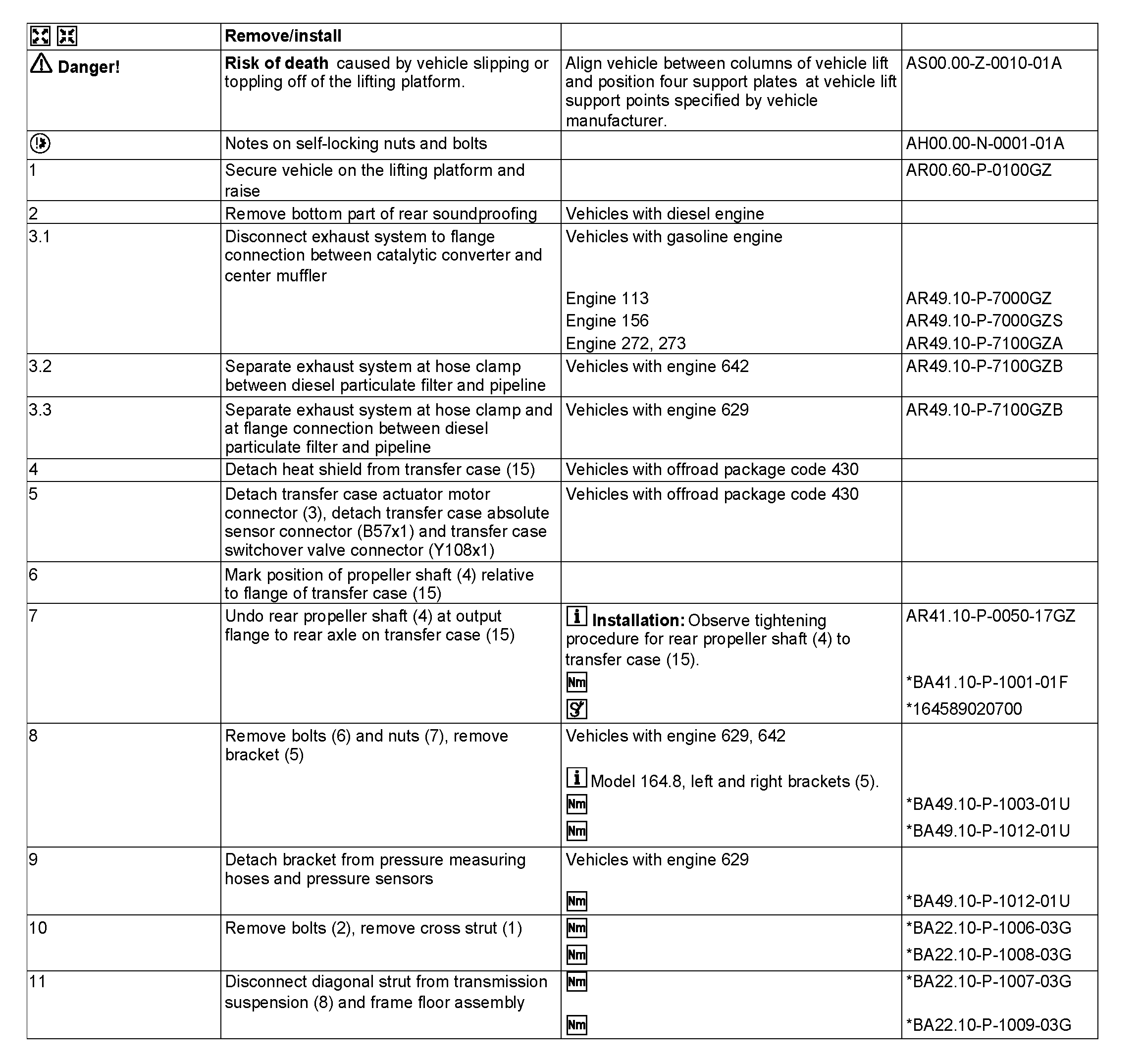

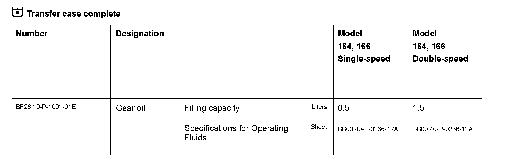

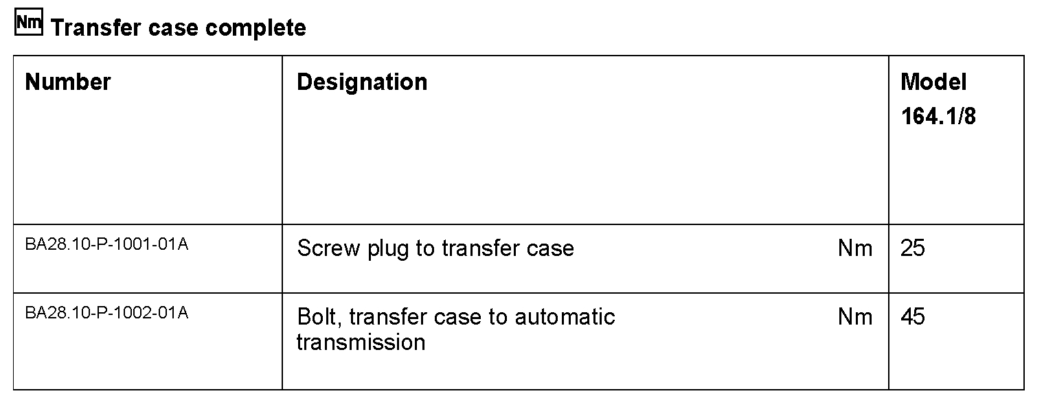

There are a few different thing that can cause it to fail. However, here are the directions for removal and replacement. The attached pics correlate with the directions.
___________________________________
2009 Mercedes Benz Truck ML 350 4MATIC (164.186) V6-3.5L (272.967)
AR28.10-P-0100GZ Remove/Install Transfer Case
Vehicle Transmission and Drivetrain Transfer Case Service and Repair Removal and Replacement AR28.10-P-0100GZ Remove/Install Transfer Case
AR28.10-P-0100GZ REMOVE/INSTALL TRANSFER CASE
MODEL 164
pic 1
Shown on model 164.1 with engine 642, with off-road package code 430
1 Cross strut
2 Bolts
3 Transfer case actuator motor connector
4 Rear propeller shaft
5 Bracket
6 Bolts
7 Nuts
8 Transmission mounting
9 Bolts
10 Bolts
11 Front propeller shaft
12 Rubber bushing
13 Support brace
14 Transmission platform
15 Transfer case
B57x1 Transfer case absolute sensor connector
Y108x1 Transfer case switchover valve connector
pic 2
Shown on DOUBLE-SPEED transfer case, with off-road package code 430
15 Transfer case
16 Bolts
17 Bolts
pic 3
13 Support brace
15 Transfer case
pic 4
pic 5
pic 6
pic 7
pic 8
pic 9
pic 10
pic 11
pic 12

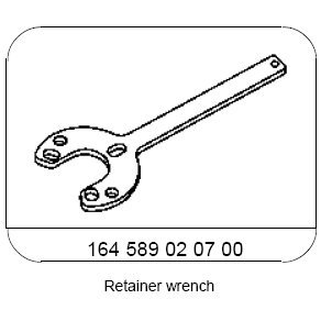

164 589 02 07 00
Retainer wrench
pic 13
