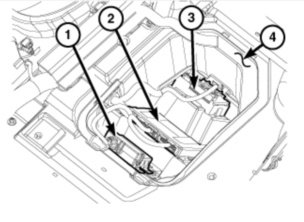

I am driving the vehicle listed above. I am experiencing Transfer case noise whenever shifting from P to D or to N or to R, it keeps clicking for some 5 seconds and stops then clicks while stopping at junctions. I can also feel some binding at rear tires at strong turns. Further, the Jeep isn't shifting / engaging in 4WD Low. All tires are same and in excellent condition. A mechanic says that this noise is from Transfer case motor. I have already changed all fluids Transfer case, Front and Rear Differentials. I am in KSA mechanics are not well versed. I have read here the same question asked by ZAIN7 some time ago.

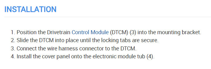

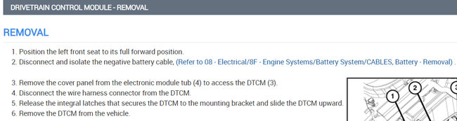

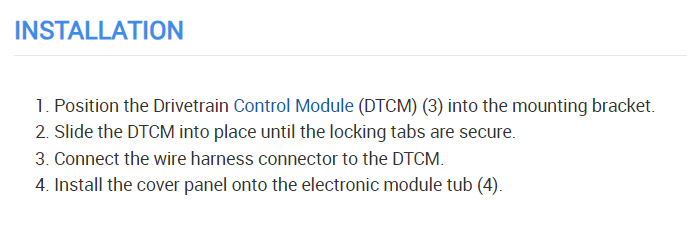

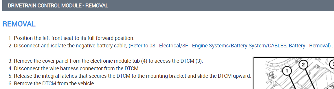

Yep, the transfer case control module DTCM is in the lower seat well on the drivers side and can get moisture in it, here is the location of the transfer case module so you can check it out.
DTCM VERIFICATION TEST
Diagnostic Test
DRIVETRAIN CONTROL MODULE (DTCM) VERIFICATION TEST
NOTE: If the DTCM, Powertrain Control Module (PCM), or Body Control Module (BCM) was replaced, refer to the Service Information for proper programming and alignment procedures.

Yes, the problem should be the DTCM near the driver's seat. Sorry for the confusion.

Hi. I got today DTCM from dealership. I changed it myself, voila.... The noise is gone.... 4wdLow is engaging..... 4wd Service light is gone. Thank you very much... For your help and pinpoint diagnosis...
