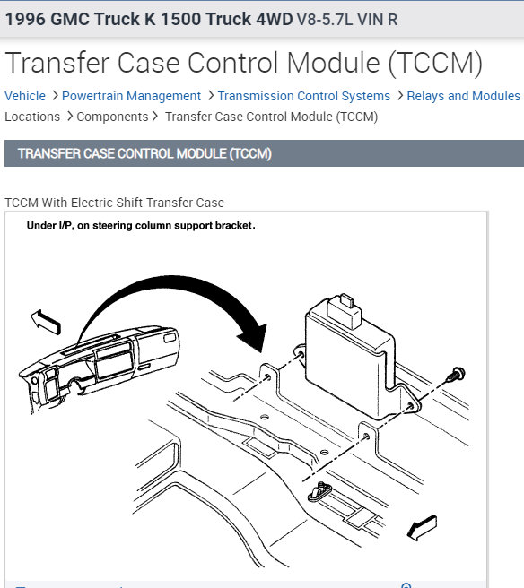

How to find out what part number? I need to replace my transfer case module control. There is no label in it anywhere.

The factory part number for the transfer case control module is 15740507.
Keep in mind that it might be a good idea to call your local GM dealer and provide them with your VIN, they can also verify this info. As sometimes depending on the location of the manufacturing, the part can be slightly different.

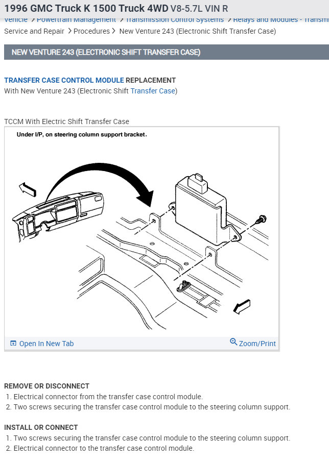

The TCCM is located under the instrument panel, on the steering column support bracket.
