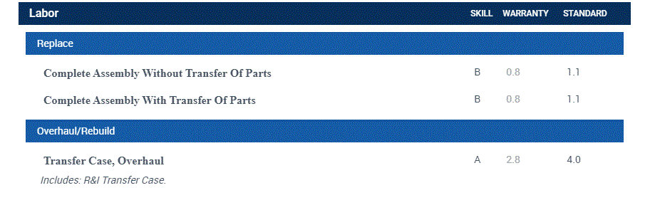

Hey Boys, could you confirm the labor time to removal and install transfer case on the vehicle listed above with a K20 engine, MRVA transmission? I'm getting 1 hour, but want to cover my backside. By the way, I came across your YouTube videos... Awesome! As always hope everyone is well, and thanks a bunch.

Good morning,
Hope you guys are well.
It looks like an easy one from Alldata. It pays not much more than an hour.
I attached it below for to view.
My best to everyone.

yea, ours is a little outdated so said an hour.. Still 1.1 seems too easy... Lets pray if we book the job, it's as simple as it says. Thanks Roy.

I would add about 1/2 hour for the unexpected things that come up just to cover your time.
You are welcome.
Always glad to help.
