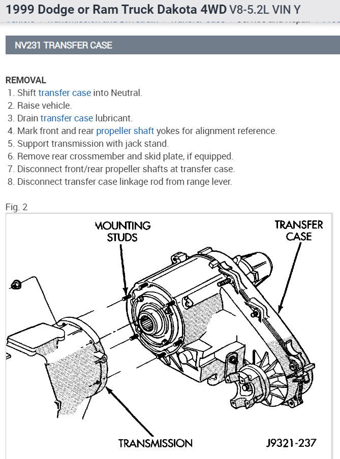

I need to replace the transfer case 231D, but I can only find a replacement from an automatic transmission. Will they interchange?
Oct 30, 2023 at 3:16 AM
  • 55,224 POSTS

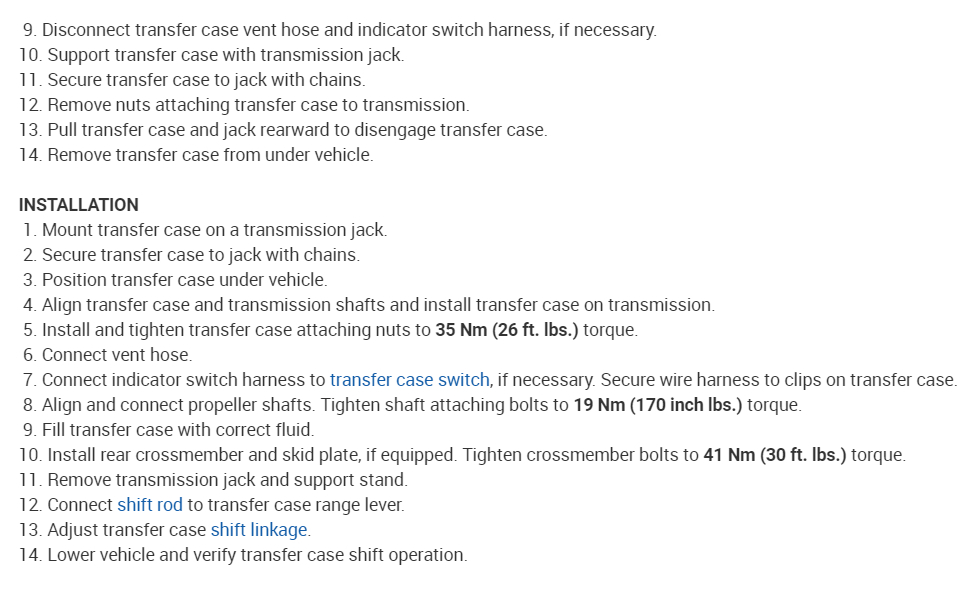

The New Process (or New Venture) 231 transfer case, commonly referred to as the NP231 or NV231, was used.
Here are the instructions on how to change the transfer case out. Let me know if you have any more questions or problems I can help with. Check out the images (below).
