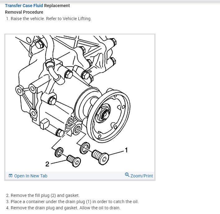

I'm trying to check the fluid level in my transfer case, but I don't seem to see the check bolt. My Haynes doesn't cover AWD and I can't find anything online or on YouTube.

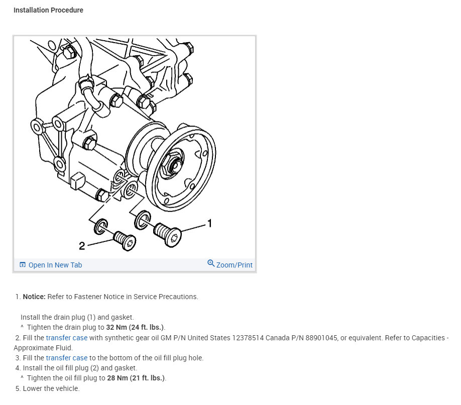

Here is the procedure we have on Alldata. Please let me know if you need more information and I will try to look in other places. Thanks

Thanks a bunch. I also wasn't able to find anything reliable about what fluid to use, so this is very helpful.
