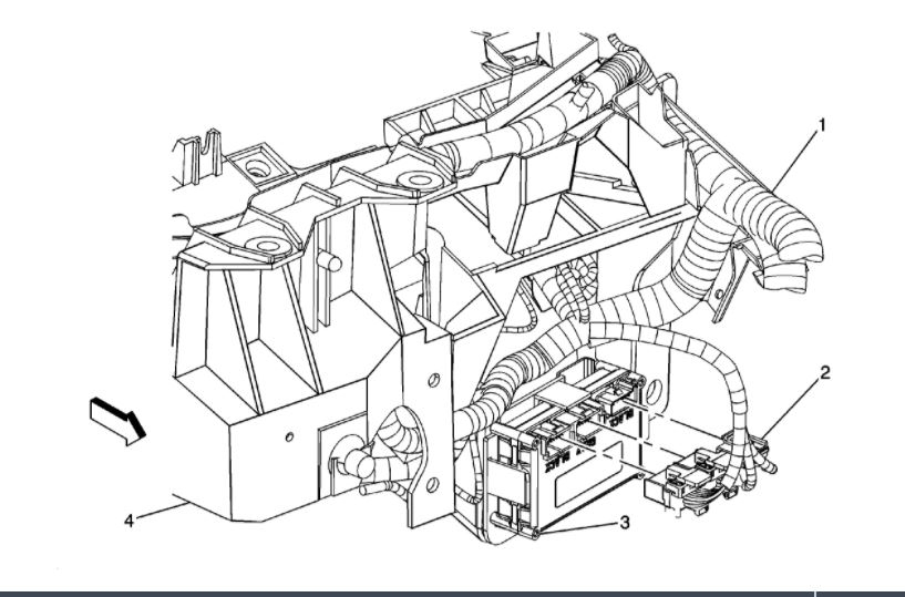

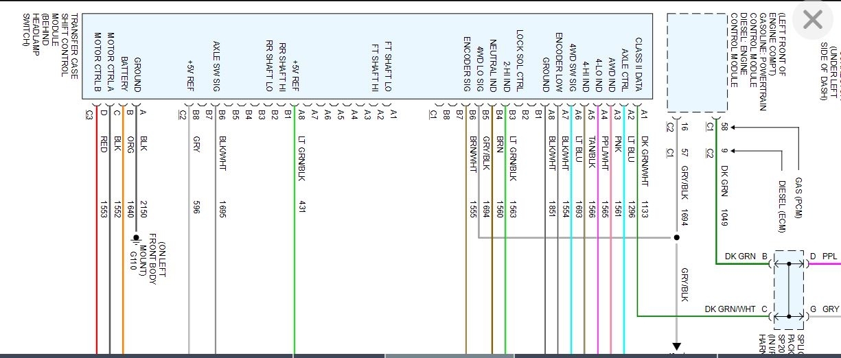

System had 12.6 volts. I did a volt drop test on my grounds. The transfer case control module ground to chassis volt drop was 11.8 volts. The C pin black on 4 pin harness(black, red, black and org) on TCCV module was unplugged an had 11.6 volts. C pin on harness had crazy numbers in the hundreds
I had 5.06 volts at switch and on pins on TCC module (5v reference and encoder signal).
On harness (unconnected) at encoder motor I had org 12.6v, tan 11.8v, light green/black 0.0v, black/white 12.6v, brown/white 10.6v, red 12.25, black 10.1v. I am unable to get 5 volt references at this end of harness.
My questions are:
Are grounds out of voltage a issue? Do you think 5 volt reference wire light green/black is open somewhere.
Is module trash?

Good morning,
The only reading that is not correct is the ground wire. There should be 0 volts on a ground wire. If you have voltage on the ground, it is not grounded at all.
The rest of the readings are okay except your battery is low. It should show 12.6 volts, not 11.6 volts.
I would repair the ground wire and see if it works. Otherwise, I would replace the module.
In The Left Side Of The I/P Behind The Headlamp Switch

My battery volt was 12.6 volt the 11.6 volt was at harness connection of encode motor when not to frame.
I get all 5 volt signals at module, just not when harness is plugged in going to encoder motor.
Dec 28, 2020 at 10:41 PM
Okay, but if it is ground, there should be 0 volts on a ground circuit if it is properly grounded.
