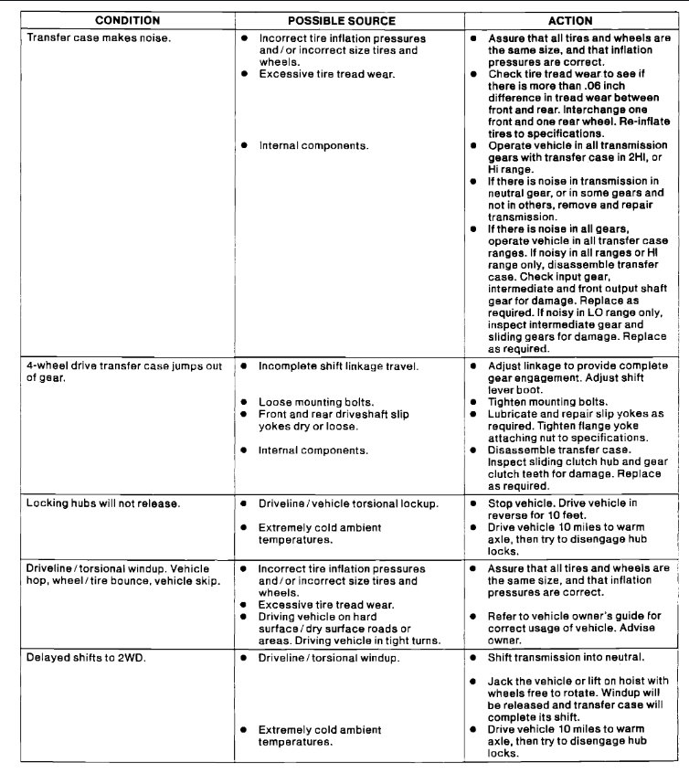

Where is the noise coming from in 2WD or High? If this is coming from the transfer case, then more than likely the input shaft or drive chain is slipping.
I would suggest removing the front drive shaft and see if the noise goes away.
https://www.2carpros.com/articles/how-to-remove-a-drive-shaft
Basically, if this is happening in 2WD as well then, we may have a different issue. However, the input shaft is just a pass through in 2WD so it is still turning.
In Low, the power flow is different, so I suspect we have an internal issue.

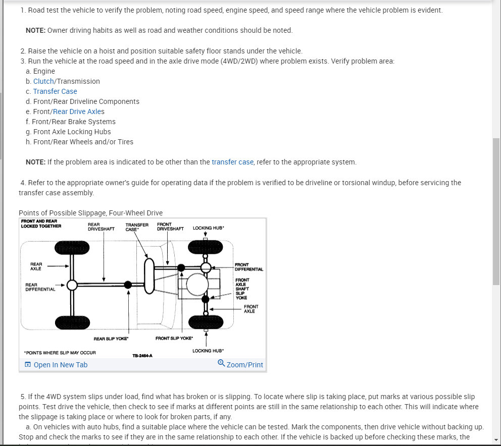

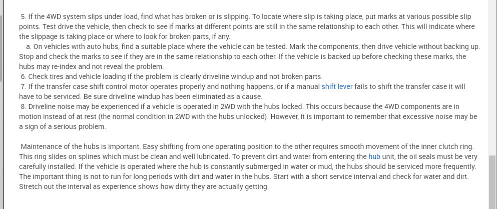

I am attaching the basic testing as well that we need to run through in order to prove this out.
Let me know if you have questions but it sounds like we may need to replace the transfer case.
