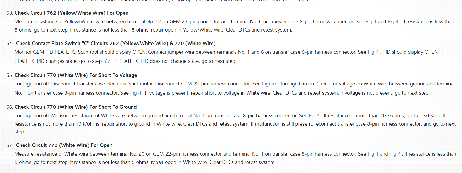

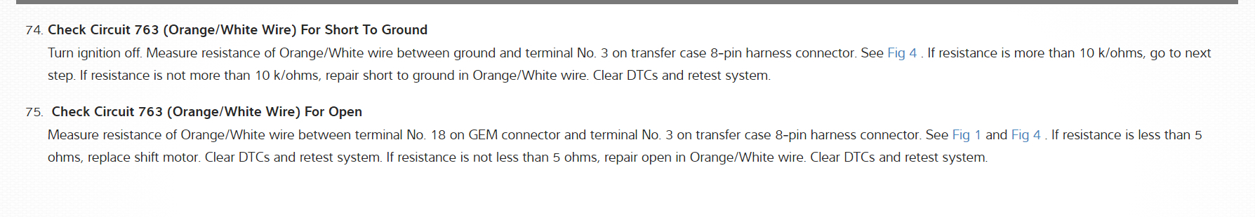

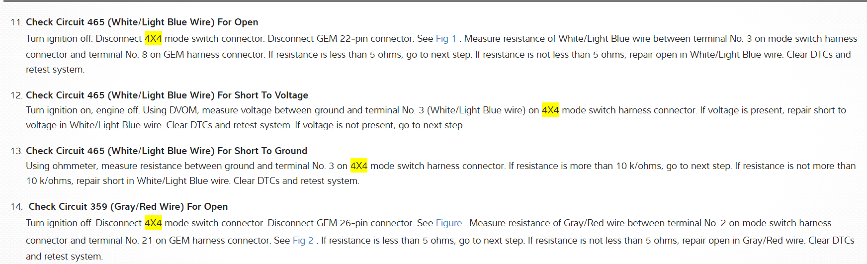

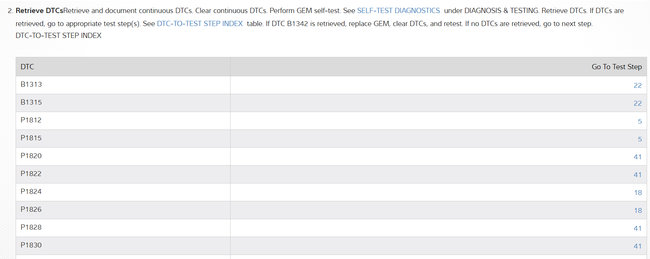

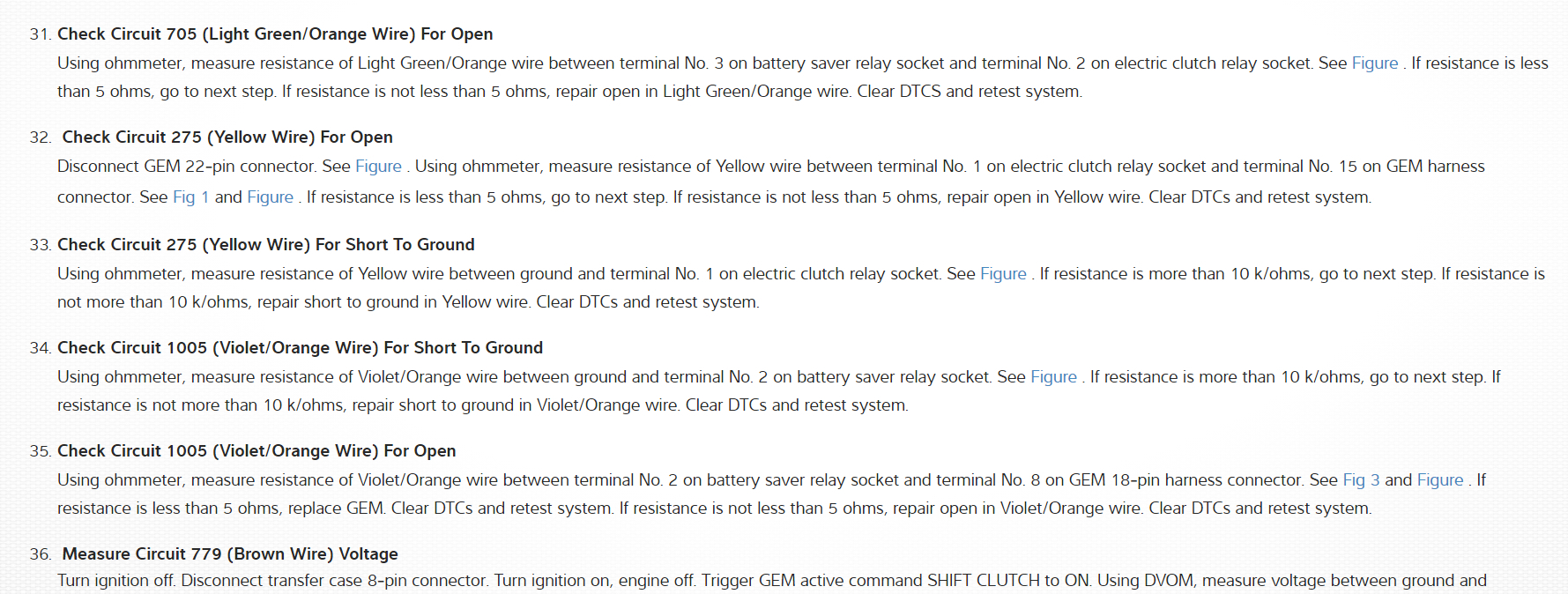

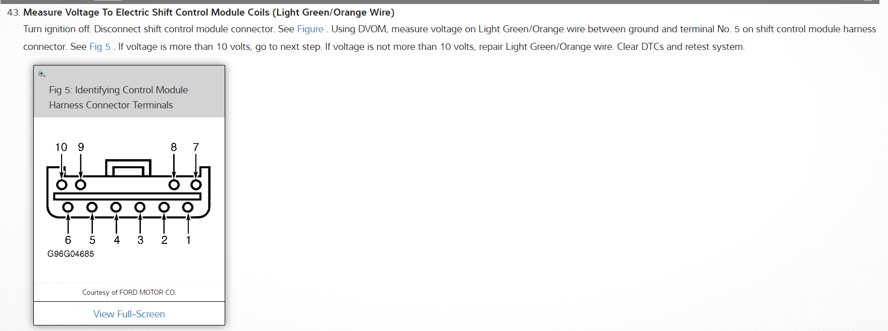

Very cold outdoor temperatures today. The 4x4 indicator lights high and low are flashing simultaneously, and it is not disengaging.
Mar 4, 2019 at 1:00 AM
SCGRANTURISMO
  • 4,897 POSTS

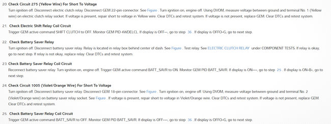

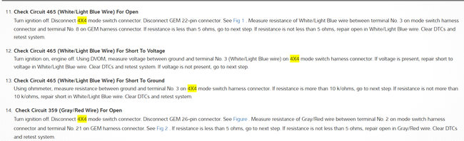

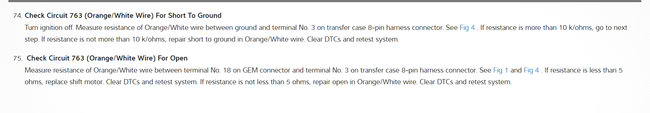

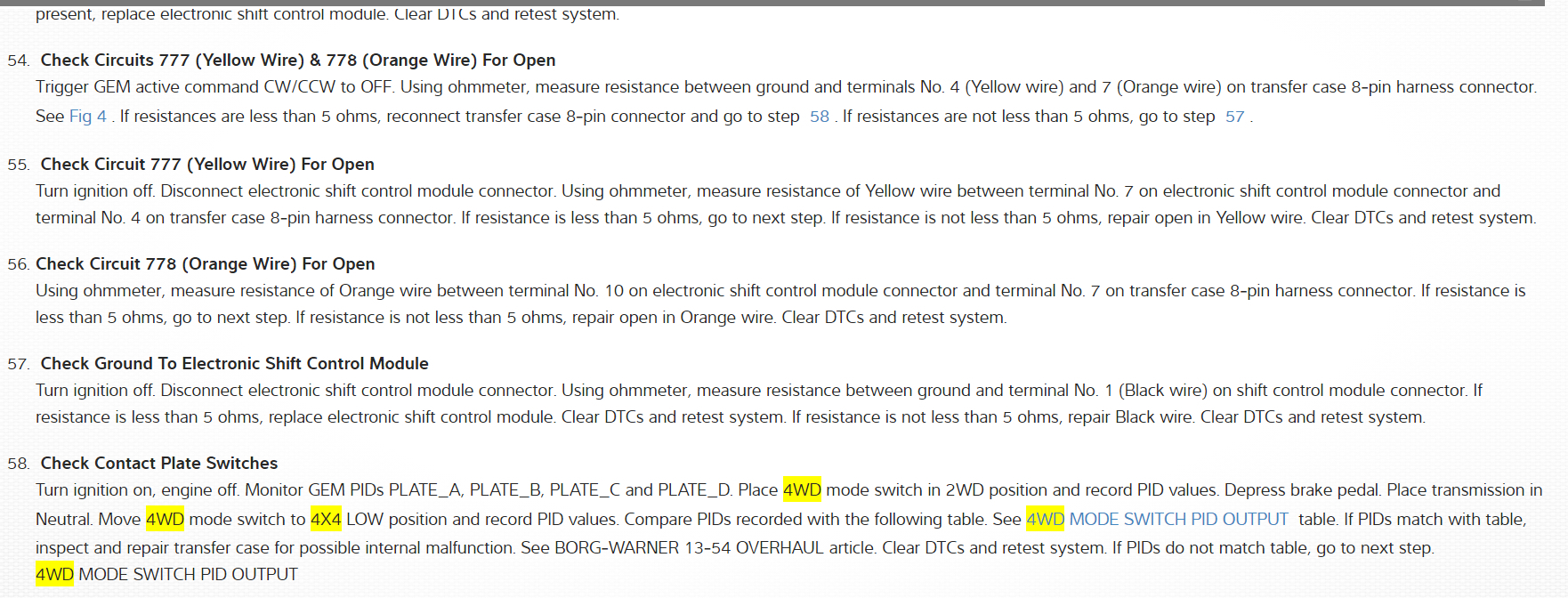

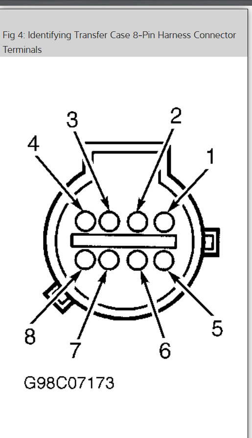

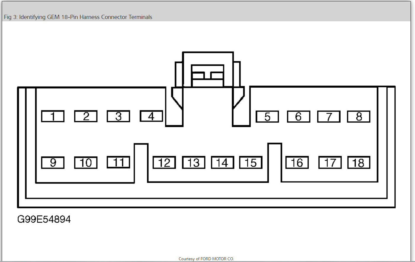

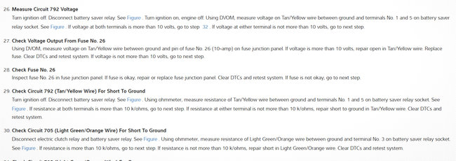

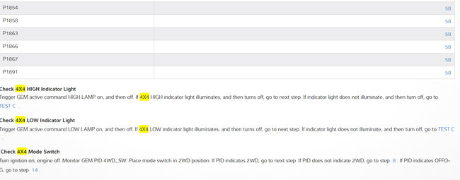

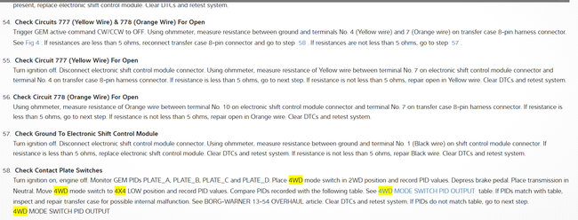

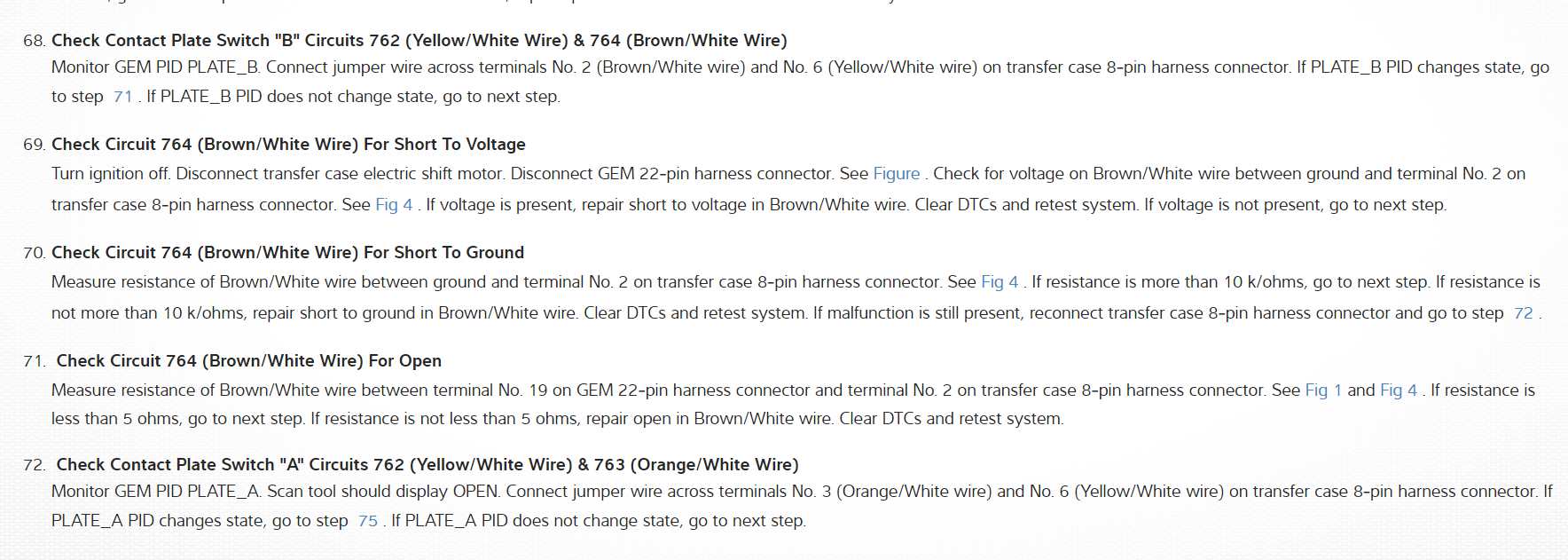

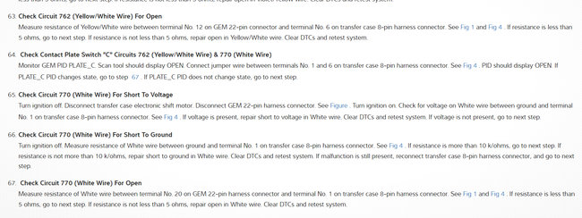

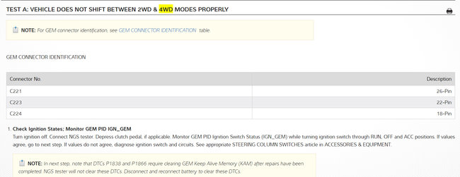

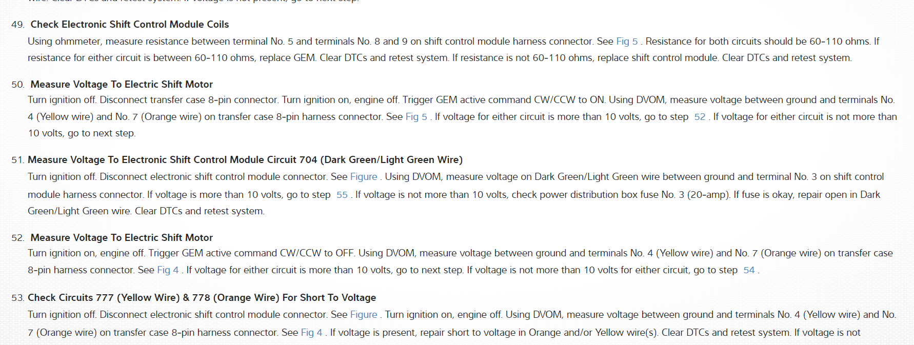

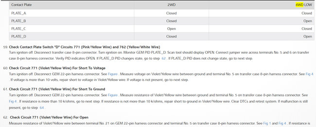

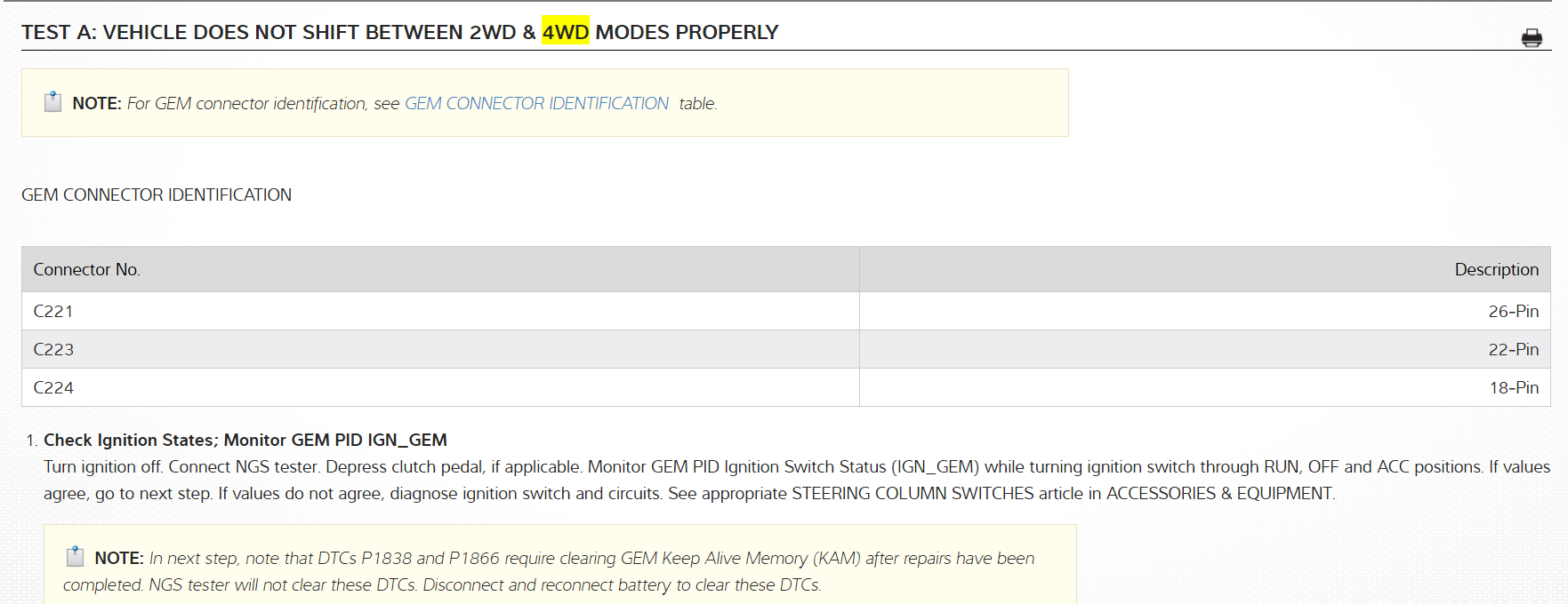

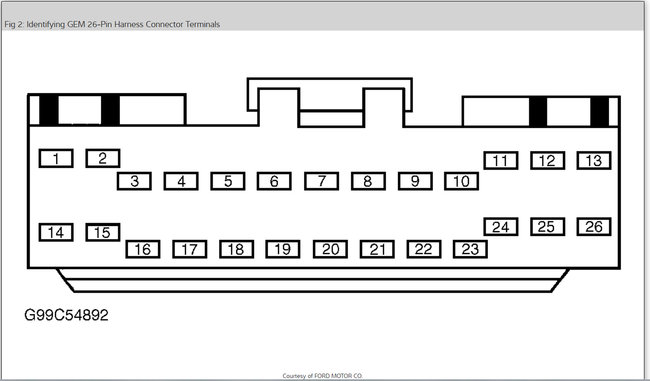

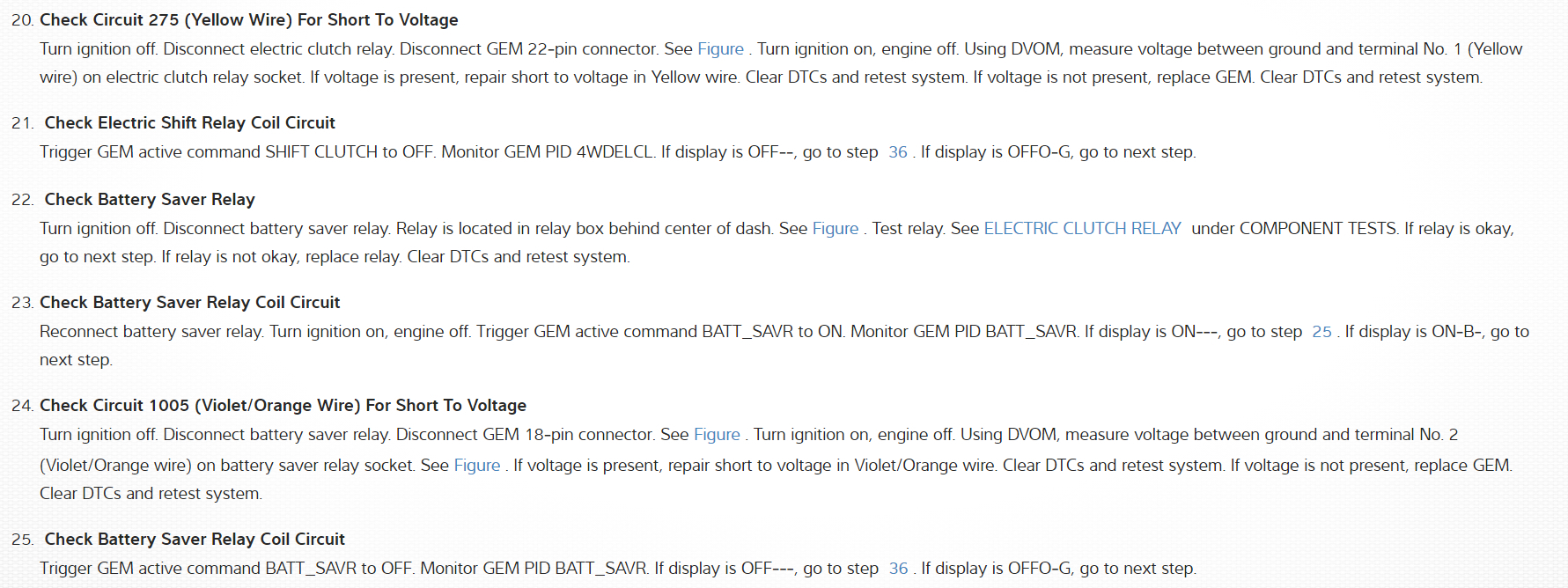

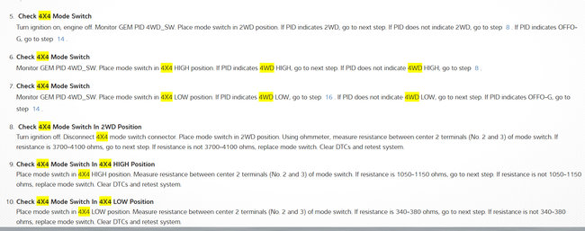

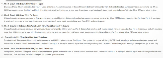

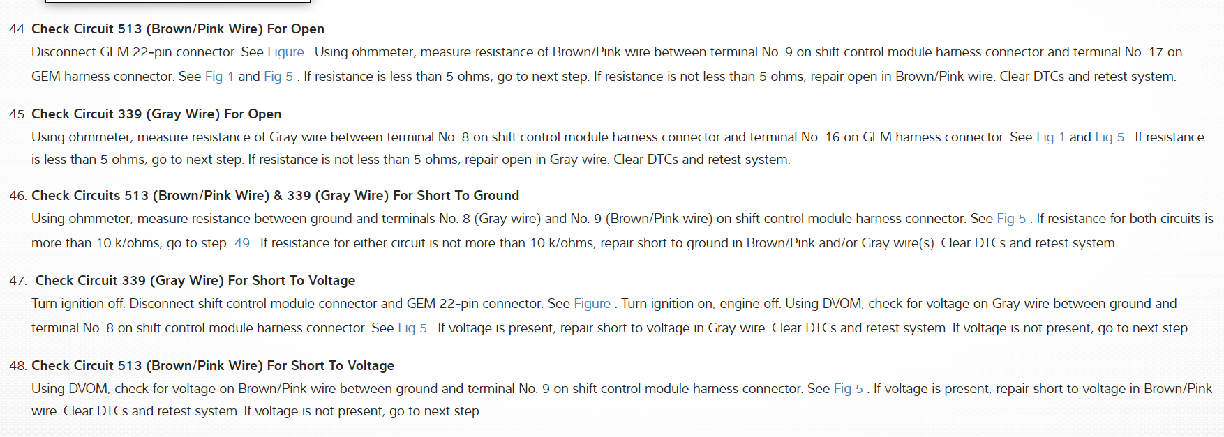

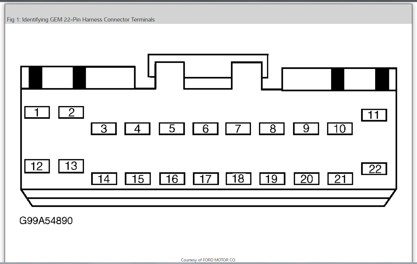

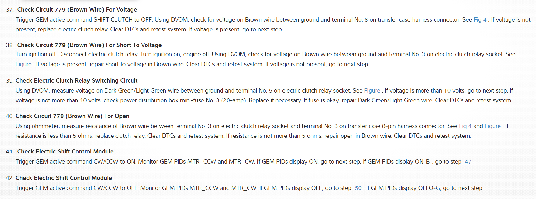

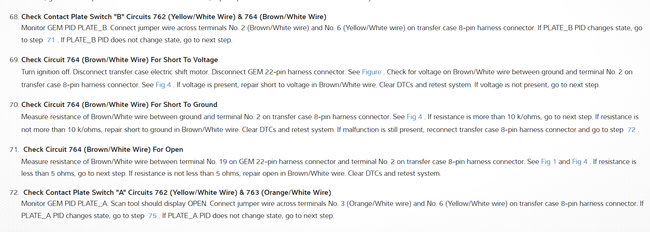

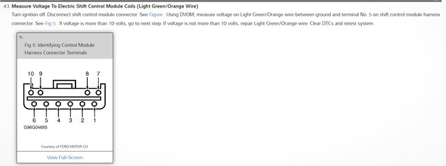

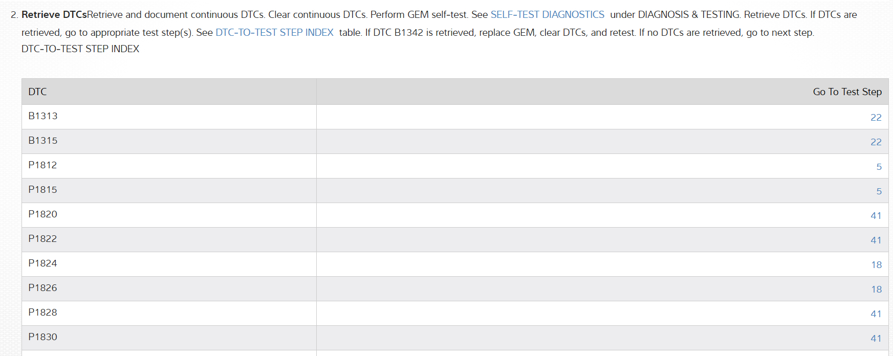

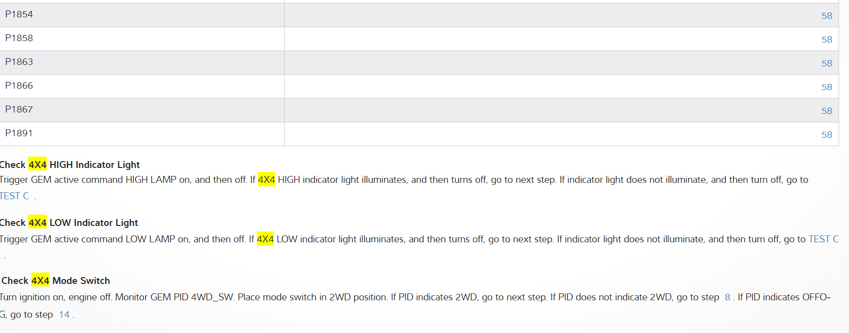

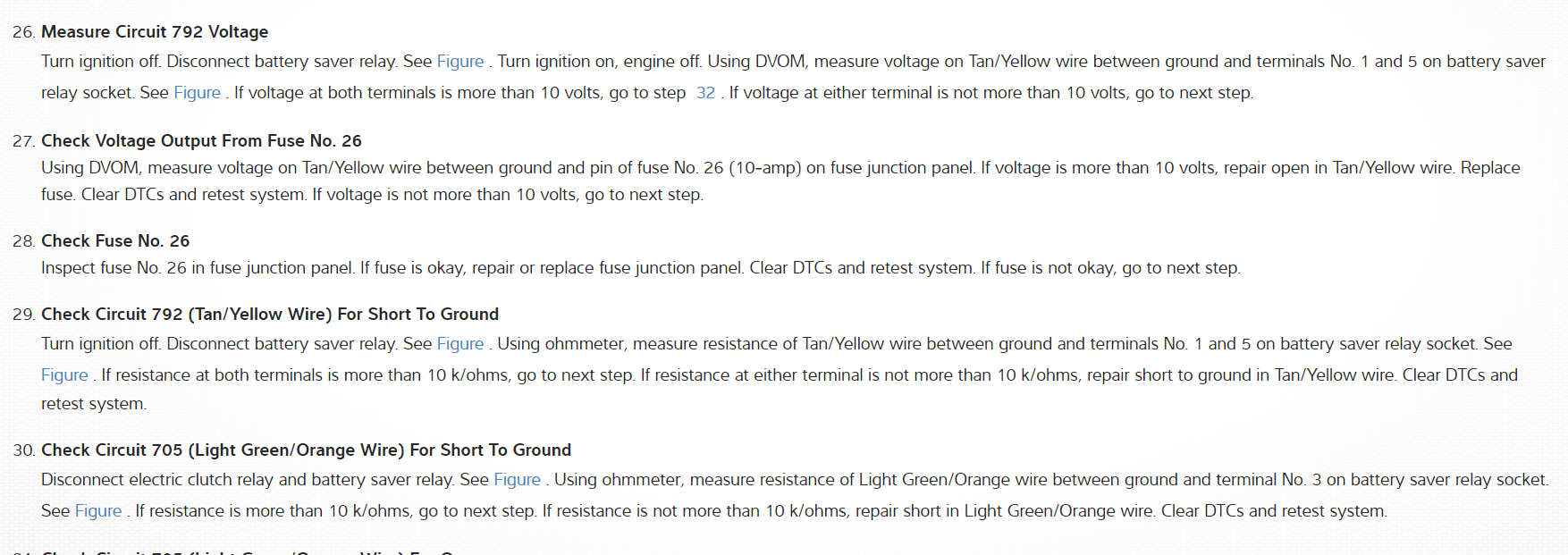

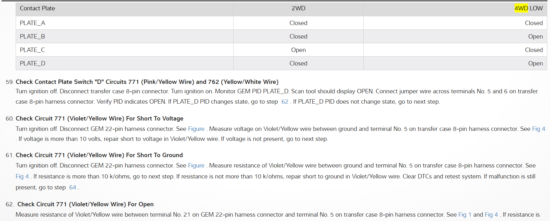

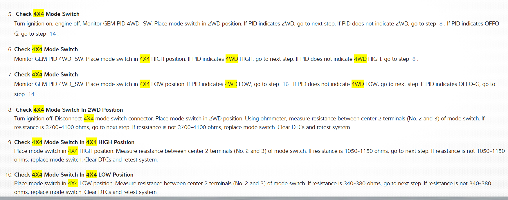

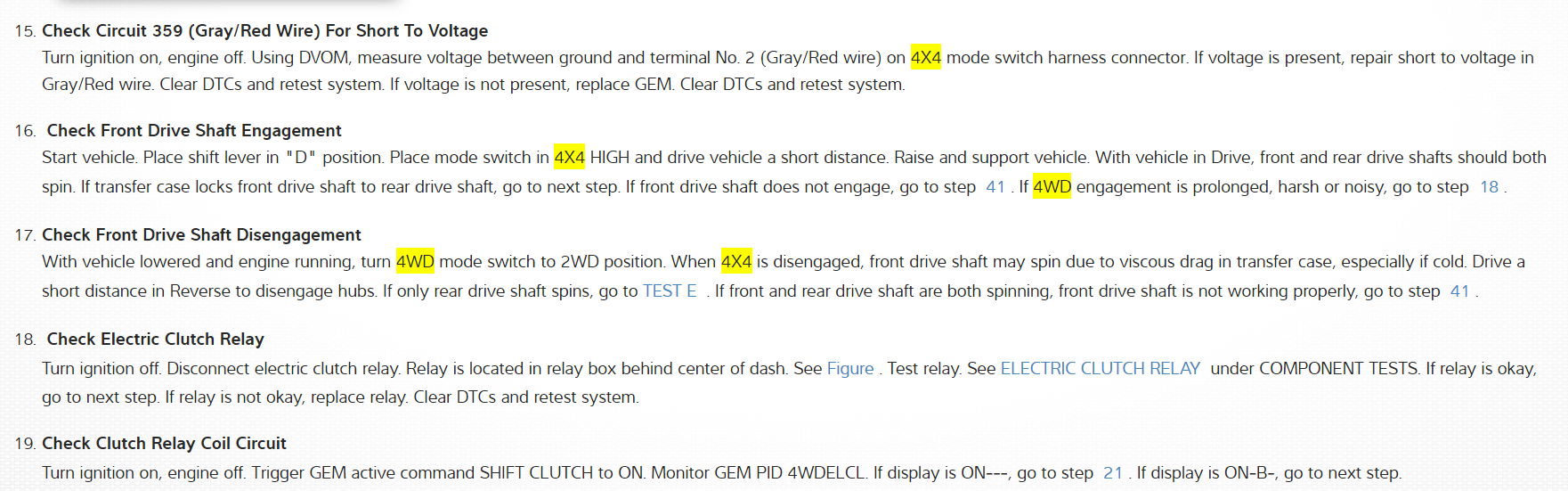

This could be a problem with your GEM connector. I have included in the diagrams down below a comprehensive diagnostic troubleshooting flowchart. Please go through it and get back to us with what you find out.
Thanks,
Alex
2CarPros
Mar 5, 2019 at 9:14 AM
RICKSRSEIBERT
Nothing wrong with the answer I will keep for future reference. the temperatures outside warmed up some and the 4 wheel indicator high low have quit flashing and it has disengaged itself. Thank You
