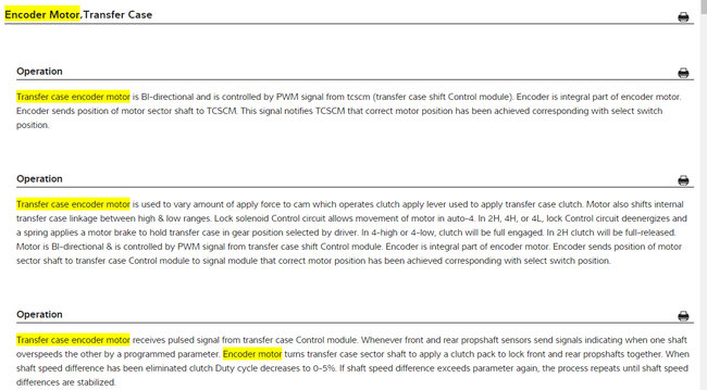

Sounds like an actuator problem like it's trying to come out but it's not fully disengaging. So it goes right back into 4 Low. Do you have access to a scan tool?

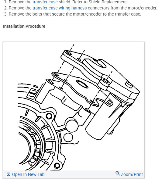

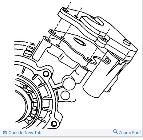

Where would I find the actuator that you are talking about, I know where the actuator is under the battery, and the one on the firewall, but is there another somewhere else?
Feb 11, 2020 at 7:28 AM
PORTAFISHING
  • 37 POSTS

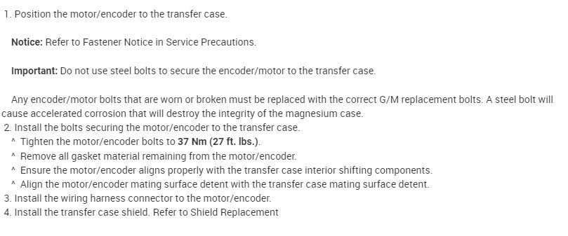

Here are some testing procedures to help figure out what's going on. this will also help you locate the encoder.
