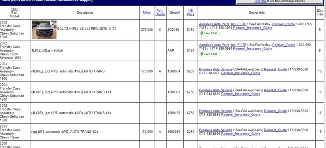

www.rockauto.com has many of them and all are around $250.00.
