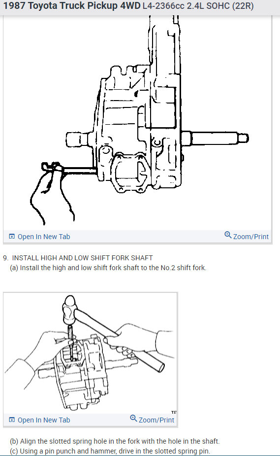

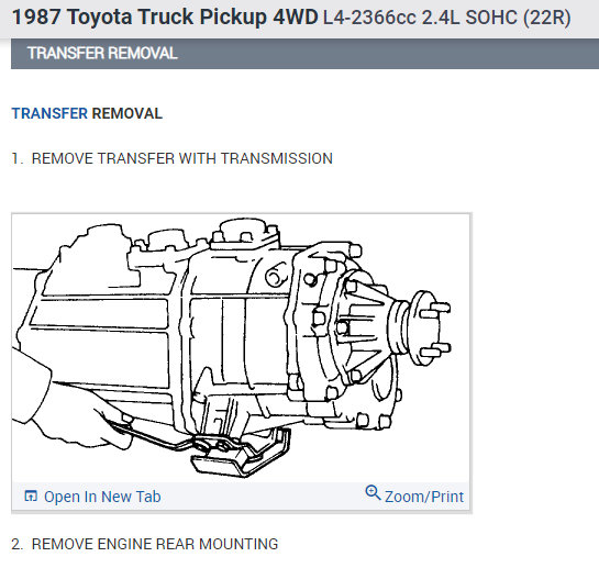

How do I remove transfer case?
1987 TOYOTA PICKUP
155,500 MILES • 2.4L • 4 CYL • 4WD • MANUAL
SFCTRIPLETT57
  • 184 POSTS
Transfer case.
Thank you
Sep 5, 2021 at 12:37 AM
SQM
  • 6,383 POSTS

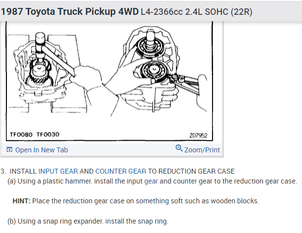

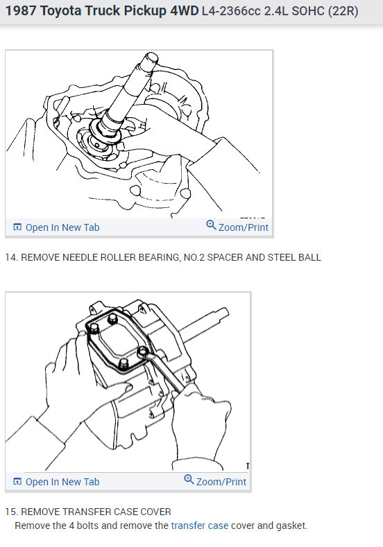

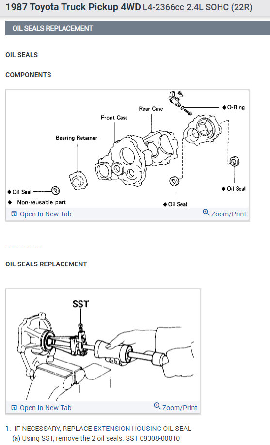

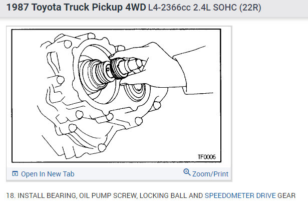

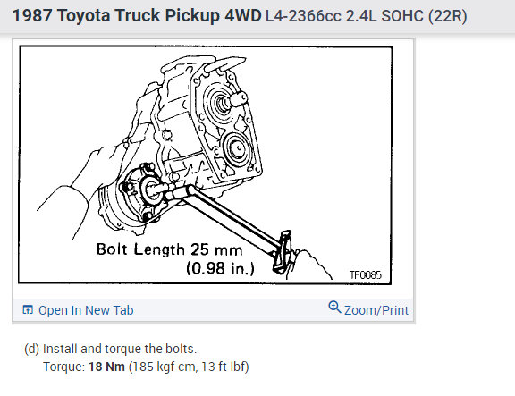

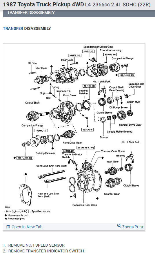

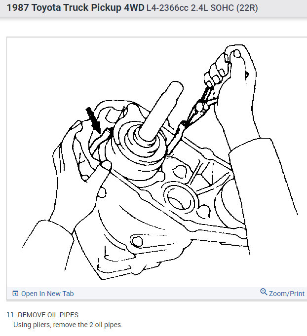

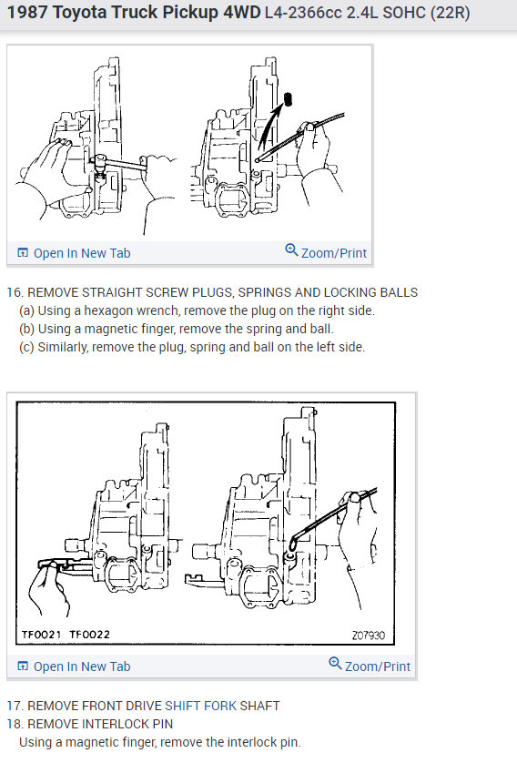

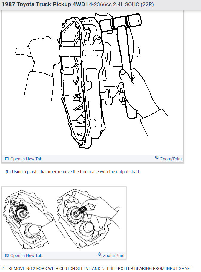

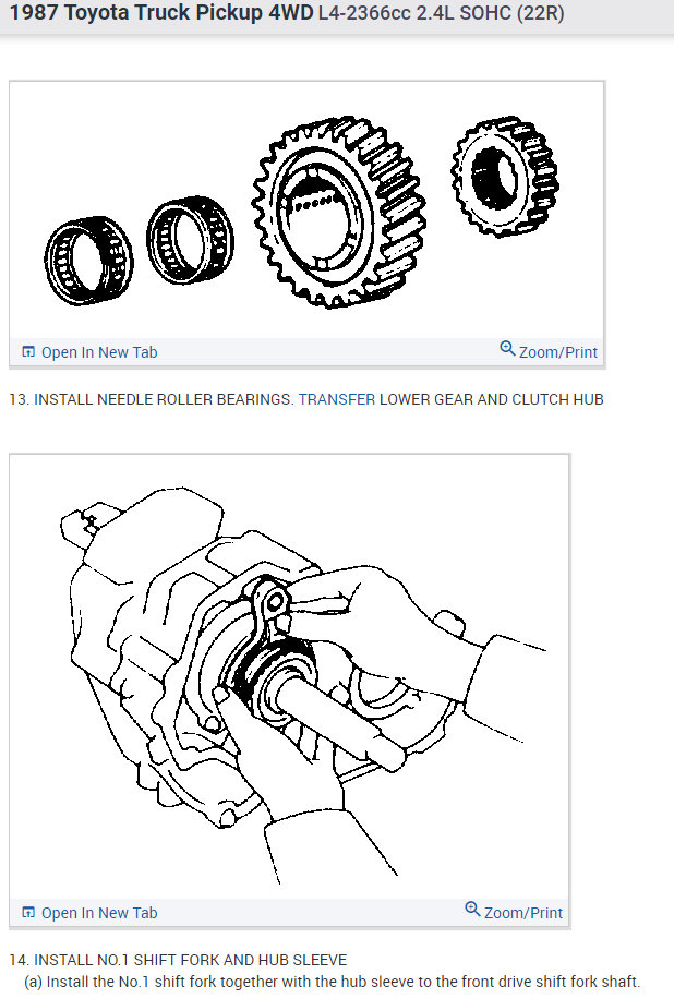

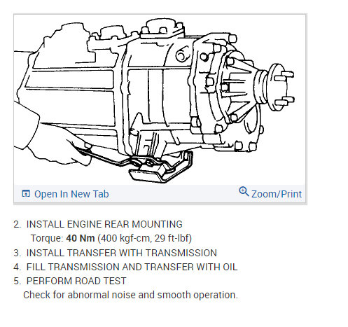

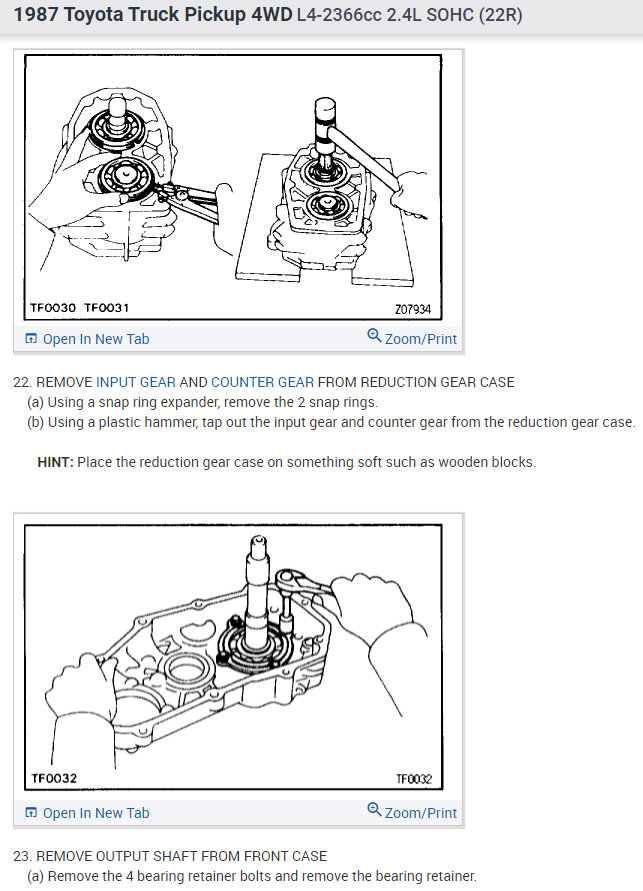

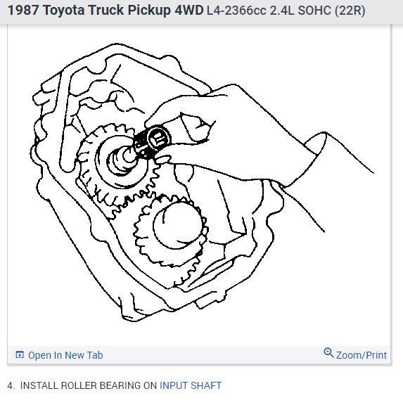

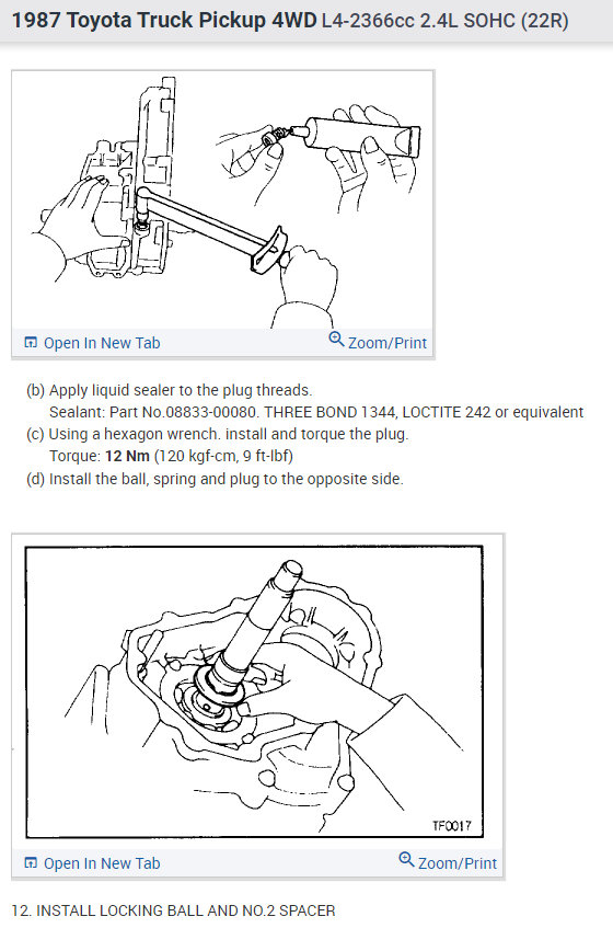

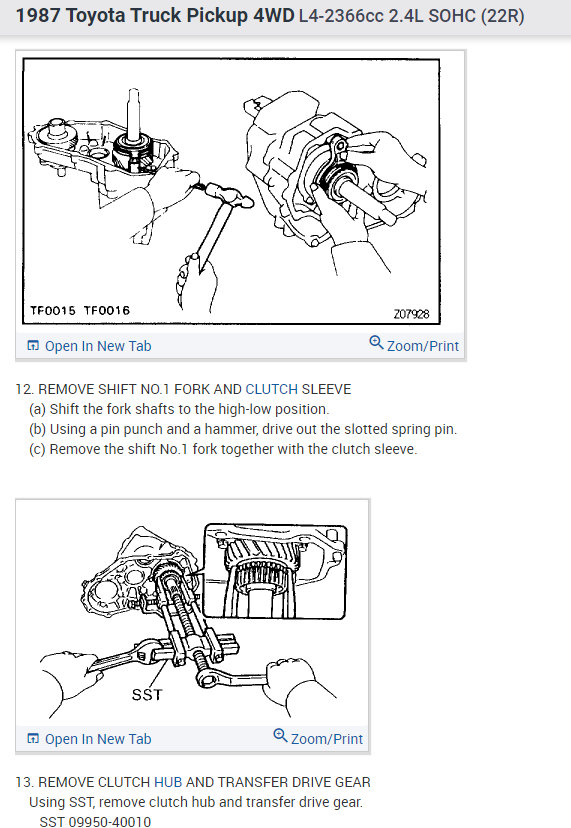

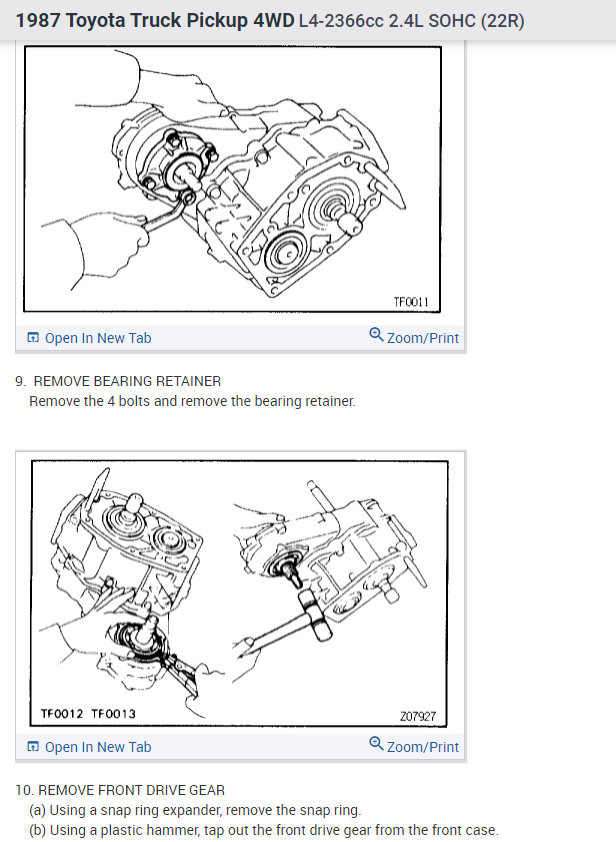

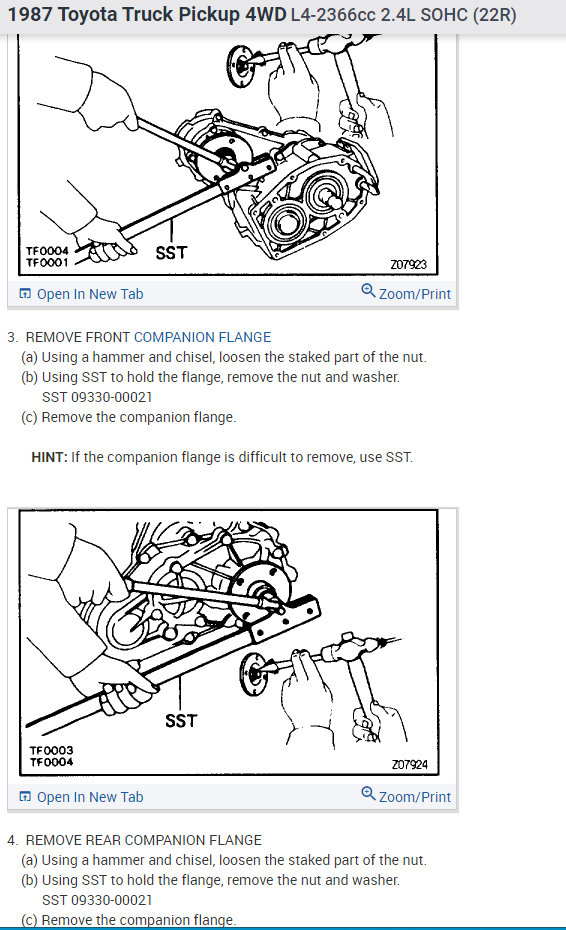

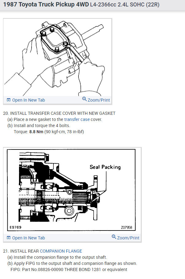

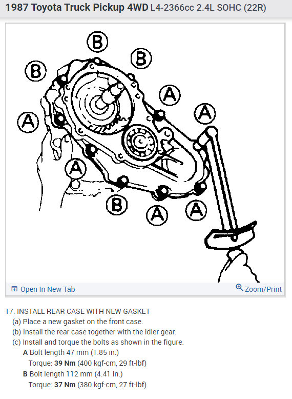

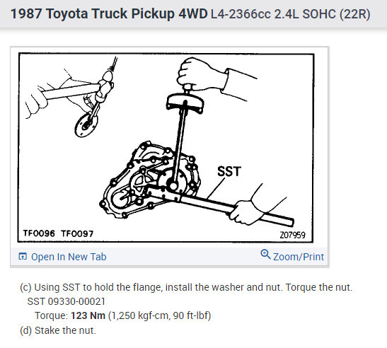

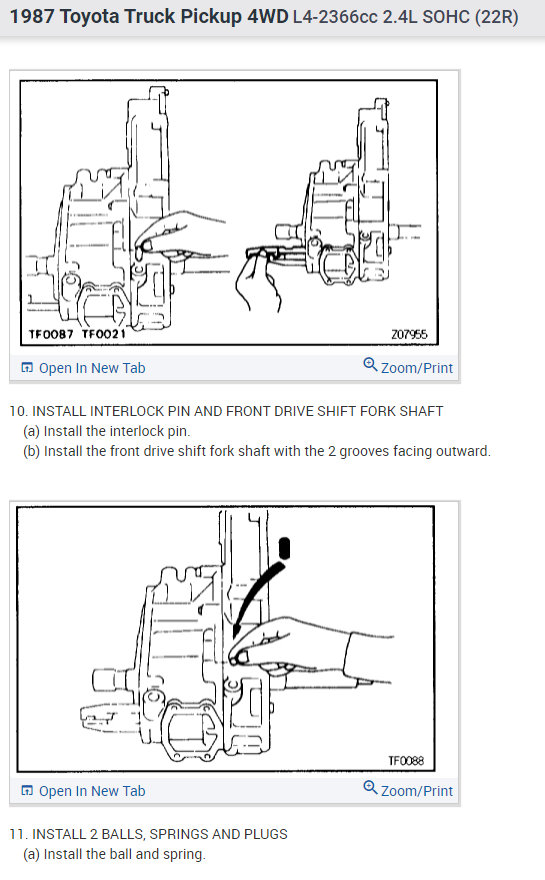

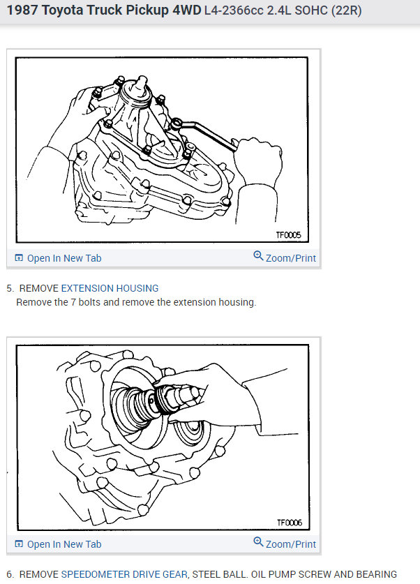

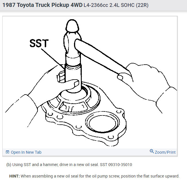

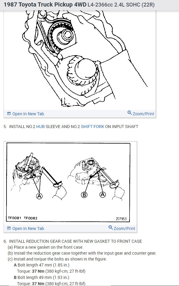

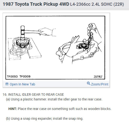

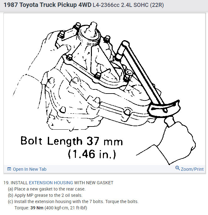

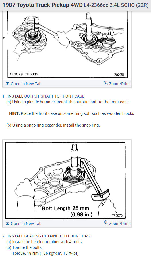

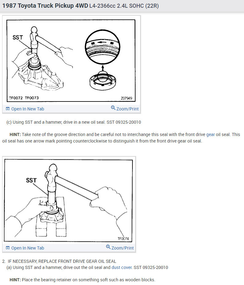

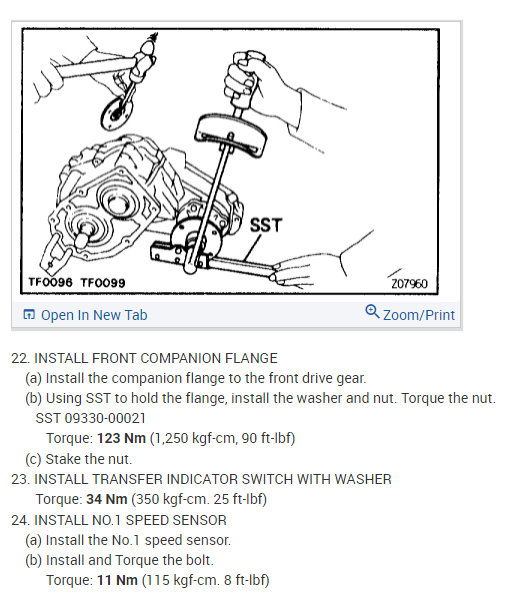

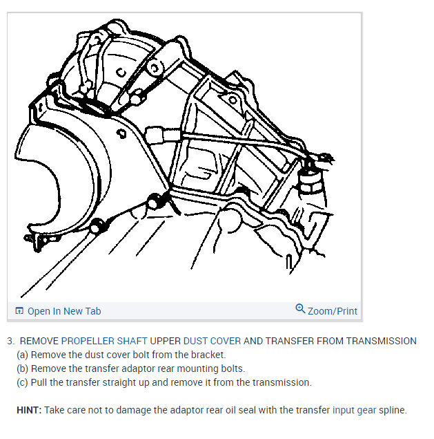

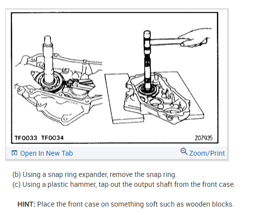

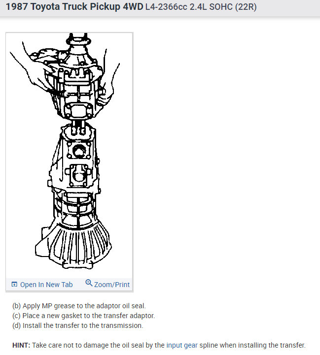

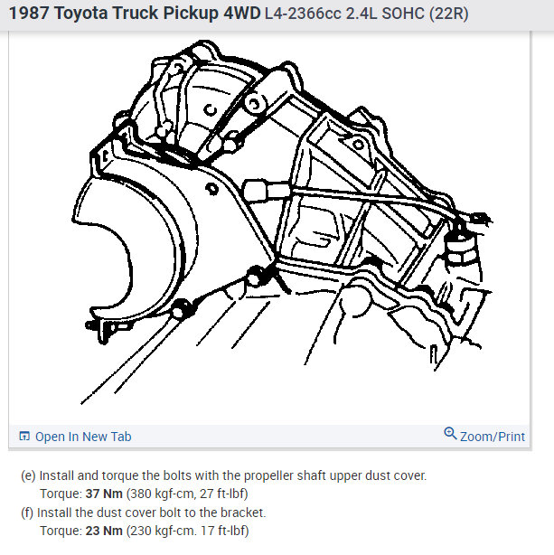

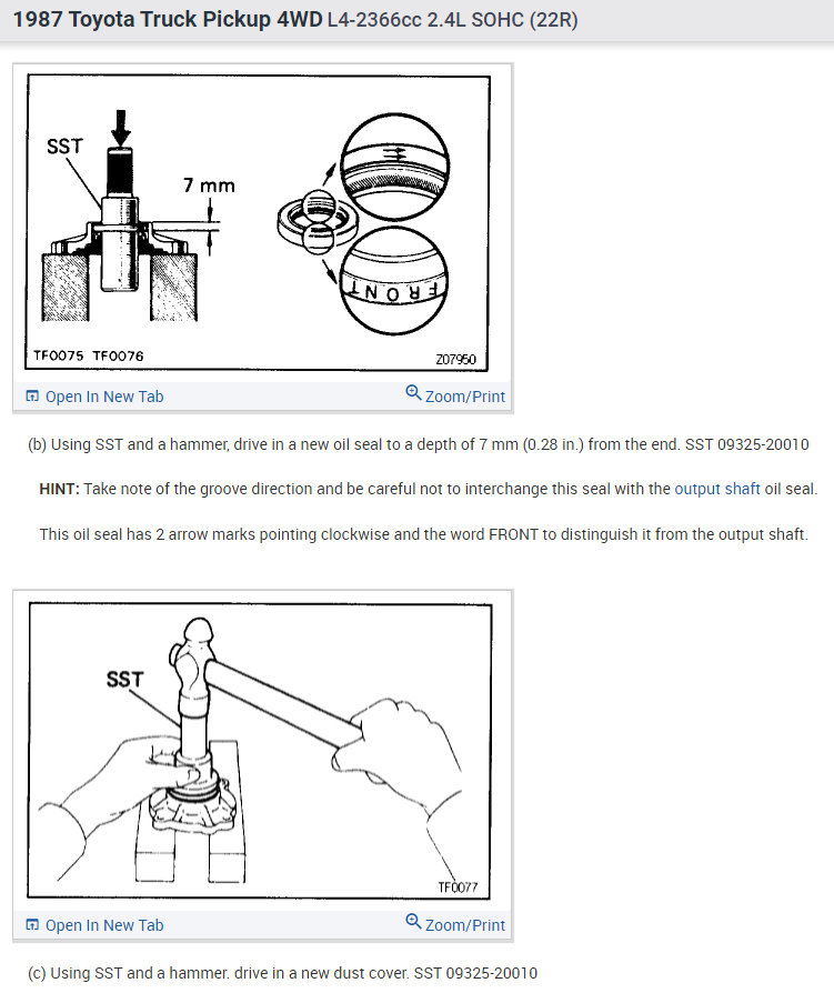

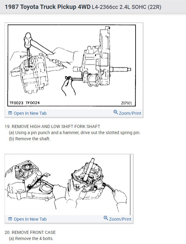

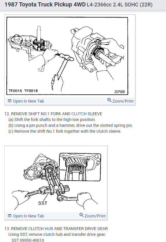

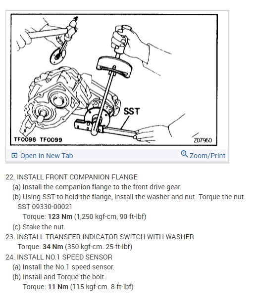

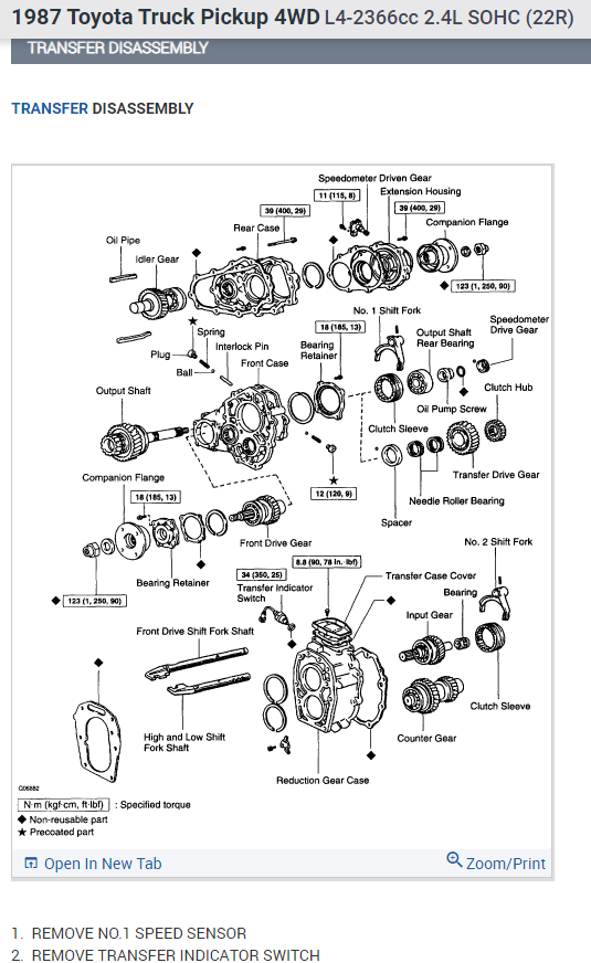

You will have to remove the transfer case with the transmission.
After that taking off the transfer case if fairy straight forward form the transmission.

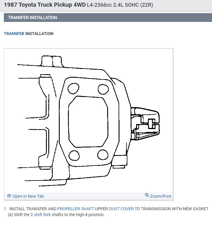

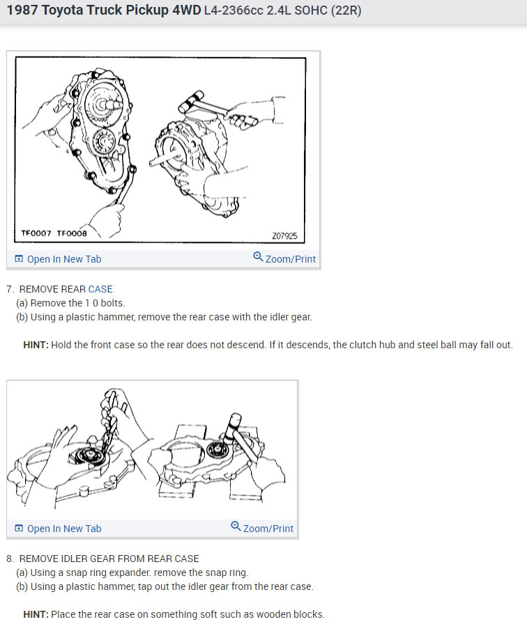

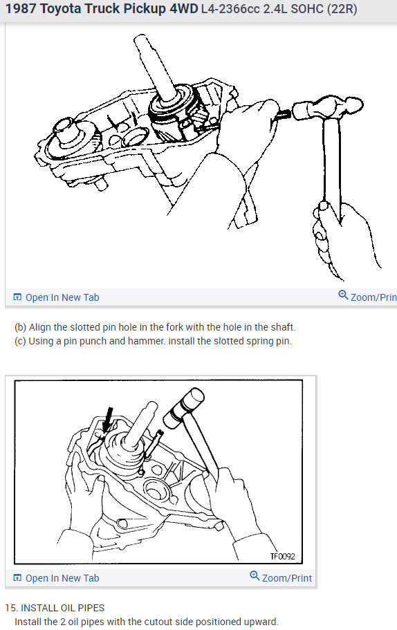

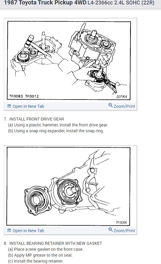

I have attached the transfer case removal from the transmission as well as dissemble and re-assembly.
Also included the torque specifications.
https://www.2carpros.com/articles/transmission-replacement-removal-manual

So I will have drop the transmission to remove the transfer case, is that what you are saying?
Thank you SQM.
Sep 5, 2021 at 7:46 AM
SQM
  • 6,383 POSTS
Yes, you will have to drop the transmission. You might not have enough space or not be able to get to all the bolts that mounts the transfer case to the transmission.
