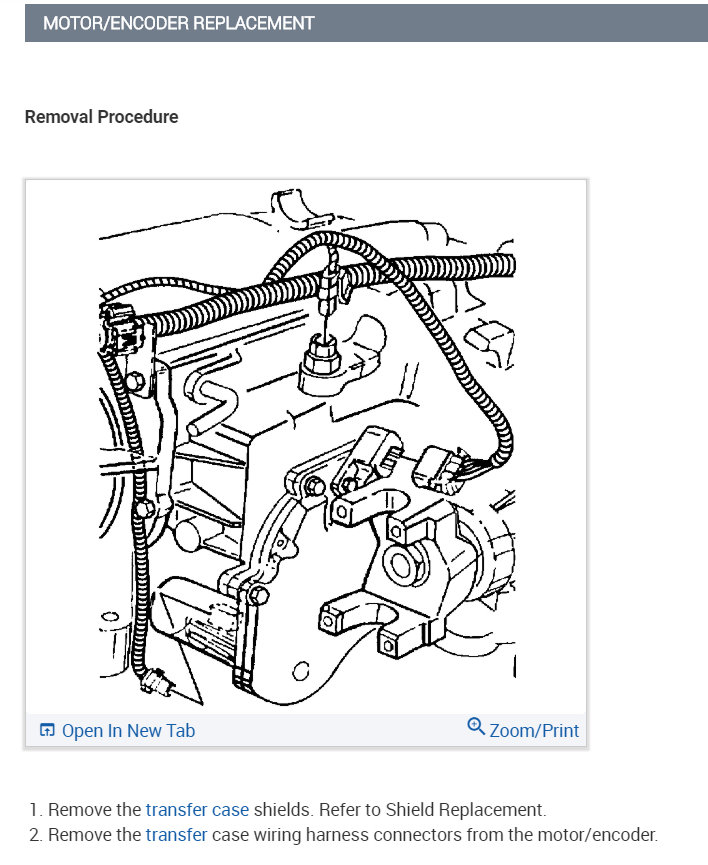

I can't get it to go back into 2 high only 4 high an 4 low.
Jul 25, 2019 at 5:20 AM
  • 55,770 POSTS

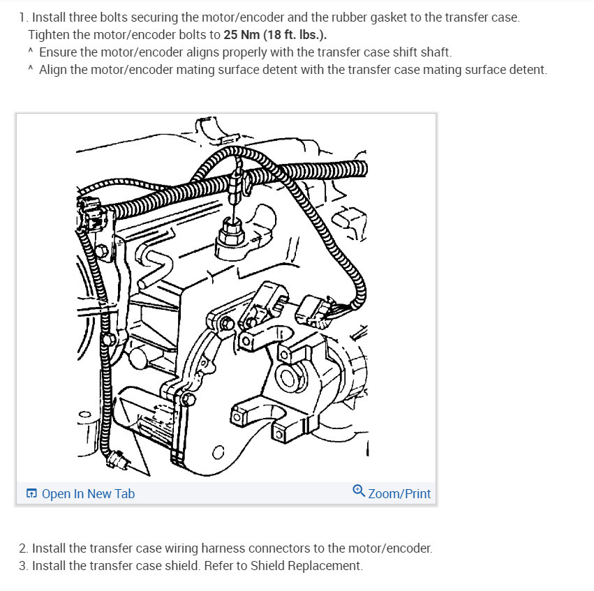

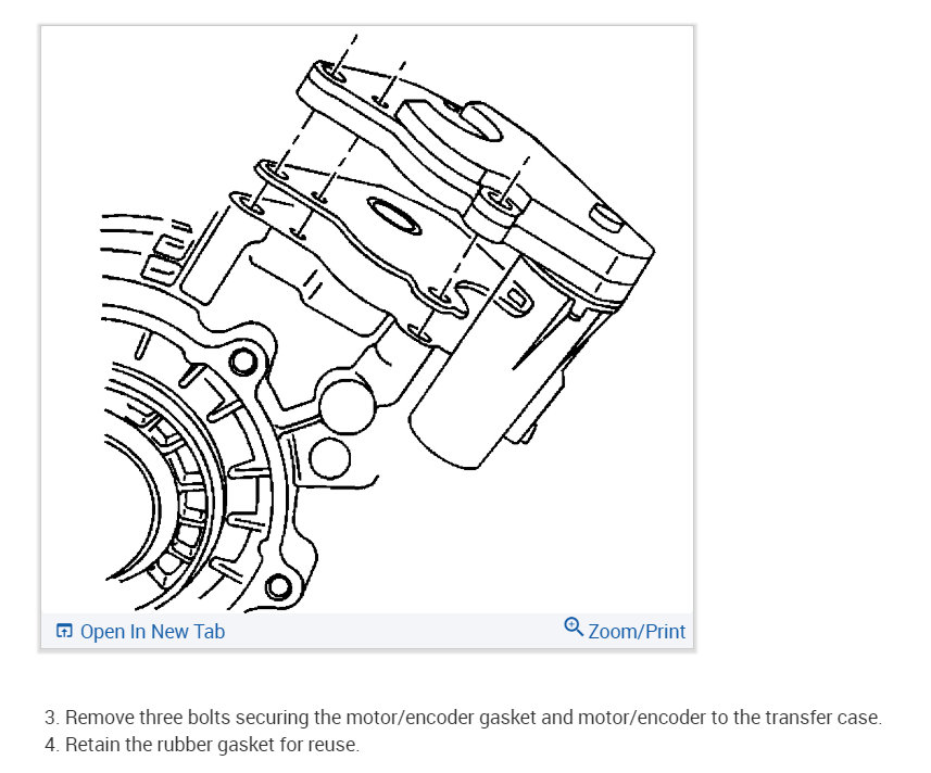

This is a common problem when the encoder (actuator) goes out. here are diagrams and instructions to get the problem fixed. Check out the diagrams (below). Please let us know what happens.
