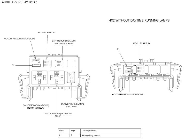

I turn switch to 2wd will not shift out 4wd low.
Nov 16, 2018 at 11:14 PM
  • 110,248 POSTS
When you shift, is the transmission in neutral? Also, do you hear any noise from the actuator on the transfer case?

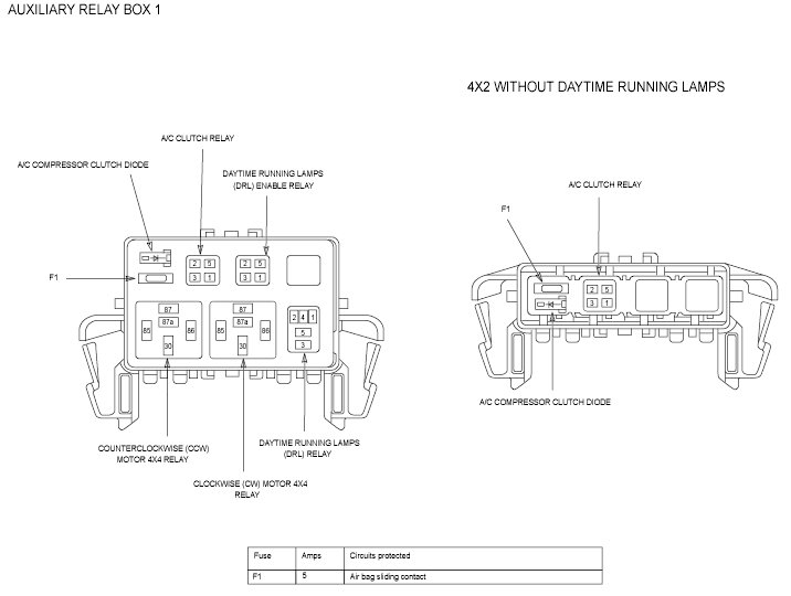

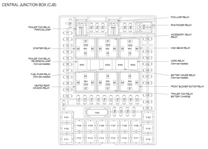

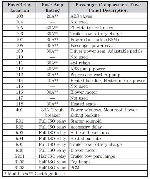

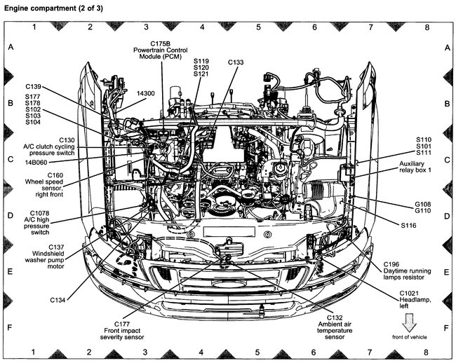

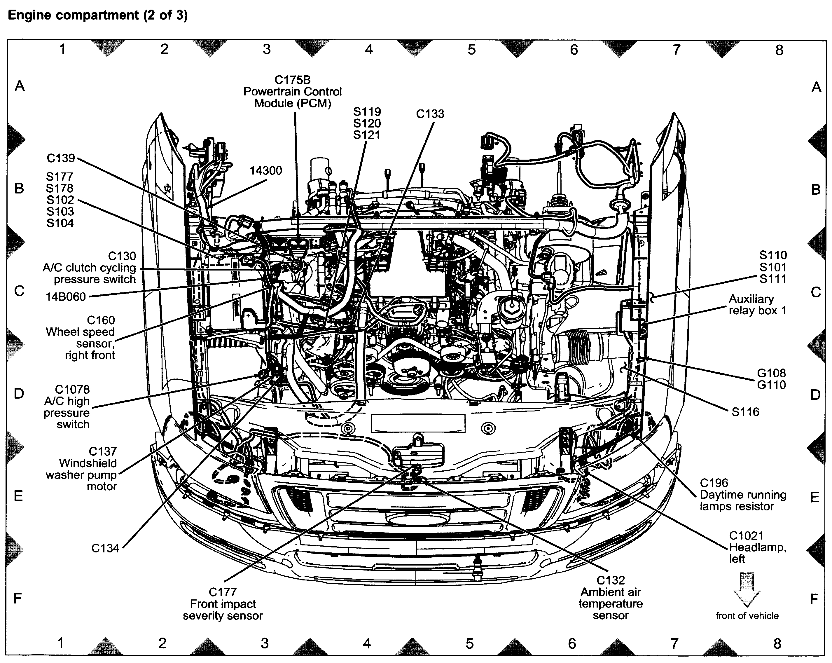

Check fuse 111 in the passenger compartment fuse box. Also, in the auxiliary relay box, locate both 4wd relays. Switch them with other relays with the same part numbers to see if it makes a difference. The relay box is under the hood (driver's side). See picture 4.
