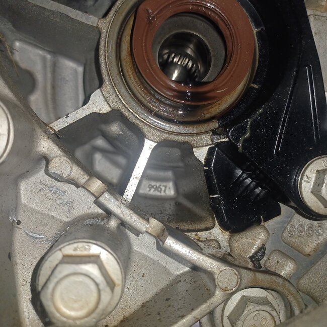

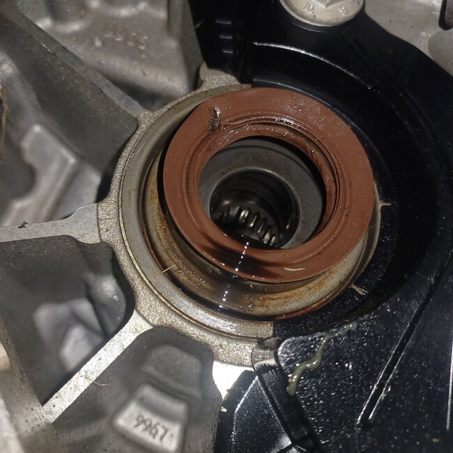

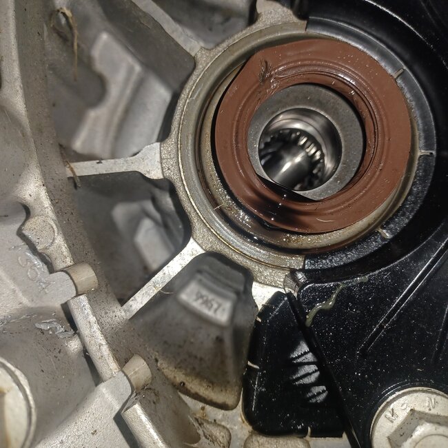

This vehicle snapped the right lower control arm and the inside cv joint. When this happened at least one spline on the carrier inside the transmission was damaged. Is this a replaceable part or is the transmission shot. Could a new cv axle be installed and the vehicle driven without issues? I included some photos trying to show the damage.

Yep you look okay as far as the splines are concerned, I would install a new axle seal and run it. Thanks for the images they helped. Please use 2CarPros anytime we are here to help.
