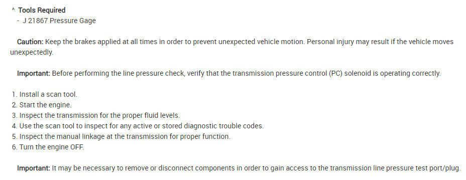

Intermittently while at 50 to 55 cruising speed, transmission seems to go into neutral and the RPMs rise to 3,000 with no acceleration?
100,000 MILES • 5.3L • V8 • 2WD • AUTOMATIC
NW1776
Pull over to sit a min then continue on down road. May happen again, may not. More often than not it shifts as it should, all day w/no prob. No leaks, smells or noises. Less than 100,000 on new 5.3 motor and rebuilt transmission, done 5 to 6 years ago 250,000 on body. The problem started a year ago or so, but only done it, maybe once or twice a year. Last couple weeks it's gotten more frequent, but not every time it's driven. No codes relating to trans. All mechanic work has been done by cert. Mechanic at a seemingly reputable shop.

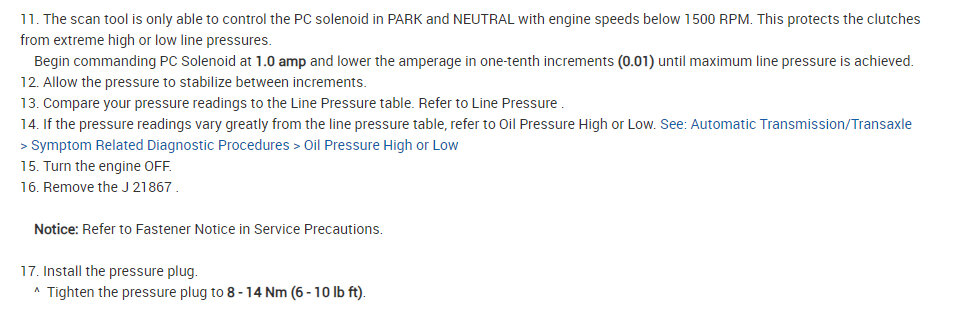

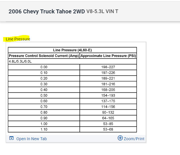

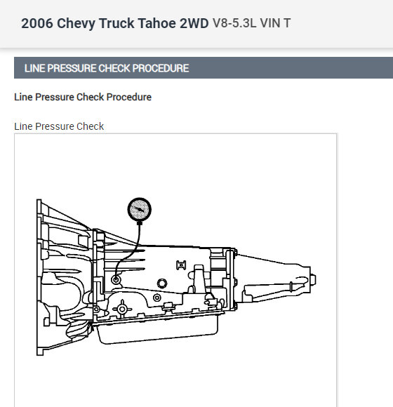

Based on your description, it sounds like you have checked the basics. I suspect the fluid is full and clean. That leaves line pressure as a question. Is that something that has been checked? If the truck has a transmission cooler, it may be partially plugged causing issues.
There are three different things related to the line pressure, pressure control solenoid, fluid pressure manual valve, and the valve body. Of course, the filter can play a role in a pressure issue.
I attached diagnostics for testing pressure below. Take a look at them and let me know if that is something you feel comfortable performing.
Apr 20, 2024 at 3:16 PM
NW1776
Thank you, Joe. Will inform you of results this afternoon.

Line pressures are falling within acceptable ranges according to specs uploaded. Tahoe hasn't presented problem at all today. I just don't know. Maybe electrical? That's about only thing left? Pure D ass befuddled, I am.
