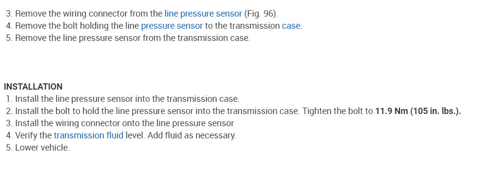

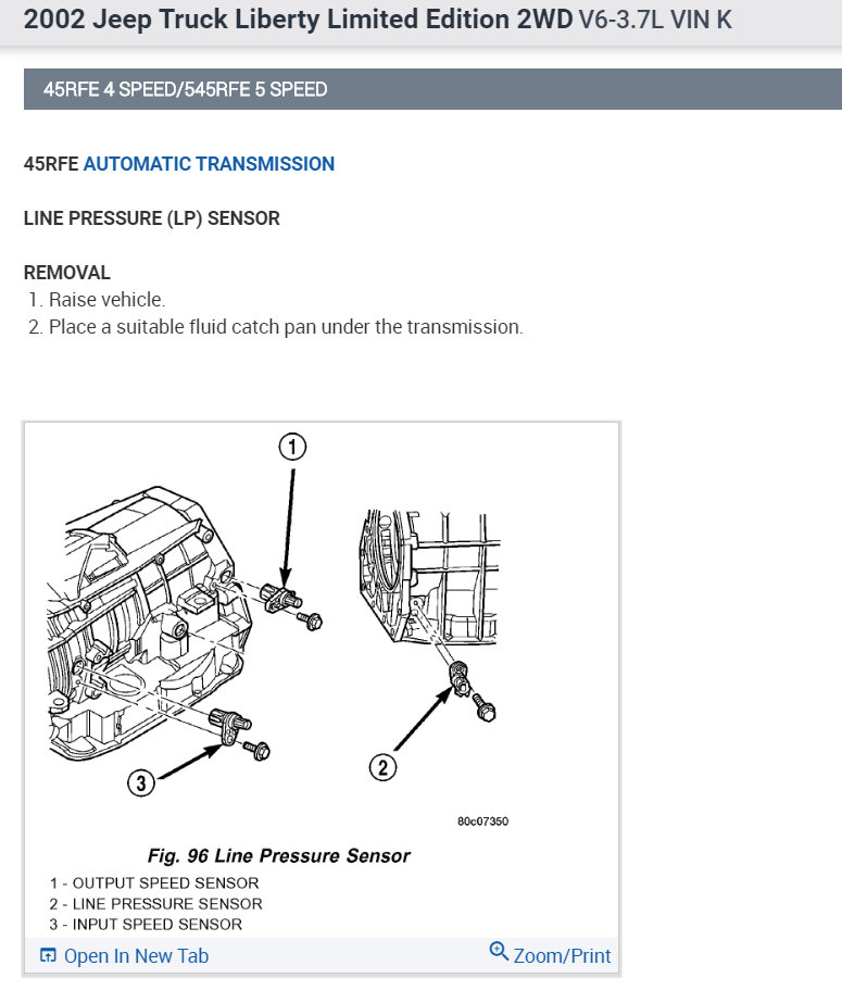

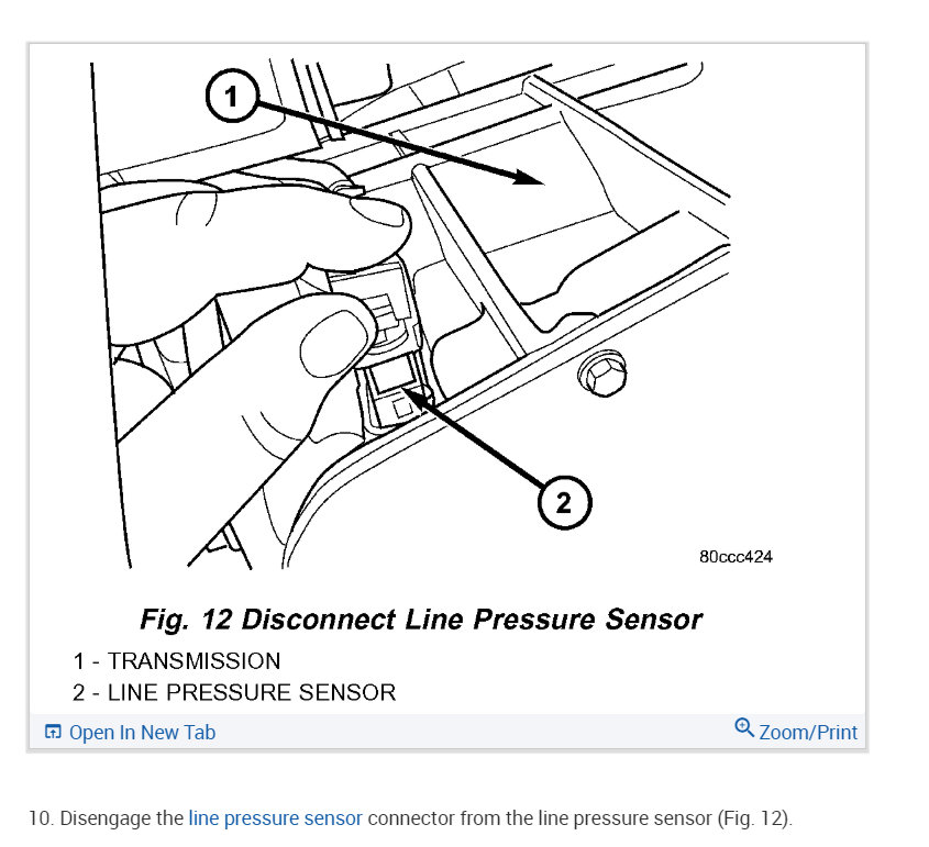

We should run the codes first, but it sounds like the line pressure sensor has gone out. Here is the location of the sensor and a guide to help you see how to get the codes:
Check out the diagrams (below). Please let us know what you find.

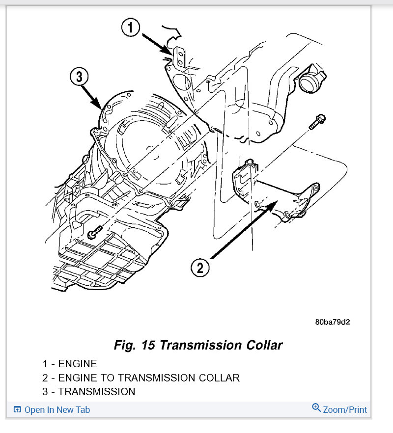

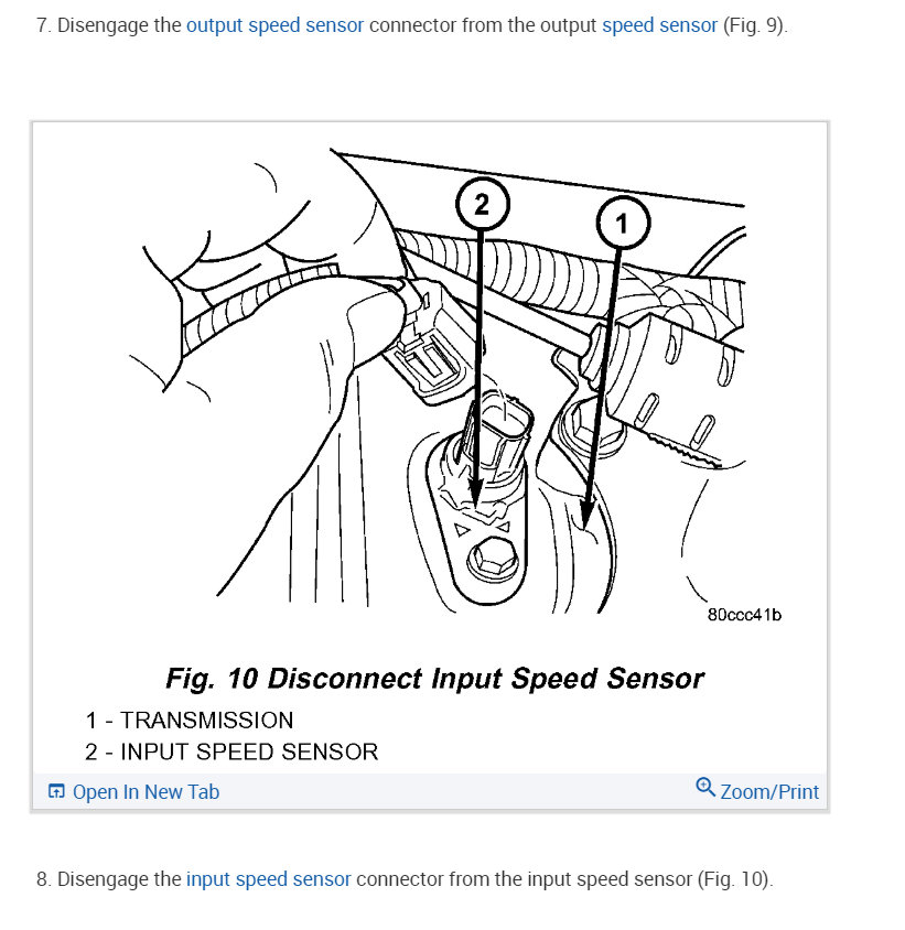

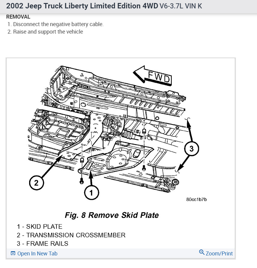

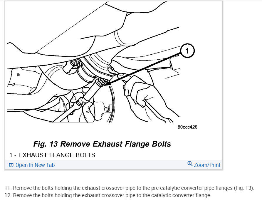

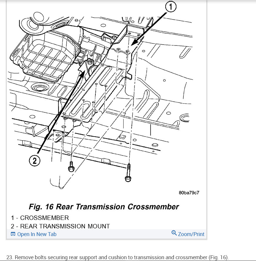

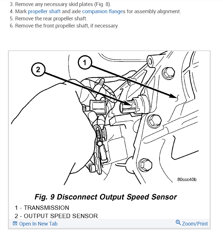

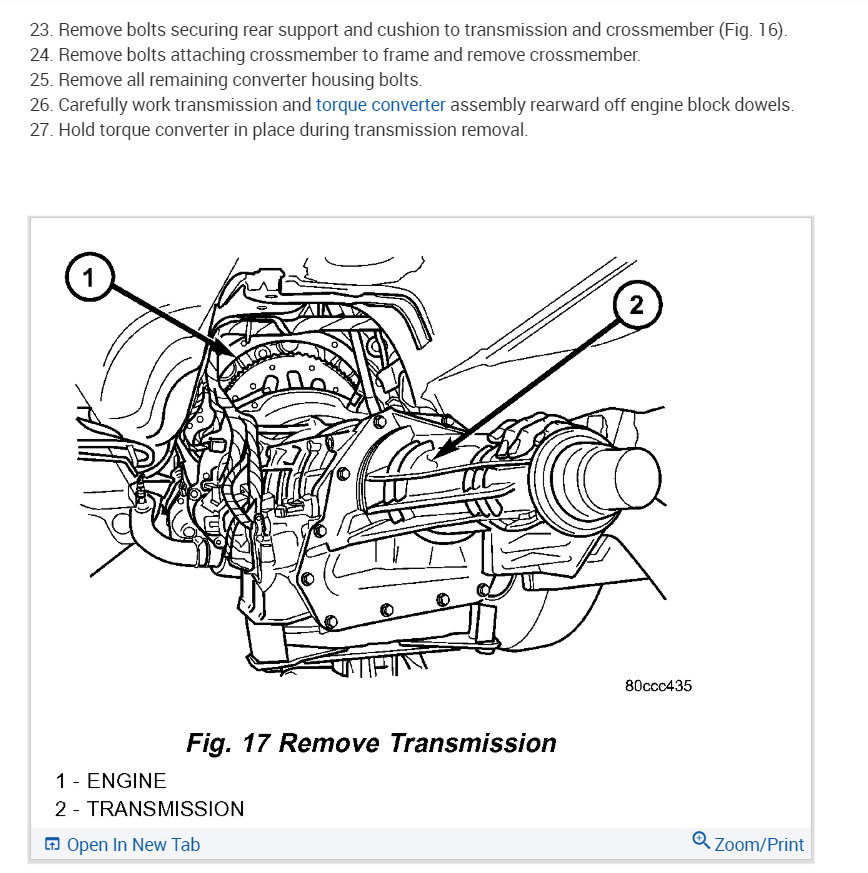

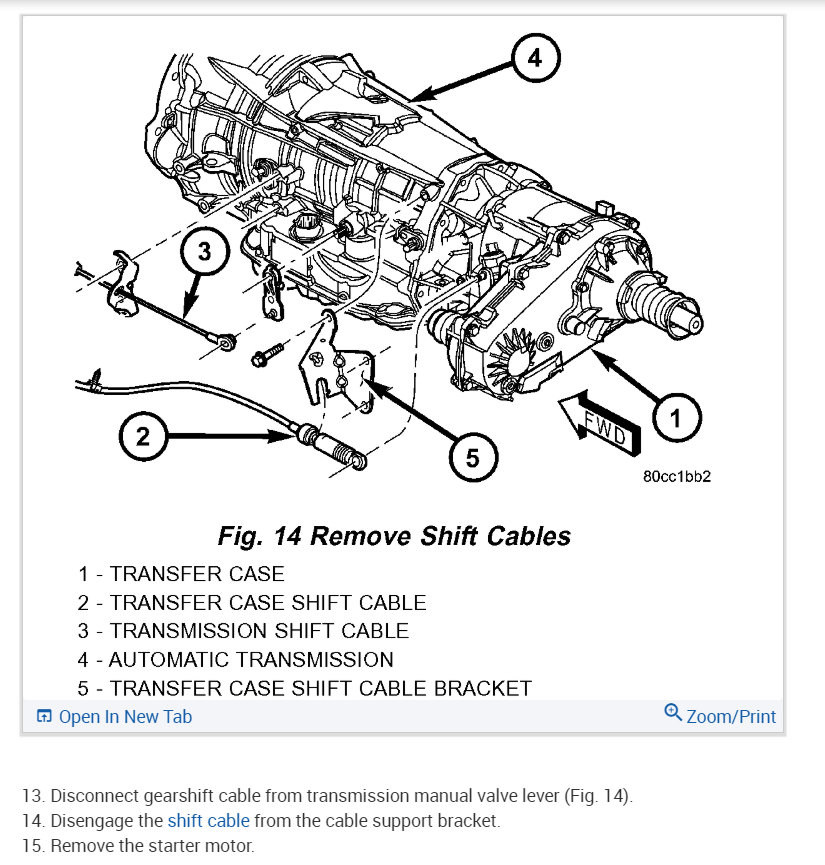

Hmm, the P0876 trouble code include a low transmission fluid condition, defective high pressure pump, which mean the transmission needs to be rebuilt or get a used one. Here is a video to help you remove the unit on a similar car but the process is the same. I have included instruction on how to remove the transmission in the diagrams below. You can save about $700.00 by removing the transmission yourself.

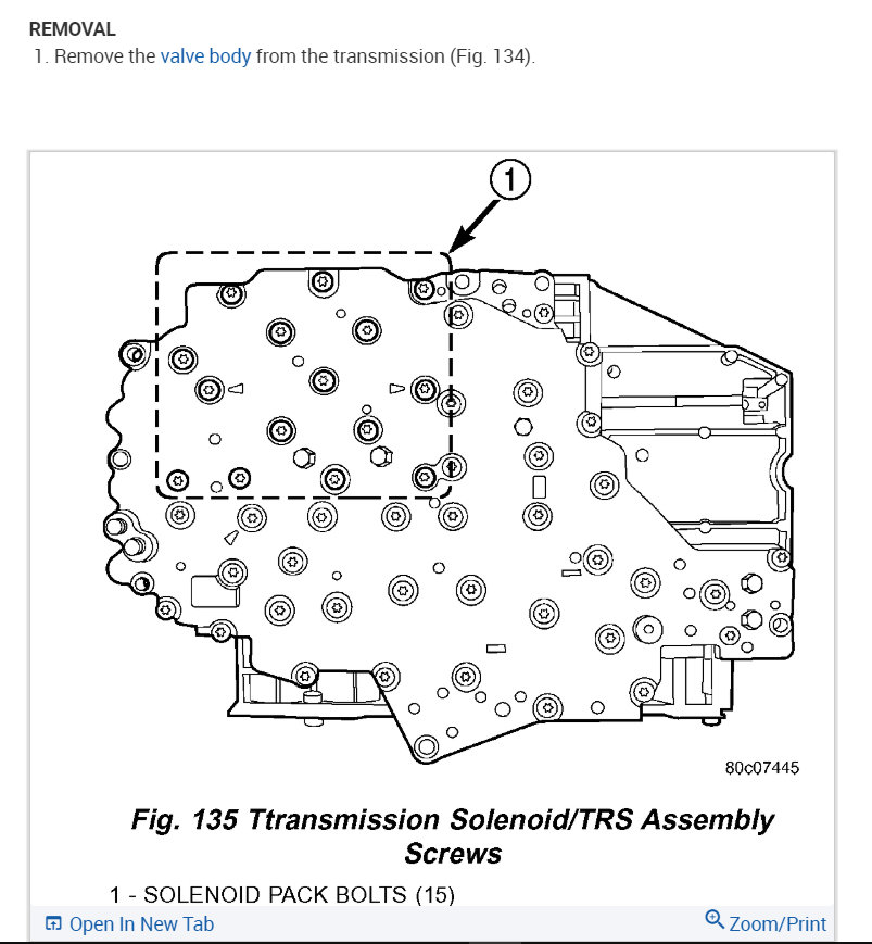

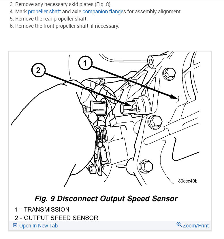

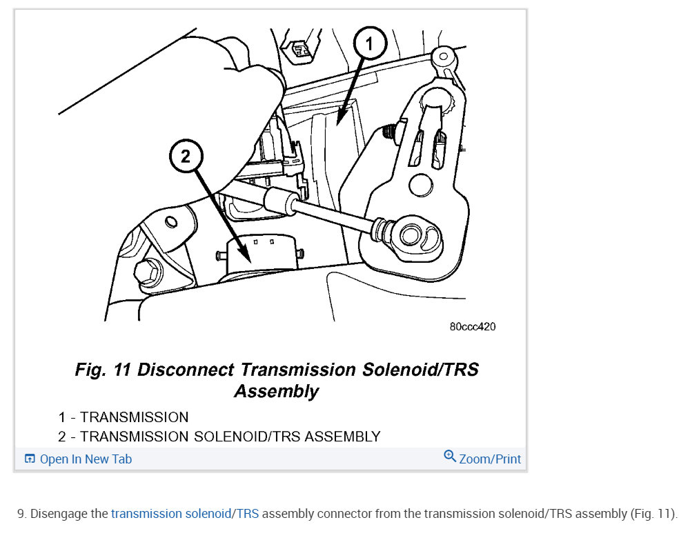

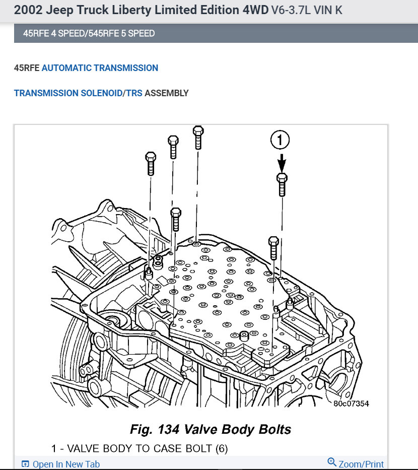

Here is how you can change the solenoid pack which may fix it. If the pump has failed the transmission will need to be rebuilt. Check out the diagrams (below). Please let us know what you find.
