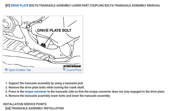

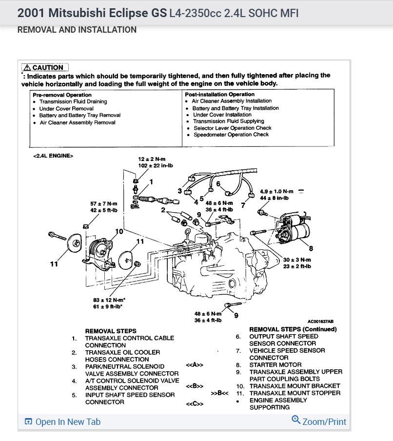

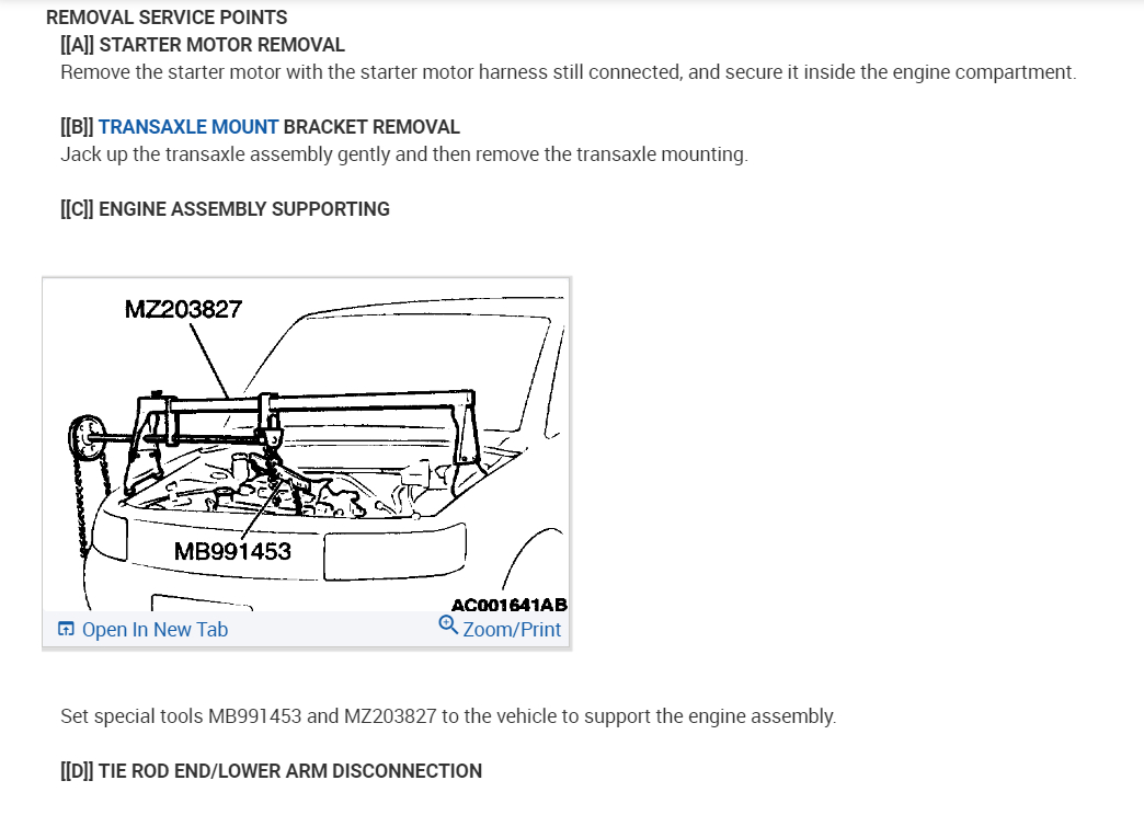

Does the engine have to be removed to replace the transmission?
2001 MITSUBISHI ECLIPSE
100,000 MILES • 3.0L • V6 • 2WD • AUTOMATIC
WILLIAM BURKHART
Oct 2, 2022 at 11:54 PM
  • 55,224 POSTS

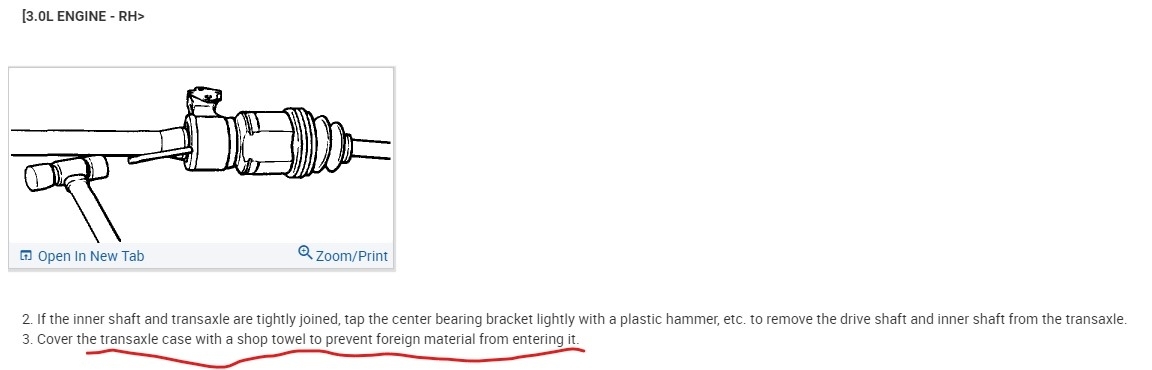

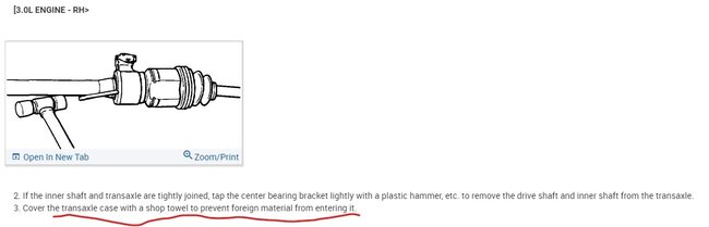

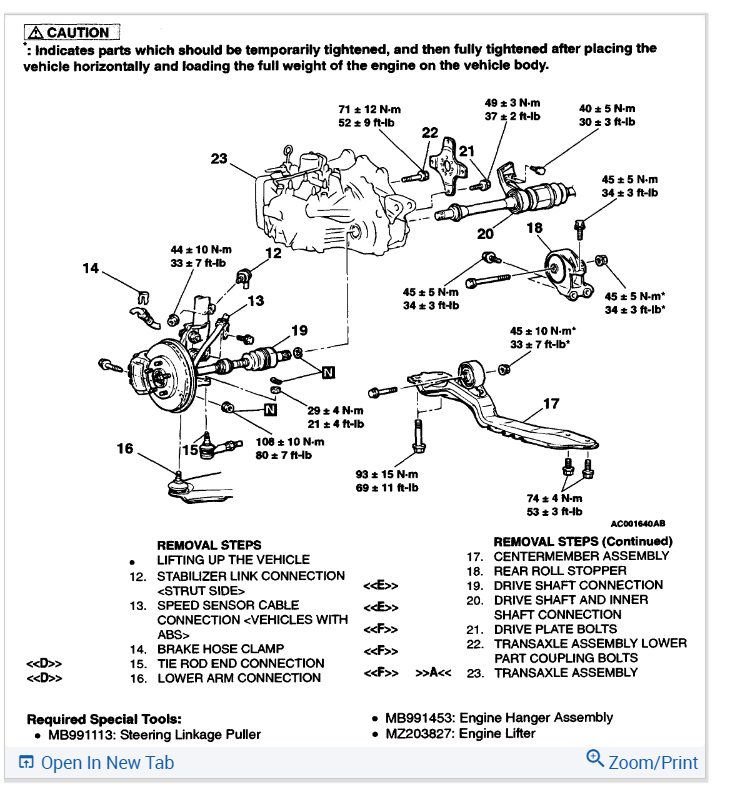

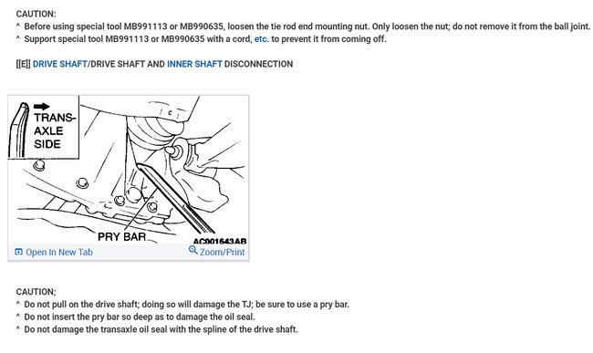

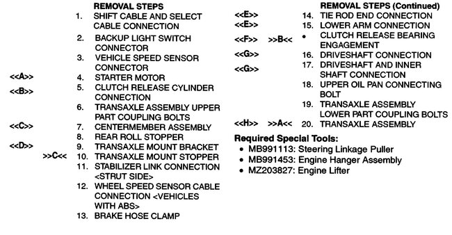

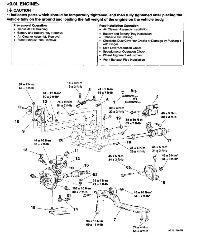

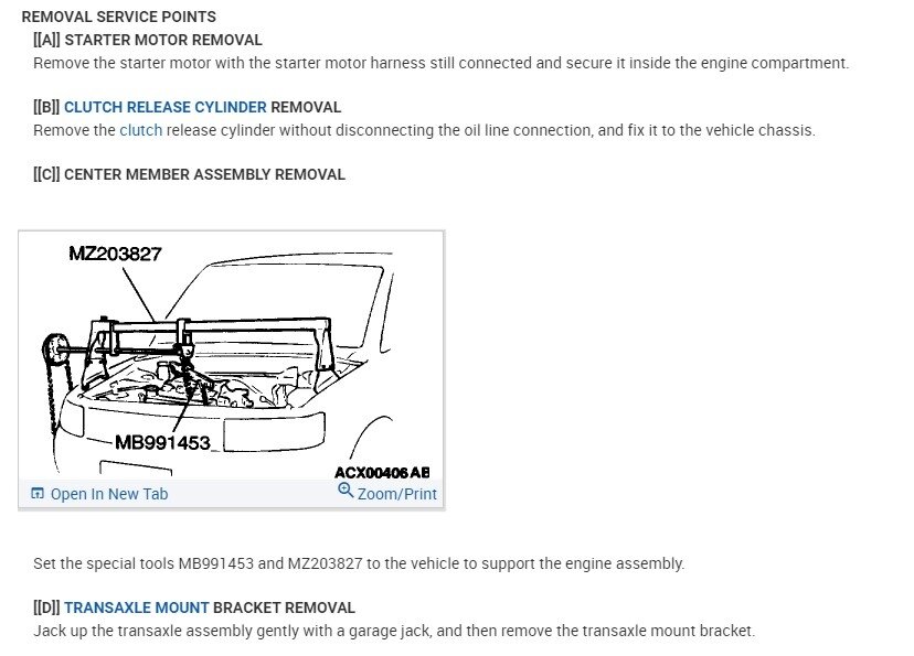

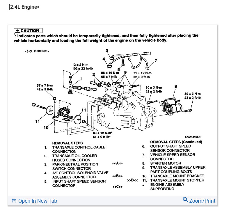

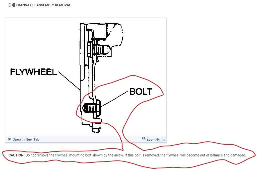

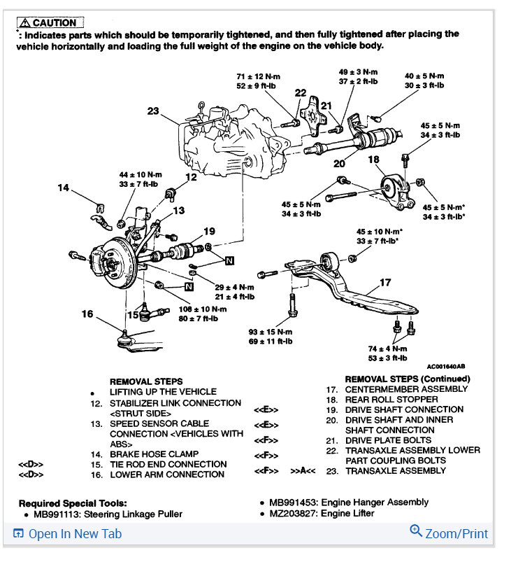

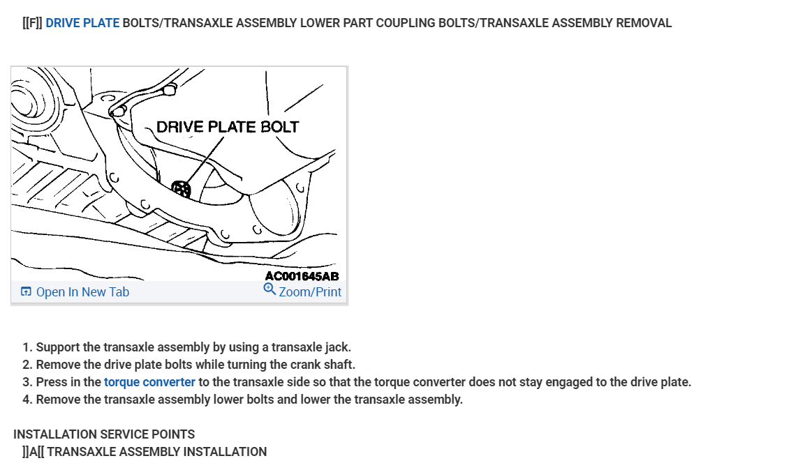

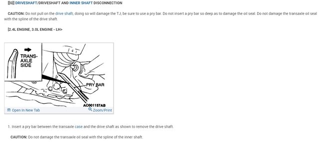

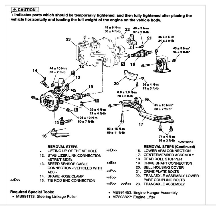

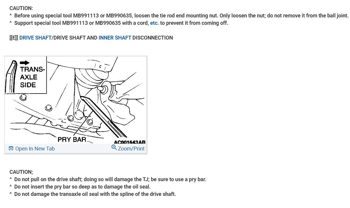

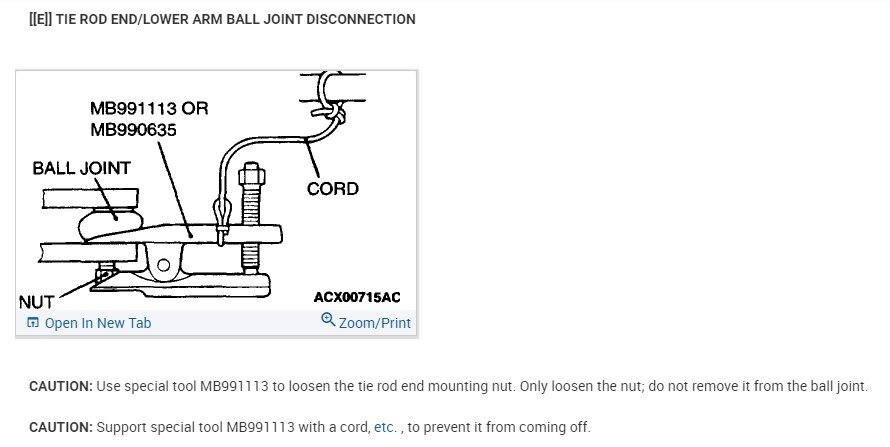

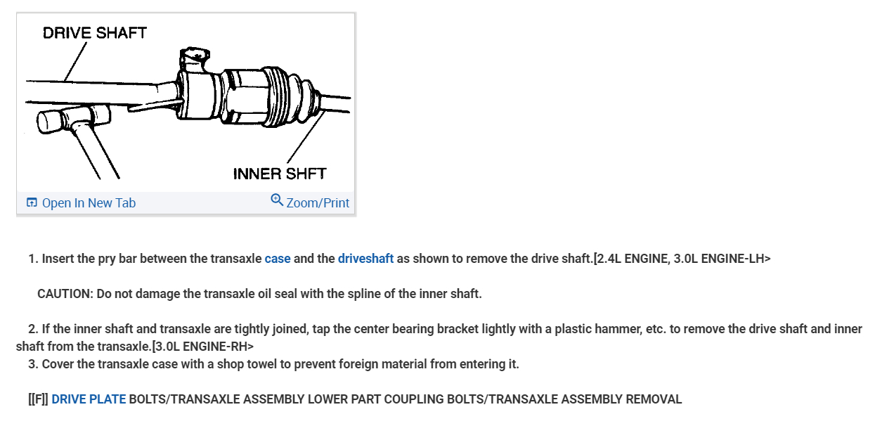

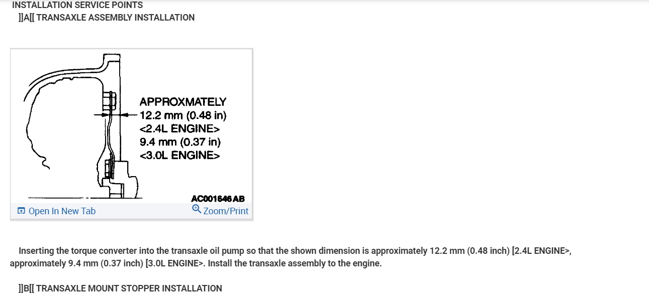

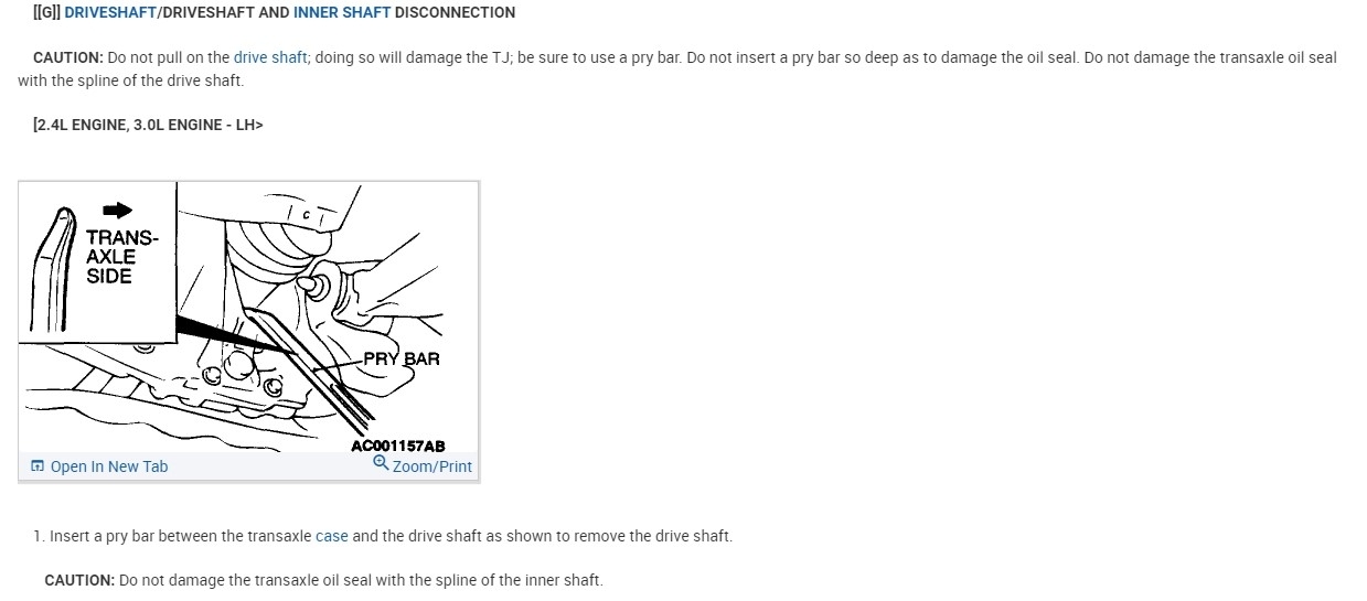

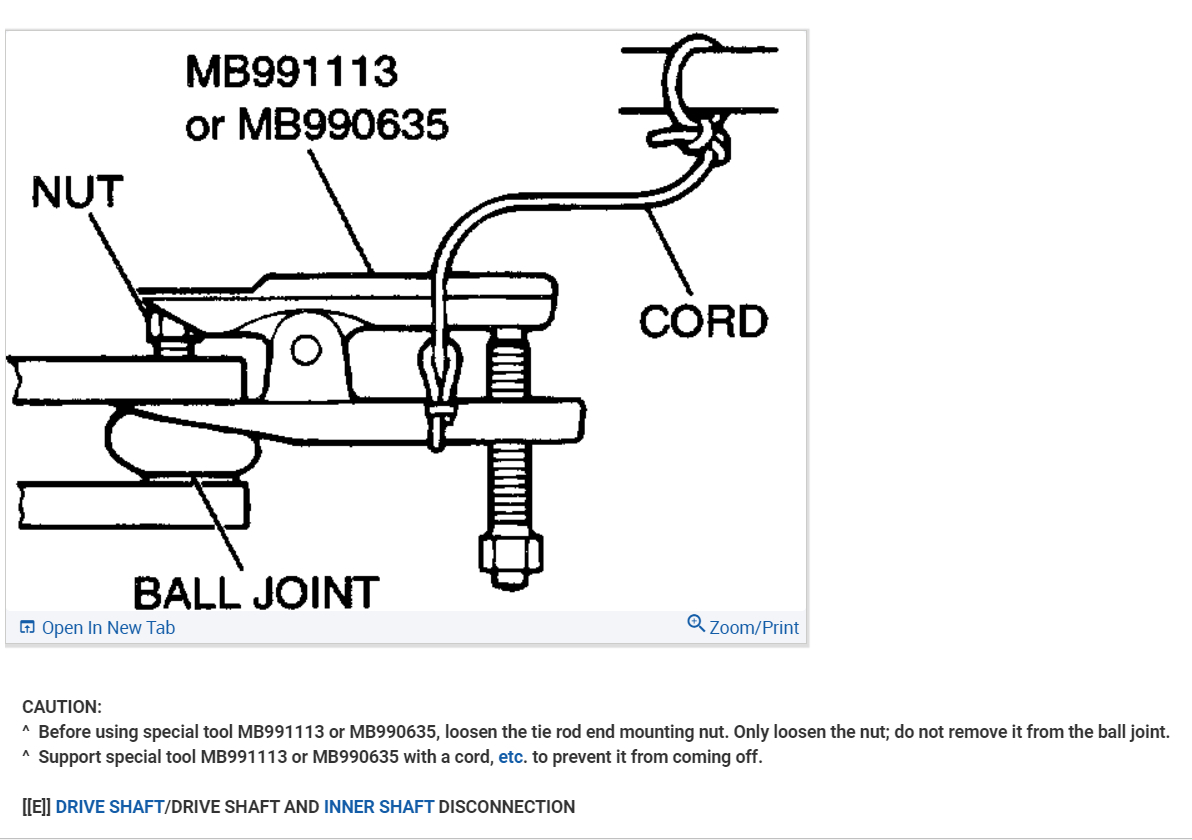

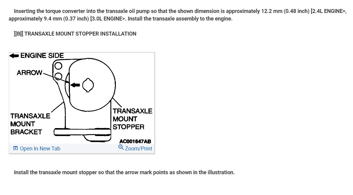

Nope, but you will need an engine sling brace. here is a video of the sling begin used on a similar car, but the procedure is the same except you will need to undo the converter bolts and cooling lines. Also, I have included instructions for your car in the diagrams below.
https://youtu.be/6N6b5F2ChyE
Check out the images (below). Please let us know if you need anything else to get the problem fixed.
Oct 3, 2022 at 8:50 AM
STEVE W.
  • 15,295 POSTS
Not on that vehicle. You can remove it through the bottom while supporting the engine. However, it is a tight fit. You will need a support beam or cherry picker for the engine. Be careful when removing the axles, it's very easy to damage the seals in the transmission housing.
