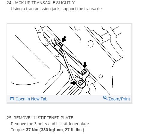

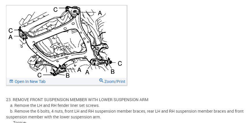

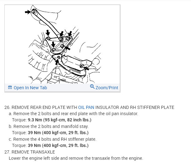

Does the transmission come out from the top or bottom?
Apr 6, 2023 at 6:02 PM
  • 110,240 POSTS
Interestingly, I am only finding directions for the removal of a manual transmission. However, I know that the automatic, as well as the manual, come out from the bottom.
The procedure requires the engine to be supported from the top.
Not to confuse you, I attached the last few steps below related to a manual transmission. I wanted you to get an idea of what is done.
