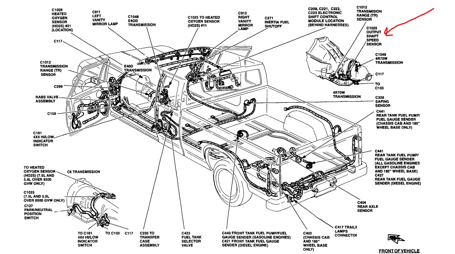

Where is the speed sensor located?
1996 FORD F-250
150,000 MILES • V8 • 2WD • AUTOMATIC
EDWARD JETTY
Lost speedometer very slow shift at all need to rev high to get to shift at all would like to know speed sensor location.

The output speed sensor or VSS is at the rear of the transmission. I have included a diagram in the images below. Check out the diagrams (below). Please let us know if you need anything else to get the problem fixed.
