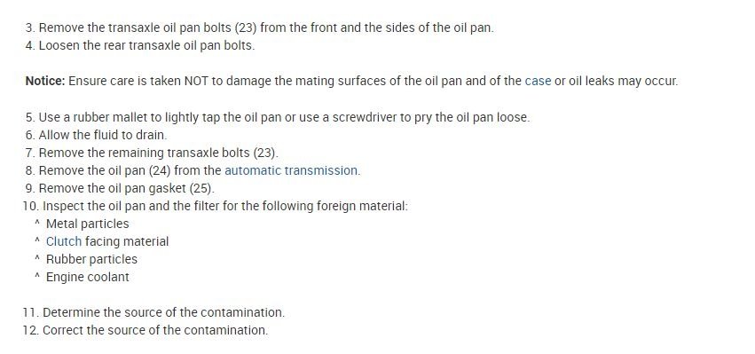

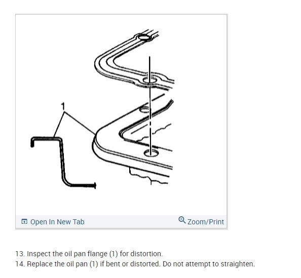

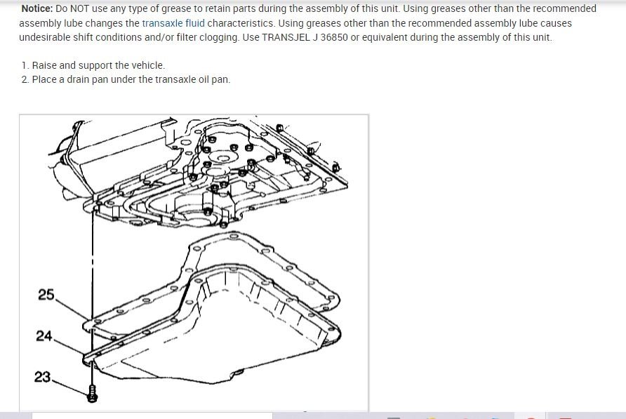

Trans not shifting not going into gear right away.
Sep 20, 2021 at 1:56 AM
Good morning,
I would drop the pan and change the fluid and filter. A clogged filter will cause this issue as there may not be sufficient fluid to run the hydraulics.
