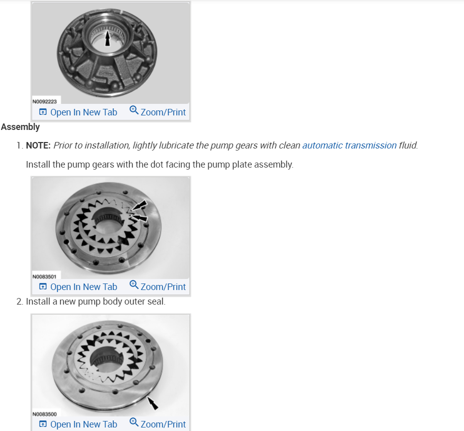

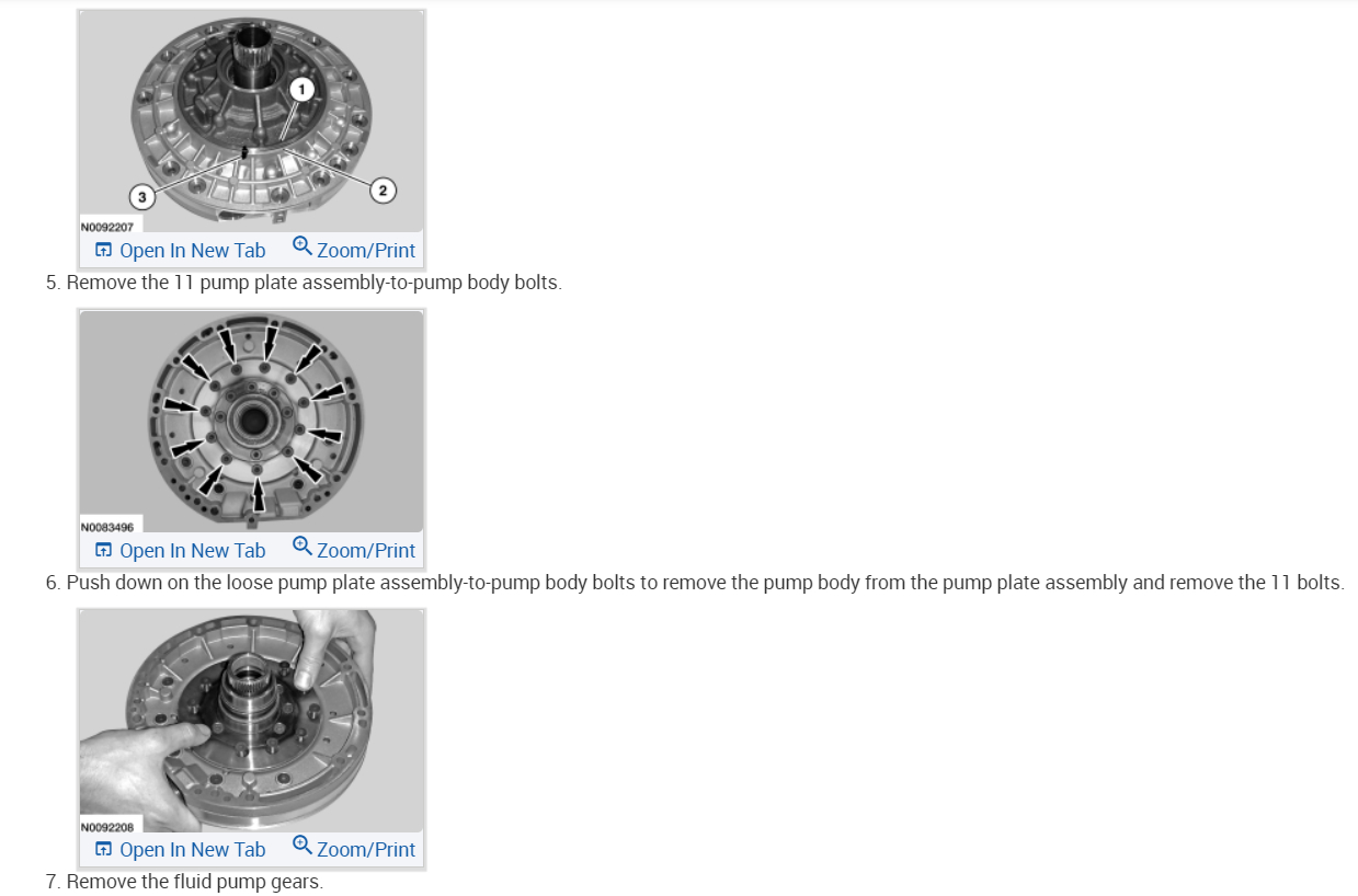

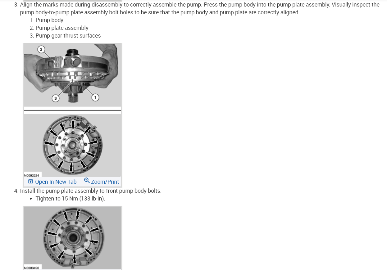

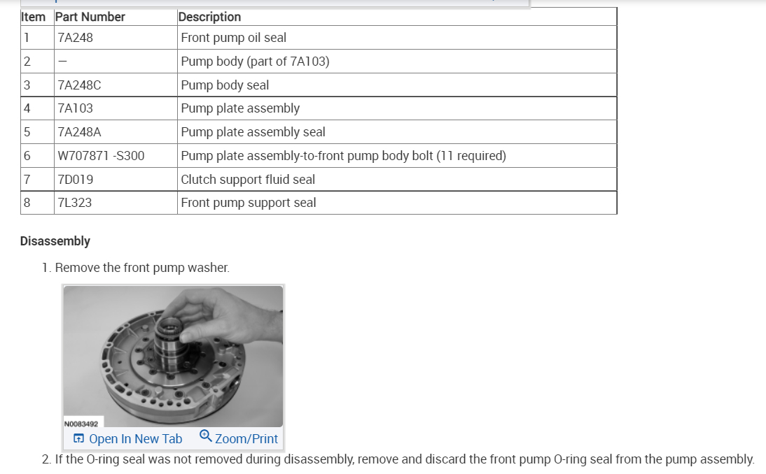

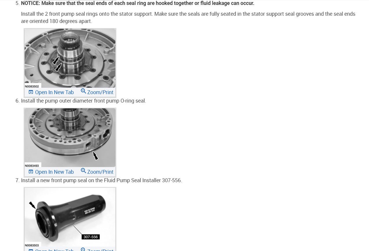

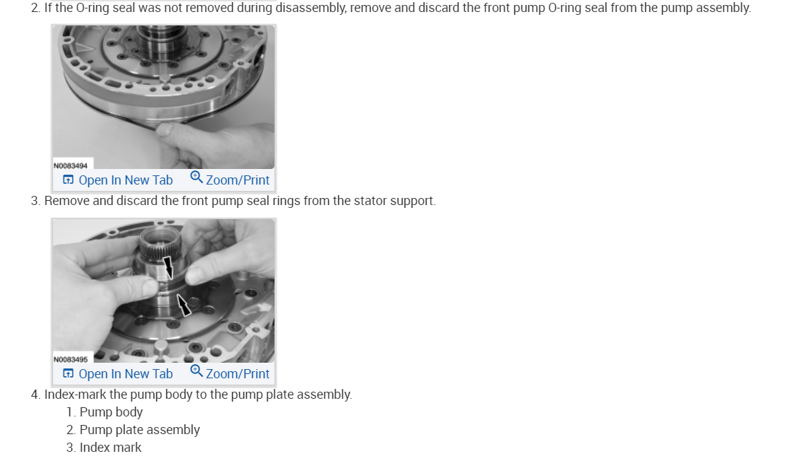

leak at bell housing. I pull 26' trailer on trips, no problems with transmission other than small leak.
May 30, 2022 at 1:41 AM
  • 55,433 POSTS

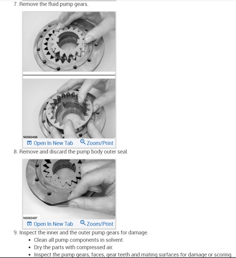

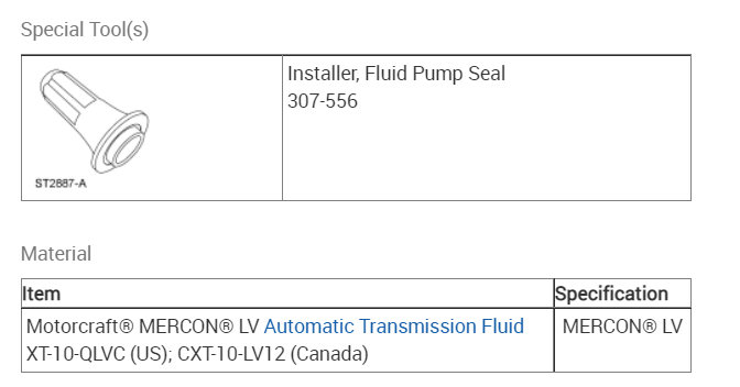

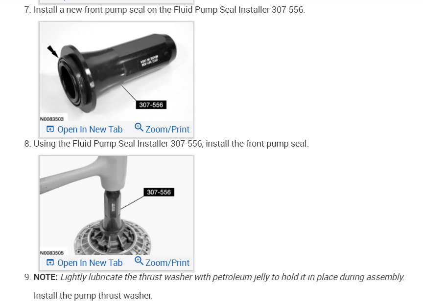

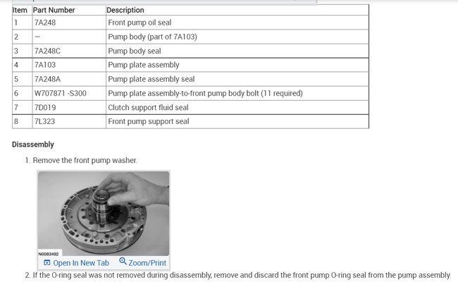

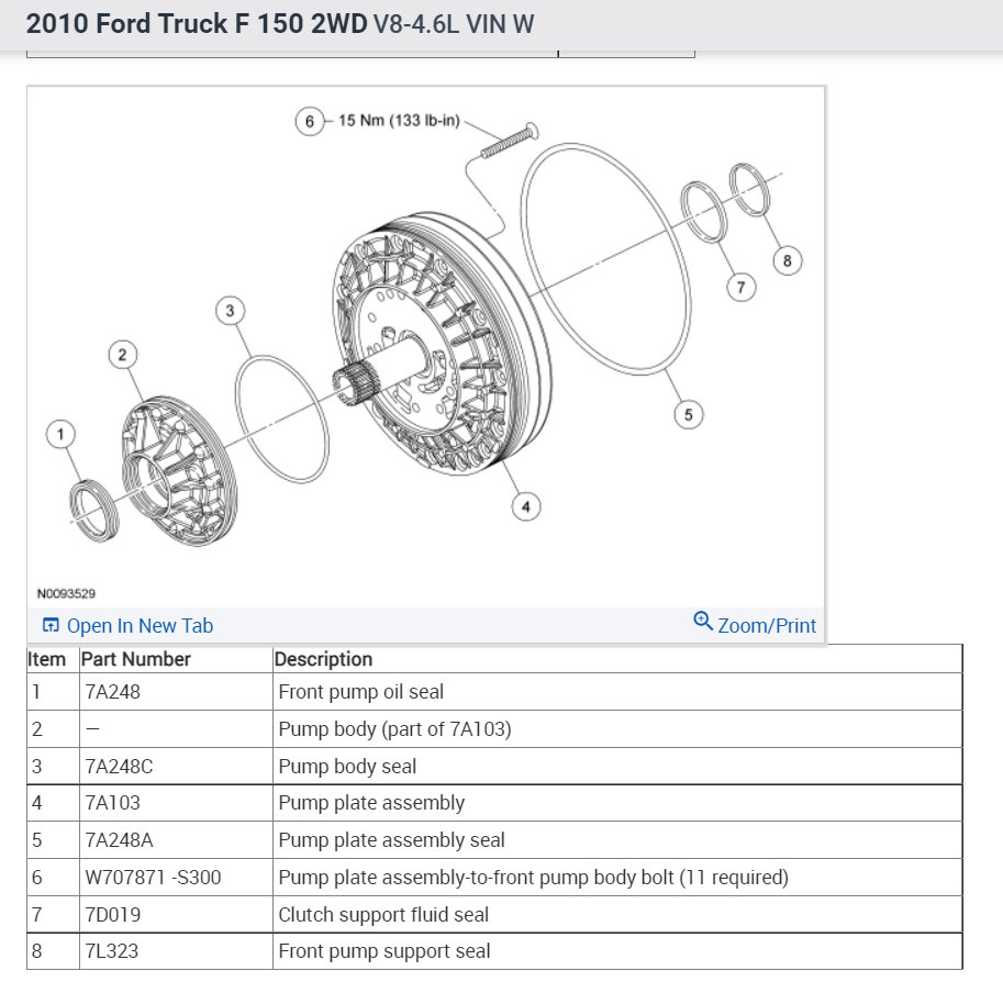

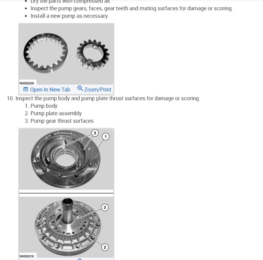

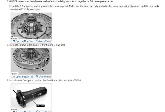

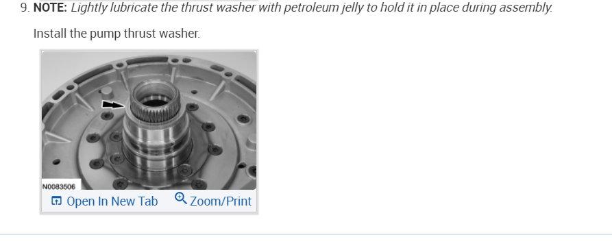

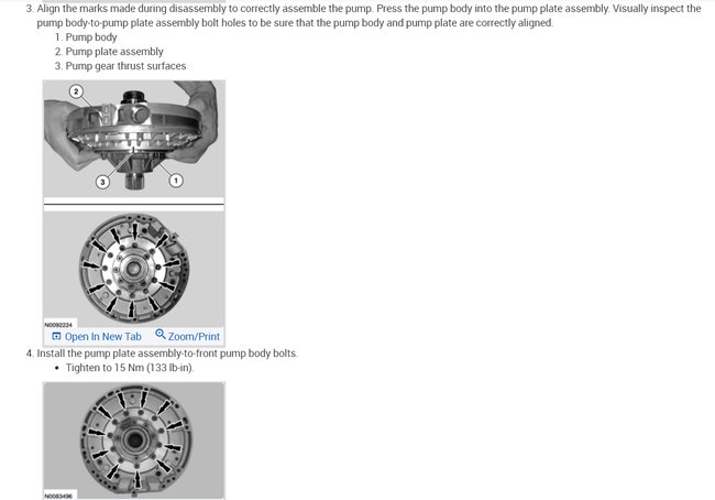

It sounds like you have a front pump or torque converter seal that is leaking, it will be difficult to tell for sure unless you remove the transmission since both seals are inside the bellhousing. Here is a guide and video of how to remove the transmission to do the job with specific instructions in the diagrams below for your truck on how to do the job.
https://www.2carpros.com/articles/how-to-remove-an-automatic-transmission-rwd
and this video is a car, but the truck is very similar.
https://youtu.be/3vJAojsrfuU
This video will show you how to install the torque converter once the job is done, and you are ready to reinstall the transmission:
https://youtu.be/ZC7xHVMKLRw
