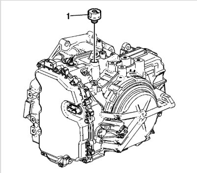

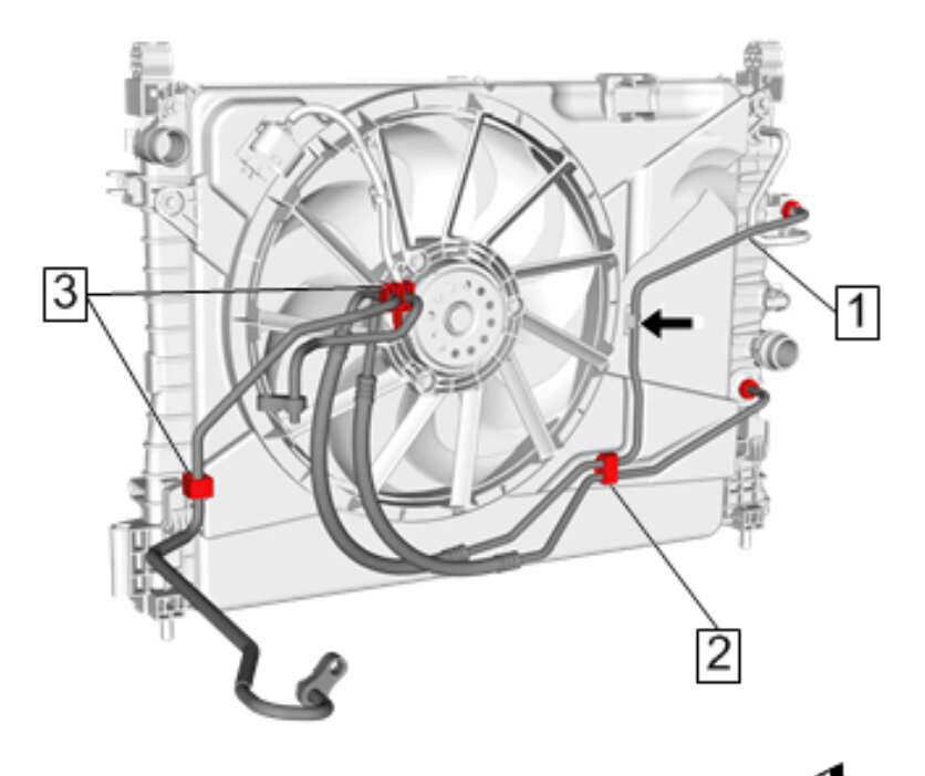

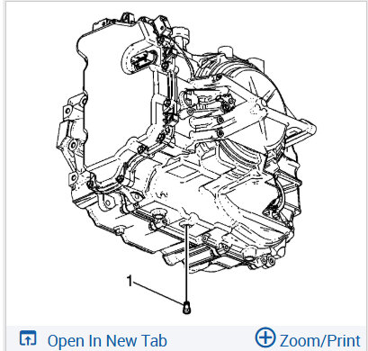

Just took it to service garage, they told me trans lines rusty and leaking, needs flush / fill/ filter change. Anything you can tell me as to how extensive this should be , time wise, and any video links you could provide would be appreciated.

Hello, The book get 2.5 hours to change the lines. Trax trans oil cooler line replacement lands around $552-$695 total, with labor making up a big chunk of that. The Trax uses DEXRON-VI automatic transmission fluid. There is no serviceable filter so the fluid is a dump and fill, here is how the job is done in the images below. Let us know if you need anything else.

Yes, this follows the same info i pulled up, however, this filter isn't exactly serviceable, but I see it can be changed out, which from what I gather, is why they said a min. of 4.5 hrs for said job since trans will need be split open and entails a lot more time, this dump and flush would be expensive enough, and something I could do myself but being disabled, ill have them do it.

Yep, you are correct, the filter is inside the case, this a big job and at this point you might want to get a rebuilt unit if the fluid is burnt with 148k on it.
