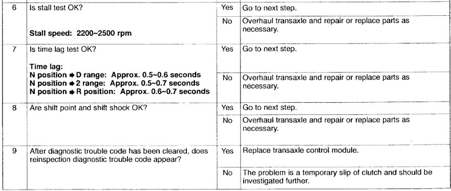

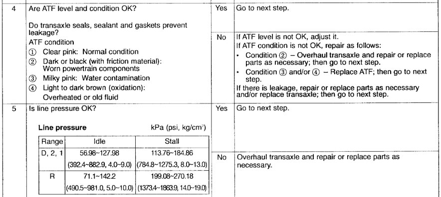

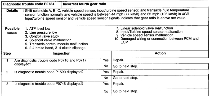

I get the code, P0734 gear 4 incorrect gear ratio.
Jun 5, 2020 at 9:38 AM
DANNY L
  • 5,648 POSTS
Hello, I'm Danny.
I've attached diagnostic flow chart below for that particular transmission code for your car. I've cut it into a few pieces so you can view larger.Hope this helps and thanks for using 2CarPros.
Jun 5, 2020 at 11:12 AM

Good morning,
This code is for low line pressure for the transmission. It could be from the front pump not working or worn out or it could be from a leak internally bleeding off the pressure.
I attached a diagram for you to view. It does indicate that the transmission will need to be either rebuilt or replaced if the pressure is low.
You could try changing the fluid and filter. I doubt it will change anything but it would be worth a try.
