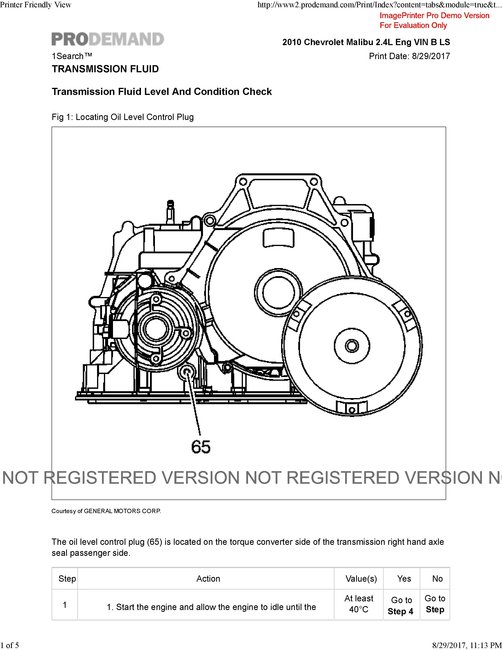

How do I check transmission oil level?
Tuesday, August 29th, 2017 AT 7:29 PM
HARRY P
MECHANIC
2,295 POSTS

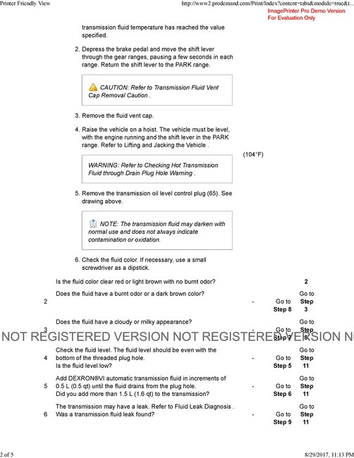

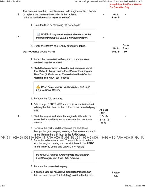

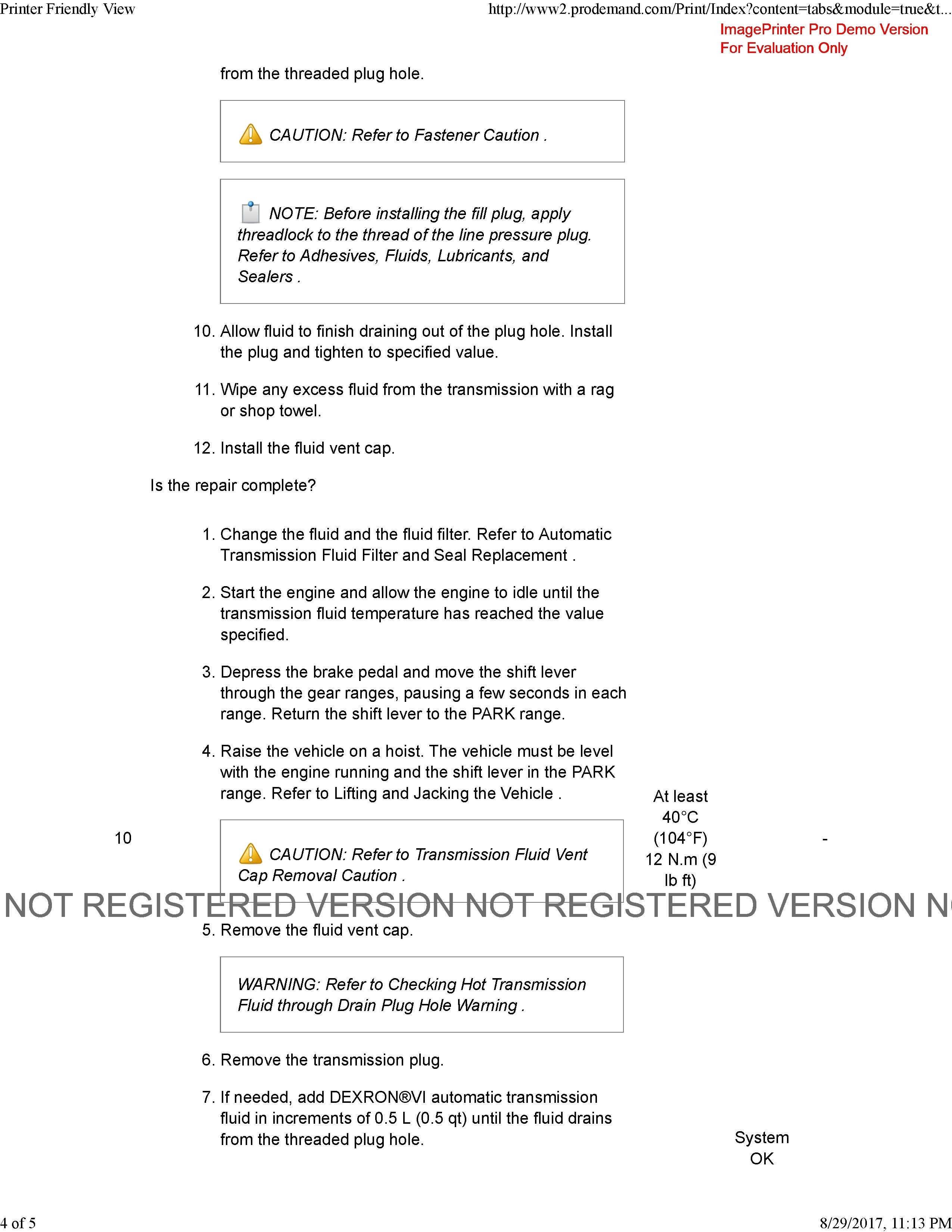

Unfortunately, your car does not have a simple dipstick for checking the transmission fluid level. I have attached a guide to checking you car's fluid in several image files.
Unfortunately, this is the way many cars are built now.
