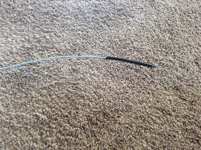

I just bought a dip stick for the transmission fluid. And there is no full mark or nothing on it, how do I know if it’s full?

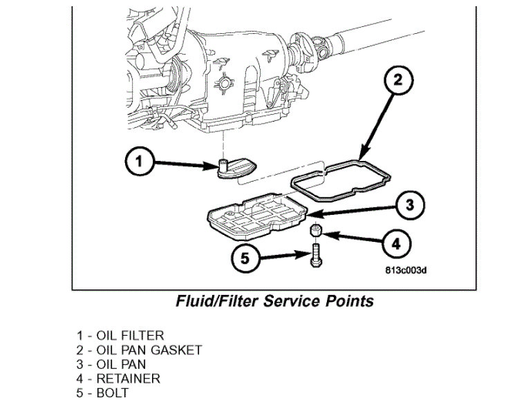

Good afternoon,
I attached the amount of fluid required for changing the fluid. I would drop the pan and change the filter. Then add the correct amount and when you check it with the dipstick, put a mark on the stick for the full mark so you have a reference for the full mark.

The thing is I had to buy a dipstick to check my transmission fluid. But on the dipstick I’m not sure what level my fluid is on because there isn’t no full mark or add mark.

That is why you need to start from scratch to make a reference mark for full level.
When you add the proper amount back into the transmission it will be full and you can mark the dipstick somehow to indicate it is full.

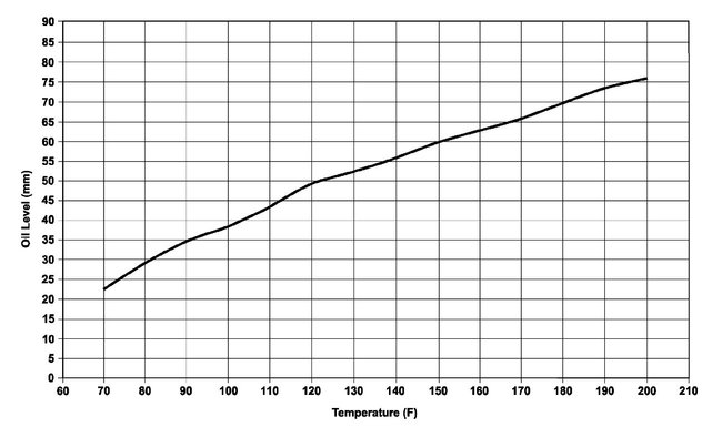

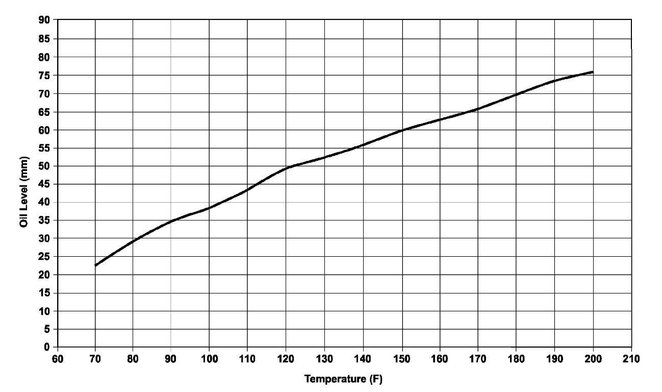

There is a way to check the level without dropping and changing the fluid but it can be a bit tricky. You use the stick and a chart to read the level. The chart below show the level the fluid should be at a given fluid temperature. It is getting the fluid temperature that is the trick. The best way is with a scan tool, even many of the lower cost ones can read the temperatures these days. Or you could use a probe on a thermometer to check it. Then you consult the chart. All of the levels are read after you start the engine, run it through the gears and check it at idle with the transmission in park. You then look at the temperature and the level. So say you have been driving the car, pull onto a flat level area, use the scan tool or other method to measure the fluid temperature and it shows the fluid is at 148 degrees. Put the stick in and let it bottom out, remove it and read the level, it should be right around the 55 mm mark if the system is full.
A quick approach I have seen done as well is to take a measurement with everything cold. Then start the engine, run the transmission through the gears, put it in park and take another reading. Then that becomes the "full cold" level. Then they drive the car around a bunch. come back to the same spot and measure again. Then that get's marked as "full hot" Not as precise as the OEM but it should work as long as the transmission isn't leaking and is operating okay.
