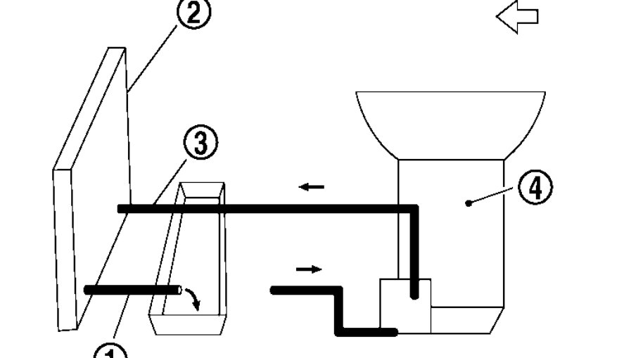

All the transmission fluid came out on the ground because the line came off. I put the line back on. Is there a certain way I put the fluid back in? Urgent
Nov 21, 2018 at 6:10 PM
Good morning,

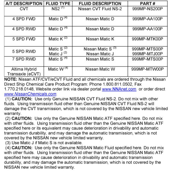

I attached a diagram for filling the system and the fluid required for the transmission to operate.
It is very important to use the correct fluid or damage will result from the wrong fluid. You can add at the dipstick for the transmission.
1. Warm up CVT fluid by driving the vehicle for ten minutes.
