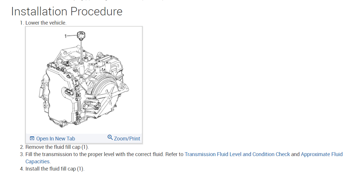

Where are the transmission filler and inspection holes located?
2015 CHEVROLET IMPALA
110,000 MILES • 3.2L • 4 CYL • 2WD
CPERRY54
  • 35 POSTS

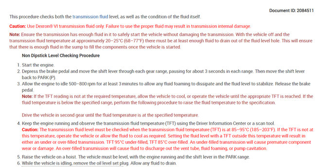

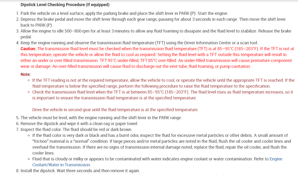

Need to know the location of the transmission filler hole and inspection hole.
Aug 8, 2021 at 9:37 PM
Good morning,

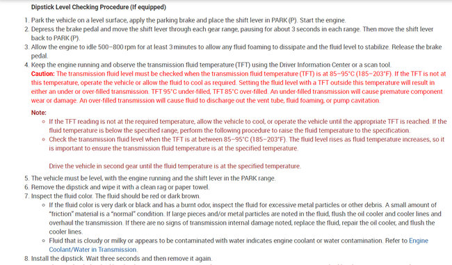

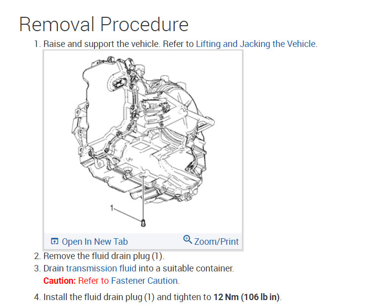

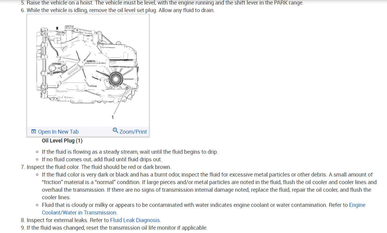

I attached the procedure for you to drain the fluid and refill. The fill plug is on the top as in the picture and the level plug is on the left side behind the axle shaft.
