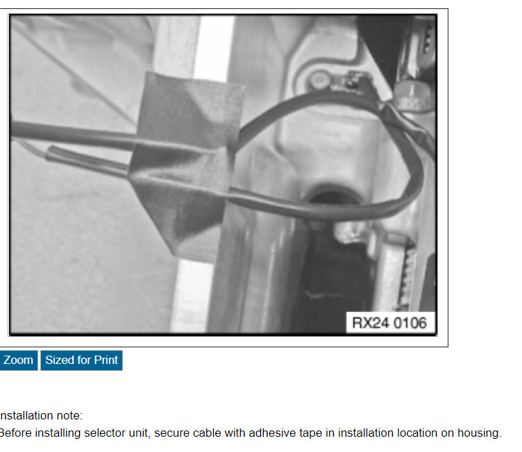

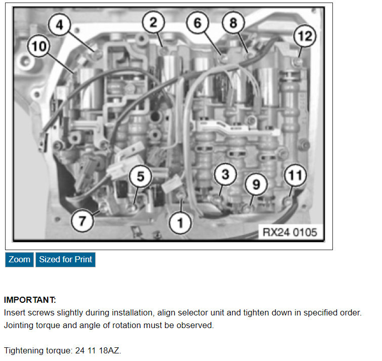

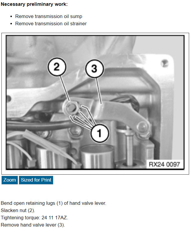

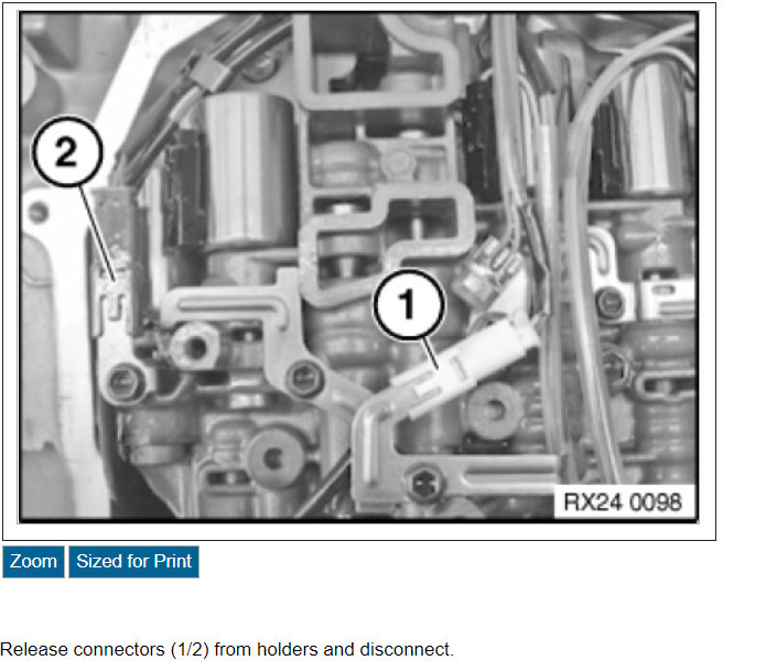

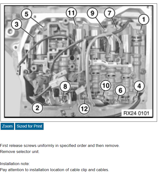

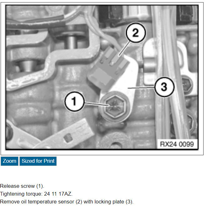

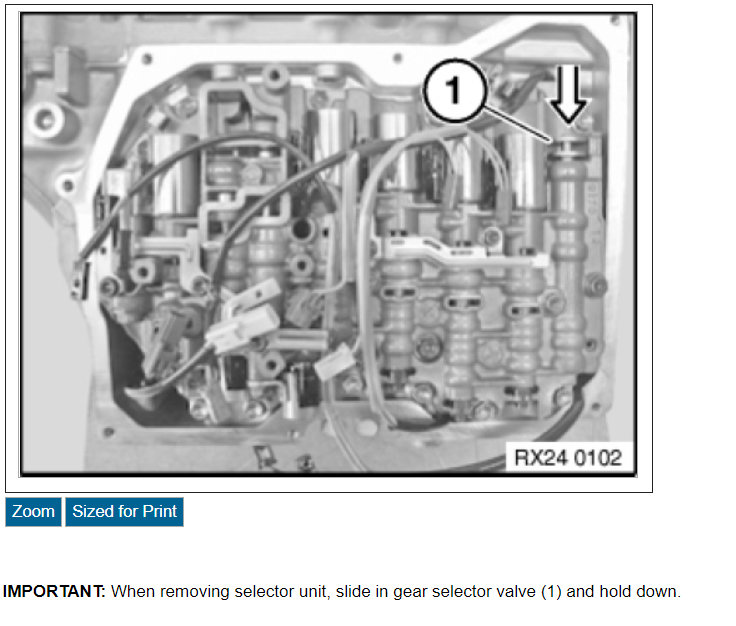

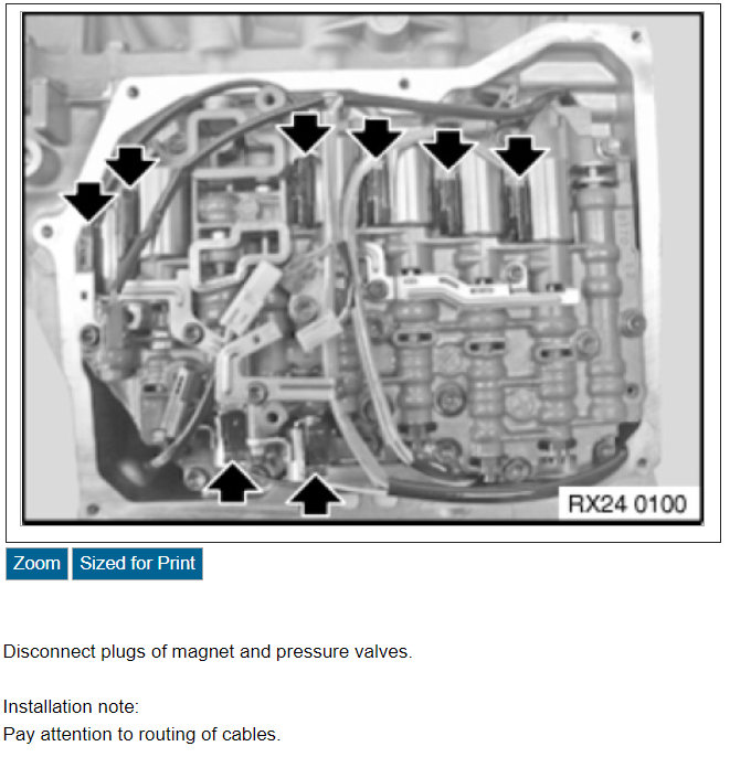

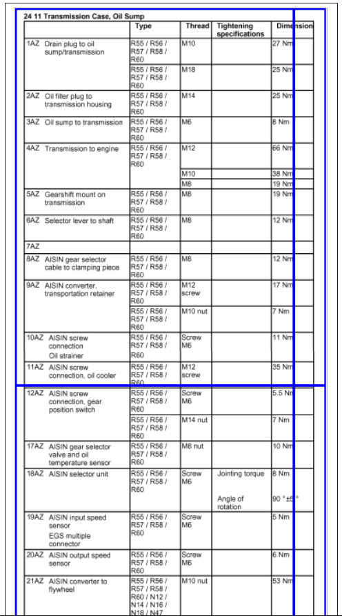

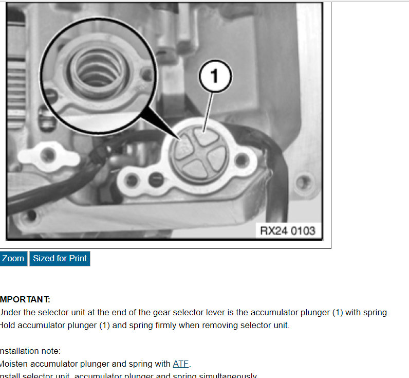

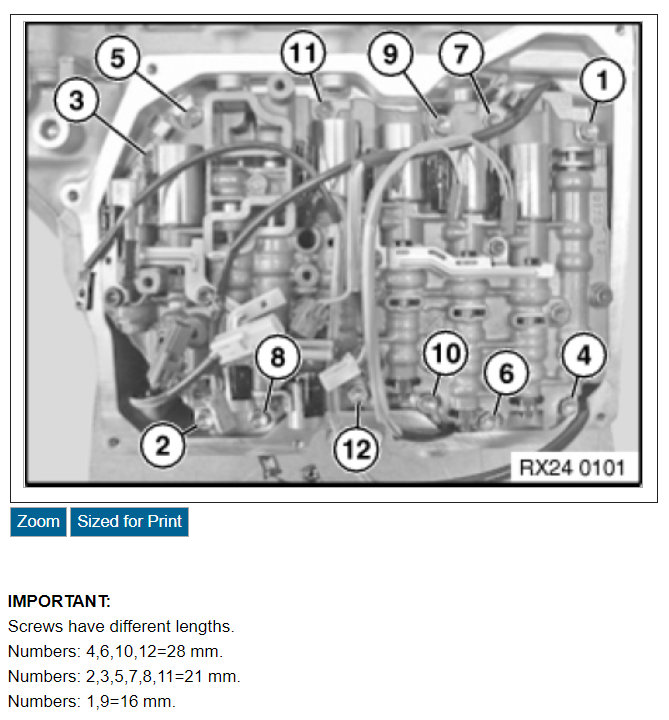

I have the same fault for my car listed above. Where did you find all of the parts for the solenoid, valve body and seal kit for the clutch pack? Thanks for any information.
Eddie G.
Jul 12, 2018 at 5:08 PM
  • 54,832 POSTS
You can find the all parts or this car at the dealer. Here are diagrams to help you do the job. Let me know if I misunderstood you.
