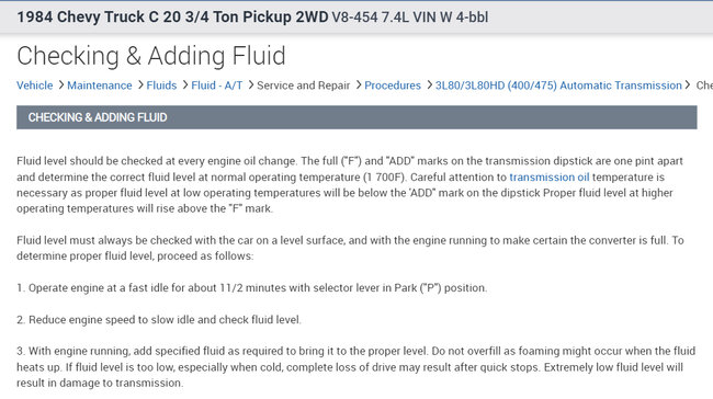

Thanks! Can you also tell me the amount of fluid needed for a transmission fluid change?
Nov 10, 2022 at 12:31 PM
  • 110,194 POSTS
Interestingly, the manual doesn't have the specifications for a service. I know it holds 11 quarts of it is totally dry, but that isn't the case when you drain it.
Here is what I suggest. Start by placing approximately four quarts to start. Once you add the fluid, follow the directions I attached below. Also, it doesn't mention it, but I would shift it through the gears before checking the level.
Let me know if this helps.
See pic below.
