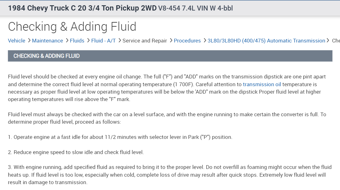

I'm trying to determine the correct length of dipstick I need for my transmission fluid level. The engine is a 454 and the transmission is a THM400 3-speed. The stick I have now is 32" long, not including the handle. I tried to look online but got varying answers with varying lengths. Can you help confirm the correct one?

I believe the filler tube is approximately 25" in length. The dipstick would be a few inches longer.
Since GM no longer produces this part, you can get an aftermarket. Even if the filler tube is a bit shorter or longer, the manufacturer has compensated for that in the dipstick. Since we can't be sure about what you have, I would recommend replacing the tube and dipstick together.
I know Mr Gasket makes one for this truck. Here is the part number: 9765A 9765
Check that out and let me know if it helps.

Thanks! Can you also tell me the amount of fluid needed for a transmission fluid change?
Nov 10, 2022 at 4:31 AM
  • 110,244 POSTS
Interestingly, the manual doesn't have the specifications for a service. I know it holds 11 quarts of it is totally dry, but that isn't the case when you drain it.

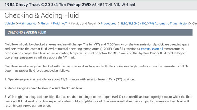

Here is what I suggest. Start by placing approximately four quarts to start. Once you add the fluid, follow the directions I attached below. Also, it doesn't mention it, but I would shift it through the gears before checking the level.
Let me know if this helps.
See pic below.
