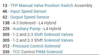

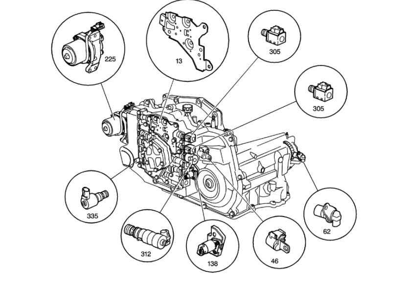

I have the XR model. I am told I need to replace the transmission solenoids, but I want to make sure I am getting the right parts. How many are there? I know there are more than one. About how much should just the parts cost me?
Dec 21, 2017 at 9:38 PM
Good morning my name is Roy and I will assist.
Below is the information you requested. I find highly doubtful that all the solenoids have failed at one time. What is your original issue?
Also, the price is about $60.00 to $120.00 per solenoid.

As Roy asked, what is the problem you are having? It would be very rare to have more than one or two solenoids failing at a time. Plus it may be that the solenoids are not the actual problem but that it is in the controller or even a mechanical failure internally. With 200,000 miles on that transmission I would be real suspicious that it is only a solenoid.
